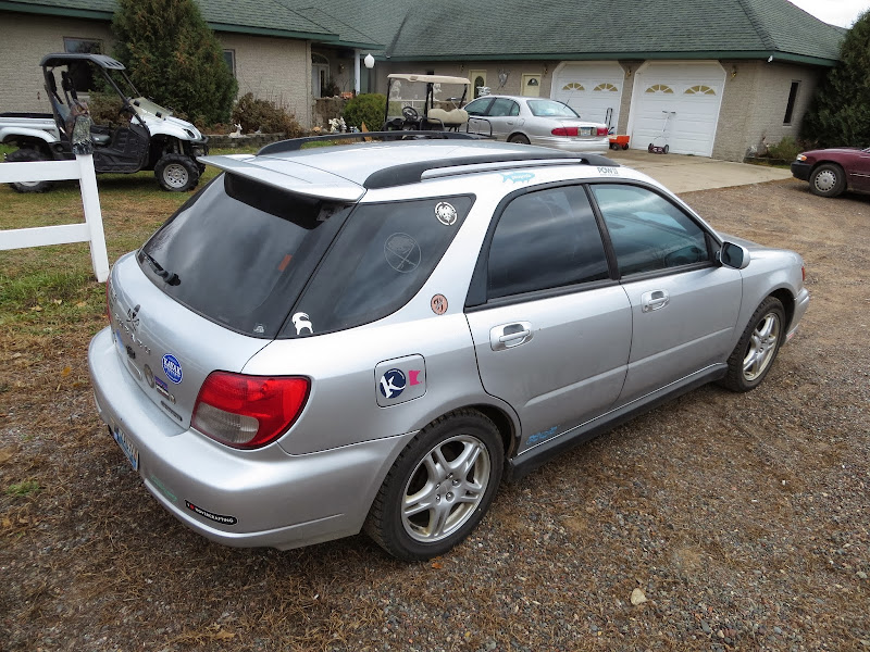

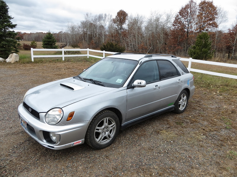

    Well, only took me a month to get some pics up...

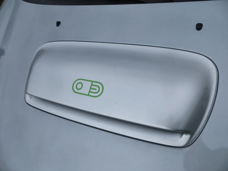

    Pics from the day we brought 'er home. I have since stripped all of the stickers off, minus the airpill on the hood scoop, but I'm not really digging it as much the more I look at it. It was calling to us on the day of purchase as Airblaster is the only outerwear we rock during boarding season. Might replace the pill with a ptery diecut and put it more on the rear of the scoop so you can see it from inside. Otherwise, it actually looks pretty sharp now that it's all cleaned up. Will get some updated pictures sometime. Probably in another month...
    If the html coding works the same on here as the other forums I'm on, click for full size/res. If not, I'll need to be schooled in proper uploading technique on here.

    I'm glad you de-stickered it, it looks like someone's idiot child went nuts and randomly put **** everywhere.

    Word. I'm usually a fan of a few stickers here and there when done right, but looks like the dude got high and just went to town with it.

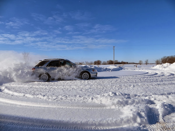

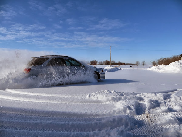

  11. Krazylegz1485
    3,628
    You said it. Pics from this weekend (also posted in the snowy pic thread). Click for full size.

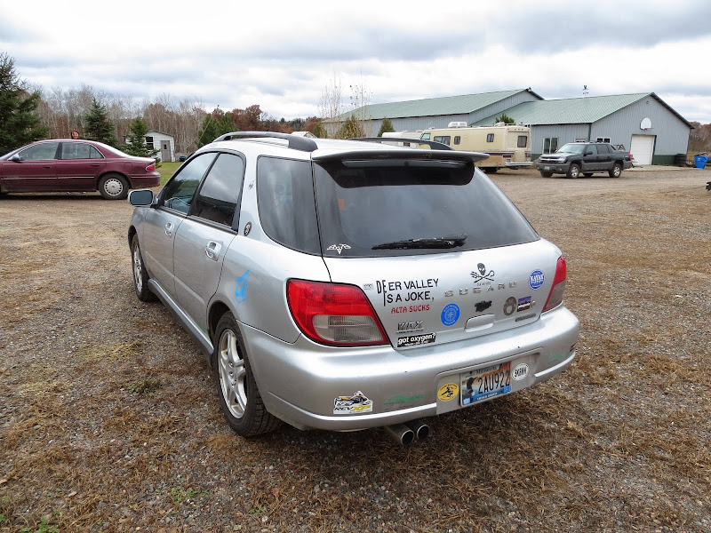

    Well, you guys are in luck. Finally found the site where my buddy got it. Only $10, too! Click the pic...

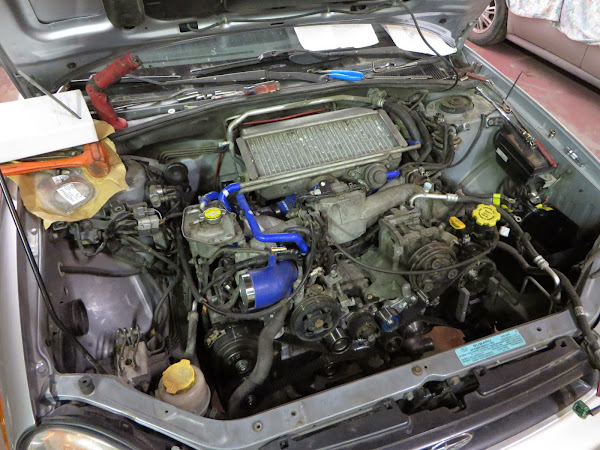

  31. Krazylegz1485
    3,628
    Just cross posting/pasting this from my misfire thread (in hopes that I won't have to post there again) and to consolidate into this one just for the hell of it.
    Just a little update for anybody interested. Been quietly/slowly making some progress on this thing and it's finally nearing the stages of rumbling once again. I ended up having my heads redone at a local machine shop down here since my boss is pretty good friends with the guy. Got two valves redone and the rest of them checked over. Heads cleaned up, seals replaced, valves all set back to spec (probably typical head job).
    Anywho, have been assembling a pile of "Christmas presents" in the meantime. Figured now would be the ideal time to do any performance mods I've ever wanted to do, so got an EBCS, lightweight crank pulley, phenolic spacers, and complete exhaust gasket set from GrimmSpeed. Also new silicone turbo inlet since my stocker was pretty much crap. Put the aftermarket up and down pipes in and will have the thing wrapped up hopefully within the week. Just gotta get a tune lined up and should be good to go.
    Buddy came down this weekend and we put in a 14 ish hour day yesterday. Got the motor completely reassembled and into the car. New clutch kit in, most of the motor hooked back up. Gonna go get a cam sprocket holding tool tomorrow to get them retorqued then can put the front back together and finish the task. Fingers crossed the beast will live.
    My only progress pic, as of about 1230 last night. Nothing special to look at, but damn it feels good.

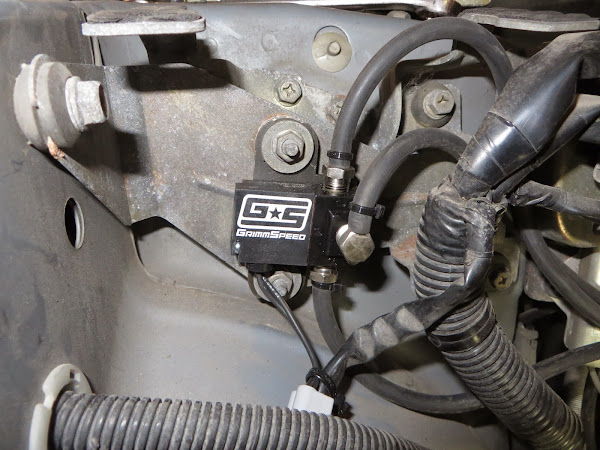

    3,628

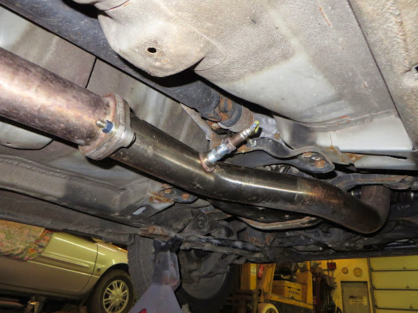

    Put the downpipe and the EBCS in the last two nights.
    Downpipe was an absolute animal to put in. I guess that's the price you pay to save a bunch on used parts. That or it's just normal for aftermarket stuff in general (it is with hot rod parts, I know). The catback I had put on before seemed to fit up to the stock downpipe with no real fitment issues other than a couple spots towards the back where I had to shave a few areas in order to eliminate rattles and rubs. Put the downpipe in and it wasn't even close to lining up with the mouth of the catback. Ended up using a ratchet strap around the downpipe to pull it to one side and then a series of different length bolts and clamps to pull them together at the flanges. Was a total pain in the ass but now that they're together it actually fits under the car better than the old stuff. Seems like it's got plenty of wiggle room on all sides, so hopefully won't have to modify anything else underneath.
    EBCS was about the most straight forward thing to install so far. Wish it was all that easy.

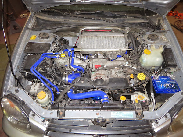

    It lives!
    Got it just about totally wrapped up today/tonight and actually fired the beast. Sounds pretty gnarly with no cats and can totally tell a difference by having the lightweight pulley on there. Almost didn't want to put it on as it looked so cool in the little box they ship Did both the resistor mod for the uppipe EGT and the mechanical fix for the rear 02 sensor, didn't get a check engine light yet so assuming they're working.
    Only issue I know of is an exhaust leak somewhere in the front, on the right side. Will have to get under there sometime Sunday or next week and do some inspecting. Anybody have any tips/suggestions on this? I put all new gaskets in the whole thing during reassembly. The good ones from GrimmSpeed. Didn't really do anything other than crank the sh!t out of the bolts at the flanges. Did I miss something? Will know more when I figure out which one is leaking.
    Lastly, the tool worked awesome. Really got to use it for about 30 seconds total and it made the job laughably easy. And I found a home for one of the several GS stickers I've gotten recently.
    Pics!

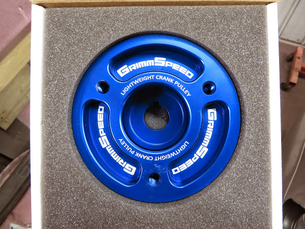

    What seems different about the crank pulley? I've got one that im putting off installing because im skeptical itll change anything..
  35. Krazylegz1485
    3,628
    It revs noticeably quicker, like it's not working as hard (essentially what it's meant to do). And I also read that it can help with low speed shifting and take off, 1st and 2nd type stuff. I can vouch for that as I putted down the road and back in 2nd tonight for my test drive. It's much easier to start rolling from a stop.
    I'd say if you've already got it there's no reason not to try it. If that's the only thing to change out I can't imagine it taking very long.

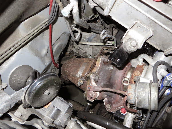

    Well, found the exhaust leak...
    So, my current question is this. I've now learned the hard way about buying cheap, used stuff and either not inspecting it close enough or it was possibly just really weak and broke upon install. I've got it pulled back out of the car and welded the sh!t out of it, probably half an inch up from the flange. Do I a) put it back in the car and hope that it lasts for the remainder of the car's days, or b) source a new or used GrimmSpeed uppipe that's constructed considerably better and has a flex section to help with gasket mating as well as vibration absorption?
    I've got a decent chunk of "extra" money currently due to the birthday cards/presents coming in. I wasn't pumped on the idea of dropping $200 on a new uppipe, but if I spend another $90-ish on gaskets to put it back together with the current piece and it fails again at a later date, I know I'll be a little peeved with myself.
    I probably sound like I'm answering my own question, but always appreciate the input of those with experience. Part of me thinks it'll just be fine and enough companies make uppipes without flex that it shouldn't be an issue, but I also don't have any flex joints in the turbo back anymore either. Seeking advice.
    Thanks much!
  37. EricS
    EricS Nooberator
    Someone with a lot more experience should chime in, but I'm thinking that since you just put the gaskets in, you should be able to reuse them with a very high degree of success?
    Ryan FailRad and Krazylegz1485 like this.
  38. TMF
    Yea, unless the gaskets are burned out, you can reuse them.
