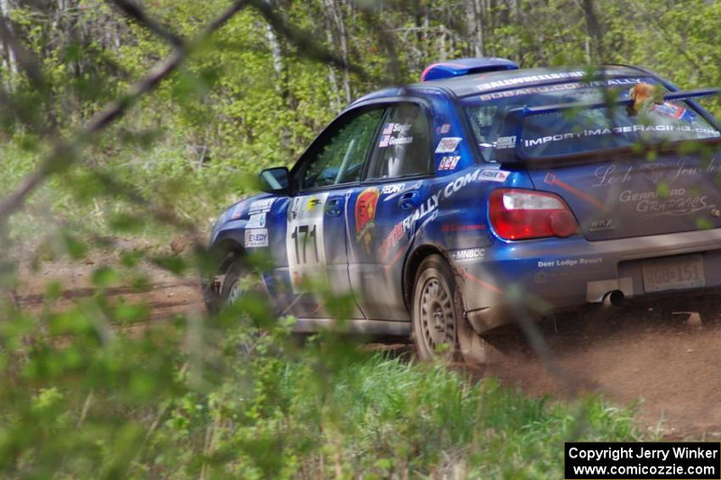

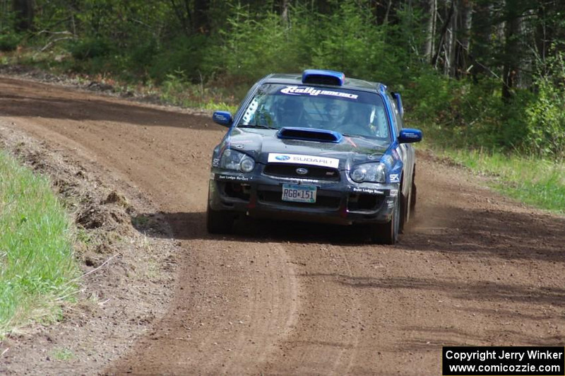

    On board 171 ss2
    [YOUTUBE]9P4JZtfkso0[/YOUTUBE]
    nice video courtesy of the Huebbe's and Jerry Winker
    [YOUTUBE]w2OXeBKPtug[/YOUTUBE]
    Yes, it was snowing in May!

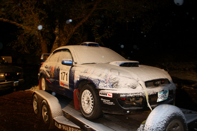

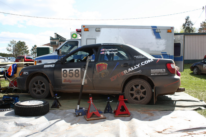

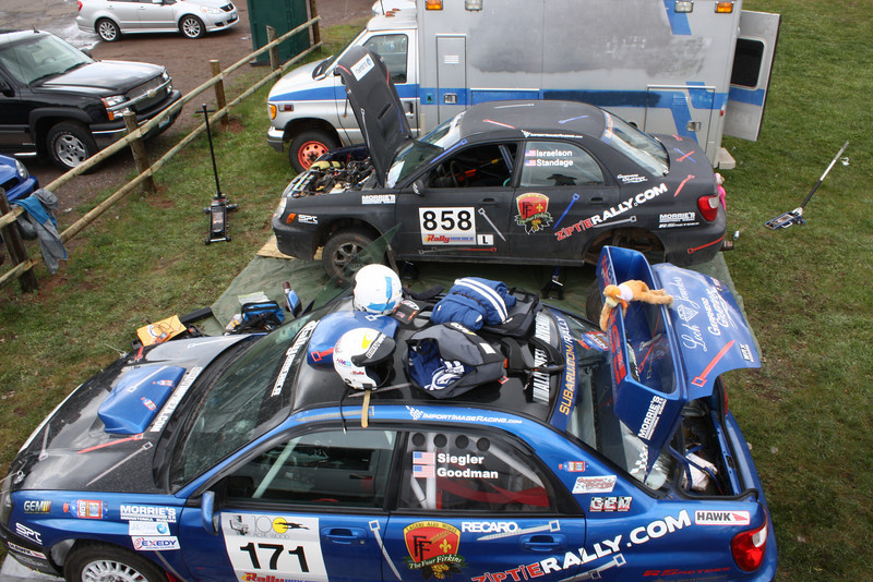

    service
    858 sitting in service
    171 outside of MTC
    photos by Martin Asao, Jerry Winker and Scott Reed
