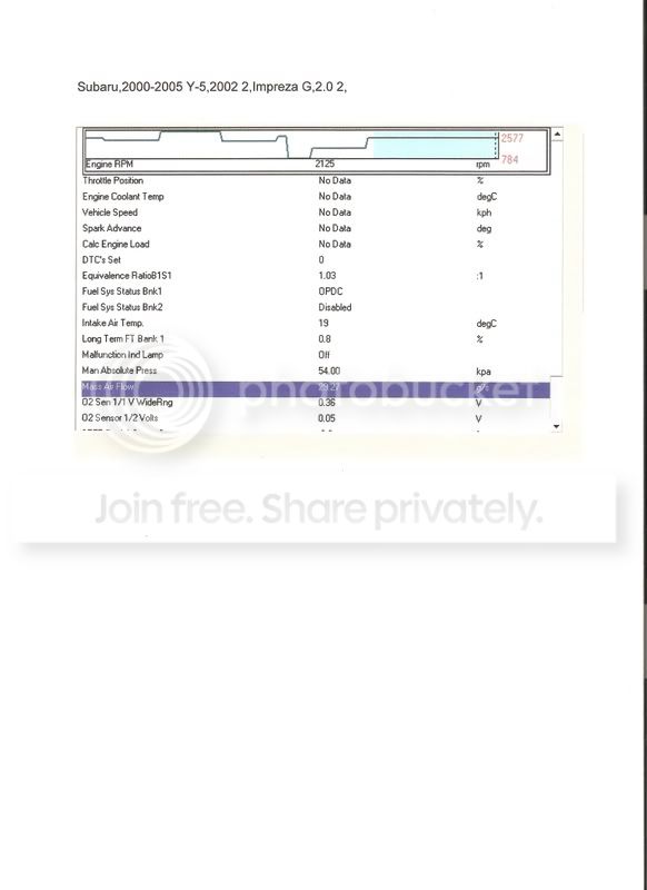

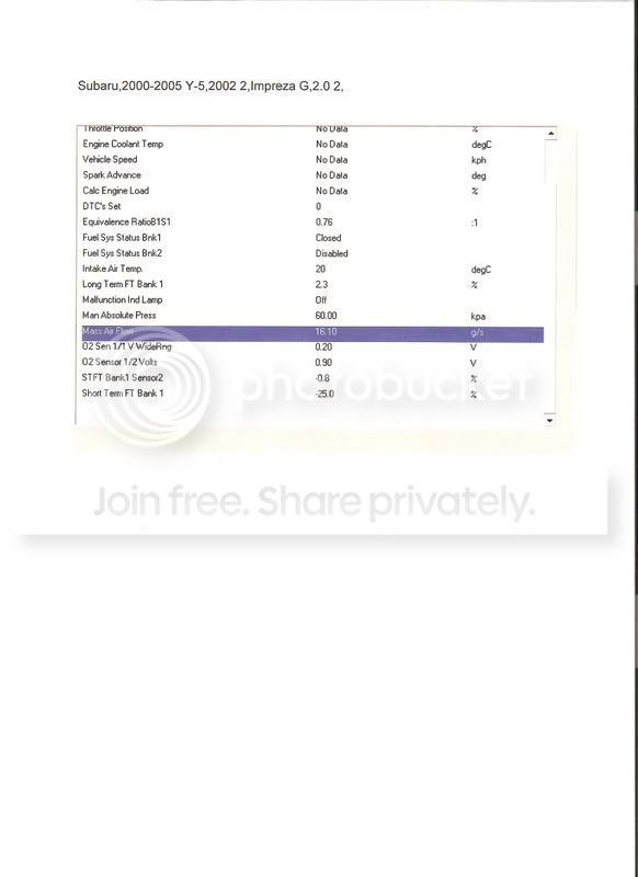

  2. 95lwrx
    95lwrx Well-Known Member
    1,748
    brainerd
    not sure if these will help, tried to pull them by myself and it isn't the easiest setup to pull a good log.[​IMG]
