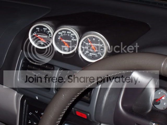

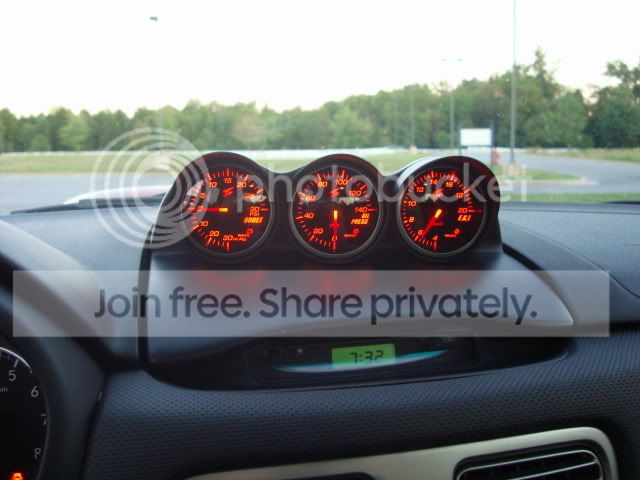

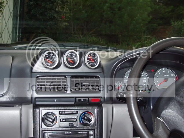

  8. TSTRBOY2004
    I believe Bill has this style...
    which personally I dont like...
    I prefer this style....
    but REALLY WANT this style...
  9. Gridlocked
    Whoah, whoah whoah!
    WTF is this, and where does a guy get one?
    :yumyum::yumyum::yumyum:
  10. STiM
    STiM Well-Known Member
    I have to 2nd that! WOW!! thats perfect!!
    You guys are awesome!!

  12. TSTRBOY2004
    the third pod set is about $200+ just for the pod... if you can find it... I think you can track em down on ebay... but it still makes that compartment useless.. well even more useless...
