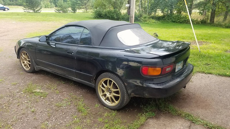

    I just used Rustoleum Gloss Black on the trunk/spoiler of my Celica. Looks good, matches the Toyota 202 Black very well. I used Acetone to thin at first, and got some orange peel, but looked much better with Mineral Spirits.
    Not the greatest picture, but it's what I have.
    2018-03-15_04-04-51
    by Numbchux, on Flickr
    I painted the trunk lid, trunk spoiler section, and the near-side spoiler section (and fiberglassed over the hole where the antenna used to be on the side section).
    joebush44 and 02subbieRS like this.
