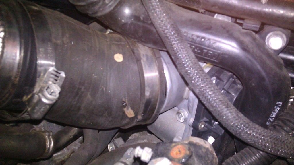

    Its easy. Just remember the position on the TB hose for putting it back on. I know you have a FMIC, so I am not sure how picky it is. With a TMIC if it isn't right on... it's a pain to install, see you're off a bit, pull everything, tweak it, install the TMIC .... see you're off a bit and repeat. I learned the hard way my first time.

    It shouldn't be hard to get back on with a FMIC. It's not very picky to the positioning. Depending on where the clamp is right now, you might have to move some of the hoses and wires from the back of the manifold (should just have bolts holding them in place). Just move them enough to get the clamp loose (don't unplug or completely remove anything). Clamp it back on nice and tight and then never worry about it again!

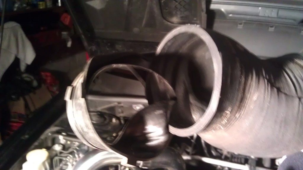

    After my visit with Jordan last night, I got close to home and tried to punch it and at 5lbs, all I heard was air psssssssssssh.
    Stupid hose... took that off and reclamped it down with a tbolt clamp. Now its all good.
  10. xluben
    That's the usual spot! Hope it holds up for you!
