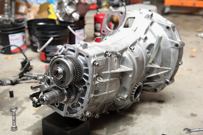

    Did I miss the build price? How much did this cost you? Who put in the gears?

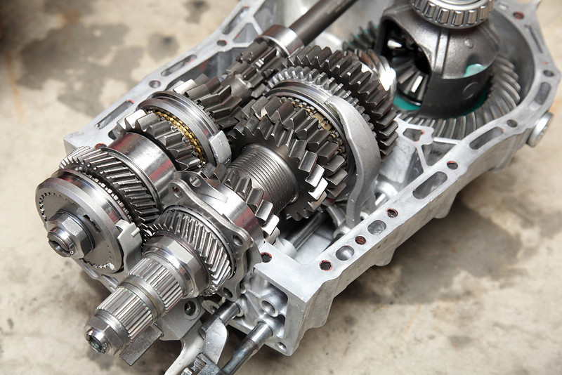

  5. xluben
    This gearset is $4500 new from Andrewtech. NF installed the gears into the case. I swapped the tranny in and out with some help from NF and others.

  8. xluben

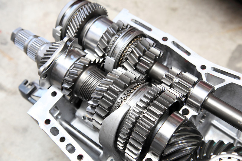

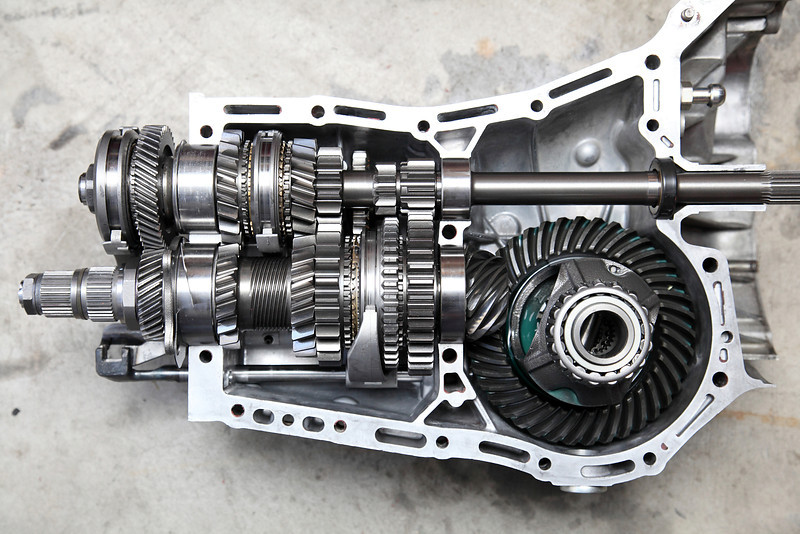

    I believe Andrewtech's website only refers to the PPG gears. I have PAR gears. Andrewtech sells them, but you'll have to call about them. Here is a link to the manufacturer's website:
    http://www.par-engineering.com/sect...aspx?typeId=gearsets&manId=subaru&sectionId=2
    I believe the Outback uses the TY75 transmission, just like the WRX (it's a 5 speed, right?). If so, you should be able to use the PPG or PAR WRX gearset.

  11. xluben
    About 4k of daily driven miles so far. Lots of cruising, but also plenty of WOT and probably dozens or maybe hundreds of FFS's so far. Everything seems to be holding up OK, but the same could be said about my stock tranny until the instant that the gear shredded off. I can probably give you a ride at a meet sometime.

  13. xluben
    Send Andrewtech an e-mail. They recommended them over PPG's. The PAR gears are wider, and therefore should be stronger. There are very few people that have the gears though, so it's hard to find any real world feedback.

  17. xluben
    They are both gear manufacturers from Australia.
    PPG stands for Pfitznew Performance Gearbox.
    http://www.ppgearbox.com.au/
    PAR Engineering stands for Precision Automation Robotics.

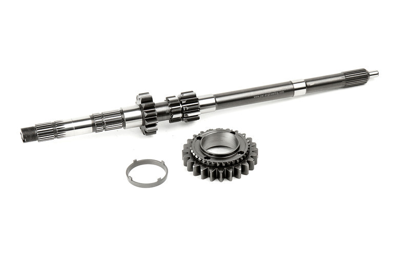

    I had the PAR 5MT 650hp Synchromesh gearset with straight cut 1st and 2nd gear. I don't think I ever updated this thread with the straight cut 2nd gear upgrade. I'll post those pictures after this post.
    This gearbox is now in another local 2011 WRX. I have switched to a 2011 STI 6MT with the Spec B long gear upgrade and DCCD Pro center diff controller.
    Stuck686 likes this.
  18. xluben

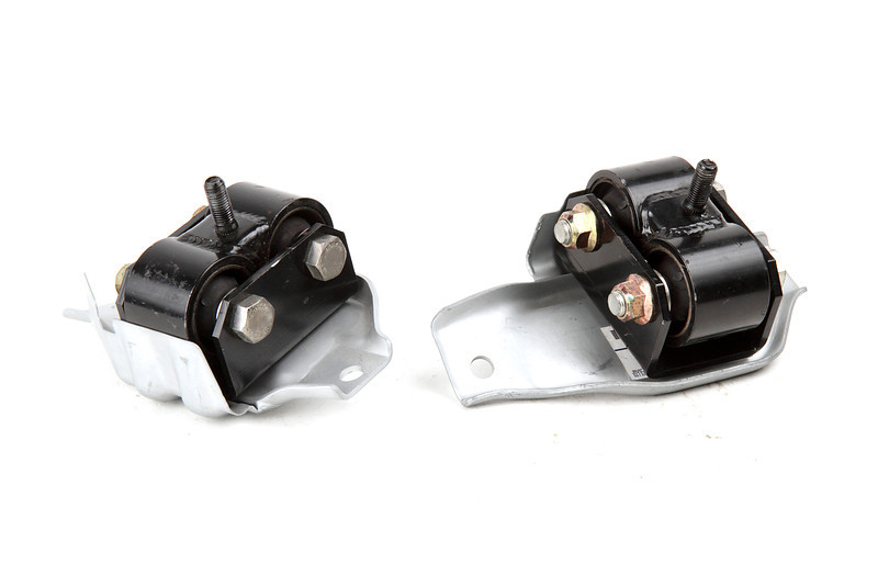

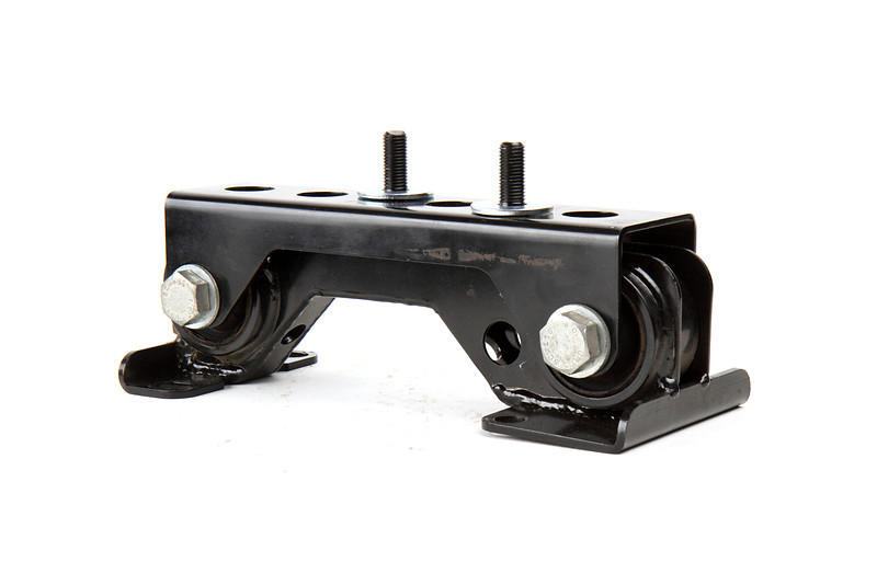

    Here are the posts on the straight cut 2nd gear and firmer mounts.
