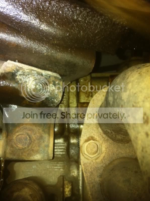

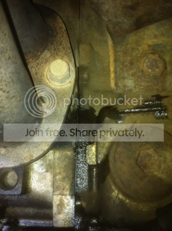

    I'm pretty sure my GFs car (99 imp 2.5 RS ) is leaking externally, but I would like confirmation incase I'm crazy before i tear it all apart. It hasn't over heated at all, but it's losing coolant and oil.
    Drivers side:
    Passenger side:
  2. RallyNavvie
    RallyNavvie Well-Known Member
    Is it burning coolant? Has it had a head gasket replacement ever? The stock gaskets on the 99 2.5 weren't so great but the replacement kit they had for them later from Subaru were a lot stronger. I had a 99 RS but it had nearly 50k miles with a turbocharger installed before it started to burn coolant on the stock gaskets. I never started losing oil though.
  3. Bielke55
    Not blown yet, but leaking for sure.
    Time for a timing belt also?

    Definatly leaking.

    I took it all apart yesterday, it was definitely leaking from both sides, and quite
    Badly from the top of the passenger side. The intake gaskets showed
    Signs of leaking too which I've never seen on a Subie. Someone has been in this engine before, it was supposedly rebuilt 30k before we bought the car. The upper center bolt on both sides was so over tightened that the 1100ft/lbs snapon impact wouldn't take them off, that seems pretty wrong to me...
    Cars
    Cars getting rear main, clutch, pressure plate, head gaskets, intake/ exhaust gaskets, cam seals, milled heads, and a new timing set. And the oil pan is about rotted off. Should be about a $1000 valentines gift depending on what the beads need haha. Thanks guys
  6. AWDimprezaL
    1,821
    Make sure you get PN# 11044aa642 x2 for the head gaskets. If you buy a gasket kit, it WILL NOT come with these, it will just come with the old crap gaskets.
