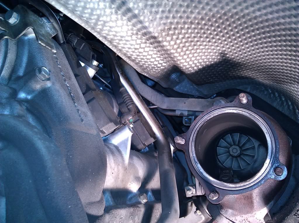

  8. idget
    No I'm still going to gut it, the problem is the post cat/pre-canister pipe has an angled diverter rather than a straight pipe. So any modification beyond gutting it will require so much work that you might as well start from scratch and build it from the ground up.
    Take a look at this cutaway to see what I mean:
    http://www.6speedonline.com/forums/996-turbo-gt2/235839-stock-cats-cutaway.html#post3114755
    I'm sure I'll go through at least half a dozen different exhaust setups on this car like I did on the wrx/STi.

  16. idget
    yeah, sucked. 3 hours to change the plugs and coilpacks (not including the hour it took me to remove the exhaust yesterday). I could probably do it in 3 hours total, but I don't want to find out.

    Yeah the book has you remove the wheels, taillights, rear bumper, rear fender liner pieces, 4 heat shields, intercoolers, and boost hoses. I didn't want to risk a boost leak or breaking something expensive.
    All I removed were the 4 O2 sensors, exhaust and 2 heat shields. 3 of the plugs/coilpacks were really easy, 2 were moderately difficult, and 1 was a huge PITA... I spent 45 minutes on that one because I had to squeeze my arm over the hard plastic boost hose, under the thick hard plastic fender liner, and through a metal bracket on one side... surprisingly I didn't break, bend, and ding anything and didn't lose any blood... lost lots of skin though :laugh:
