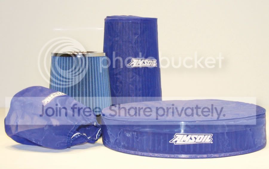

    I took out my silencer and dropped in the K&N last night. The new grumble and turbo whine sound is pretty cool, and although I haven't had time to open it up, the car does seem a little bit quicker and seems to spool a little faster. Would it restrict much air or do anything good or bad to throw a chunk of panty-hose over the air box inlet to keep the big stuff (bugs, gravel, etc) out? I need to get new fender liners because mine are all beat up and I don't want a ton of gunk pouring in the airbox, but thought the extra "filter" might help?

  18. richard donovan
    richard donovan Well-Known Member
    Gridlocked -
    You could try making some sort of pre filter from this
    or this
    Filter
