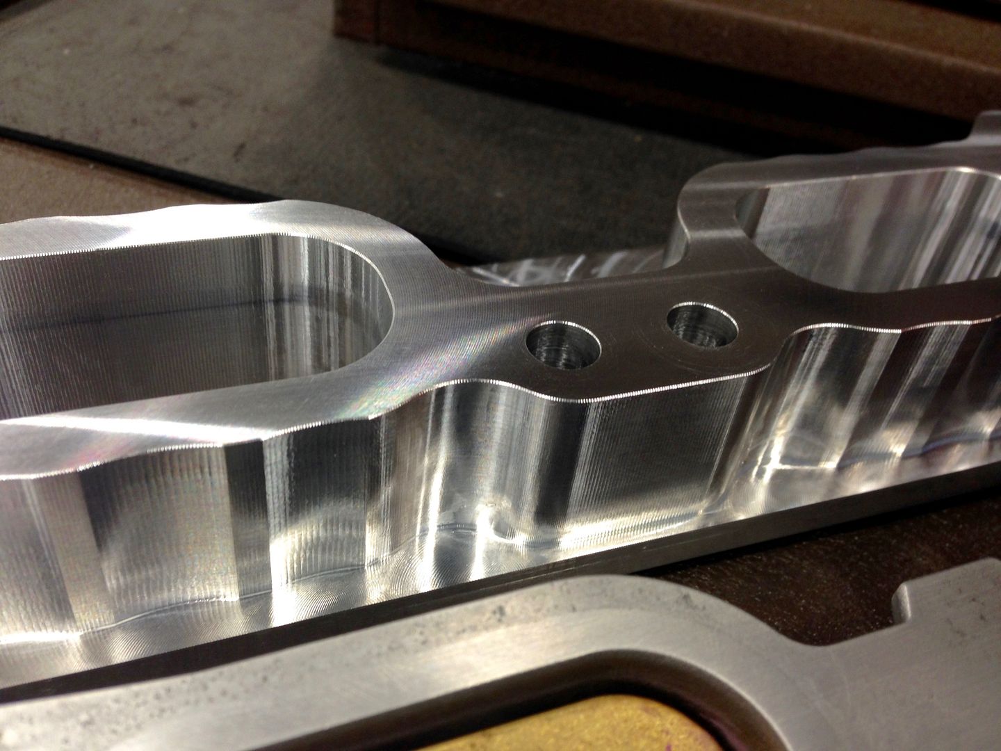

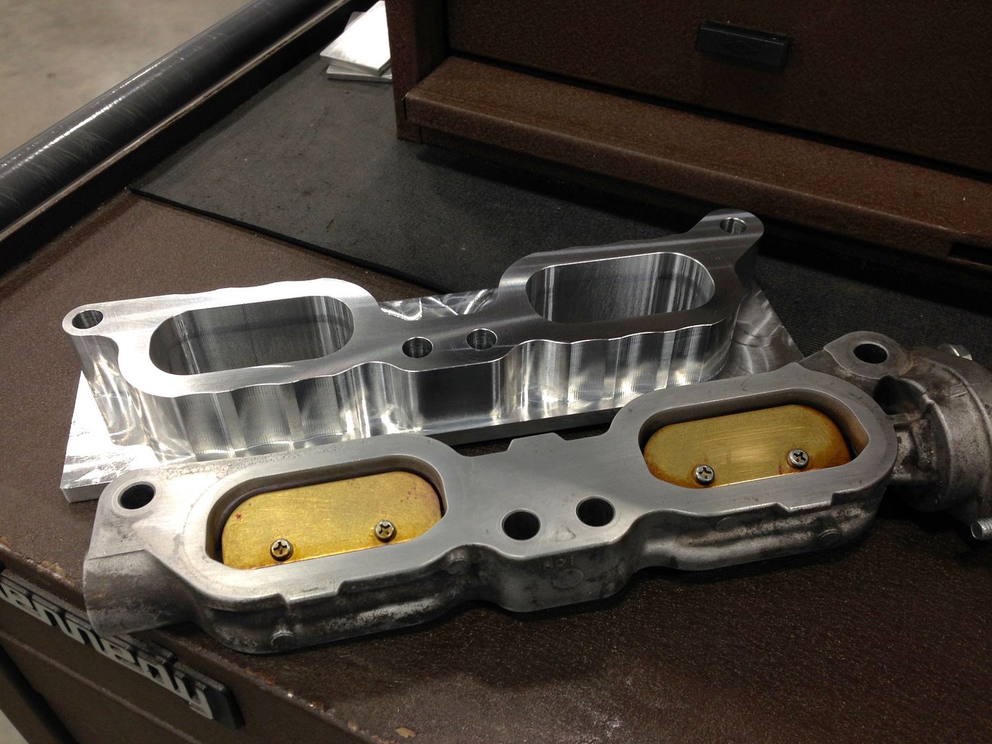

    The FA TGV's are coming together nicely!

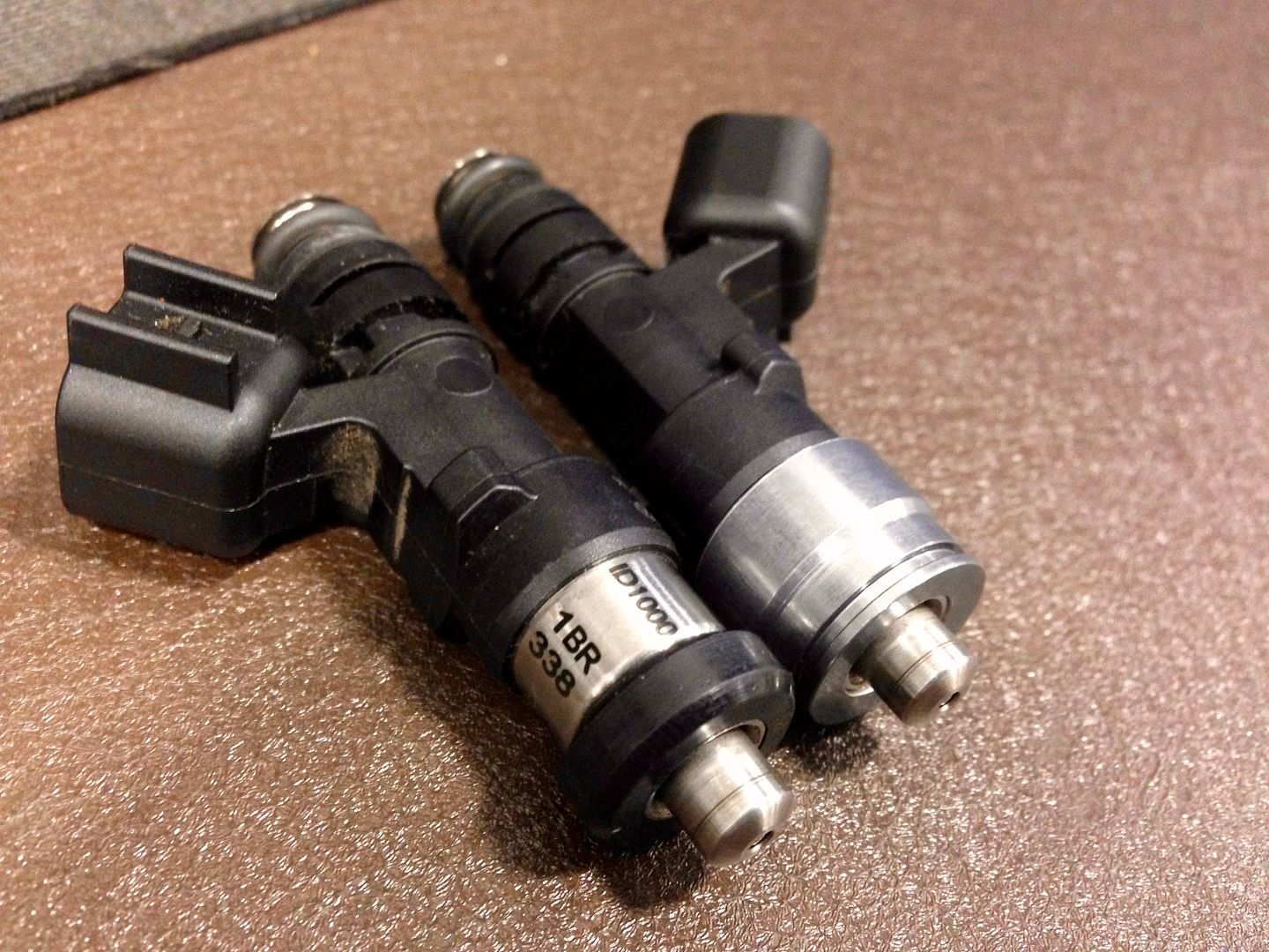

    We purchased adapters to further test injector fitment on the EJ TGV design. They are sealed with an o-ring instead of downward pressure which is great but sadly from our testing they do grow in length by 3.5mm, so washers will be needed (we'll supply these) to take up the extra room.

    That doesn't seem right from what I've heard, when putting them side by side did you line up the bevel on the adapter with the bottom of the original (slightly squished) square bushing, because that's how they should sit in the bore... With the new adapters the tip of the injector may sit a few mm lower in the tgv, but the top datum should be the same.

    I'm a machinist by trade, I measured a difference and you can see the difference :)
    The invoice from ID, it says height increases by 3.5mm, which I measured.
    Iag knows about it too!
    I can probably modify the adapters to retain the old style height but adding washers is just as easy.
    http://www.iagperformance.com/v/vsp...GV-Deletes-New-Style-ID-Fuel-Injectors-v1.pdf

    I wasn't doubting you, just surprised because that's different than the plan I heard the last time I talked to ID, I'll have to ask them about it sometime. Thanks for the info!

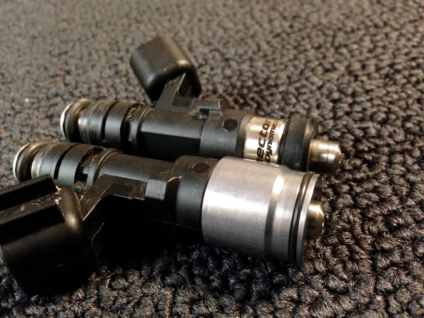

    I modified the adapters supplied from ID and have made them work with ID1000's to be at the same height as they are with square cushions (old style). Soon i hope to confirm things with ID2000's. The overall height of the adapter, thru hole and ID bore depth had to be modified to make it work lol
    I'm thinking about asking ID if i can make adapters that work without using washers under the fuel rails.
    Old vs. New:

    Figured everything out with the injectors. If you purchase new injectors (that come with the new adapters) they are compensated on the injector body to be at OEM height but if you try to use these new adapters on the old style injector bodies, they will require 3.5MM of washers/spacers or modifications on the adapters to get OEM height.

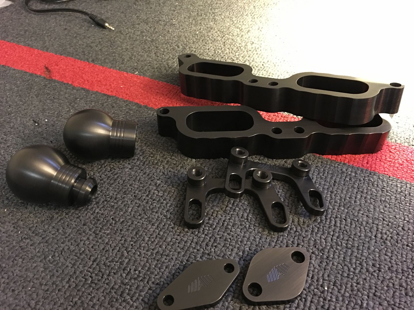

    Just finishing up some things but a lot of goodies are coming early next year.
    2015-2016 WRX Solid Motor Mounts
    2015-2016 TGV Deletes
    Air Pump Delete Plates
    2.5 and JDM (V8,V9) Fuel Rail Adapters
    Short Ball Shift Knobs (5MT Aluminum, 6MT Aluminum, 5MT Black Delrin, 6MT Black Delrin)
