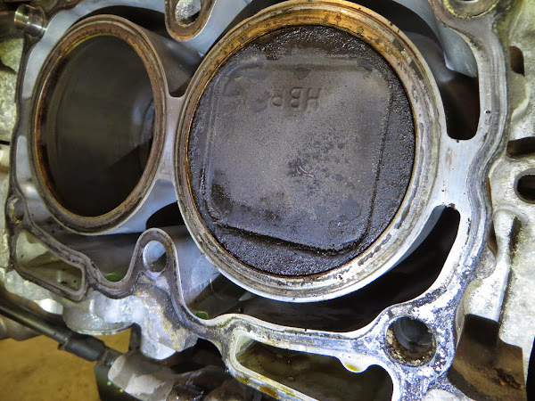

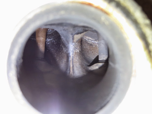

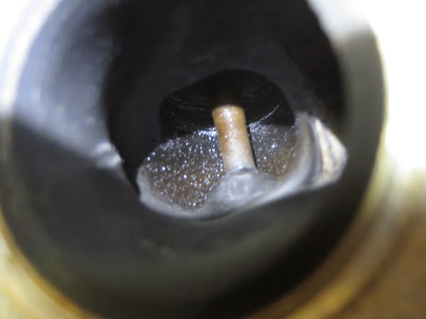

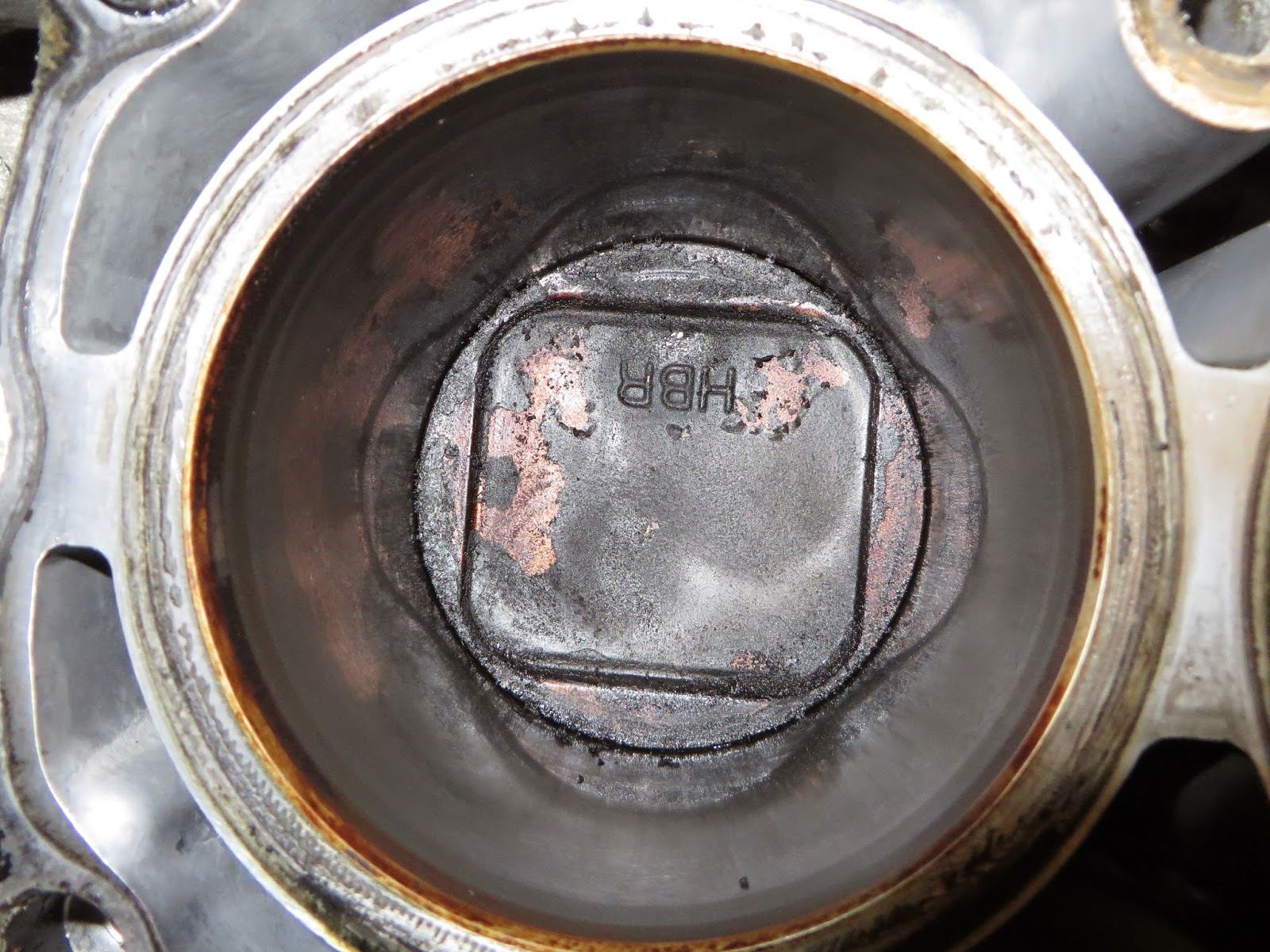

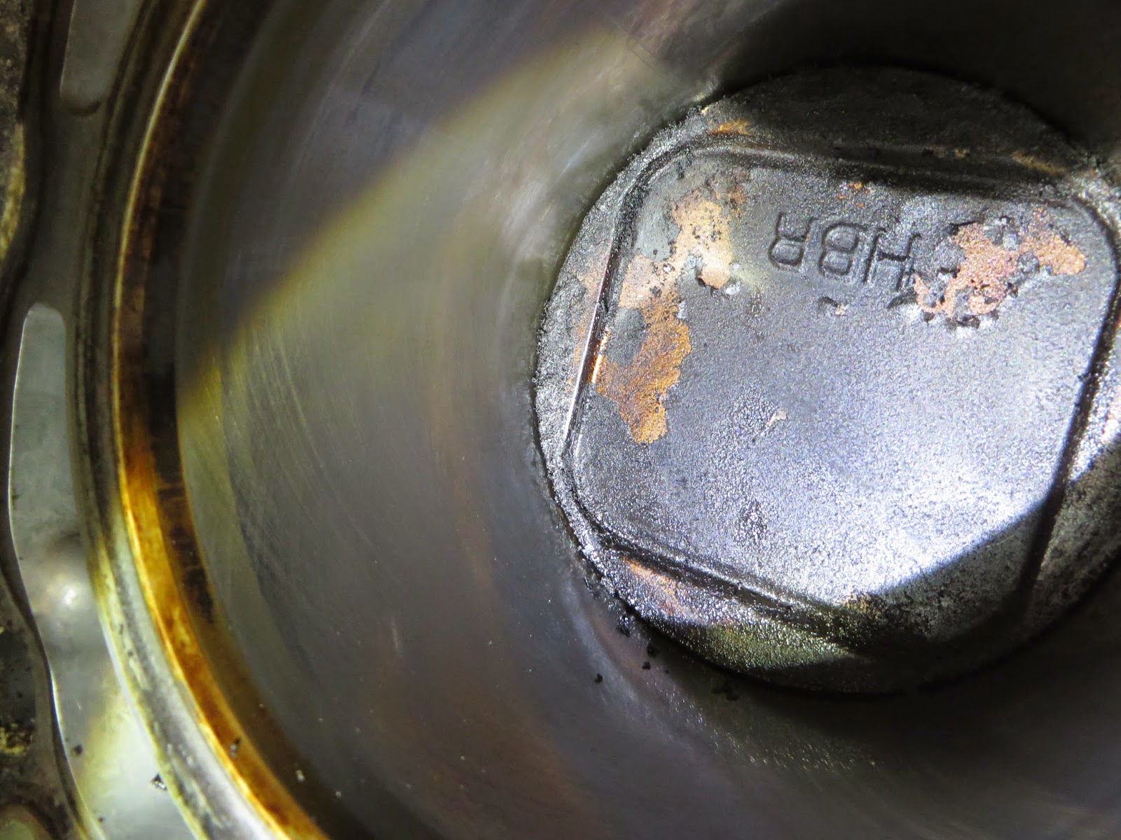

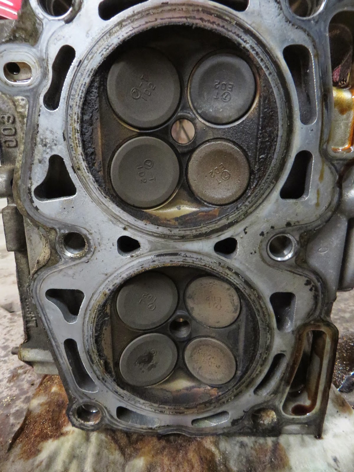

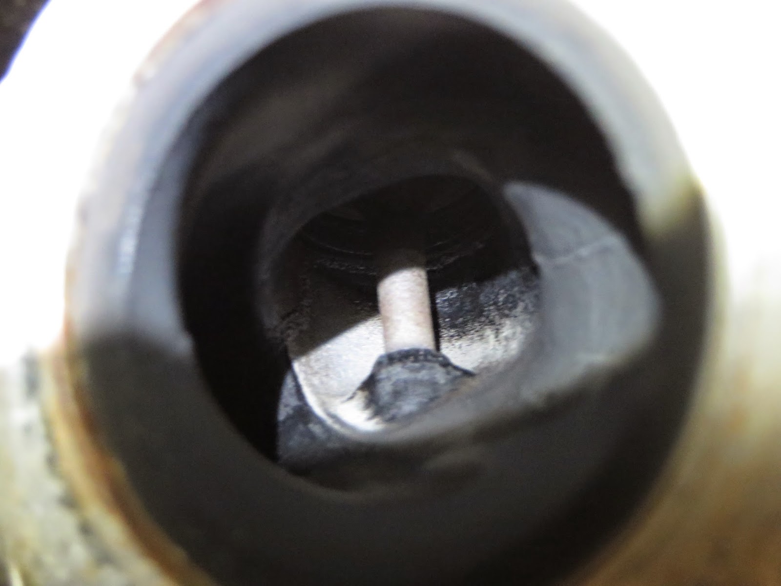

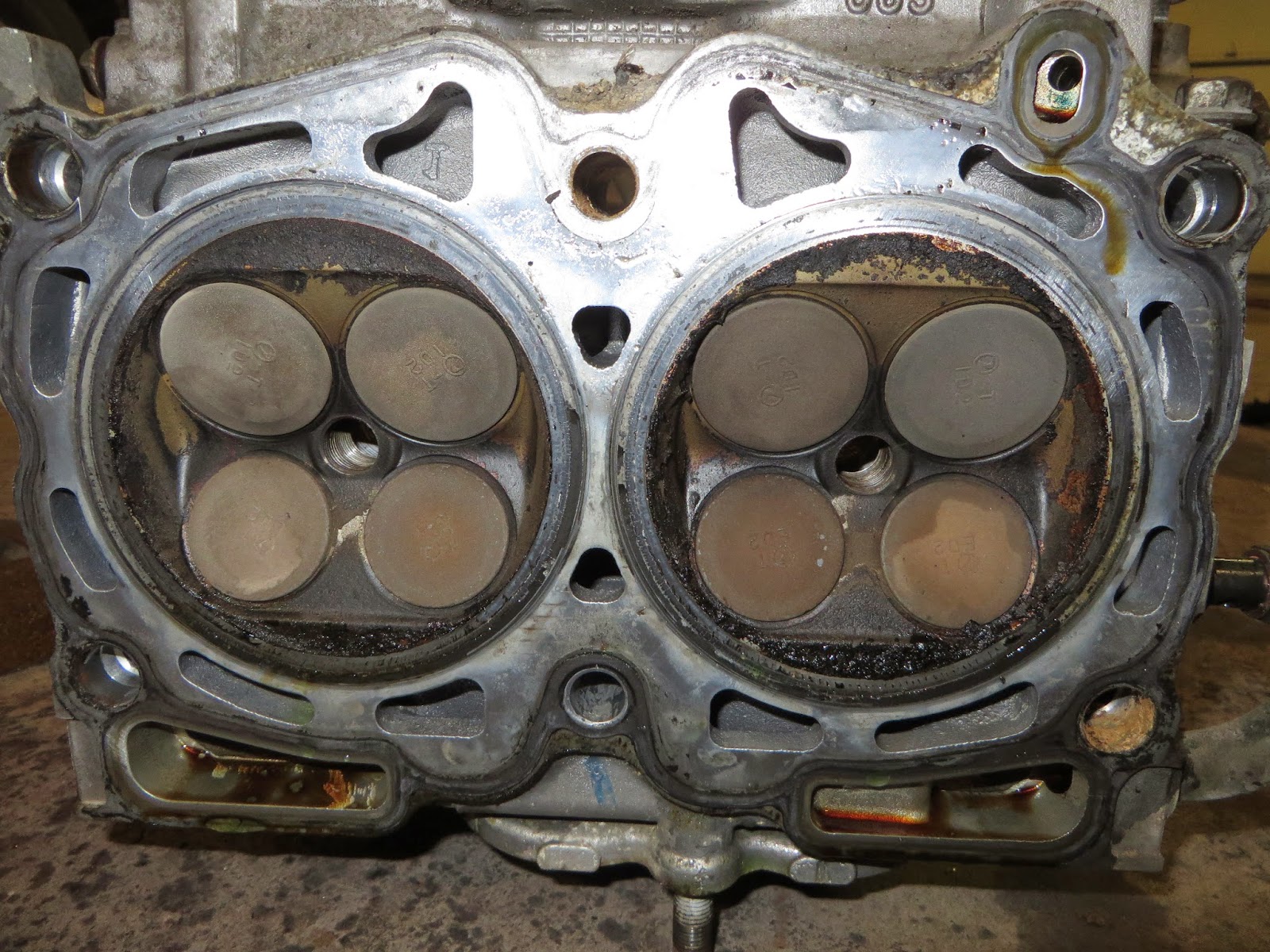

    Update - Finally got some time this weekend to pull the motor and further investigate. Was pretty apprehensive going into it but having the thing out and actually seeing all around it, while also taking it in just in general is pretty cool. Also found my "mysterious" oil leak in about 10 seconds (valve cover gasket). So that's good.
    Anywho, while it wasn't the blatant evidence I was looking for, I'm hoping that you guys will be able to recognize the issue. Pics of suspect area (click for full size if needed):
    Both exhaust valves on #2. The one is obviously discolored, and was sorta wet looking. The other 3 on that side were dry and white-ish.
    Sample of the rest.
    Close-up of the dark one.
    Hard to tell, but the one that was dark on the back was a little darker on the face as well.
    #2 hole. Seems legit minus some carbon build-up.
    Another shot of #2.
    Face of #4 for comparison. Disregard the little scratch mark, I was using a piece of wire to follow the piston up and down while troubleshooting previously.

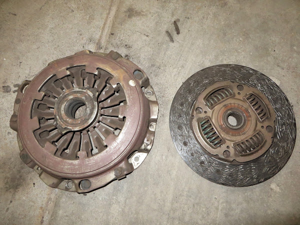

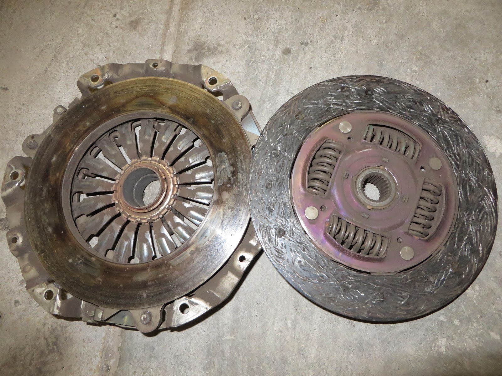

    Don't know much about clutches, but would I be stupid to NOT put a new one in at this point? 150k miles right now.
    If so, what's a decent daily driver clutch kit gonna cost me? Quick search via RockAuto yielded about $230-ish.
    Thanks all!
  15. idget
    Nice work. You're mostly past the hard part.
    Do that starter fluid test I linked to. Guessing that wet valve will leak quite a bit.
    The clutch disc looks like its running out of life and the pressure plate is definitely hot spotted. Pick up a stock replacement kit ($250-300ish for clutch disc, pressure plate, and pilot bearing) and an oem throw out bearing. Get the flywheel turned as well.

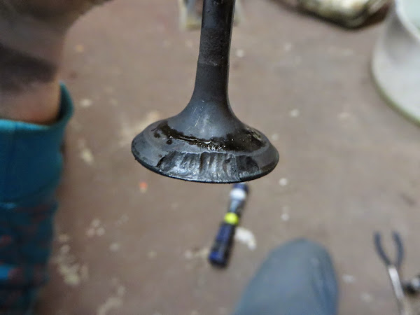

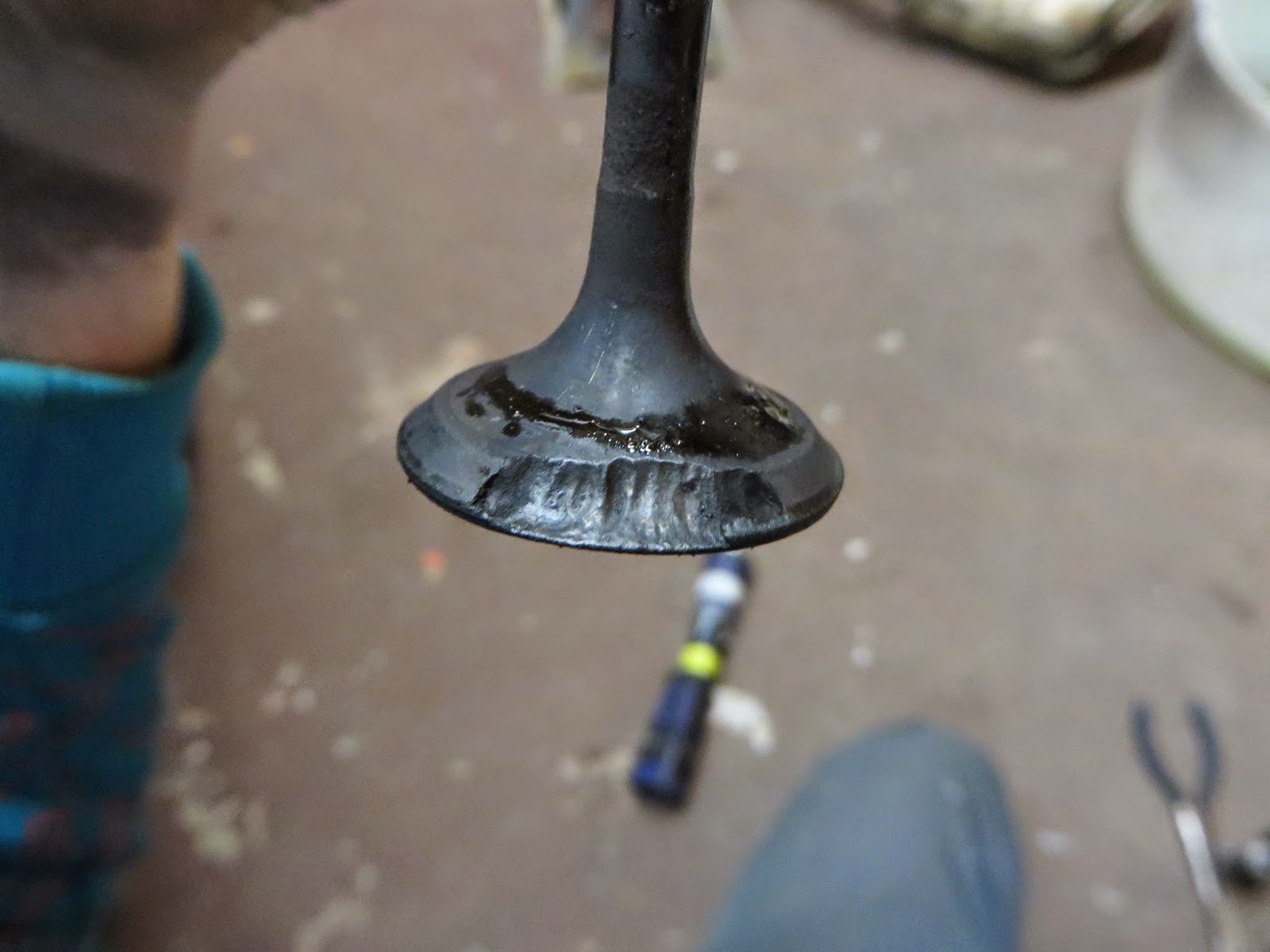

    Took the exhaust valves out of the left head this evening. Perhaps one of the rare instances where the cat in the uppipe actually saved the turbo... Here's the front one from #2:

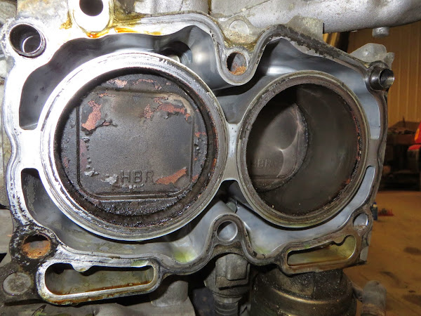

    Pulled the right head off as well. Didn't take valves out as they appeared to be decent on the surface. However, there seems to be a ton of crud/carbon build-up.

    Yep, there's your problem. Like I suspected. Glad you got it figured out.
    Exedy is fine for stockish power. Drives nice. Cheap. Reliable. Long life.
