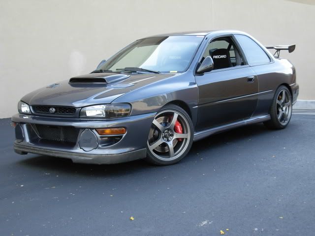

    Some of you may remember my project "Sarah" thread I had on here a few years back.
    I ended up buying Wiggle_Puppy's swapped GC8 that was/is in dire need of work. When looking at it to buy it I determined it has TWO parallel wiring harnesses from the guy that swapped it before him. The parts on it alone were enough to make me interested, I wasn't really interested in the swap quality. Wiggle_Puppy was super nice and pretty much laid it out how it was, I have yet to find a surprise with the car.
    With all of that said, I need a "winter beater" as I just put $11k into my Evo X to get the engine built/tuned at RS Motors. It's pretty low so I don't want to drive it in the winter, plus I like being in more control of the AWD system and not having the AYC do everything for me.
    The car as it sits:

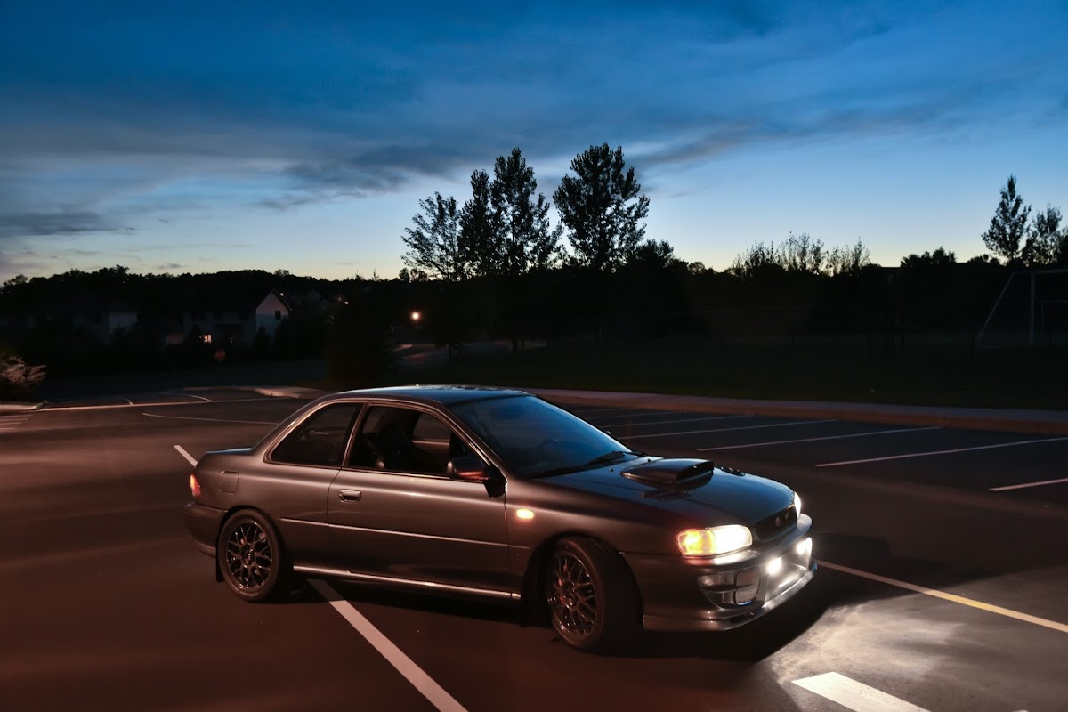

    The moment of purchase:
    New body, waiting for paint.
    As she sits:

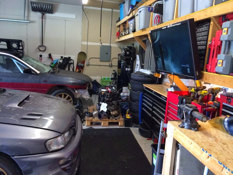

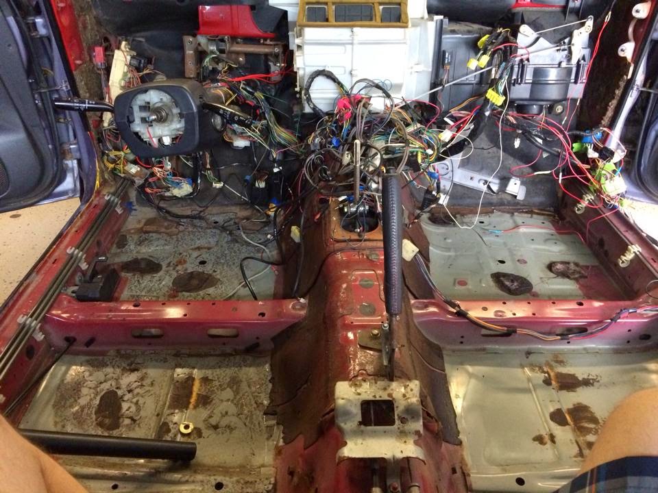

    Got a decent start on the car today. I had 22 hours into insulating/sheet rocking my garage where I thought it would only take 10 hours... so that was awesome.
    Late last week I got these things in my possession.
    1. The EJ207 I ordered, came perfectly fine and looks damn near new. (Also came with the VF37, JDM ECU, STI TMIC)

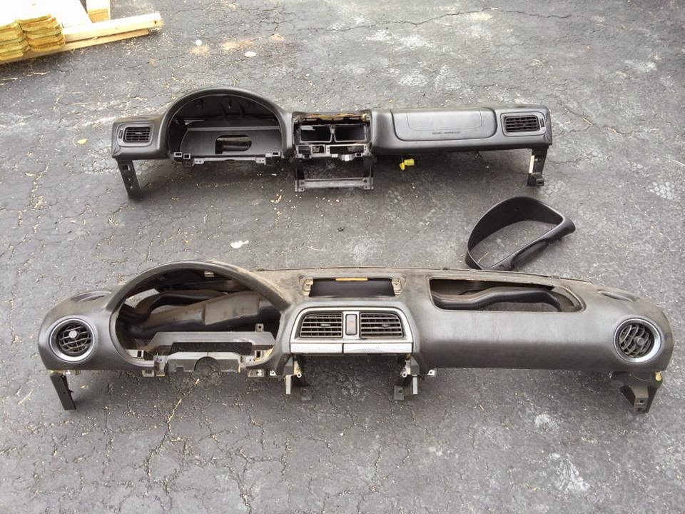

    2. 02 WRX dash, dash beam, wiring harness, steering wheel assembly, pedal assembly, brake booster, heater core/blower motor, etc.
    3. 06 Evo IX Recaro seats

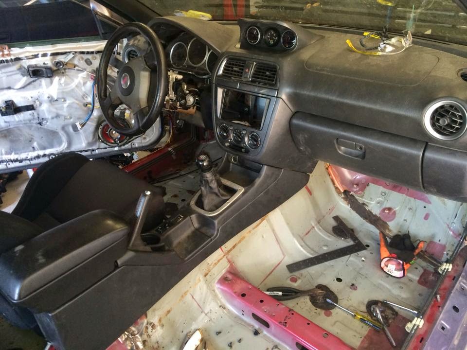

    I started the project today and got pretty far on it. Firstly I found out the transmission on the car at some point exploded around the drive shaft assembly and totally messed up the chassis. I'll have to re-weld a new plate in it's place. But apart from that, it's going pretty smoothly. I got the interior 90% out and took out the floor pan's sound deadening. I also removed the front facia and also took off the fenders in preparation of taking out the terrible wiring harness. Below is what I have so far.
    Right before starting:
    Recaros
    Interior as I was brake cleaning the tar left behind from the sound deadening
    New Dash vs Old Dash
    Exterior currently
    Another note is the new Dash shaves off 10lbs because I removed the air bag and the sound deadening alone on the floor pan was about 9.5 lbs. So I'm close to 20lbs lighter on the car and I've just started!

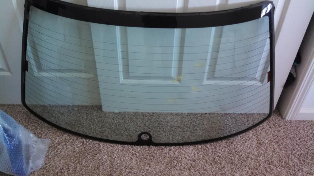

    The other news is over the weekend I've found a JDM rear window with the entire assembly. So I'll be purchasing that tomorrow, below is the pic sent to me.

    4. Got my rear JDM window/wiper assembly paid for/ordered

    Wiring harness out now, JDM lightweight beam test fitted. See the hole on the bottom left in front of the wheel well? Ugh I need to either buy a welder or take this to someone, this is where the guy decided to run the FMIC piping.
    Another pic of the interior, but this time without wiring! Notice I'm putting blue tape on all the grounding points, it's more important than you know.

    Thanks for the kind words man! The car was/is in pretty rough shape. I should take a moment to call out items that are crazy to me about the previous build, for the readers entertainment.
    1. The car had NO front fender liners... none.
    2. The above wouldn't be so bad if there was a grommet where the (what I call) main power harness came into the cabin. That being the one behind the DS fender.
      Imagine: You're driving in the rain/snow and the front wheel is slinging water up (due to #1) up and into the cabin along where the main power comes into the cabin fuse box.
    3. In the transmission tunnel, there's a huge tear in the metal. It looks like the center diff exploded and the driveshaft started flying around. The owner didn't feel the need to fix the hole even though it looks like the side of the Titanic.
    4. The main radiator support has been pushed up, looks like the bottom hit something.
    5. The bumper was zip tied to the bumper beam, which is cool I did the same thing on my IX but the zip tie job actually broke/hurt the bumper in the middle.
    6. We all already know the issue with the wiring harness, it wasn't as bad as I thought but it wasn't the greatest either.
    Things I've decided to do to fix the above issues.
    1. This one is obvious, I'll probably pull them off of my other GC8 project.
    2. New wiring harness has the proper grommet in place, I'll also be welding/shaving other unused grommet holes in the firewall then sanding/treating/painting the firewall satin black.
    3. I plan on welding a new plate in it's place, after the fact I will be POR 15ing the entire cabin's floor pan/firewall. At the same time, I'm doing some very minor seam welding while I'm in there. This is a Daily Driver so it'll be to just refreshen the chassis since it has around 145,000 miles
    4. I'm honestly not sure on this one... it's not terrible, but it's also in need of repair. I want it to look stock when it's done so I may need to figure something out.
    5. Already purchased a new bumper and have the JDM bumper beam installed.
    6. New 02 WRX wiring harness, which will be mated with the AIP AVCS kit to utilize the EJ207 heads, you know the rest from the top post.
    All in all, everything is going ok. It could be smoother, but I also would have paid a lot more money for a cleaner chassis. Parts are starting to trickle in and things are starting to come together. This weekend will be prepping the engine bay/floorpan for painting, fitting the GD dash and welding the tunnel. Accompanied by a lot of sanding/grinding and sweating... and cussing.

  35. DoughtCom
    DoughtCom Well-Known Member
    236
    Thanks Boone, I worked a lot to make the garage what it is today, it seems to have paid off!
    I didn't post any updates after the weekend because I had an accident occur. Long story short I coincidently bought new safety glasses, used them and then took them off during cleanup. Went to unplug a grinder and had the extension cord slingshot into my eye. I can't explain it... it's the weirdest accident I've ever had, it physically doesn't even make sense. I basically went blind in the eye, had to go to the ER and have had eye doctor apts all week while slowly regaining eyesight. It sucks.
    This was my eye tonight.
    I'll post some info about the progress last week. I made quite a bit of progress, but I'm obviously behind now. I was hoping to be putting in the wiring harness by now, I haven't even started splicing it yet. :(

    3. I test fitted the dash and dash beam. 05 STi dash, '02 WRX climate control area, 04 center console with V6 mirror controller (it fits!). I also did things a little different than last time and from what most people do. I decided to roll with the old GC8 heater core/blower. I hate cutting new holes in chassis, so I wanted to see if it was possible to make it work. I'll do a writeup later of my findings.

  44. DoughtCom
    236
    Thanks a lot man! My eye actually works as of today!
    I made some incredible progress this weekend. I worked for basically 17 hours straight on the car yesterday with the goal of not stopping until the interior was in and everything was plugged in/spliced. This is where it's at tonight along with the trunk being POR 15'd and the other hole in the engine bay being welded and ready for body filler.
    Almost ready to fire her up :)
