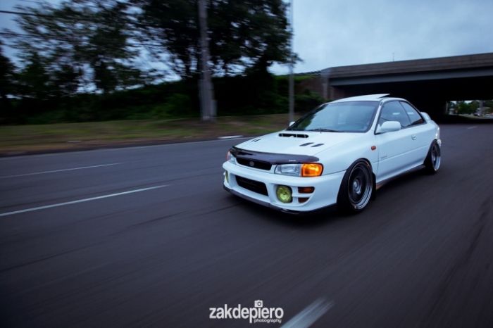

  31. DoughtCom
    DoughtCom Well-Known Member
    236
    You guys don't like bug deflectors?! I happen to think it adds some hawtness, but I guess to each his own. The main thing was rock chips though. Someone on facebook already pointed out it kind of negates the purpose of a hood scoop, I tend to agree.
    I think it will look better once the car is painted it's lighter color.
    Ntxhuav_Khang and EricS like this.
  32. Curry
    Curry Well-Known Member
    906
    What a dick...
    I don't think it looks bad, but I think the contrasting colors on the white car looks a lot better. If the bug shield is the only thing I have to unbolt when you sell this to me for 1/10th it's value, I won't complain (too much).
  33. DoughtCom
    236
    Haha, it's only two bolts, so that's the good news!
  34. Curry
    906
    TWO BOLTS!? alright, 1/20th the value it is...
    This car makes me excited for the world, we need more clean GCs.
    DoughtCom and EricS like this.
  35. EricS
    EricS Nooberator
    Sorry Curry, this cold must be making me even more of a dick than usual today :)
  36. EricS
    EricS Nooberator
    Alright it's grown on me, sorry for being a dick DC! I think I just had a gut reaction from being used to seeing them on cars/trucks that are "accessorized" with every single part available from the PeP Reilly's aftermarket aisle :p
