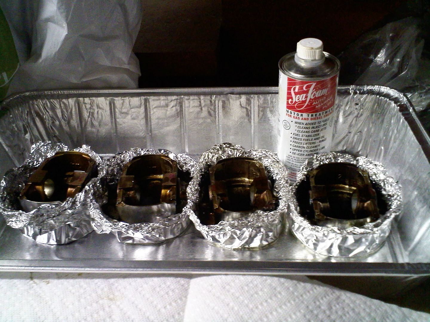

    So much carbon build up on the ring lands... ewwwWW new rings going in. Should I bake it?? lolz It'd stink up the house if I did... lolz!
    I was like.. spray it down with carb cleaner??? But I figured I'll soak them in Seafoam to see how well it works. I've never tried it, just heard a little. Hopefully the carbon comes off. They sat since last night. I'll go check on them in a bit.

    I soak them in carb cleaner overnight and then scrub them with a toothbrush. Worked great last time.
    Are you sticking with OEM 22T pistons? :ugh:

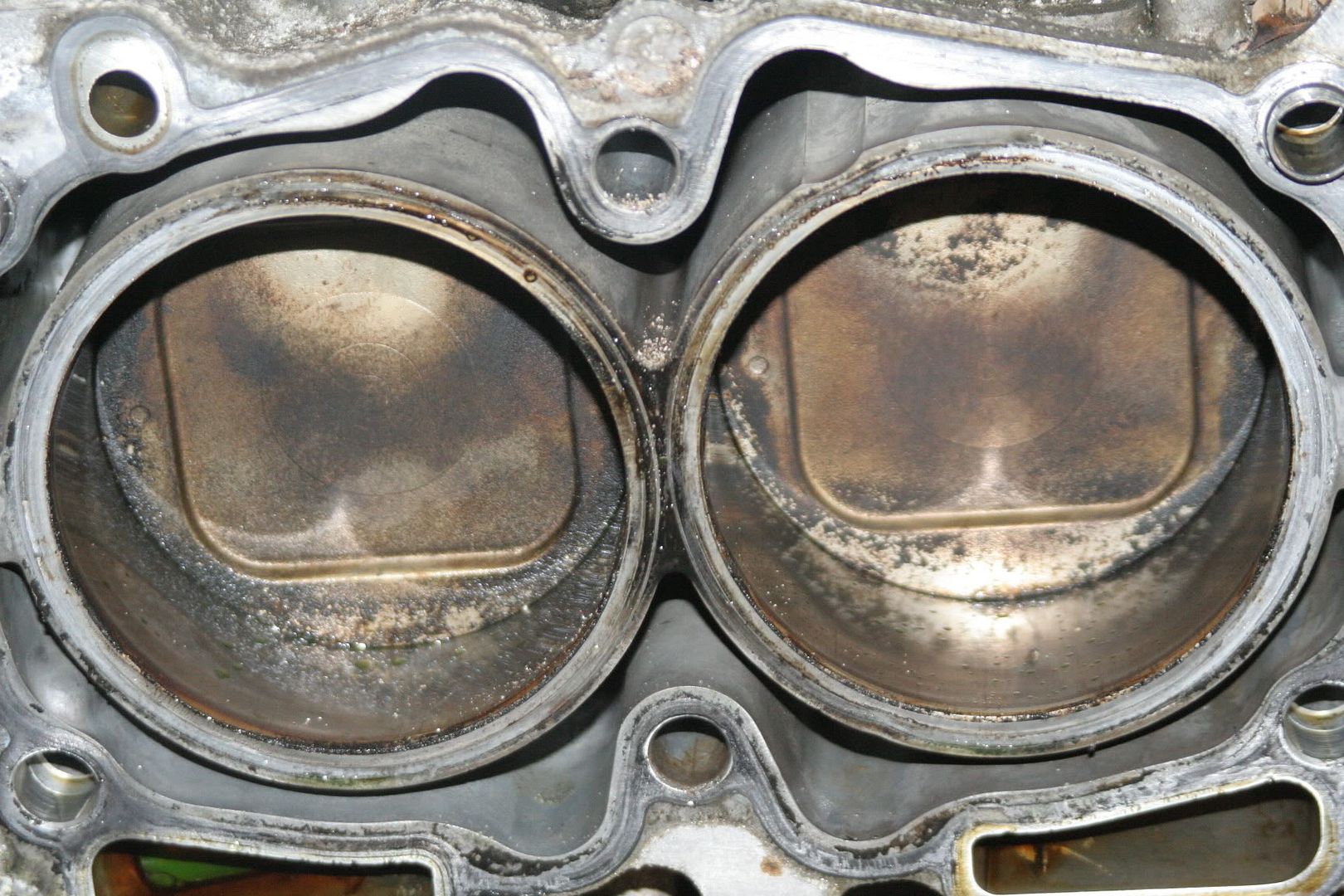

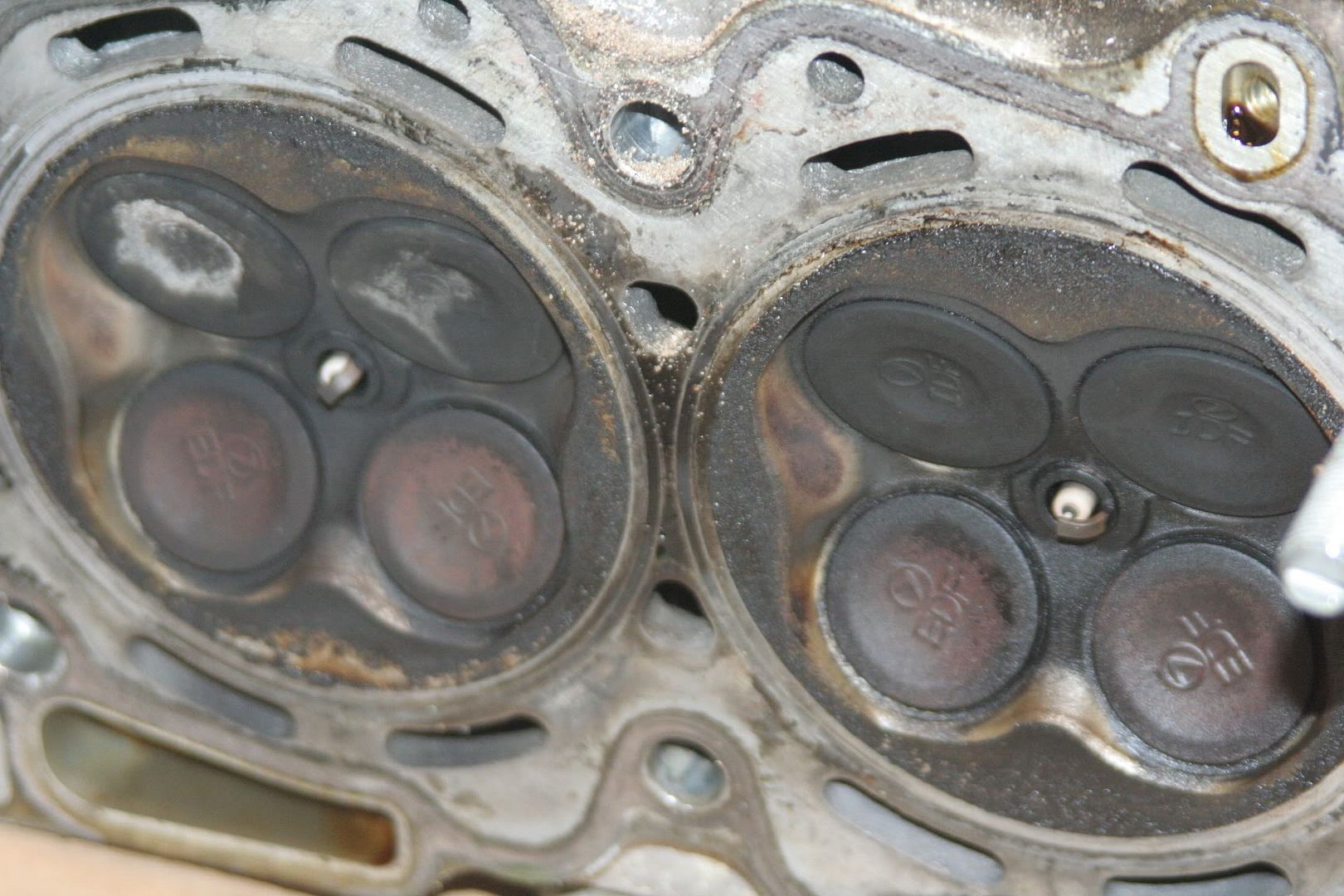

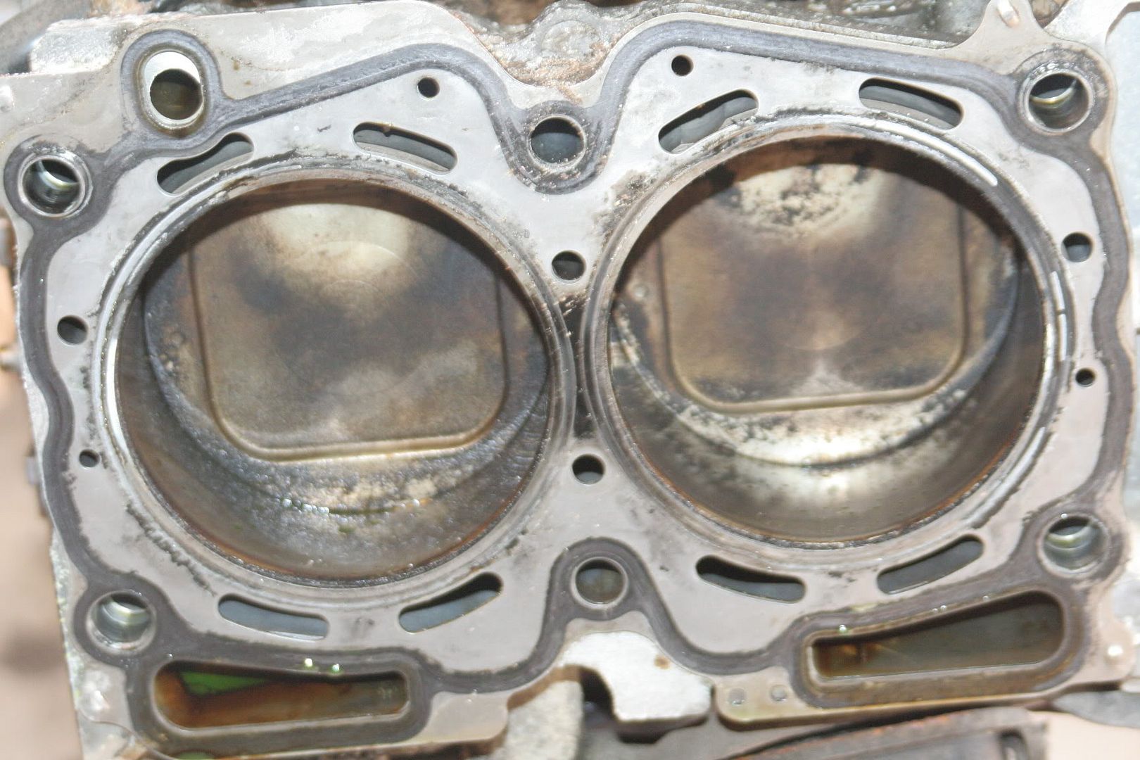

    The rebuild on my Dad's '98 Outback:
    resurfaced heads and block decks w/ fresh cylinder hone
    NEW ACL Race bearings
    NEW Std rings
    NEW seals/gaskets/o-rings
    NEW OEM head bolts

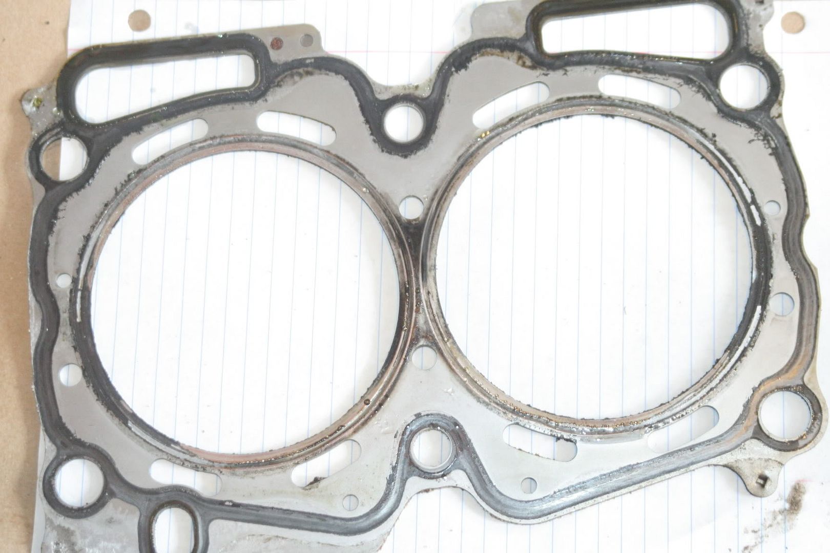

    NEW HG '98 2.5L DOHC
    It overheated and blew the HG between cylinder #2/4. Changed it once but didn't resurface it. Now it warped the head and the block deck. You can see the dark spot. The pistons did get steam cleaned though from the coolant. lolz
    here's what it looked like when I opened the motor.

    So how are you planning to help clean the valves?
