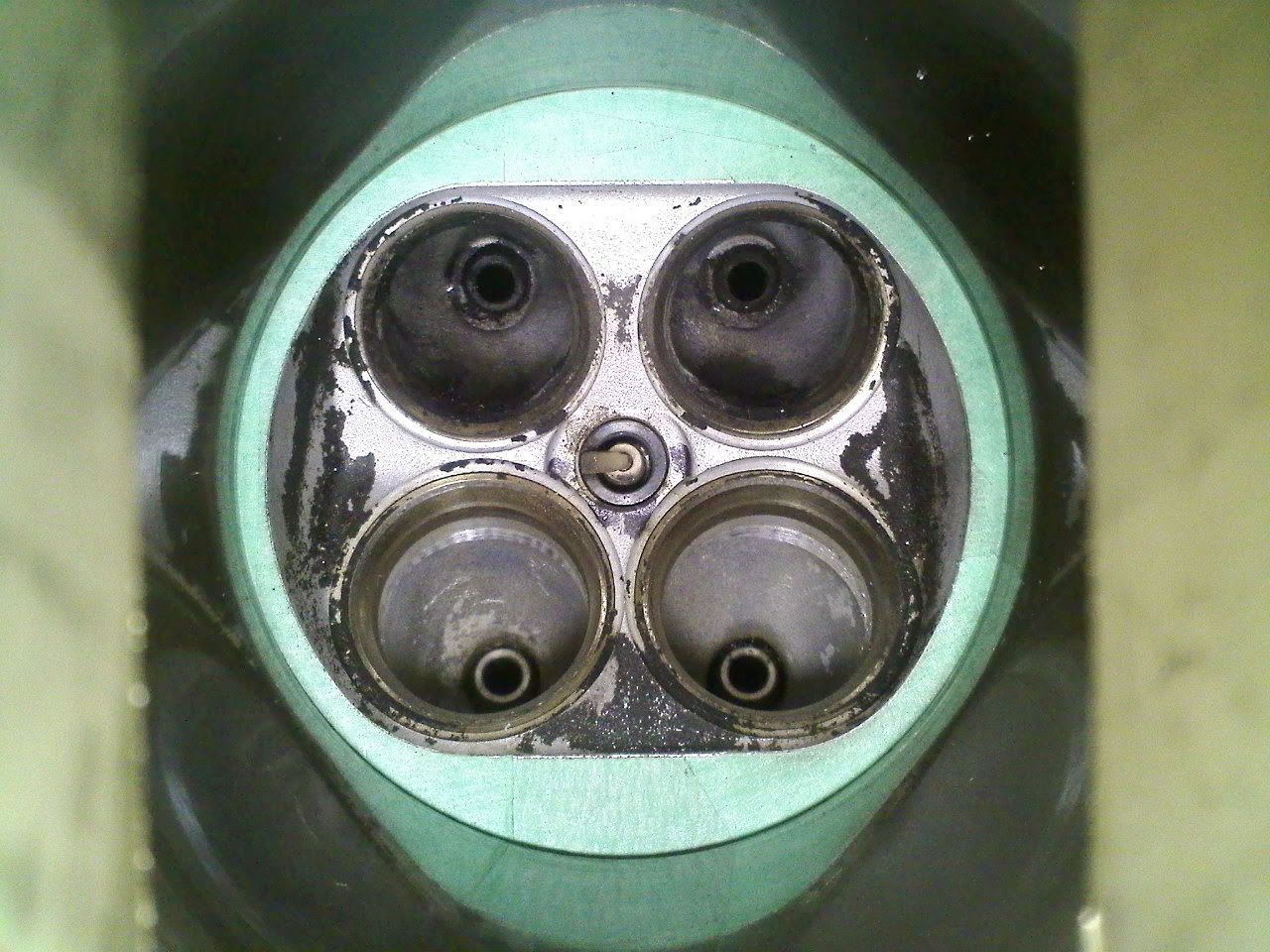

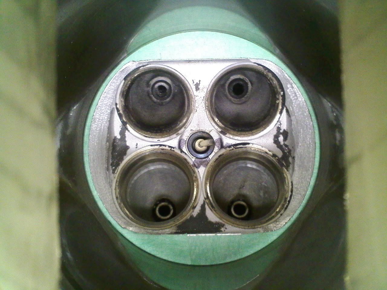

  14. FuJi K
    If the engine was one that had a blown HG and overheated or have overheating problems, I will have the heads and block decked. If it doesn't I will inspect the heads and block. I don't really like to deck it if I don't have to.
    However if you're talking about chamber work, a simple widening like what I've done with then; 50cc after will allow the heads to let air out of the engine. I did this with (Dynapar) Martin's 2.2L build with the EJ205 heads. Much better flow around the valves. He also has some head work and cam to complement the port work. There will be no hot edges with this modification.
    Here are pics of Martin's heads. Chamber and pic of it on a 2.5L block.
    Stock head on 2.5L bore
