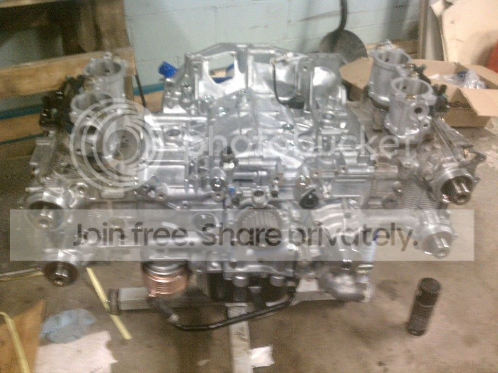

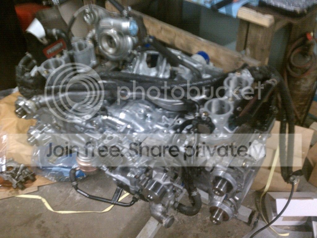

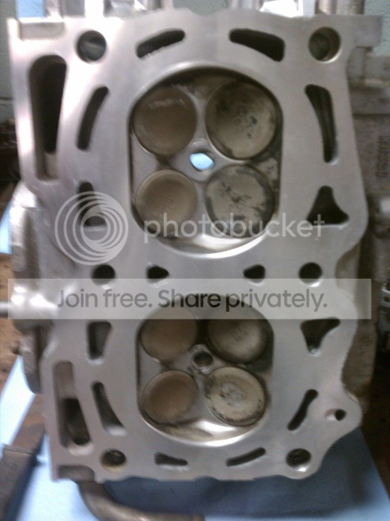

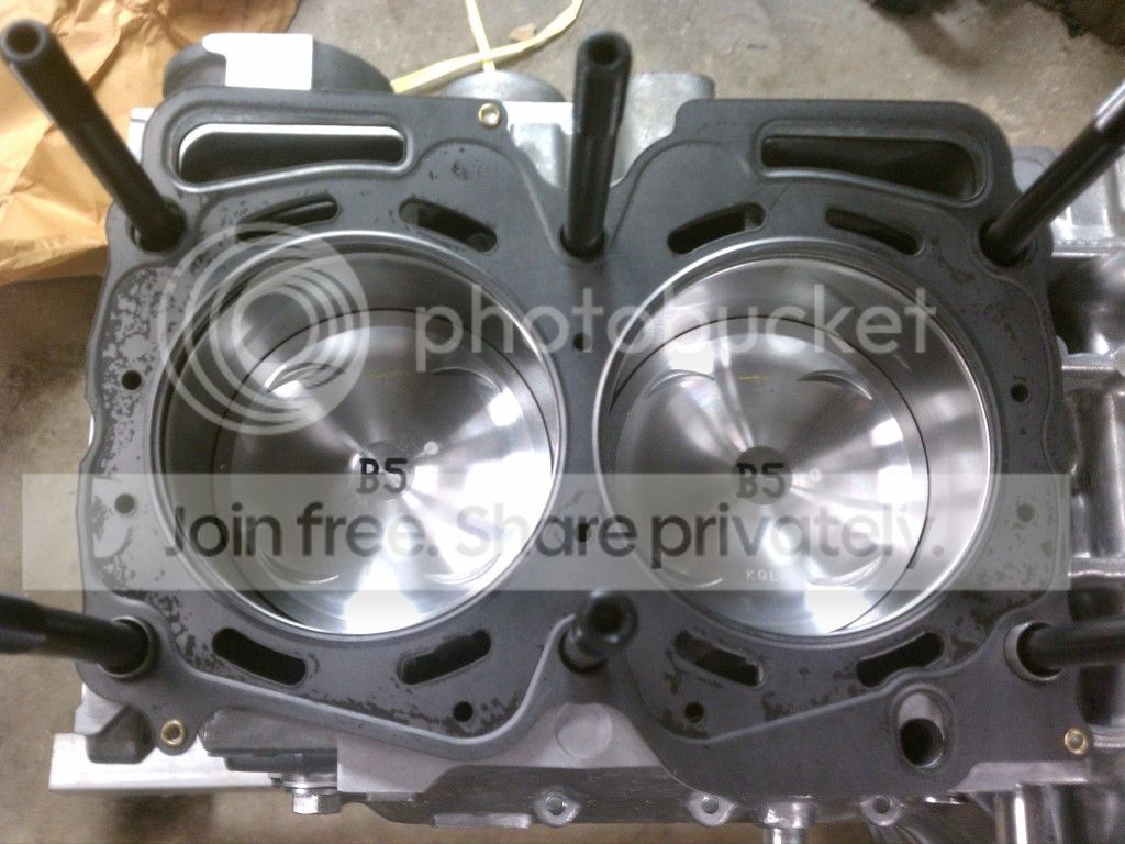

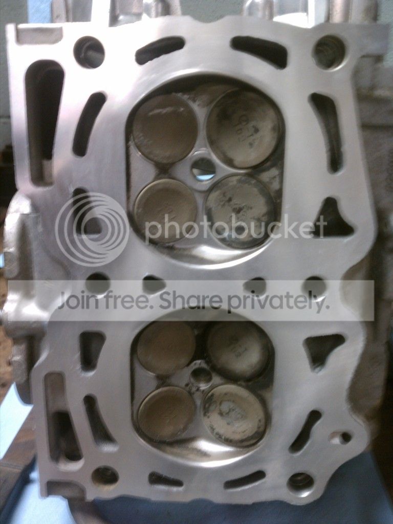

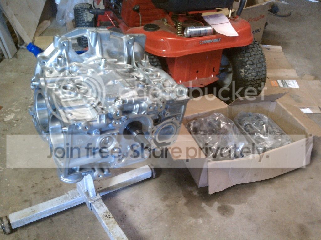

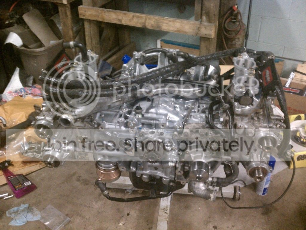

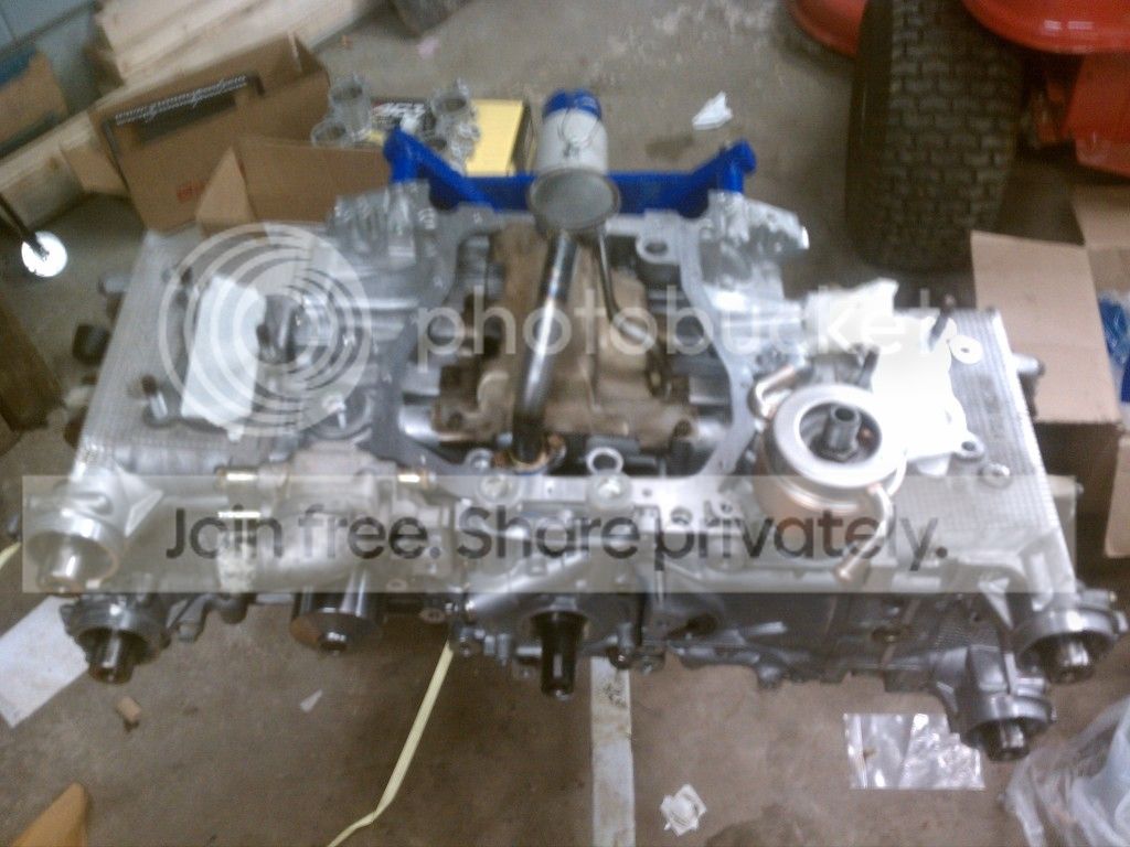

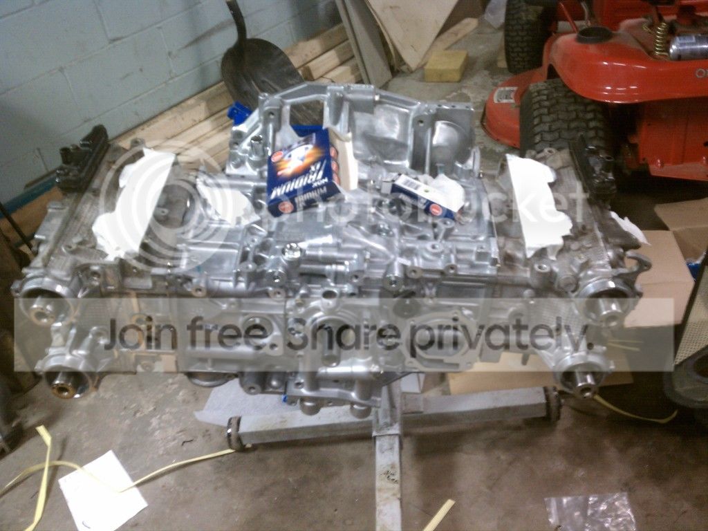

    Figured I would throw up the pics of the reassembly just incase anyone was curious![​IMG][​IMG][​IMG][​IMG][​IMG][​IMG][​IMG][​IMG][​IMG][​IMG]

    The biggest note to take is the combustion chambers, I didn't do anything radical as my goals didn't involve running lots of boost. Basically I just smoothed the sharp edges of the combustion chambers where the new 2.5L cylinders exposed what used to be the mating surface of the head. All this does is prevents hot spots from forming and causing detonation.
    20/20 Hindsight I would have gone with forged pistons so I wouldn't have had to worry about ring land issues with the stock STi short block. Also I highly recommend having oil temp, and pressure gauges. With the smaller oil capacity of these motors, its a great idea to keep close watch. Also I would have gone with a stock clutch and flywheel, IMO the Fidanza was far to light and made the car hard to drive in traffic, and difficult to maneuver in tight quarters with out slipping the clutch. You also have to remember that with the little mass that the clutch will over heat very quick!
    All said and done I don't have any regrets going the route that I did.
