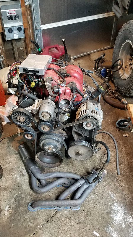

    Pulled this out of my '87 4Runner. Engine and transmission originally came from a '92 S10 Blazer, it had hit a deer, and already been partially parted out when I got it, and didn't have a gauge cluster. I was told it had about 150k miles on it. This is the Central Port Fuel Injected, early "Vortec" 4.3. And 4L60 transmission ('92 means non-electric, identical to 700r4, but technically called a 4L60).
    The good.
    Great compression, no knocking or anything like that. I took a couple videos of it running the day before I pulled it out. I also have pictures of the compression tests from the last time I was messing with it backed up on my desktop.
    I've put maybe 1k miles on it since I did the swap 8 years ago.
    LOTs of new parts, oxygen sensor, spark plugs, timing chain, HD water pump, serp belt, A/C bypass pulley, idler pulley and fuel lines in the manifold all done with the swap. Since then, new coolant temp sensor, injector "spider" assembly, distributor, custom MSD plug wires, IAT sensor, etc.
    Advance adapters transfer case adapter, motor mount adapters, and blockhugger headers (headers painted with POR15 Hi-temp paint).

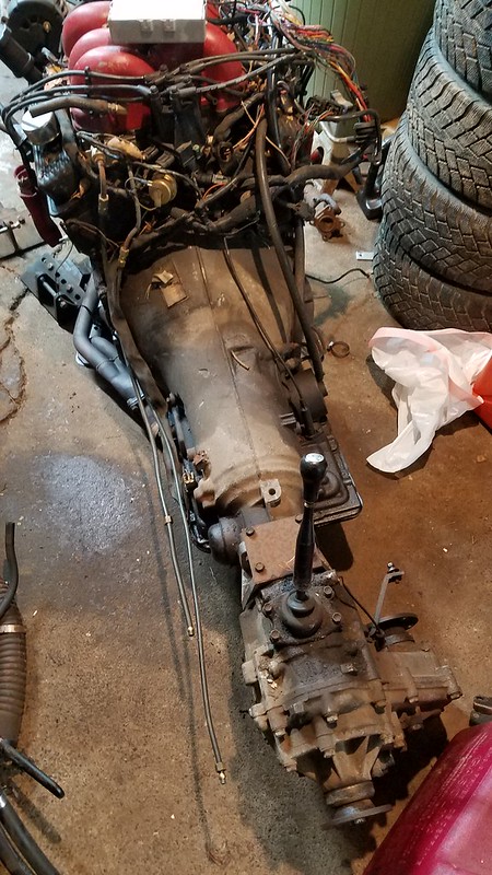

    '86 Toyota gear driven top-shift RF1A transfer case, standard 21-spline input

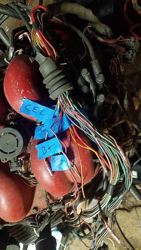

    Wiring stripped and modified for custom standalone installation (I will be keeping my body side Toyota plugs, but I will label the wires before I cut them).
    USB adapter hardwired to view and log ECU data via tunerpro (and the correct definition files)

    Aftermarket (B&M?) shifter cable, with associated bracketry for the transmission side. I'm reusing the body side stuff for my new setup.
    The Toyota tcase adapter required a new output shaft in the transmission, I had that installed at a transmission shop, and he replaced several parts as needed when he had it apart. Not a full rebuild, but should be good for many miles.

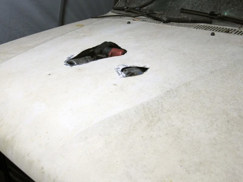

    This will all bolt right into an '86-'95 22R/E/TE truck or 4Runner. To use the motor mount spacers, a 2" or more body lift is required. With this, the oil pan *just* clears the IFS front diff. This could also be done with a bracket lift instead of the body lift, or a custom oil pan. Will bolt into an '84-'85 truck with the solid front axle, but I can't speak to front diff clearance.
    It will not *quite* clear the hood.

    Transmission pan leaks. Had to put a dent in the rear corner to clear the front driveshaft, might not help.
    Shifting from Hi to Lo range in the transfer case is a bit of a dance with the transmission. In neutral, the transmission does put a bit of torque on the input shaft of the tcase, so it will spin and grind before you can get it in gear. Have to put it in park, let the truck roll just enough to engage the parking prawl, but not enough to load up the drivetrain.
