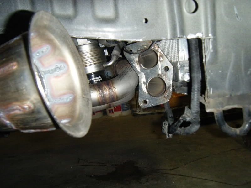

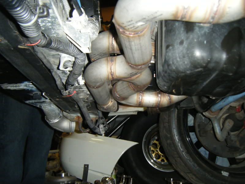

  29. fobiawrx
    fobiawrx Fabiola
    booyah bitches! it fits!

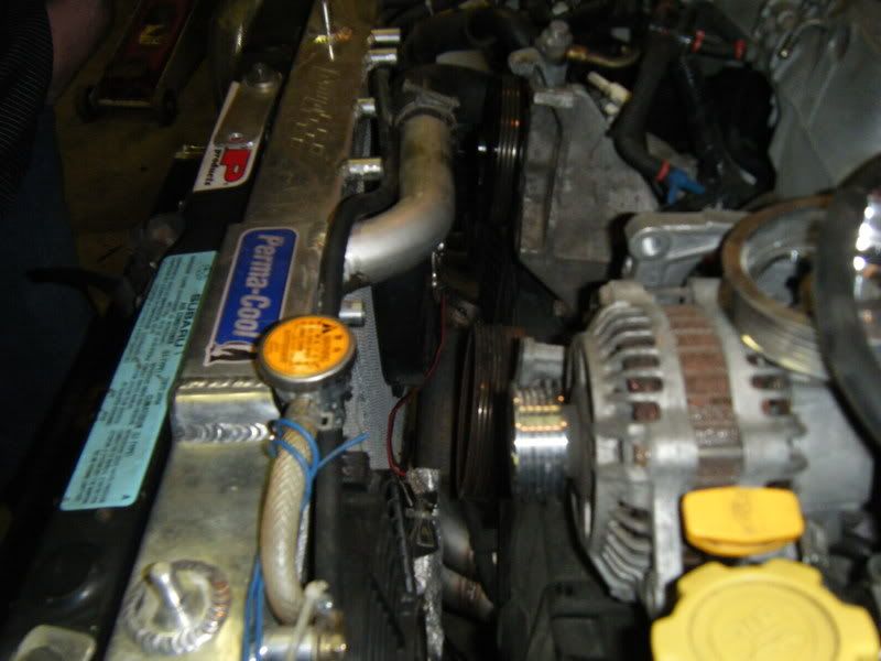

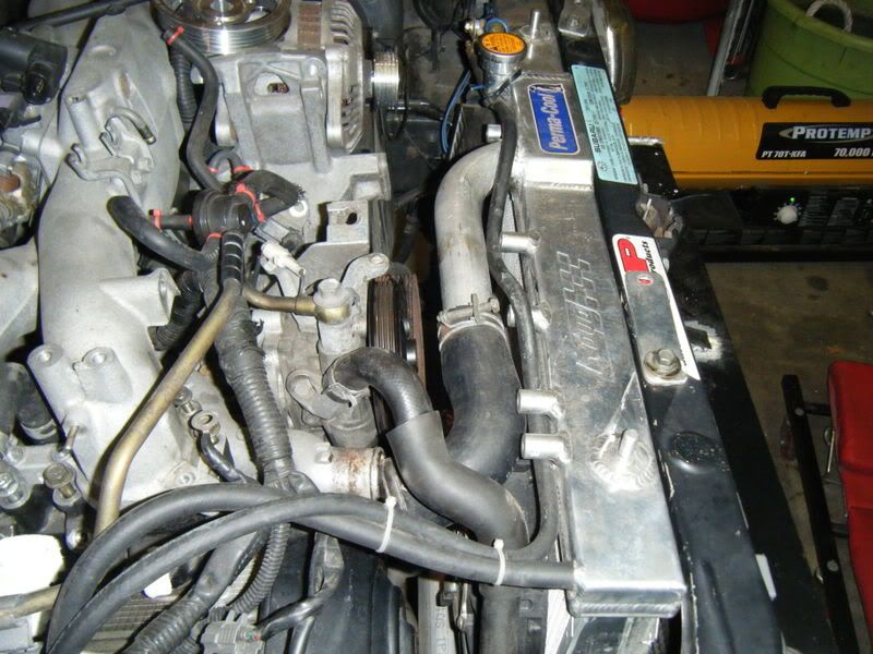

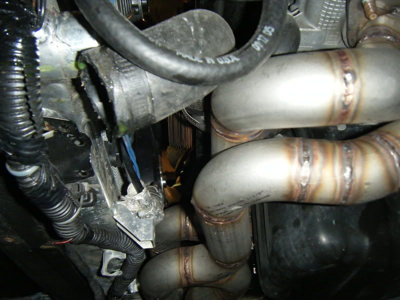

    ok so hear is the deal with the gc chassis. the header fits great on it but hears the deal. with the gc chassis and a koyo you don't have room for the stock fan assembly so you have to run aftermarket fans. and with them it fits perfect once you cut off the stock fan mounts that are on the radiator. pics to fallow

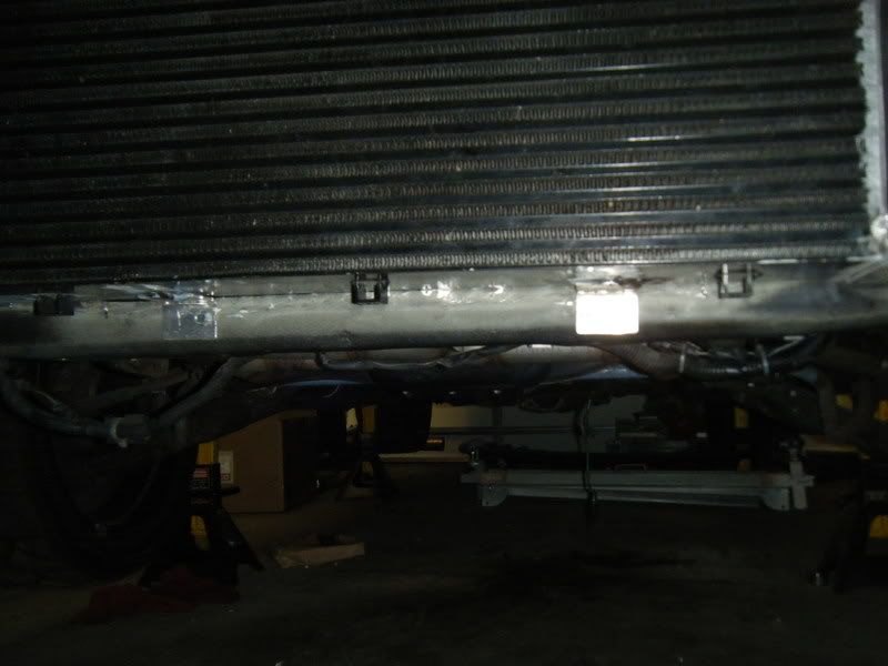

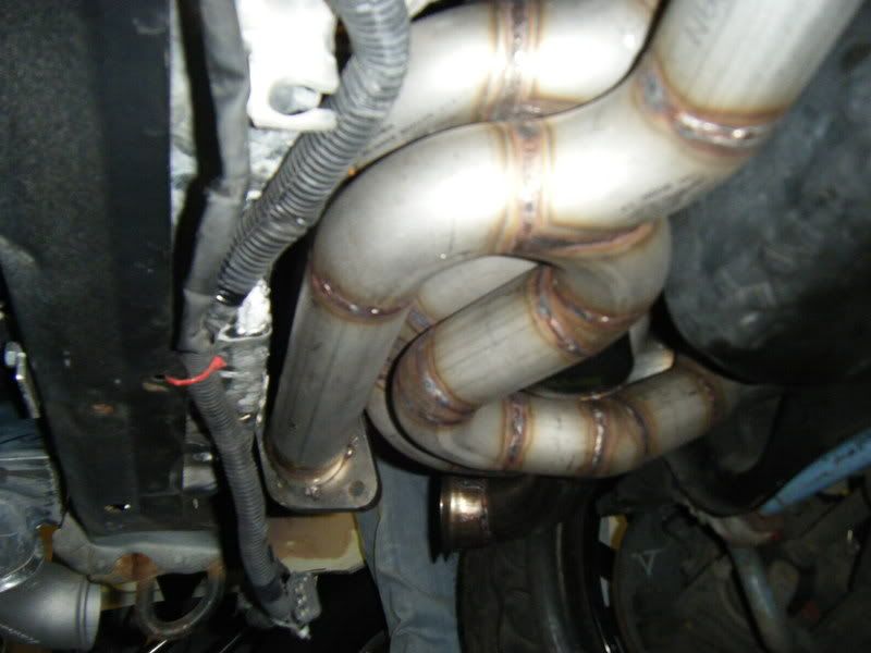

  40. fobiawrx
    fobiawrx Fabiola
    look how tucked up this header is! booyah!
    ready for fog light setup!
    this is how tight this setup is:
  41. AspitFire
    sicko
  42. fobiawrx
    fobiawrx Fabiola
    oh the pics dont show that well but there is a 1/4 of a inch between the rad and the header.
