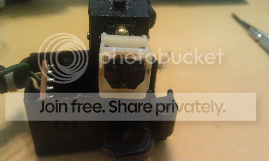

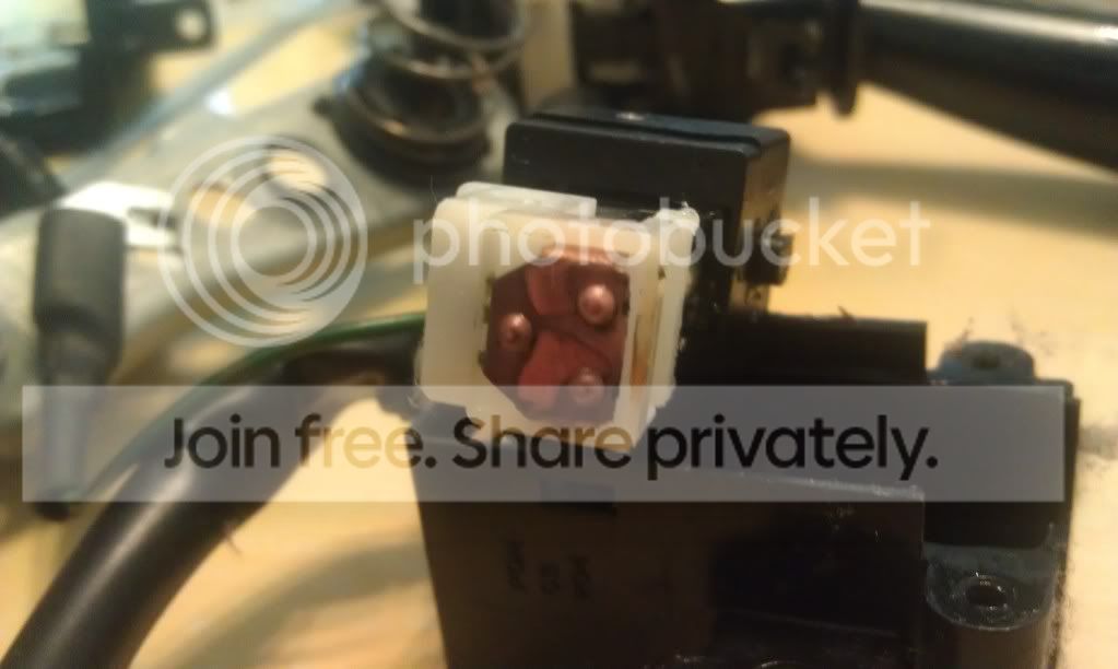

    Well I dug in today. The turn signal switch is just too worn down and will need to be replaced, luckily it works well enough I can just live with it for now.
    The cruise switch seems to be working better after a good cleaning, but time will tell. It was actually very simple to get to and take apart on my outback.

    As for cleaning it you must dissasemble it. First remove it from its mounting bracket with two number 2 Phillips screws
    Next open the case by removing two number 1 Philips screws and by releasing the two small plastic tabs.
    Once inside just lift the lever and switch out and inspect for dirt/damage/wear.
    Clean and assemble just as you took it apart.
    This one was mine, I cleaned it with cotton swabs and everyday rubbing alcohol, remember if you removed all of the grease to reaply fresh dielectric grease.
