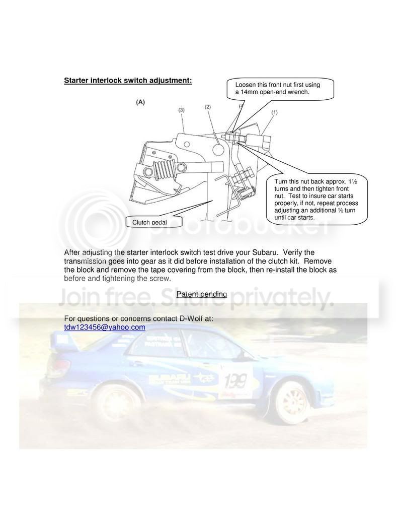

    The starter interlock switch? It's in the install instructions from first post of the second link in my post above:
    The cruise safety switch is separate iirc. So it disengages the cruise as soon as the clutch is depressed (not at the same point as it needs to be to start the car).

    Maybe I'm not understanding your point, but the pedal plate doesn't change the engagement point, it just shortens the travel between "all the way down" and engagement. So, given the same seating position, you would still be "going half way" to engage the clutch, but would not have to deal with the 1" or so of dead space between shifts when you press the clutch pedal and search for the engagement point. You also wouldn't be fully extending your leg, but fully using the total pedal travel (which is now reduced from stock).
