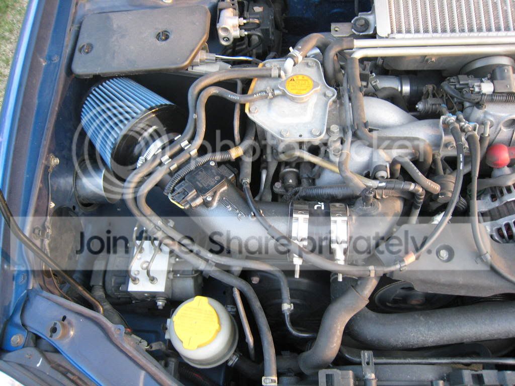

    Can anyone tell me what this is nicely
    when putting on the intake I noticed an aluminum pipe where I thought the plastic snorkus was supposed to be. The car had the stock box with k and n filter. I was wondering if this is some sort of upgrade or what. Thanks, no flaming needed I did not fell like wearing the flame suit today.
  2. Paul Revere
    Previous owners remains to their cold air intake that they never told you about would be my guess.
  3. Ylime
    yes that was my guess as well...wonder what else I am going to find. From half yellow calipers to intake tubes....whats next.

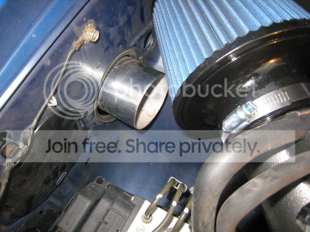

    I'm not sure what you would need to do to pull it out though, oh and did the car come with that plate over the larger hole or was that part of the SPT kit?
  6. Ylime
    you mean the black plastic thing on the side wall, that came with the car. I took that off to get a look at the tube but it was to hard to see.
  7. Scuba Steve
    to really see what's in there it's best to get under the car (jack the front up) and start pulling part the plastic underbody guards (whatever you call them). that way you'll see for sure what's in there
  8. Vector
    Vector Rally Organizer
    416
    Looks like there was a hybrid CAI in there that drew air in fromt he fender well, but used the stock intake filter box. If you take out the fender liner you may discover more.

  10. EggRoll
    EggRoll Well-Known Member
    Take off the fender liner, pull it out like you would the air box.
  11. bhiku
    bhiku Well-Known Member
    If I recall correctly, you could just pull the fog light if all u wanna do is take a look-see. Quicker than pulling all the plastic bits-n-bobs unless you think you'll yank it outta there.

  17. Vector
    416
    You're right about being able to take it on and off without adjusting it.
    But those three screws tend to be corroded badly, and are very prone to breaking when removed, so something as simple as three screws can turn into a huge bolt extraction mess.
  18. manochromatic
    manochromatic Member
    this is the truest statement ive seen all week.
    wd-40 and a phillips plus a gentle hand. no sockets or those guys will snap off before you even know it.
  19. TSTRBOY2004
    easiest... pull the inner plastic fender away enough to see in with a light...
  20. Jackstand
    Jackstand Well-Known Member
    Idk but my bugeye i just use a 10mm socket and i havent broken a bolt yet.
  21. driftin240
    driftin240 Well-Known Member
    Em, I broke 5/6 retaining bolts when removing my fogs. I would just say to remove the fender liner.

  24. fobiawrx
    fobiawrx Fabiola
    why has it taken so long to say this? its like three plastic push pins and you can get in to it from under the car. by pulling the fog light out you will get nothing done but get to look threw a 3 inch hole.
