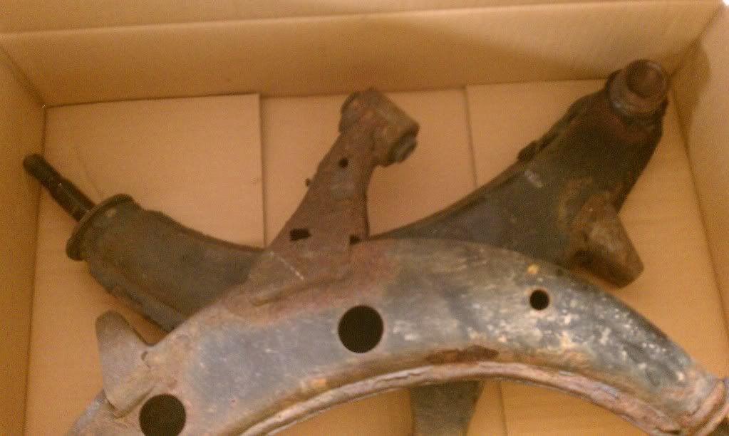

  40. Bielke55
    Our service and techs are busy with these because they are replacing 1 out 3 cars. We had a forester that the punch tool went right through, and left a quarter size hole in the rust.

  42. Bielke55
    This is what i'm taking about, this one failed before the tech used any tools...
