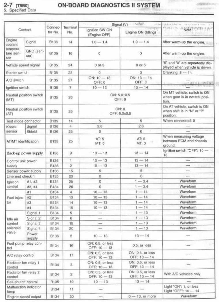

    this is for a 99 RS. I found that pin 25 on connector 135 needs to be grounded, according to this
    currently there is nothing going to pin 25.
    1. how do I pull a pin?
    2. is there an unused pin i could pull?
    3. can i just ground the pin somewhere where the ecu sits?
    another problem aside. when i was pulling out the ecu i got a couple of sparkles, i checked the connector but i don't see any cables touching each other. what should i check/do?
    thanks guys
    PS: i'm doing this because it's causing 2 CELs.

    If you are unplugging the TCM, those pins are probably the same. Pull one out with 6-12 inches of wire attached.
    Just ground it right to one of the screws that holds the ecu down, just give it a good rub down with sandpaper or something abrasive first, then slap a little dielectric grease over it (carpet can hold water pretty well = rust).

    I went down there again and I think the guy who did the electrical work did almost everything but taking care of pin 25. so there are some wires that have been cut and no pin available to be pulled.
    where can i buy a pin? is a 22 gauge 300v a good wire to use?
  9. qstarin
    qstarin Well-Known Member
    1,913
    Uptown Mpls
    any wire will be fine for that. literally, any wire at all.
    For the pin, you could use one of the wires going to the ECU that came from the TCU/TCM. Those should still be there.
    So, like, "Torque Control 2 Signal" or something.
    Pull the pin from one spot in the ecu connector and cut the wire a ways down. Then insert in the right spot for the new ground.

    DONE! DONE! it's working, CEL is gone! thanks qstarin. I also looked at the wiring diagrams to make sure I was pulling the right wire. but now I have one extra 10mm nut. there are 3 bolts and 4 nuts. but you can use at most 2 nuts directly on the ecu, because if you put the 3rd one on the top bolt, then the firewall doesn't line up. I don't remember where 4th nut was.
