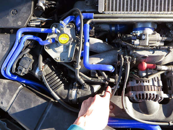

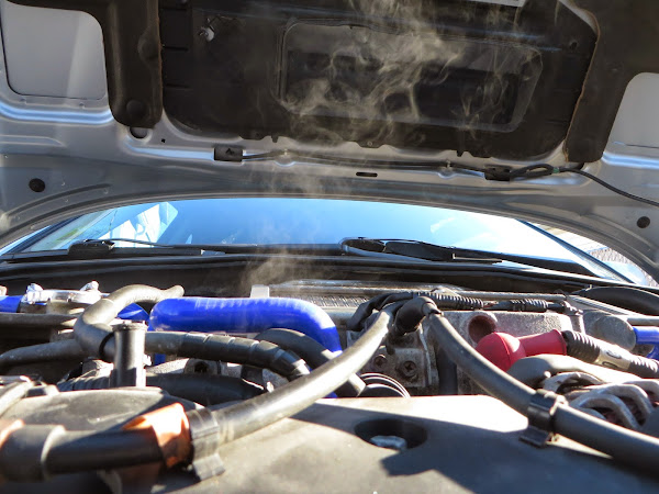

    Didn't want to make a new thread for what's (hopefully) a common issue. I took the wife to work and back this morning and came home to a cloud of white smoke under the hood. I have noticed it in the past but it was much more noticeable/worse today for some reason (at one point I could see it in the passenger mirror rolling around the side of the car). Car seems to run normal and I've never had a head gasket fail so I'm not sure what kinda symptoms you get during that.
    Anywho, I can see a small puddle of coolant on top of the right side head. I've seen that for a little while and assumed that it was just that stuff boiling or burning off when the motor gets warm enough. However, the smoke seemed to be coming from everywhere on that side of the motor, or else there was just a lot more this time. I tried taking a pic of the little coolant pool but there's so much stuff in the way the camera can't get a good focus. So where I'm pointing in is where the pool is.
    Perhaps it's landing on some other surfaces, too?

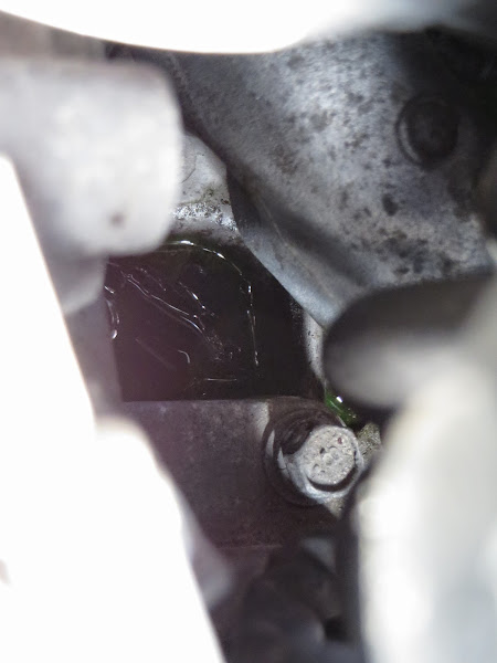

  14. Krazylegz1485
    3,731
    Got a pic of the pool after the smoke cleared. Not sure why the pic got rotated this time (should be turned 90* left) , but here's what I got:
  15. Threshld1
    Threshld1 Well-Known Member
    Mine did that when the bottom side of the upper hose was leaking.
  16. Cotts612
    Cotts612 Well-Known Member
    652
    I had a small coolant leak on the engine side of the upper hose and it would run down the timing cover and on to the exhaust. Just needed a little tightening. Didn't steam up that much though.
