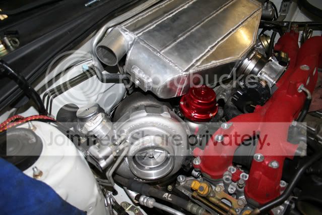

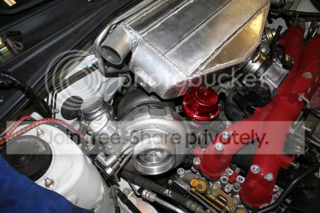

  11. FAB KING
    FAB KING New Member
  12. Dream
    Yum! Looks like the wastegate is super close to hitting?
  13. piddster
    Since its all connected to the motor it should be fairly rigid. It will all move together. That is a tight fit though. I don't think Suabru had 40R's in mind when they designed the car. Or did they.....
  14. curly2k3
    looks awesome, but what happened to making an intake? did you guys just decide to do TGV deletes now?
  15. FAB KING
    FAB KING New Member
    That will be phase 2 I believe.
