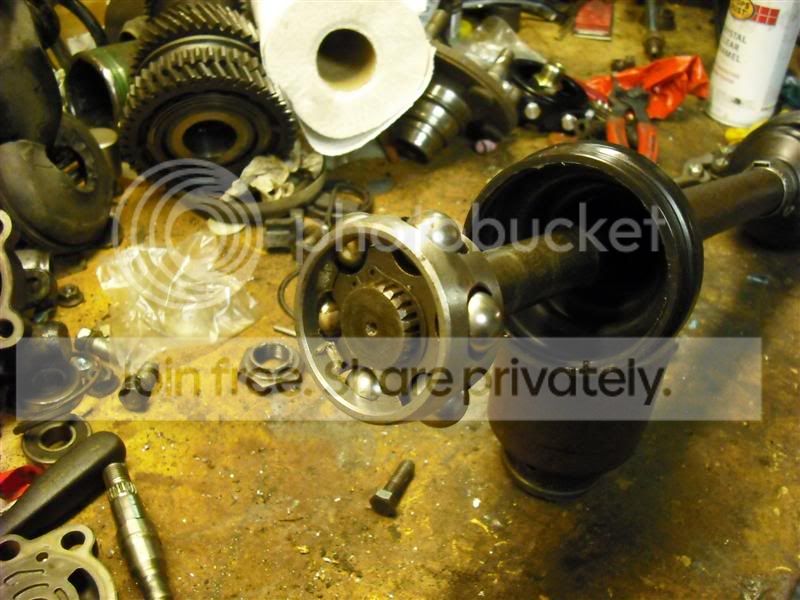

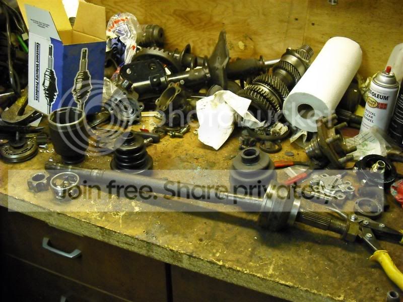

    with the luck I've had with reman'd axles, I would definitely pull it out, and just replace the boot. not much technology to a CV boot, so you can just grab one from any auto parts store. they're usually like $7 each (including clamps and grease). pull yours apart (need a snapring pliers and clamp tool, plus the tools to get the axle out), clean them out real well (since the CV basically doesn't come apart, you'll need a good solvent to get it real clean. I usually soak it in gas.....), pack them with the fresh grease, install boot, and put it back in the car.
    pictures from when I re-booted one of the axles on my XT6 (same idea).

    I usually try to describe DOJ disassembly once every couple months. so I just went into the basement, pulled apart a spare axle, and took a bunch of pictures. write-up will be posted shortly.
