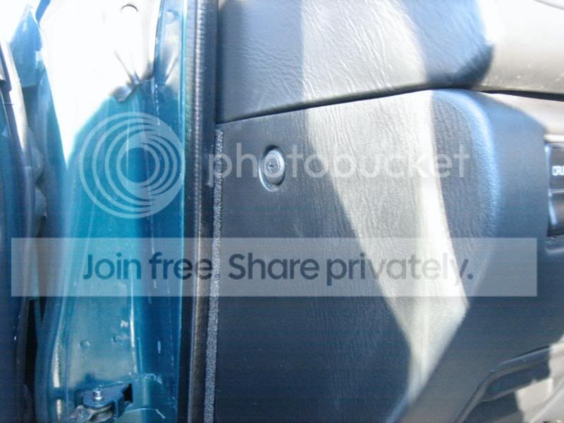

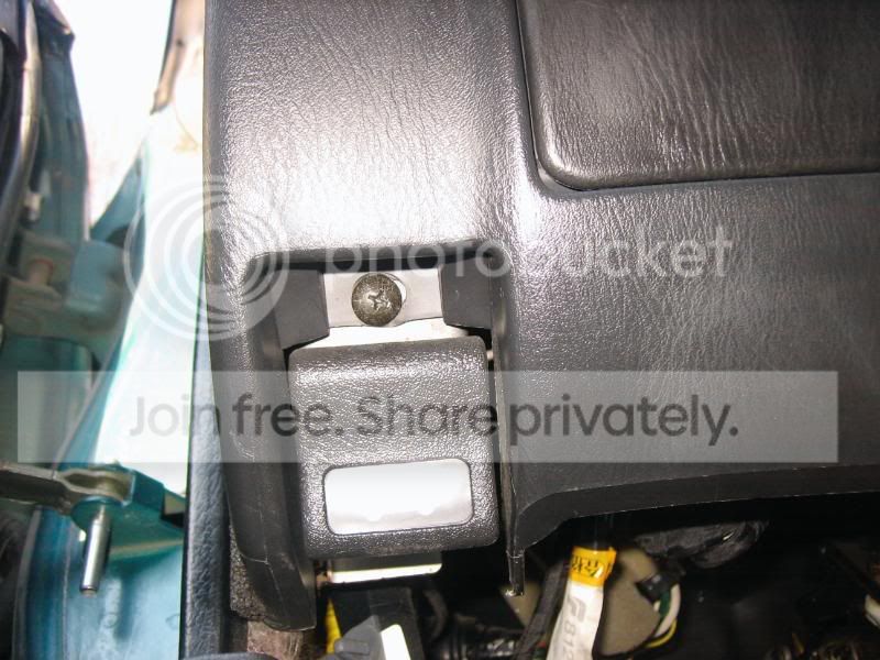

    1) Remove side plastic screw from lower steering column.
    2) Remove metal screw by hood-pop latch.

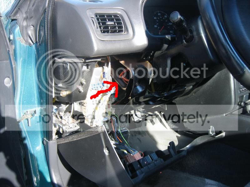

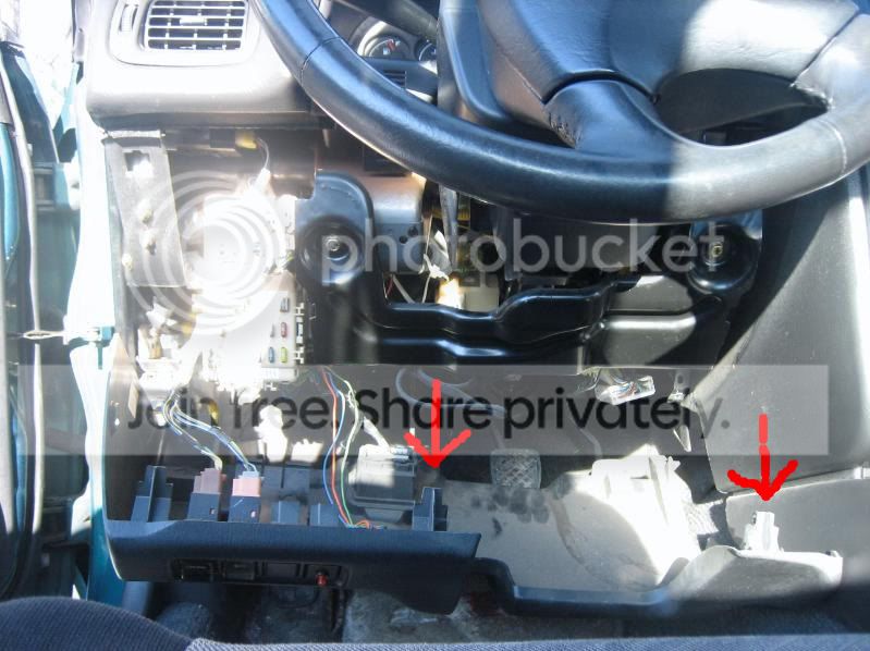

    3) There are two plastic clips (one on either side of the steering wheel) that you need to muscle out. I just gave a quick pull where I felt each of them, and they popped right out.
    4) While the lower steering column dangles, locate the small black box labeled "Sensor" here:
    5) Go find a friend with tiny fingers (or just use a pliers) and adjust the white knob counter-clockwise to make it less sensitive , or clockwise to make it more sensitive.
