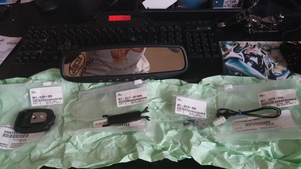

    These are the parts that I ordered for my Homelink/Compass Install
    Complete Parts list with price

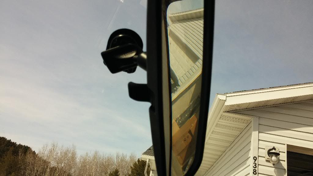

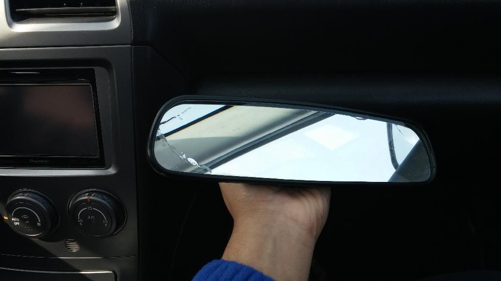

    Remove the Stock mirror by twisting it 90 degrees to the right
    Get the stock mirror out

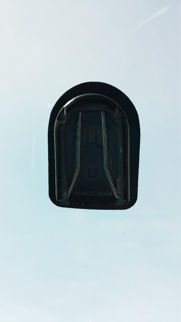

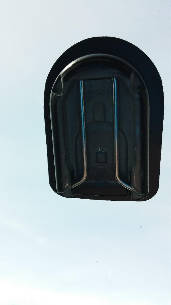

    This is how the stock mount looks like:

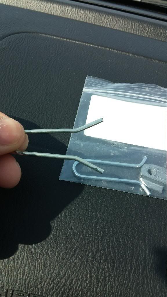

    Remove the Stock clip out

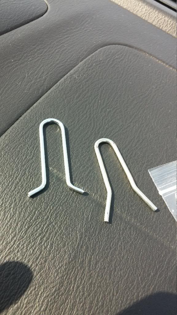

    The new clip on the left , stock on the right
    Insert the new clip
    Slide the Cast iron into the clip might be a little PIA to put in

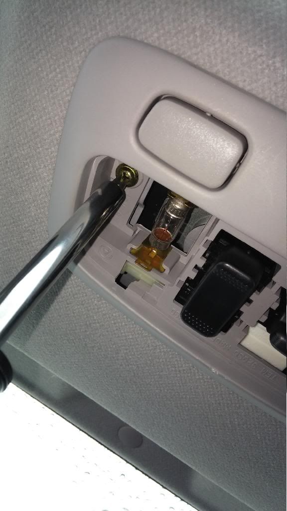

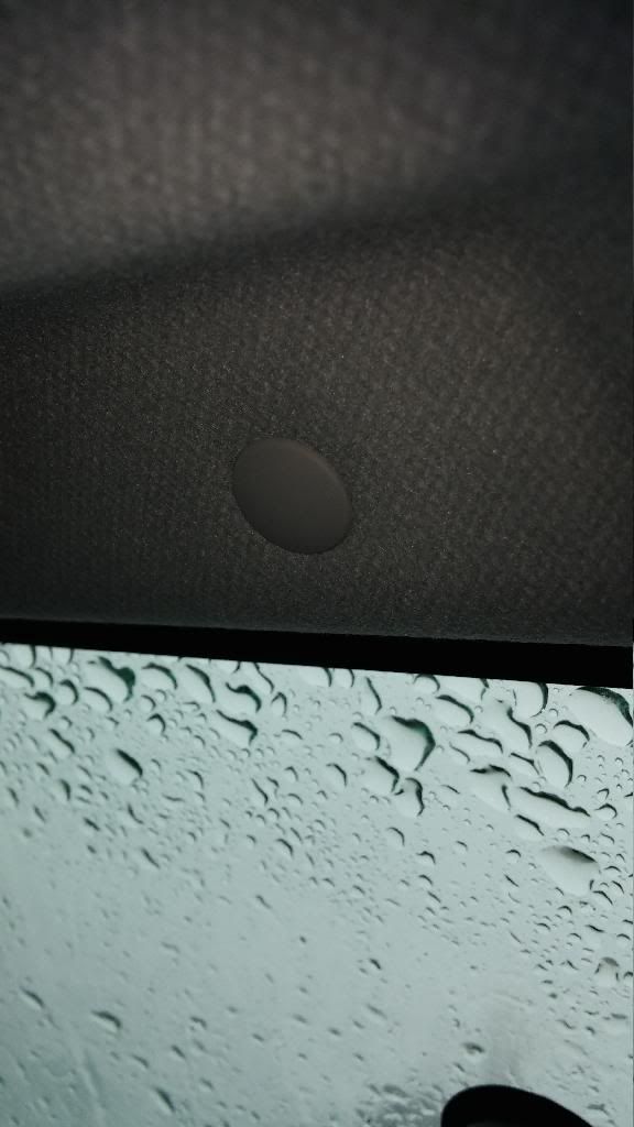

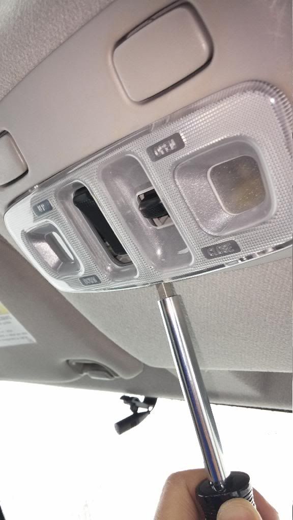

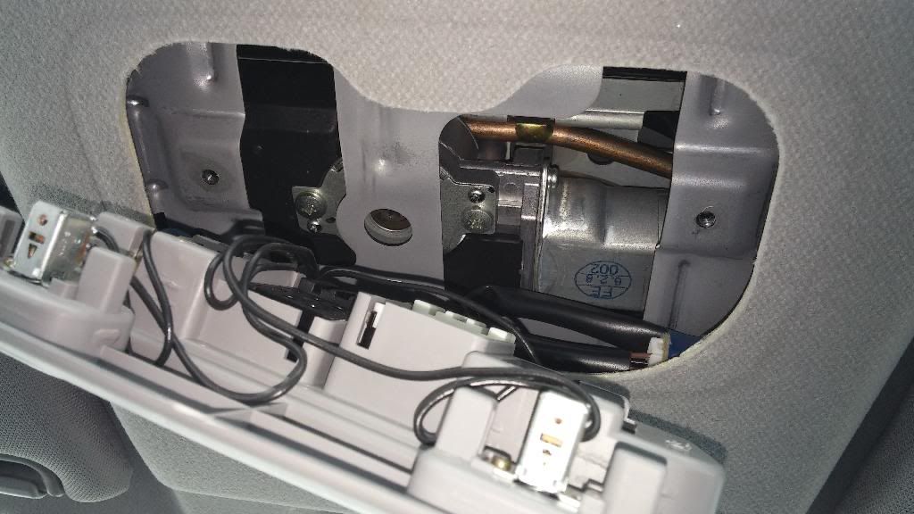

    Remove the bulb cover
    Once the covers out take out the screws on either side of the console light assembly

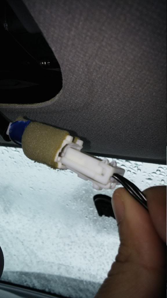

    Remove the the console and look for the wire plug
    Gothca!
    Plug in the wiring harness to the plug

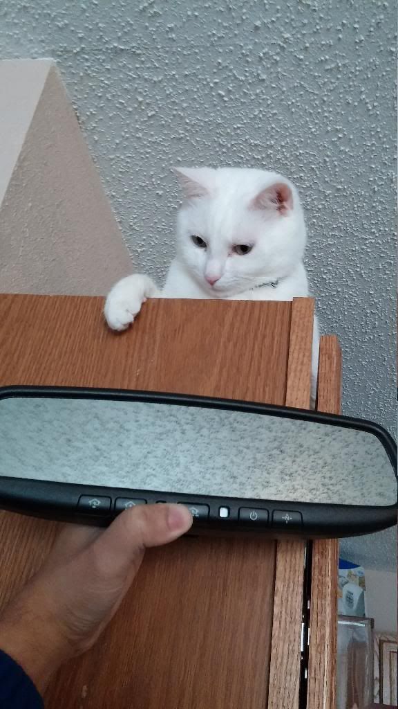

    Get your Homelink Mirror from your cat

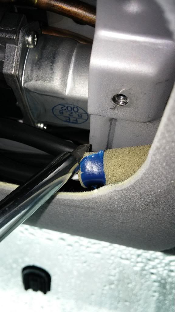

    Pry this open

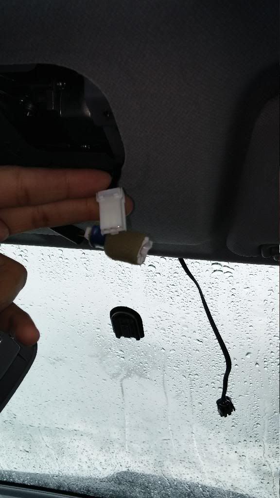

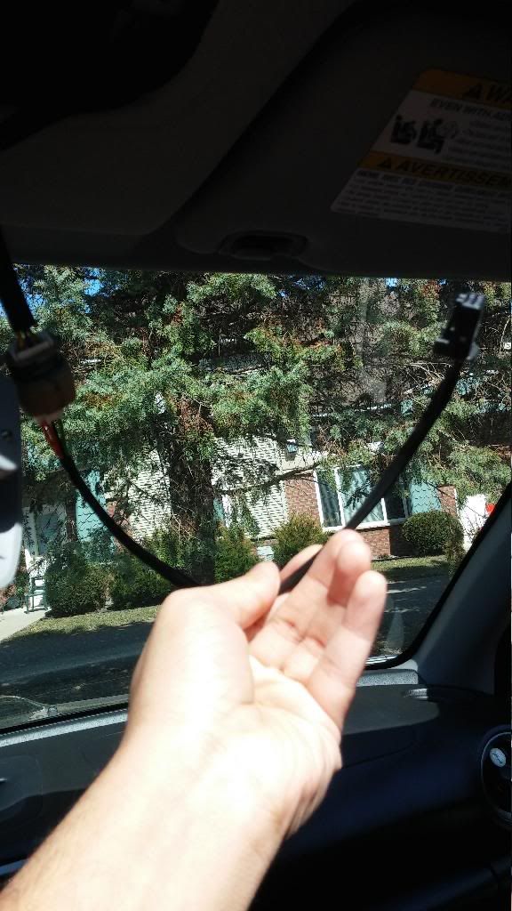

    Route the homelink harness through the overhead trim
    Slide the wire cover

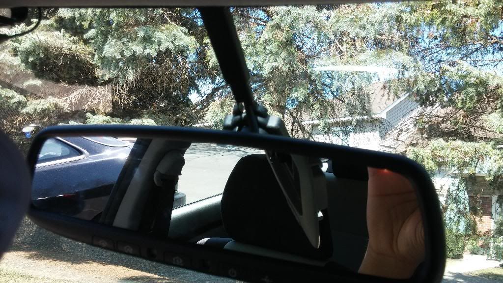

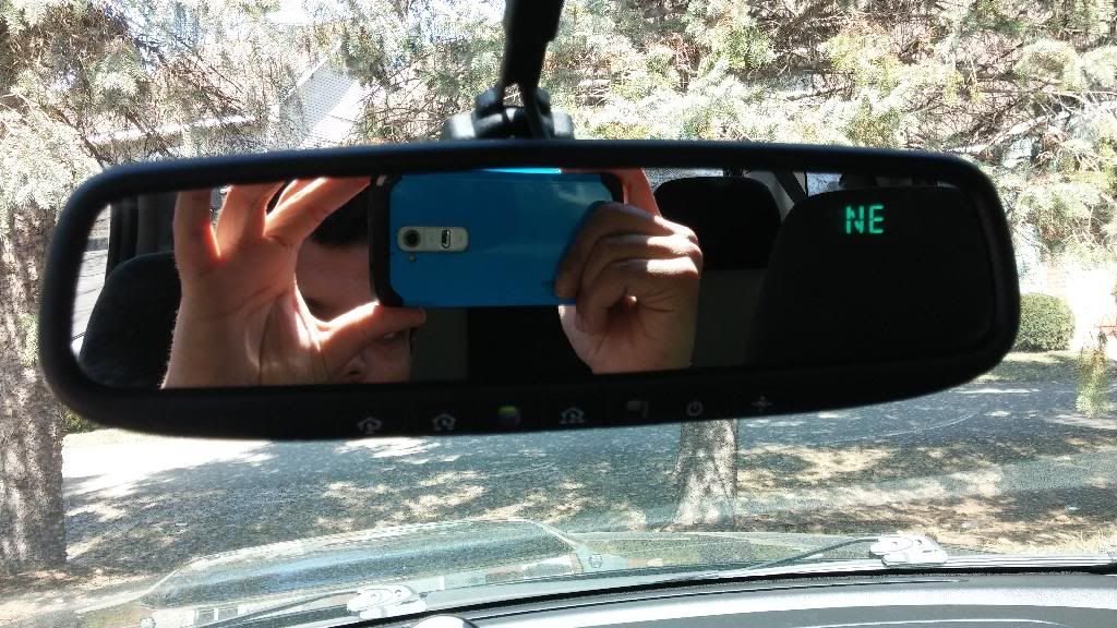

    Start your car and enjoy your new Autodiming Homelink MIRROR: :banana: :rock:

    Just to add, if you have a base model and do not have the map lights up top, you probably do not have the harness to plug this into.
