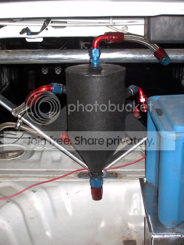

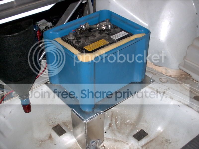

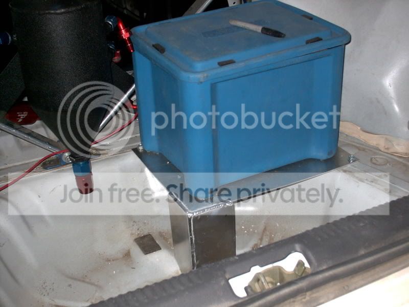

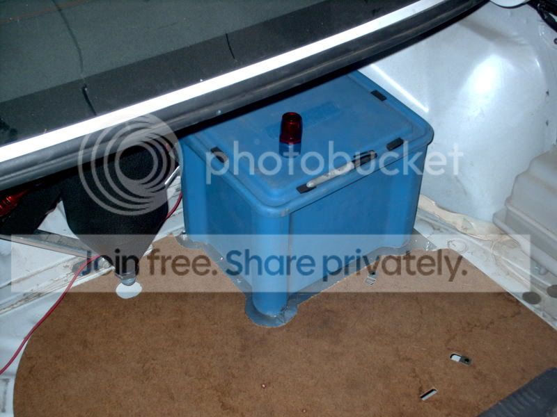

    hears what i was up to today. got the swirl pot finished and painted. no leaks so i mounted it in its spot along with made a stand for my battery box to make way for the new spot for the inline pump and filters. also cut the cover for the wheel well and am going to do some sound detaining to cover up the noise a bit from the pump.

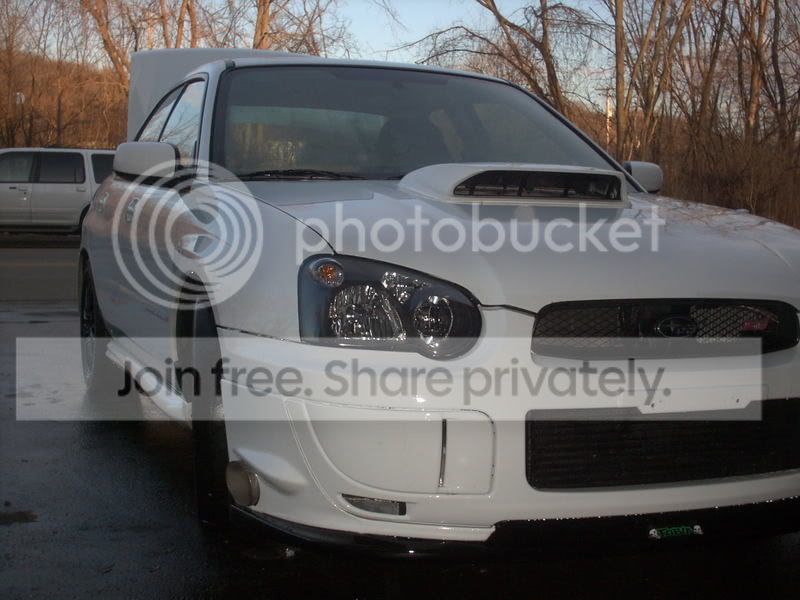

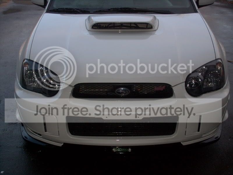

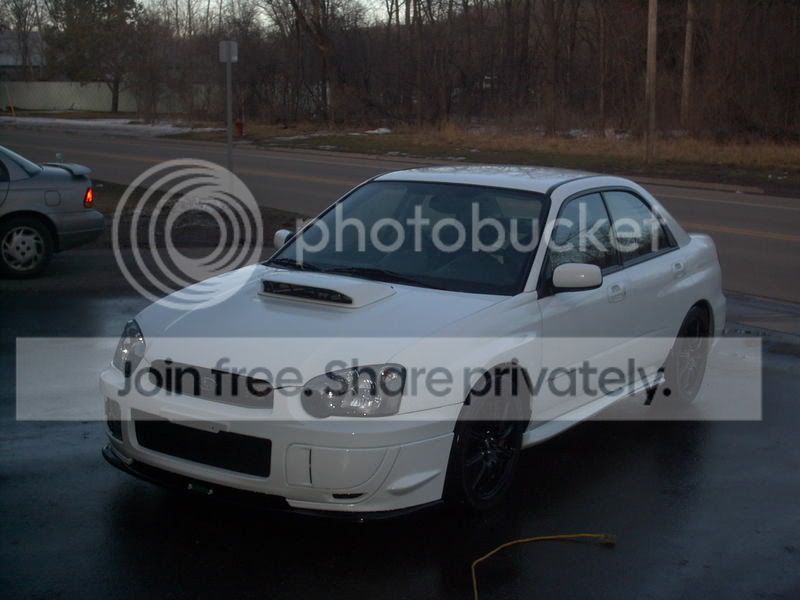

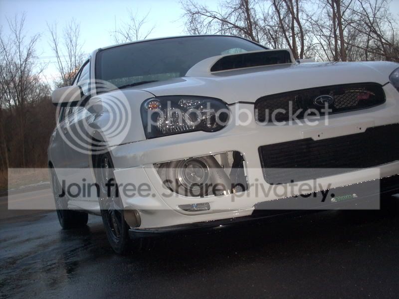

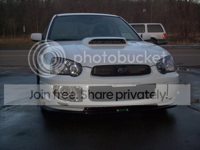

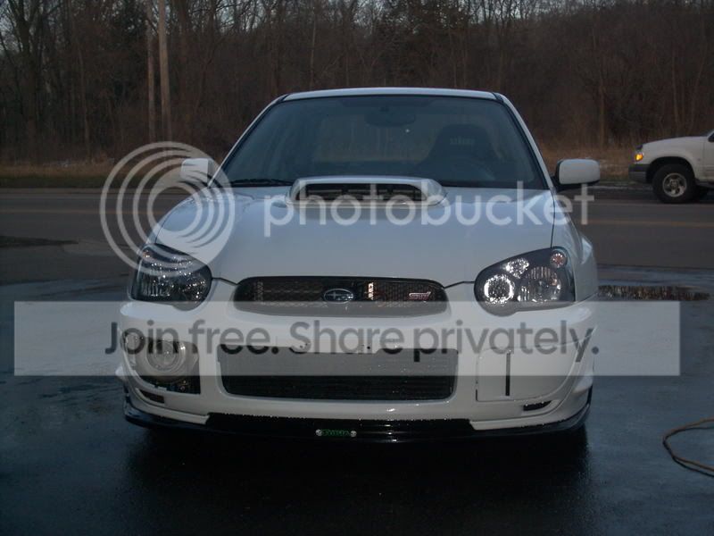

    well it runs again! just drove it out of the garage and washed it real quick and put it right back it. sounds sweet and am now ready to work on it more now that i know everything is working. hears the pics i snapped:
    and the new clutch!

  13. AspitFire
    are you putting anything around the front bumper where your cutout is?
  14. fobiawrx
    fobiawrx Fabiola
    what you see is what you get

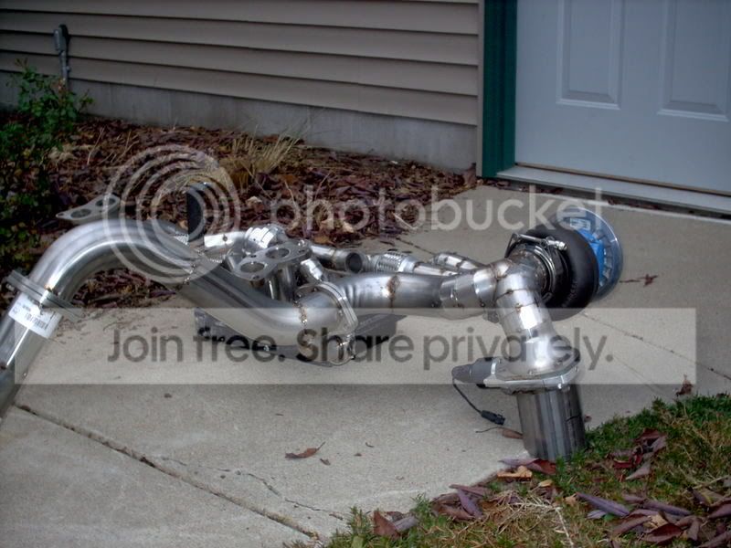

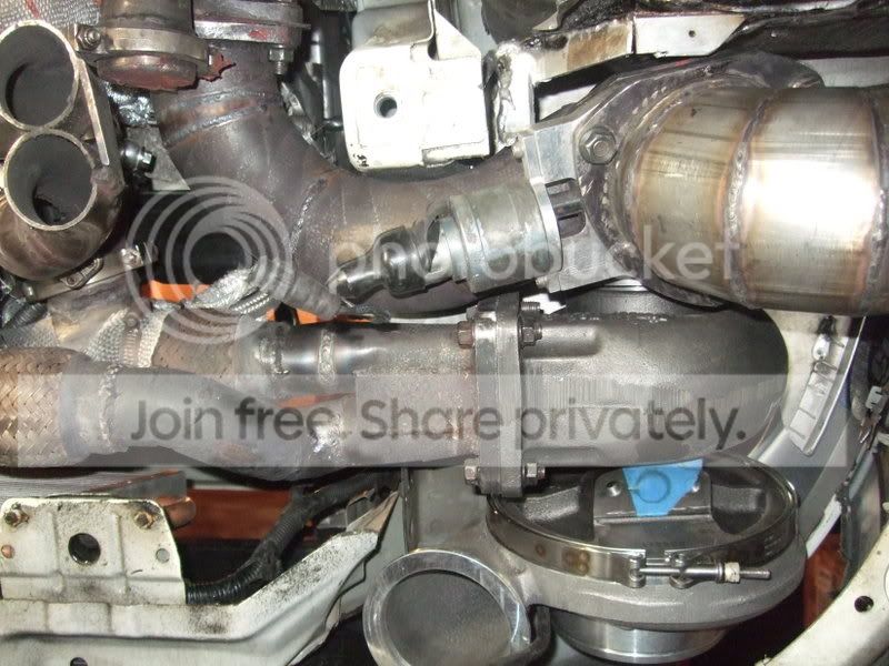

    this is how it looks and works:
    this is my old setup. when the cut out is closed it goes to the back of the car and when it opens it comes out the side. i ditched this setup because it came down on the dyno straps so i never could open it to tune for it.

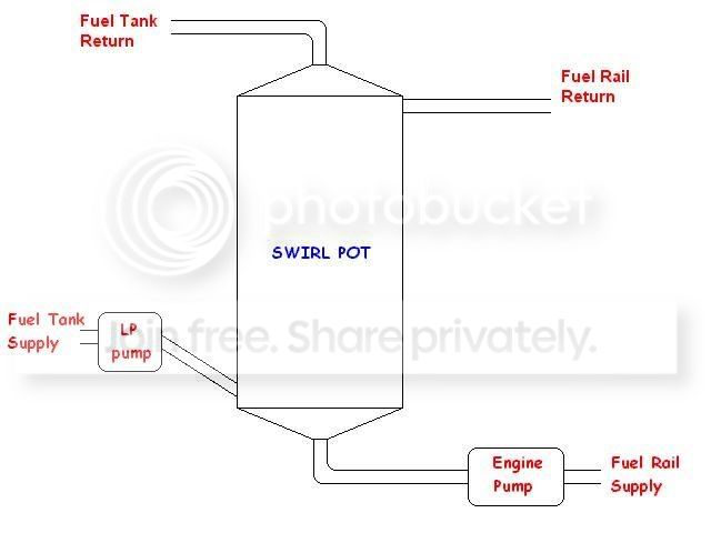

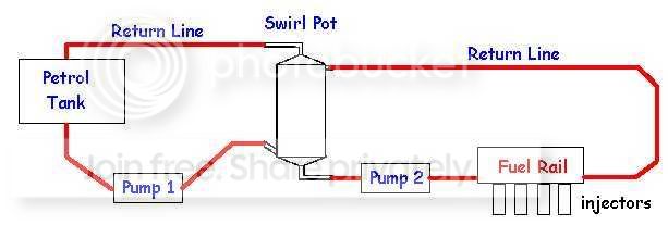

    I'm wondering......why a swirl tank instead of just a surge tank.
  36. FAB KING
    FAB KING New Member
    Just make sure that your pumps dont overload your return.Any pressure in that tank would be an enormous car fire you may not survive.
  37. Bielke55
    Where does bee sit?
  38. fobiawrx
    fobiawrx Fabiola
    so if the -10 fails to return the fuel fast enough i will die? hmm....... that would suck.
  39. fobiawrx
    fobiawrx Fabiola
    both are dam near the same thing. the big deference is that a swirl pot gets rid of air better for a less chance of loosing pressure.
  40. TSTRBOY2004
    been single too long havent ya ;)
  41. Chux
    1,507
    very true, but with the existing baffles in the tank, you already have a pretty slim chance of loosing pressure. seems a simple surge tank would already be over kill.....and would have been waaayyy easier to fabricate.
    surge tanks are a common thread over on Ultimate subaru, as the fuel tanks on carberated models don't have the baffles, so when doing an EJ swap, it becomes an issue...but even then, only occasionally, and only under 1/4 tank or so.
  42. fobiawrx
    fobiawrx Fabiola
    well when your using a inline pump you need to use some kind of swirl pot/ surge tank(like i said there the same thing). and when you start getting into e85/e98 like i plan on running, you can go threw a tank of gas easy in one night. and with the shifting of gears of slight turns you get swishing of the fuel and in tank pumps suck air in. and that is what i don't want. inline aeromotive pumps have been known to break when they don't have enough fuel. so i think this setup will serve its purpose.
