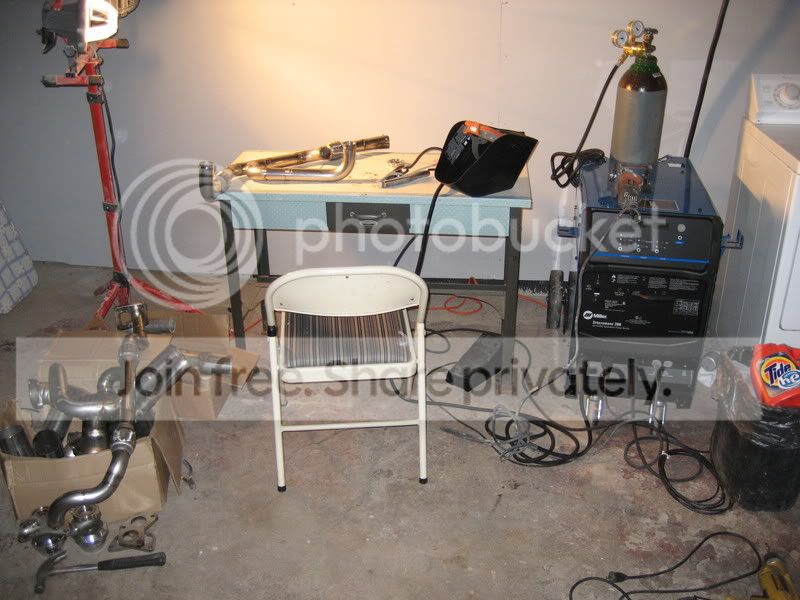

  12. TSTRBOY2004
    was about to ask you what welder you had... then read the post while editing it...ha ha ha
    how much you pick that up for??? I need to figure out our budget for the workshop!!!
    also to save me going through all the posts again.. where do you get your piping hookup.. I know you mentioned it before...

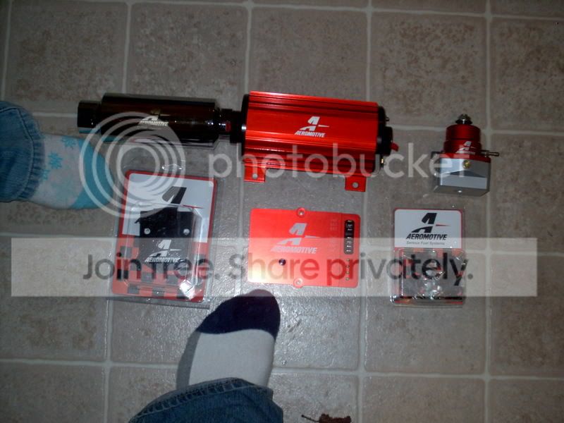

    fobiawrx Fabiola

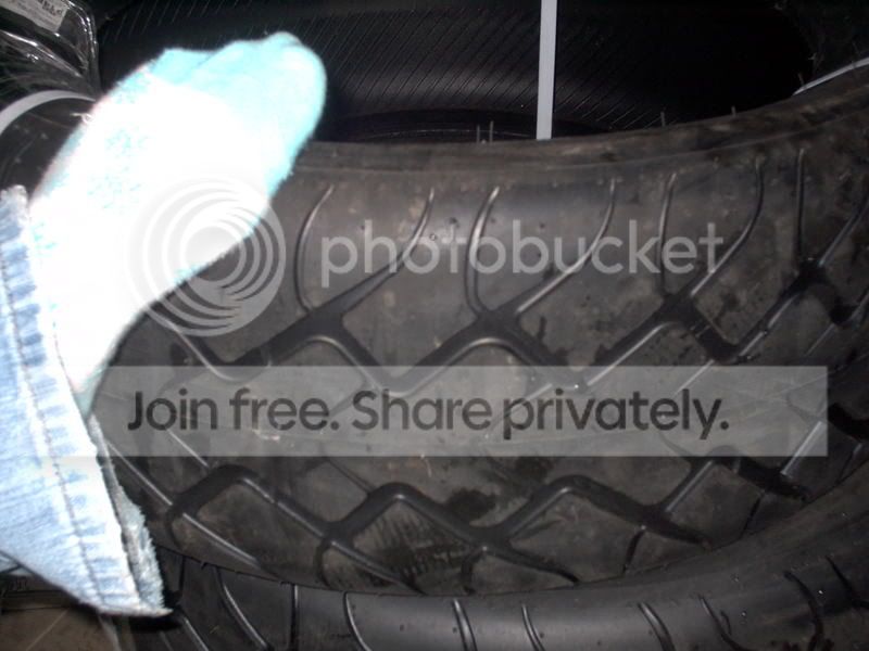

    some parts just showed up!
  18. mnstilynwrx
    mnstilynwrx Well-Known Member
    those look pretty beefy. what brand/size?
  19. fobiawrx
    fobiawrx Fabiola
    bfg g-force T/A drag radial 225 45r 17
  20. carl
    won't you just vaporize those the first time you step on the gas? :laugh:
  21. wrexinator03
    wrexinator03 Banana Cream
    +3.14
  22. TSTRBOY2004
    Matt your blue socks are just too cute...
  23. vangstaboi86
    those tires are nice man... had them 2 summers ago, they grip very well.

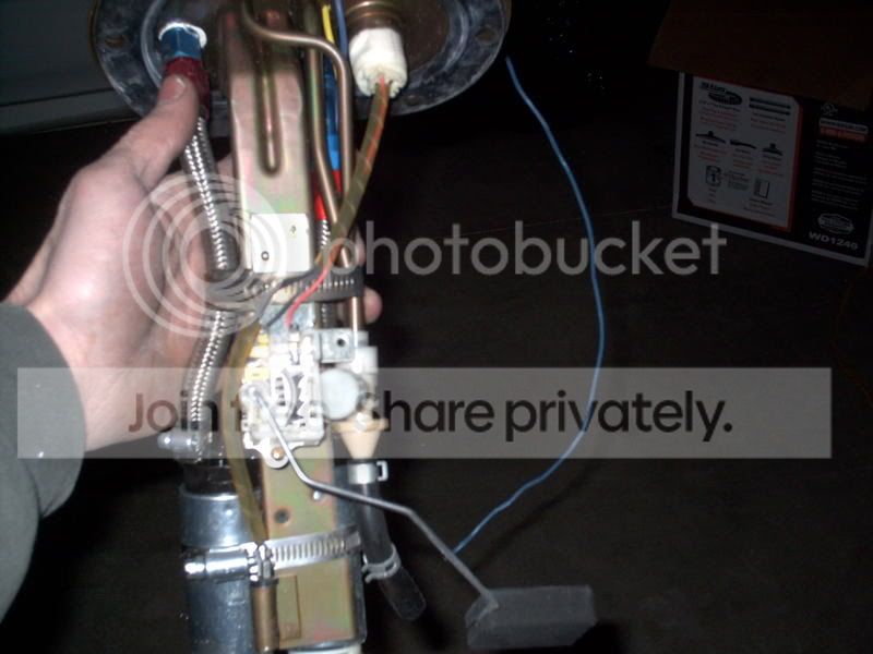

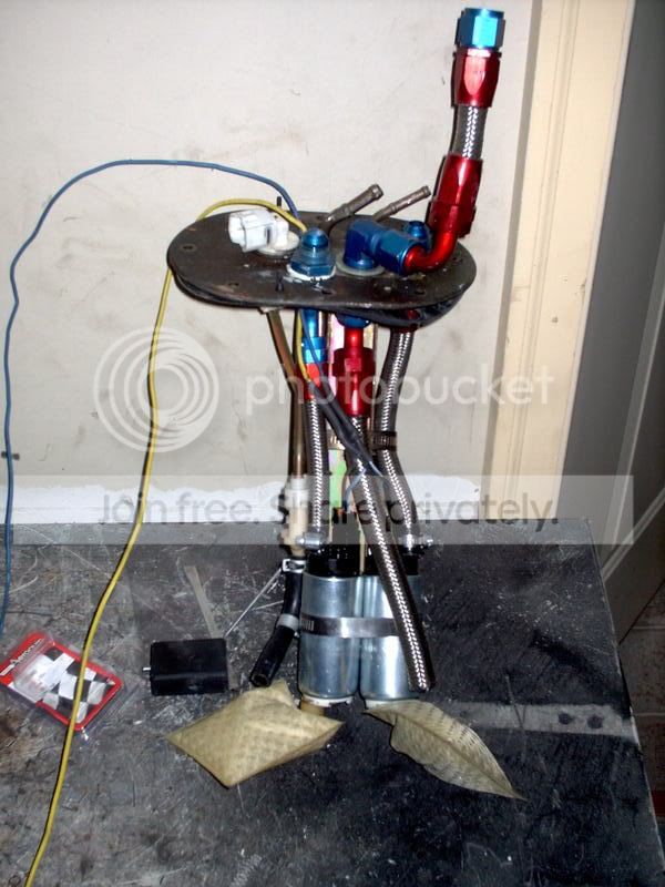

  24. Iroc-Z
    Iroc-Z Well-Known Member
    Is that an A1000? You think that pump will be enough? I heard those things are not that good after 700hp on a forced induction motor?

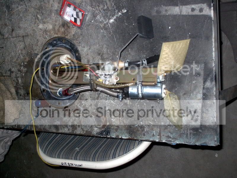

  29. fobiawrx
    fobiawrx Fabiola
    no this is the eliminator pump. good to 1100 horse. should be enough...

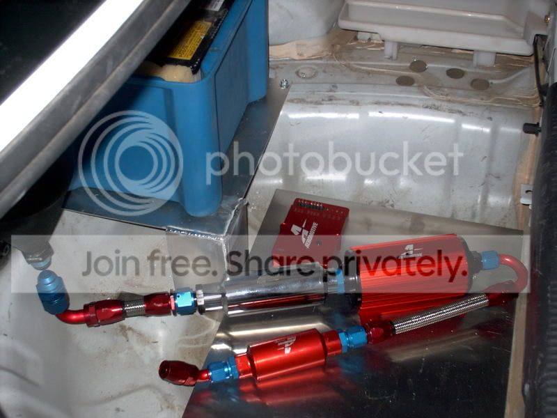

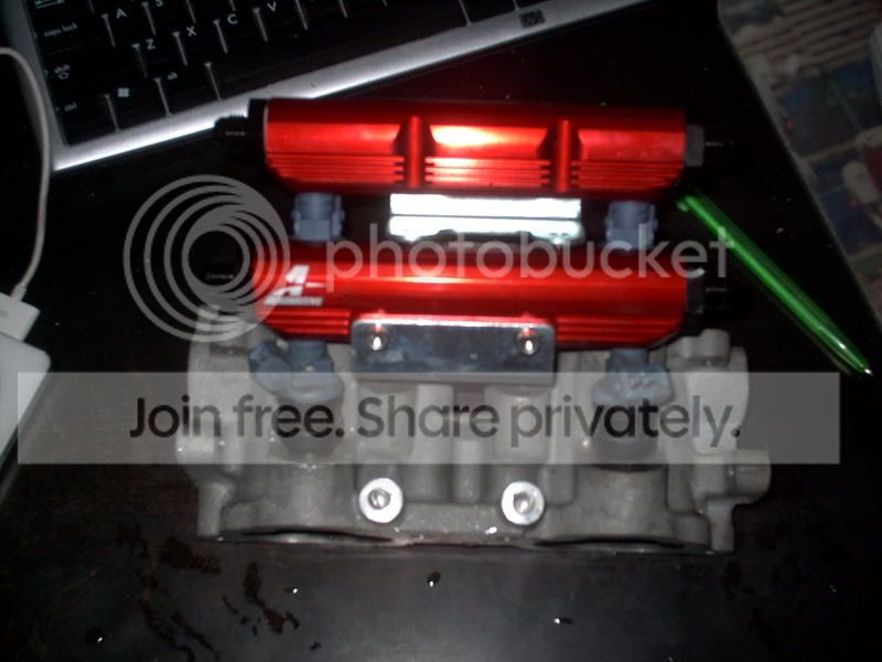

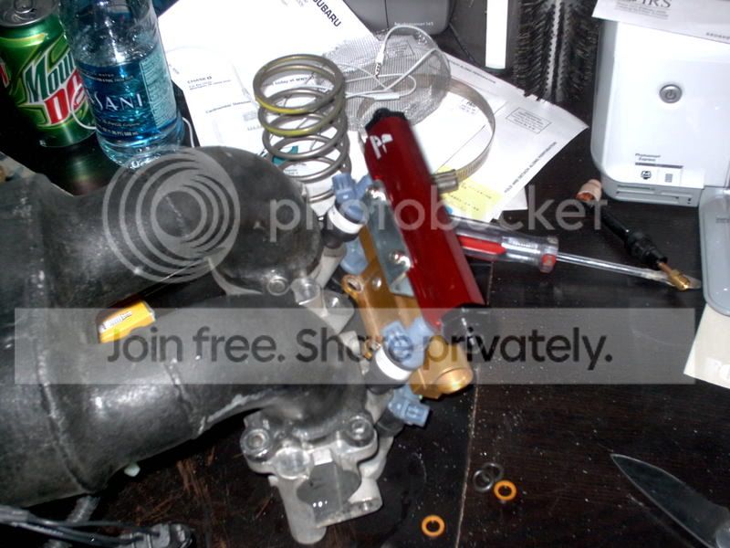

  40. fobiawrx
    fobiawrx Fabiola
    pics of the progress...

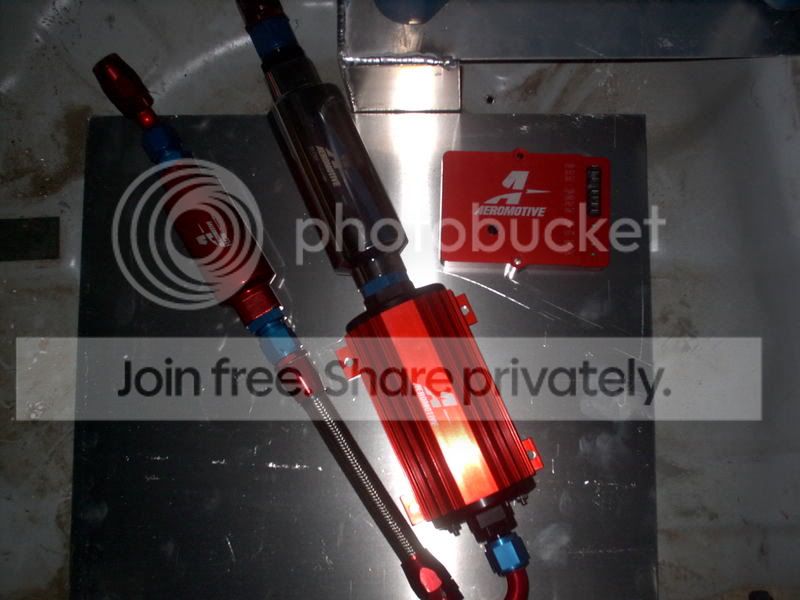

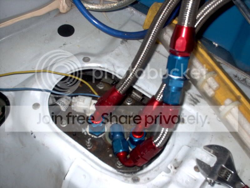

  41. fobiawrx
    fobiawrx Fabiola
    mmmmmmmm... twin 1600cc injectors per cylinder.....
  42. wrexinator03
    you crazy but i likez very much yes
  43. piddster
    Hmmmm. 12.8 liters of fuel per minute. You sure thats enough? lol You're gonna have to charge $20 for rides.
  44. Iroc-Z
    That might not be enough money to cover the gas for the ride.
