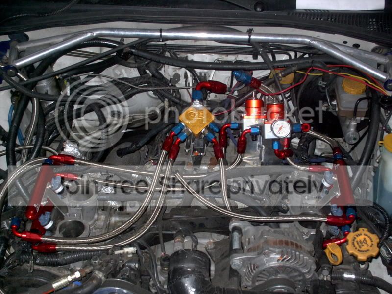

    and i don't think im going to get close to maxing these out. wanted to try allot of fuels this year and see what works the best. two 1600cc injectors will be enough for methanol if i want? then all im missing is the high compression.

    Sick Fobs! Just SICK! Man that's alot of FUEL!!
  10. fobiawrx
    fobiawrx Fabiola
    3,908
    dont worry about it
    just one pic....
