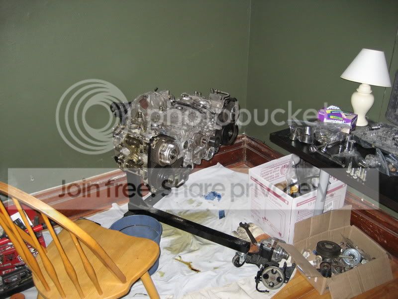

    also started taking apart the motor to start sending it out to get stuff done little by little bored to 100mm and porting out the heads.

    I like the engine being used to decorate your living room. Every man should have one. :biggrin:

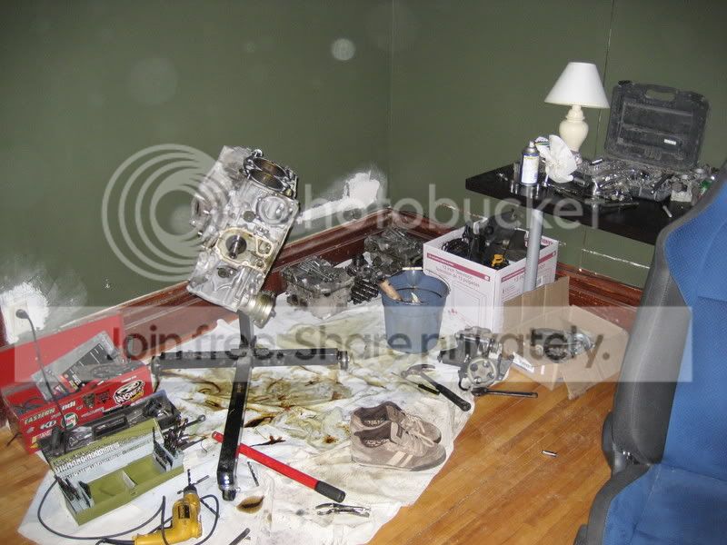

  6. fobiawrx
    fobiawrx Fabiola
    its cold out side so i brought the project inside

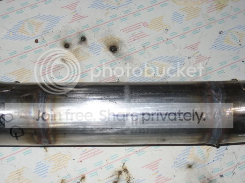

    Speedemon Well-Known Member
    37
    lets see some pics of your welds!

    My wife is wondering if you're single? She said no woman would allow that much car stuff in the house(at one time):)

    herd the same on nasioc! lol! she is being really cool about it so far. hasent complained about the oil smell yet!
  11. fobiawrx
    fobiawrx Fabiola
    been taking my time with it but hear are some picks:

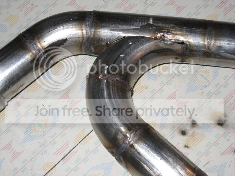

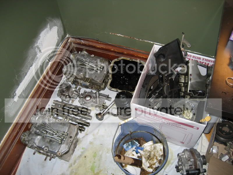

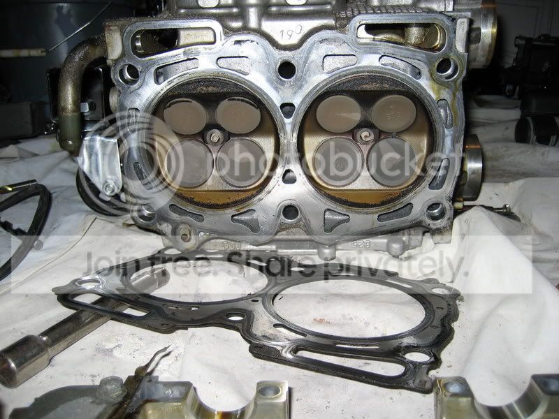

    well did a little of everything today. started out tarring down the motor until i ended up rounding out the passenger side exhaust cam bolt. so then i went down and started to weld up my headers. did that for a while until i got board and went back to the tare down. had to drill out that bolt and when i got that out things when smooth. hears some pics of the day:

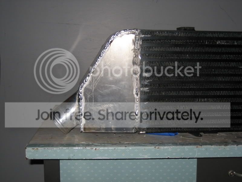

  14. fobiawrx
    fobiawrx Fabiola

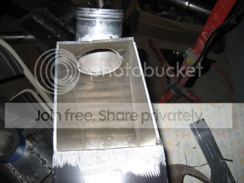

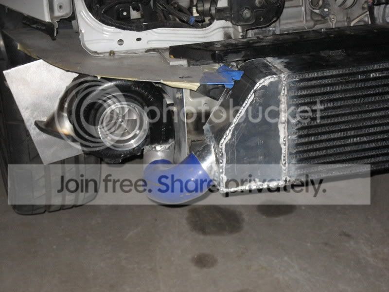

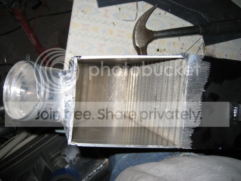

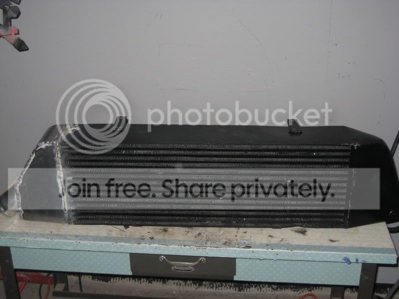

    well finished up the intercooler today! built a new endtanke and welded on the elbo to the compressor housing. hears some pics:

  16. Speedemon
    37
    you need to work on your welds a bit but otherwise cool!

  18. phi11
    aluminum is hard to do.
  19. fobiawrx
    fobiawrx Fabiola
    i think they turned out fine...
    second day welding aluminum

  21. esperunit
    esperunit Well-Known Member
    not bad for not having much welding experience. It could have been a whole lot worse
  22. AWDimprezaL
    1,821
    hell yeah, nice enough job for 2nd day...i would leak check those though

    Very touchy compared to steel.
  26. Nuke
    i've see far more worse weld jobs on honda turbo manifolds LOL
    keep us updated...I want to see how this project works out :D

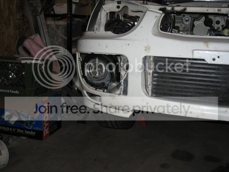

  30. fobiawrx
    fobiawrx Fabiola

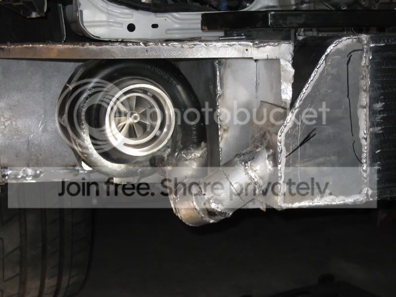

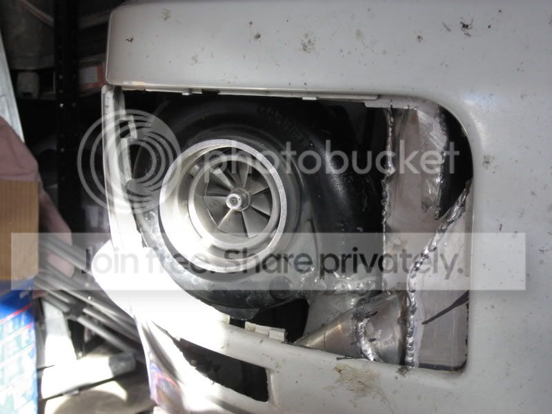

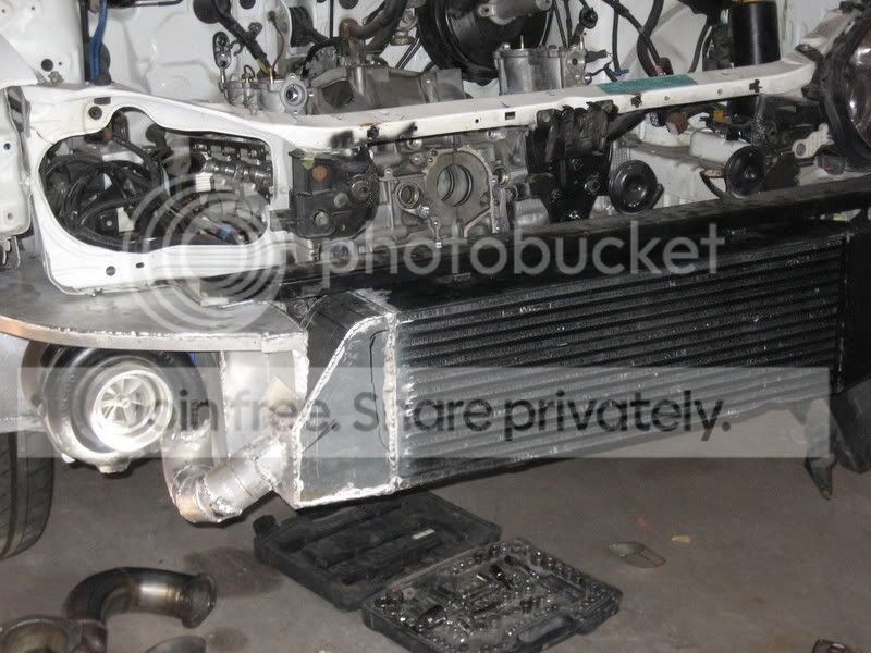

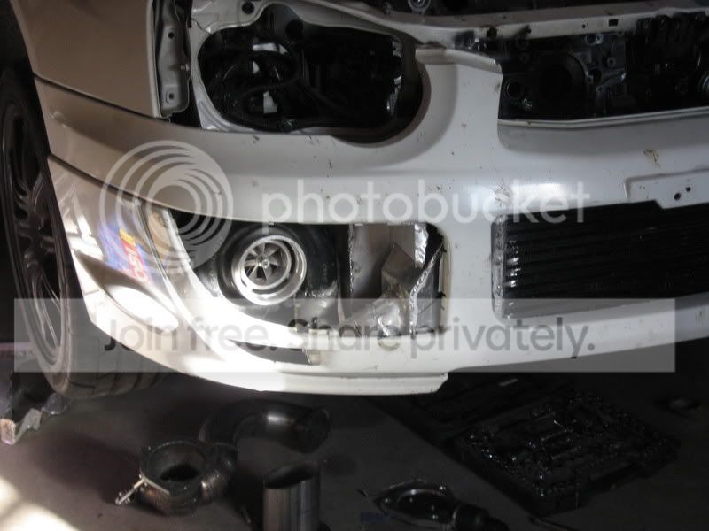

    ok update pics! got the frame of the box all welded and im going to have to think of a different way to do the front cover with the filter in do to final fitment. other than that it all fits grate and should be one hell of a sleeper (with the cut out closed). hears some pics:
    oh and yes some of the welds are gobed on there but they are strong as hell!

  32. Dizmal
    Dizmal Well-Known Member
    Boy, good things those welds aren't in a beauty contest!!
  33. Sogonerg
    Sogonerg Anteater
    ^haha...As long as it is strong and no leaks...It will be covered up anyways...Right MATT!
  34. 6MTizzle
    6MTizzle 2SLO
    You've made some awesome progress there man. The welds ain't pretty but if they hold who cares. Can't wait to see this thing run.

    looks awesome. that is one monster turbo. now after you finish this up, you have to make it so that you can run with foglights. be the first person with the front located 40r and fogs it would be uber sleeper :)
  38. fobiawrx
    fobiawrx Fabiola
    stis dont have fogers and i would have no way of fitting them in there. the fog covers fit perfict and plan on seeing if they make one with a bigger slit in there just for more air.
    and the welds....... in person they arent that bad....... ok there ugly but yes they are strong as hell and dont leak that is why they are so ugly cuse i keep going back on them and move slow just to make sure they are sealed tight. i can do a pritty good alum weld now. this stuffs all under a bumper so dont care if it looks bad.

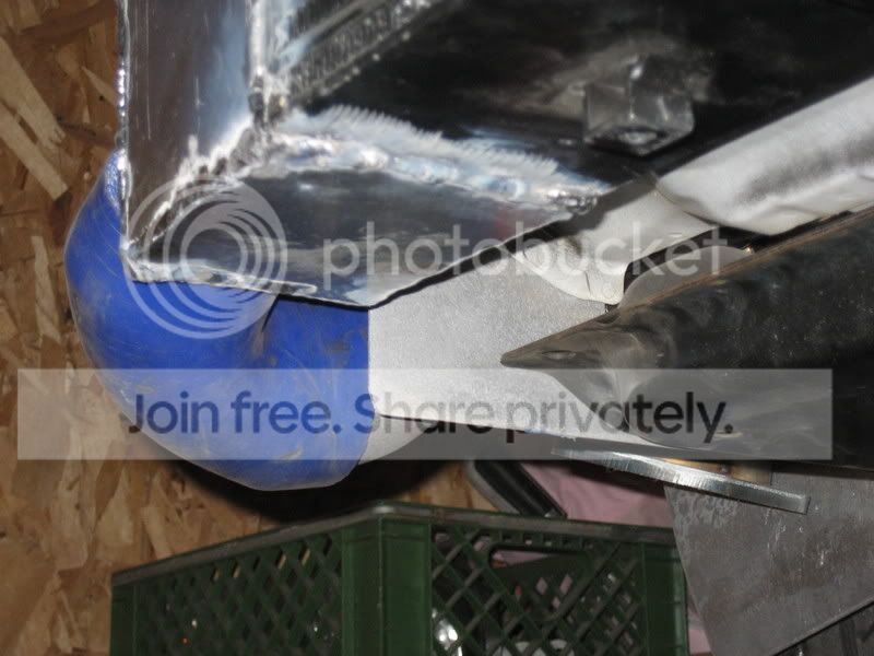

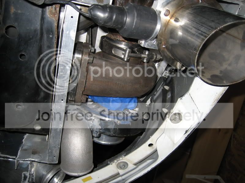

  40. WRX1
    736
    Just make sure that you have some kind of silicone connection between the turbo and the ic. I would cut those last little straight pieces back a little bit and put your hose there. The turbo will have a little bit of movement since it is bolted to the header, where the ic is a solid mount. You just want to make sure there is enough wiggle room in there to keep the stress down. Other than that looking pretty damn good.
  41. wall of tvs
    Good point, Russ. I'm sure that the engine will be torquing around just a tiny bit, hehehehe.
  42. MNAutomatic
    MNAutomatic New Member
    Looks awsome man...can't wait to have a ride in the passenger seat.
  43. fobiawrx
    fobiawrx Fabiola
    if you look closely there is a spot for the silicone hose just for that reason. the turbo is actualy fixed in that spot and will be solid so i have it cut tight. i have the flex sections in the headers and in the exhoust for flex between the motor and the turbo. also plan on having soid motor mounts to have less movement.
  44. WRX1
    736
    Cool, looks like you have it covered then.
  45. fobiawrx
    fobiawrx Fabiola
    yah the people that i talked to before i bilt the header had a big concern for thermal expantion and movement. just hope it all works as planed.
