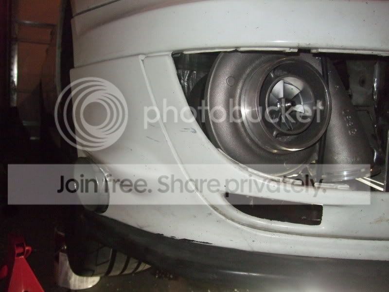

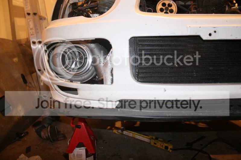

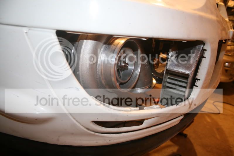

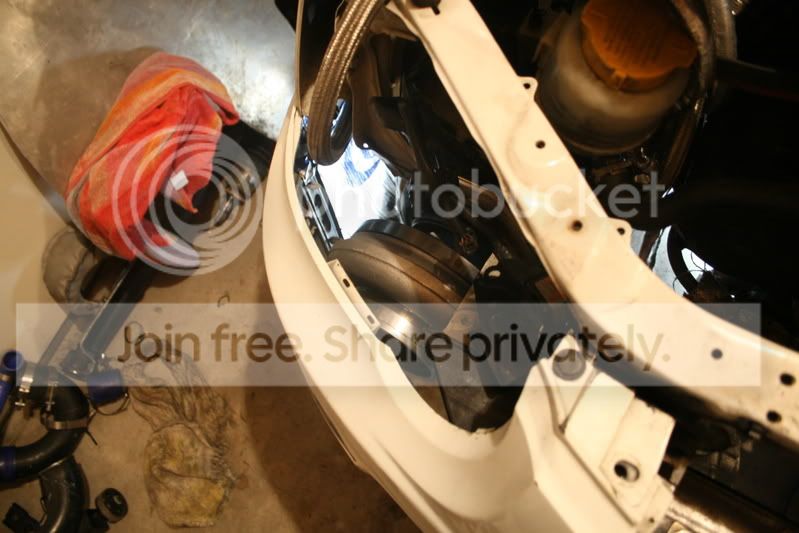

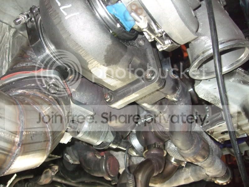

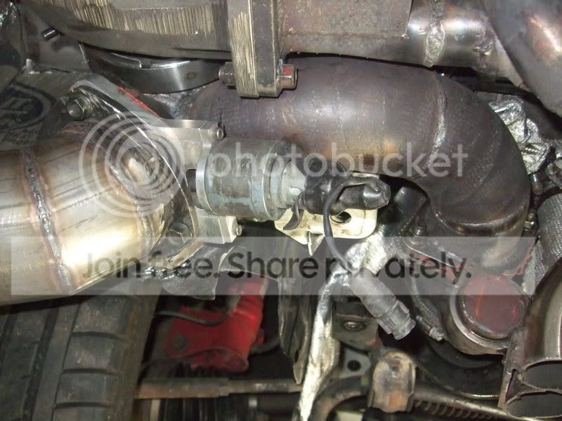

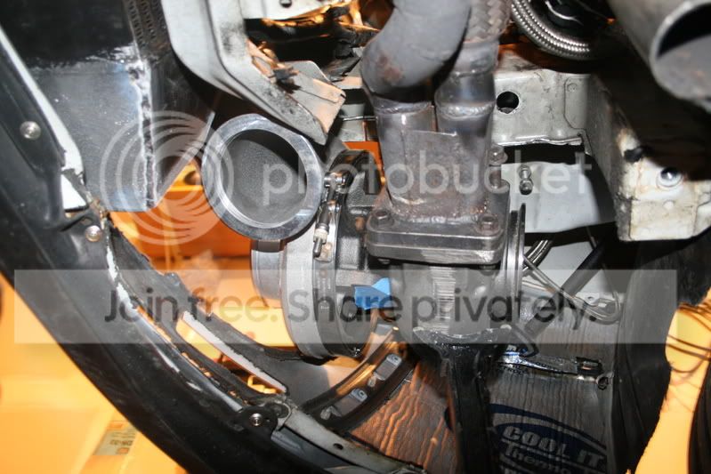

    well did some work tonight. cut down the header about two inches and re welded it. also re worked the end tank on the intercooler to give room for the v band clamp on the compressor housing. so i went and stole my bumper back from the painter to test fitment. funniest thing is that i have more room now then the 40R as far as clearances. hear is some pics:
  8. piddster
    4,735
    Boostonia
    How well does it fit with your box you had in there before?
    The CHRA seems pretty short on that thing. Are all those schweitzer turbos like that?

    same size as Garrett. the bw maybe a inch longer overall. as far as the box i had before. i have to make that fit again. i wanted to re work that anyway because of a part i left on it that made it a pain to get to the header bolts.

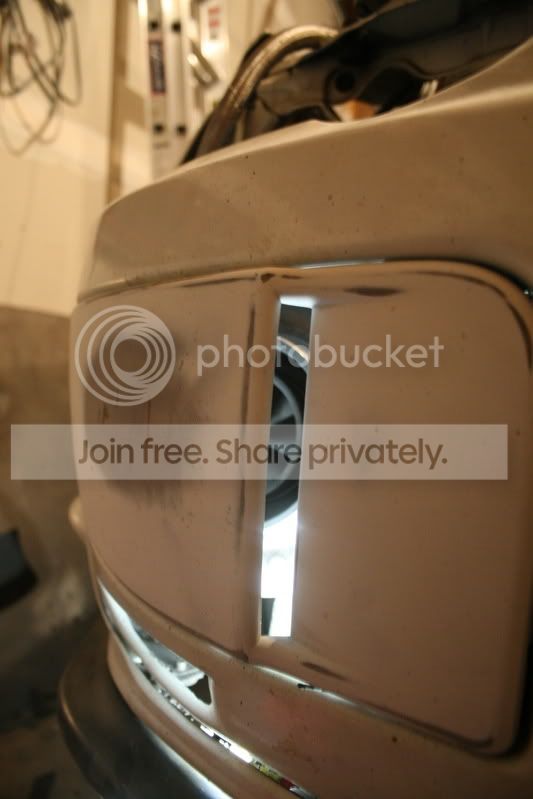

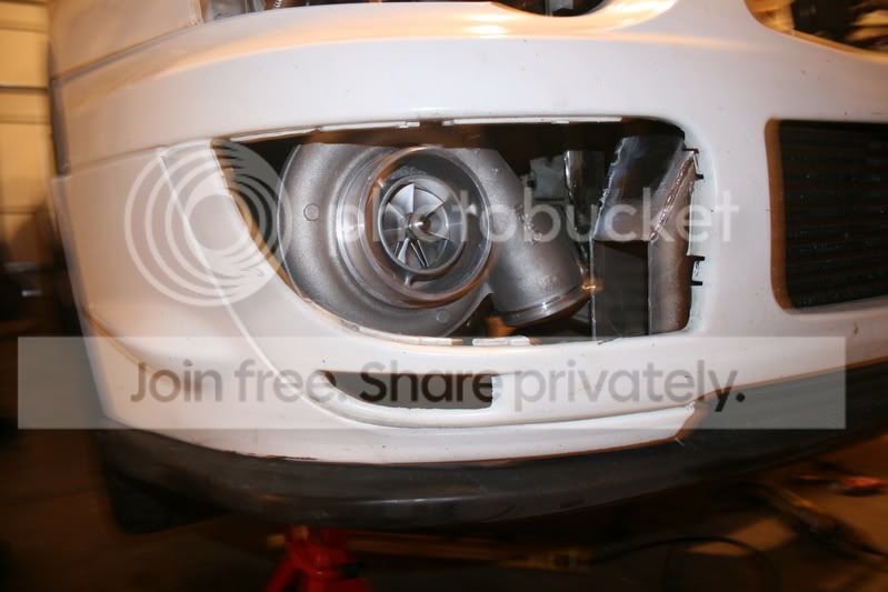

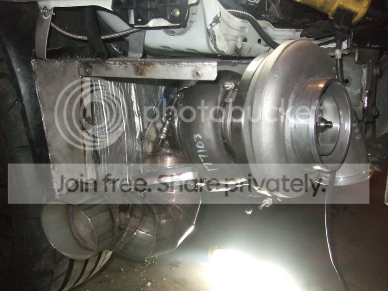

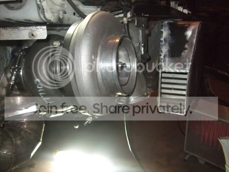

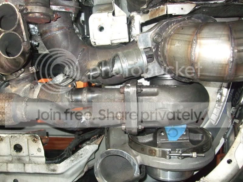

    well finished up the exhaust tonight. everything fits well and should work sweet once it is all running. still need to get the v-band in the mail for finishing up the end tank on the ic but other then that theres not much more to fab tell i get more parts. hears some pics:

    omg..LOVE the side exit. its just like that white gc.
    planning on putting wrap or something on the outlet so it doesnt melt the bumper cover?
  32. fobiawrx
    fobiawrx Fabiola
    3,908
    dont worry about it
    every thing is still going to get coated and wrapped as well as some more room around the exhaust when it goes threw the bumper
