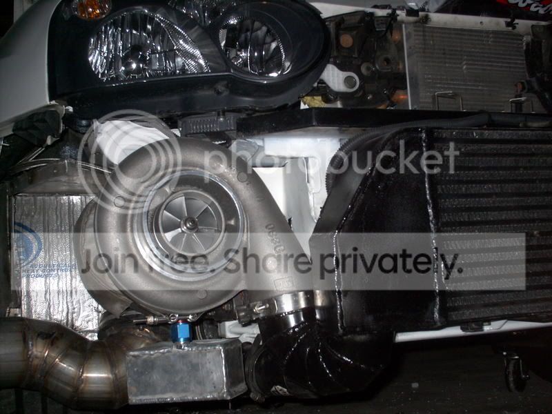

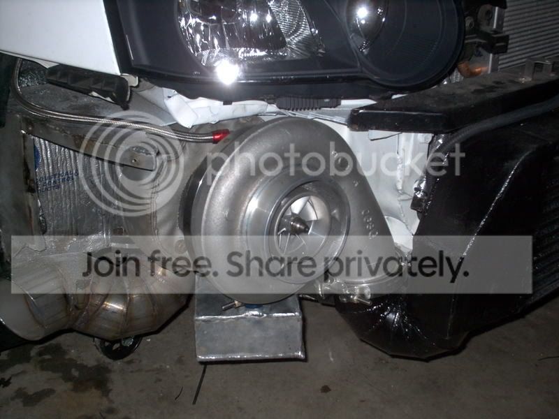

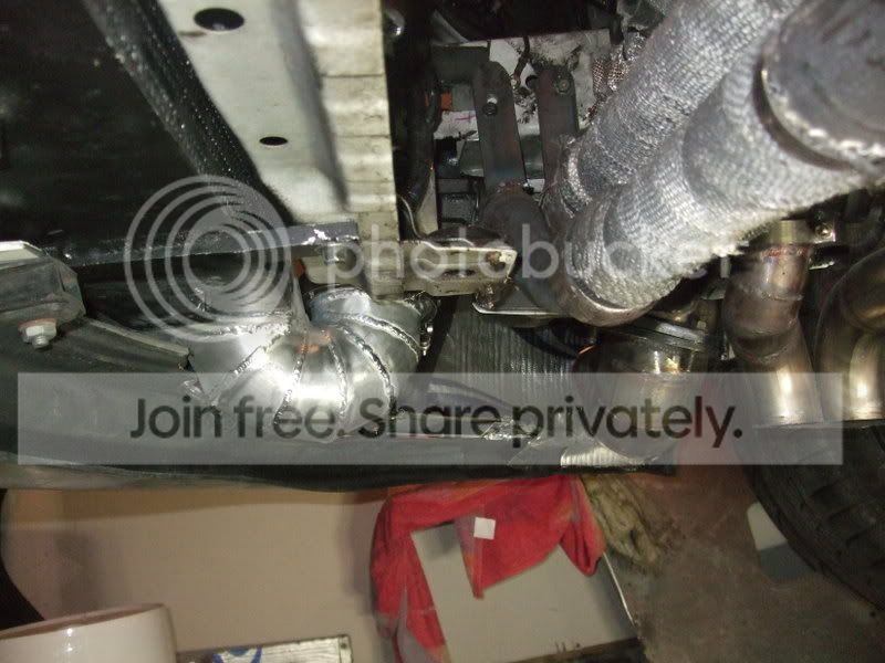

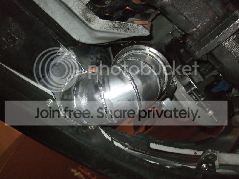

    finished up the end tank for the intercooler tonight! pretty pumped on this so no my kit is done for the new turbo. all i need is to put it all together now and would be able to dive it if i wanted. so on to other little projects and buying more parts to get the motor done. heres the pics from tonight:

    OMG :eek3::eek3::eek3:
    Ambitious is an understatment

    looks like the tin mans arm from the Wizard of Oz :)

    yep and they work sick! those guys rock for getting parts.

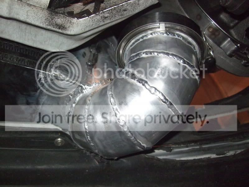

    Your welding has much improved young grasshoppa.
    Looks nice. I might have to come by in the near future.
    I need to use your welder for a minute or two, BTW. My tacked shut wastegate flapper doesn't really like 28psi and now it rattles in there. Time to weld it shut for good.

    ^^THIS! Sup!? Your welds are looking really good Matt!

    fobiawrx Fabiola
    thanks guys. i still am a little to impashent when it comes to welding. it i can keep my hand propped on something close to what im working on they turn out pretty good. but still could be better.

    they look good enough to work! speed doesnt have to look pretty

    Yeah, having something to prop the hand on to hold it steady makes a world of difference.
    And you do know that you'll be perfecting your welds for the rest of your life don't you!?:laugh: They can always be better!
    You should post a side by side of your first aluminum welds as a comparison to these. HUGE difference! How long have you been welding alum. anyway...like a year, not even?

    well right now i can hook up the oil stuff and put the radiator back in and it would be ready to roll. would need a new tun but i could still drive it. i have a bunch of things i still am going to do yet. bought a new under brace that im going to mount a bracket to to hold the oil pump and reservoir along with making it fit by the turbo. have to put my new interior in along with cleaning up all the wiring under the dash. new motor still has to be assembled and swapped but that will be the last thing becouse its the most expensive. installing a idle air controller too this year for a better idle. and some other stuff i cant think of right now

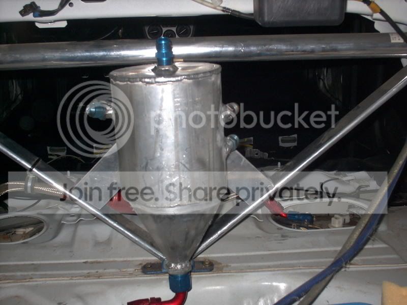

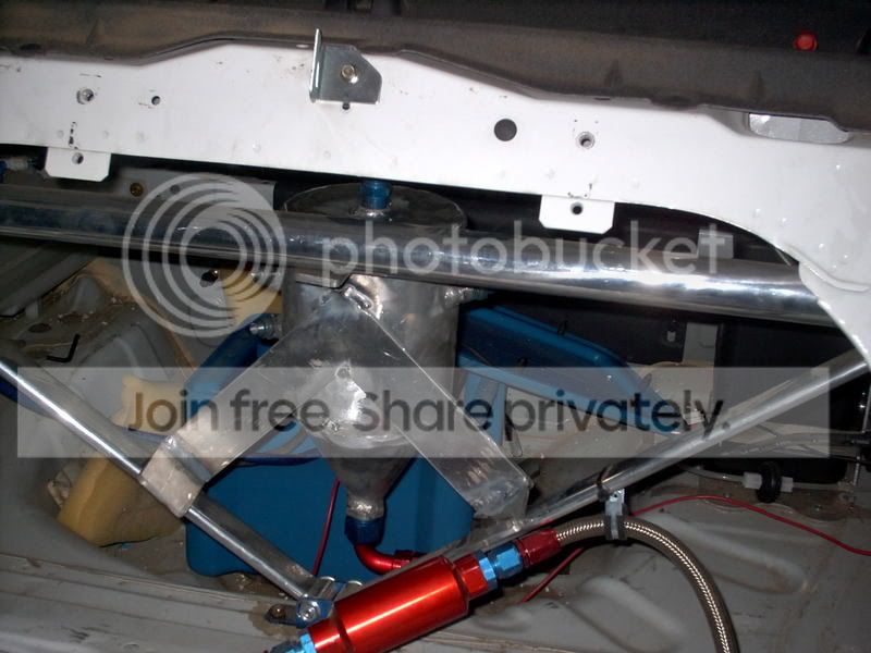

    got some stuff built! made a swirl pot for my fuel system and mounted it in its new home.

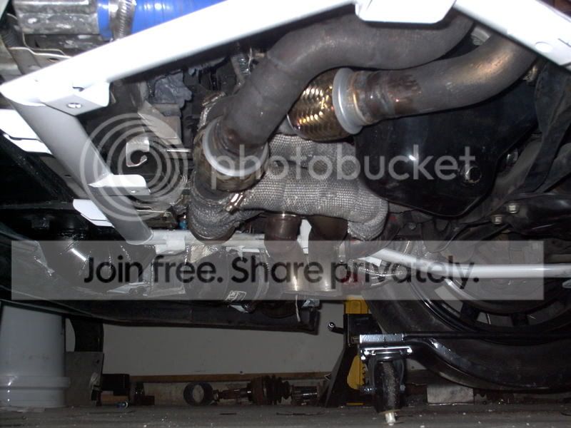

    also got the whole kit put on and all hooked up. oil lines and pump are all lined up and working. as well as mounted the oil pump to the new carbing under brace.

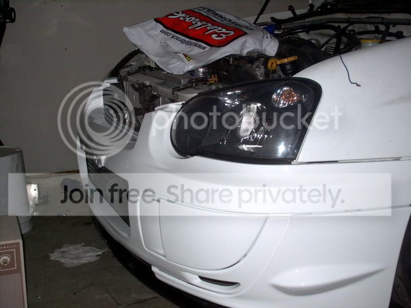

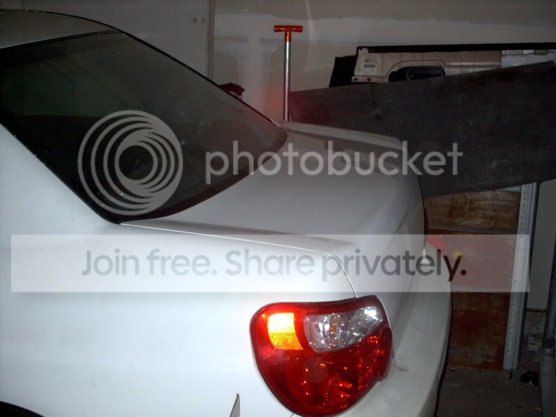

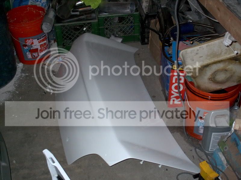

    also got my stuff back from paint. two wingless trunks (one has the key hole shaved) and a freshly painted front bumper and lip.
    also installed a set of bc inverted coilovers. the ride sits low now. looks so tight! time to start working on making this thing hook up.

    I was thinking about doing the shaved wingless look you just plan on opening it via cabin lever?
  35. fobiawrx
    fobiawrx Fabiola
    yep or crawling threw and using the in trunk lever
  36. Paul Revere
    Yeah that was the in case option but I would rather rig up a just in case lever ya know, or one of those magnet poppers.

    looking sweet matt. can we get some full car shots???
    what does the swirl pot for your fuel do? What do you gain from it?
  38. fobiawrx
    fobiawrx Fabiola
    it acts as a surge tank so the car never runs out of fuel if the fuel in the main tank splashes around. for example. if you are taking a long right turn the fuel in the tank goes over to the left causing the pumps to suck up air. this prevents that becouse the air it would suck up goes to the swirl pot and would go back to the tank. hear is a diagram of how its run:

  40. fobiawrx
    fobiawrx Fabiola
    it was a pain in the ass to make. had to cut my tig torch down to get in there to weld the inside of the tank and make it smooth in there.

  42. 02blubru
    thanks for the explanation fobia....
    nice fab work
