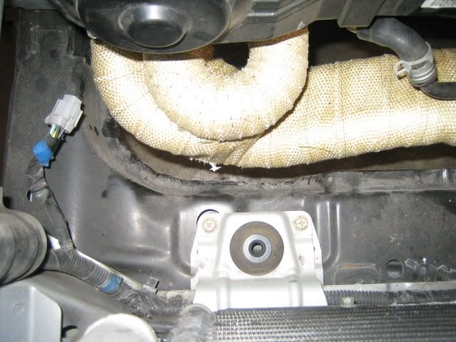

    Just use ducktape on me. I don't think I can tell the difference 6ft. under.
  2. WRX1
    727

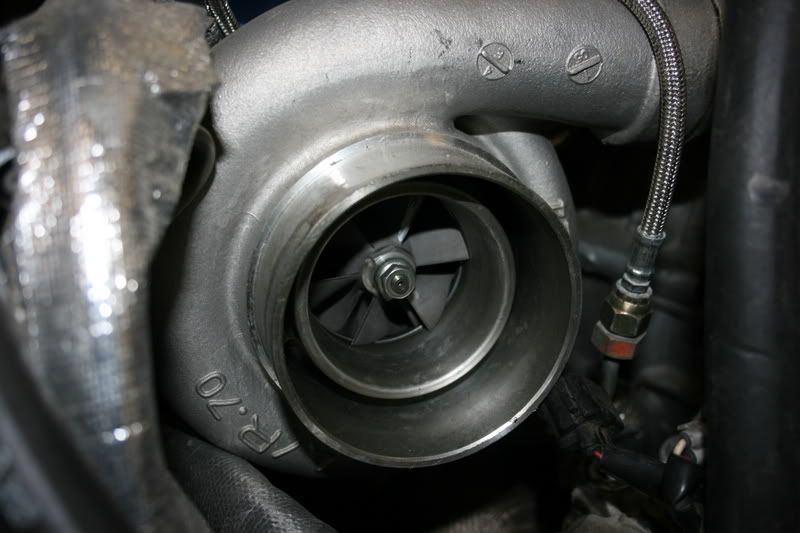

    Are you going to use the dei wrap seal on it also?? When we wrapped Steve-o's stuff, it was a pain in the ass. You almost need 3 people to hold everything and get the wrap on nice and tight.
  3. Justin
    Justin Well-Known Member
    273
    soaking the wrap in water makes it easier to get tight. a table vice with duct tape on teh clamps always works good as a second set of hands, as long as you dont over tight and dent the piping.
  4. Dream
    Yes, I bought the whole kit from Summit. There will be a heat blanket over the exhaust side of the turbo as well :yumyum:
  5. Justin
    273
    per the heat blanket...
    powerlabs cooked a turbo and he believed it was because he had a blanket on his turbo. i've read a decent amount about it and i'm indifferent but maybe you want to chat with him first. just a thought

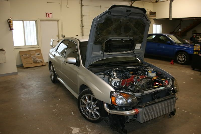

    VERY nice! Dream, did I meet you at LSE this past weekend? I met someone that pulled up in a silver with FMIC and his girlfriend. Same guy? If so, I didn't realize this project is completed. Are you just waiting to get tuned through Jorge?
  15. Dream
    Yep that was me. Project is 99% complete. Matt just needs to finish up the electronics and touch up on a few small things and ill be getting tuned on the 6th by Jorge :) :cool:

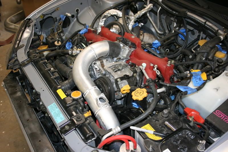

  24. wall of tvs
    sweet.
    Nice job on the blowthrough MAF -- however, I would have suggested to rotate it 180*. You want the longest and straightest section just before the sensor to reduce turbulence.
  25. fobiawrx
    fobiawrx Fabiola
    Yah I was thinking more of ware I can wrought the wires best. Move it farther down and I have to worry about the ac or the fans.
  26. wall of tvs
    Oh yeah, I totally see what you're saying. It's in the best location, by far. I'm just nitpicking over a few inches in sensor placement because I'm anal like that.
  27. Dream
    Can't wait to post pics of the 4" intake, the thing is massive :eek4: More pics to come tonight :cool:
