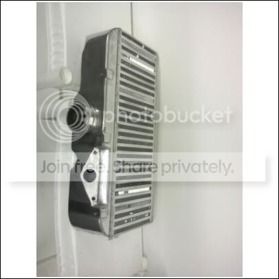

    I can pick up an ebay ssac tmic for $75 shipped w/o the y pipe, should I snag this or would it just be a waste on monies? Also can I use the wrx y pipe on the ssac unit?? The ssac is supposed to be a more efficent bar and plate design so I'd think the pressure drop would be lower as well. Thoughts?
    [​IMG]\
    size comparo

    I don't know about the pressure drop...
    you need a y pipe that will fit that IC, it's too tall for the stocker to fit.
    have it pressure tested if possible
    make sure the mating surface for the bov is really flat and not warped
    worth it for stock turbo? probably not unless you are already pushing modded injectors and a stage 2+ map with higher boost levels

    The STI TMIC is a great design, you'll likely lose power switching to that ebay unit. Not that the ebay unit is crap, it just won't cool as well as your STI TMIC with the stock'ish size turbo, period.

    You'll need a sti hoodscoop and splitter also to keep the bigger tmic cooler.

    FYI, I recently had a user on NASIOC PM me because he was running a version of one of my stage 2 maps and saw an increase in detonation after installing one of these ebay TMIC's.
    Personally, I think they're a decent deal for medium sized turbos, but worthless on the stock turbo.

    this^ im just gonna run my stock tmic with my vf34 cuz there isn't that much of a gain unless you are gonna go with a bigger turbo such as an 18g or 20g

    OP - Too many people I know have gotten huge pressure drops across those cheapo no-name intercoolers.
