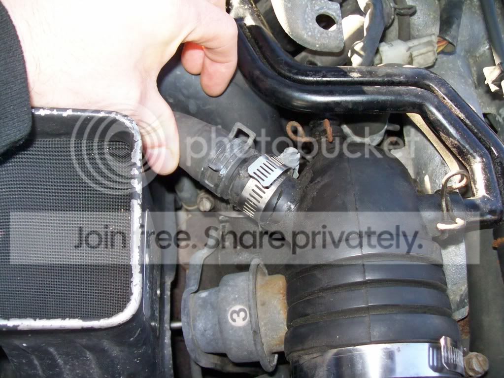

    notice the crack, well it is not a crack but the whole end is broke off.
  17. JasonoJordan
    1,726
    thats the main vacuum tube if i remember correct..
  18. piddster
    Looks like the size of the IAC valve hose.
  19. Andy93SS
    Andy93SS New Member
    Does this not go to the bypass valve, that was my understanding.
  20. piddster
    Well, trace the hose to its source. Pretty simple. It either goes to the valve on your intake or to the little black plastic valve. I'm not there to hold your hand.
  21. Andy93SS
    Andy93SS New Member
    You know just the other day I was saying how amazed I was with the people here on mnsubaru. Everyone has been nothing but helpful as this is not only my first subaru but also my first turbo vehicle. I come here seeking knowledge from people who have been there and done that. I replyed as I did because I DID TRACE IT and consulted my manual and it says it is the bypass valve. So correct me if I am wrong here in my understanding of exactly whats going on, but as an adult please keep the attitude to yourself.
  22. piddster
    Sorry, I was in a piss poor mood last night and probably shouldn't have been online. Bad form on my part.
  23. Andy93SS
    Andy93SS New Member
    No worries, I was just confused because I did look it over and then I get conflicting results here so I wanted to make sure I had the right info. Manuals can be wrong from time to time.
  24. piddster
    After looking at it closer, my frame of reference was backwards. That most definitely looks like the BPV hose.
