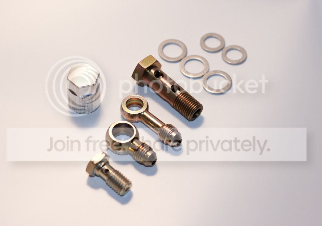

    Has anyone used the Infamous preformance filtered oil supply line... and if so what do you think of it so far.
  2. AWDimprezaL
    1,821
    Why, is what I ask, how many wrx turbos (02-07) have issues with failing? I say the filter is what destroys the VF40. Take it out, keep it out.
  3. tangledupinblu
    9,058
    Exactly! They should rename it "failter"...moar fitting name.
  4. Subie Lovers
    578
    My banjo bolts don't have the screen... But specifically the one into the turbo has an unbelievably small hole (insert ghey joke... yeah I know)... This kit seems to provide a bolt with a larger opening plus has a more accessable reuseable filter... so why wouldn't you???
  5. Subie Lovers
    578
    last bolt is new banjo in too the turbo... the hole is twice the diameter at least
  6. AWDimprezaL
    1,821
    Do you know that that hole is designed to be that size for a reason? Any more oil getting past that restrictor means the oil seals in the turbo cant handle it, and oil gets dumped directly down the exhaust. Its a journal bearing turbo, it doesnt need THAT much oil all the time.
    Moleness likes this.
  7. xluben
    That is a restrictor. You need it.
    Moleness, GiMp and AWDimprezaL like this.
  8. dang0
    dang0 Well-Known Member
    55
    I bought the kit a couple weeks ago and will install it next oil change.
