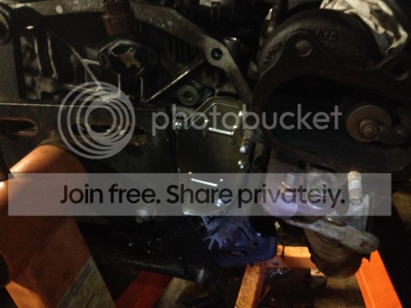

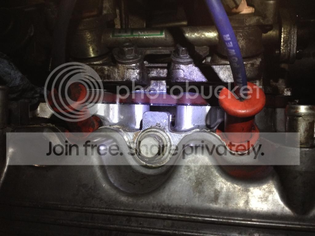

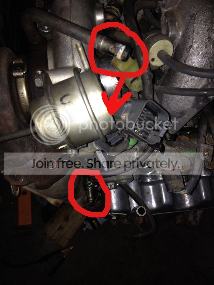

    Another clarifying question for water return and water supply to the turbo:
    For the supply I can just use some small coolant hose from the nipple on the head to the top nipple on the turbo. Right?
    (from the red circled top port on the TD04 to the nipple on the head for supply)
    (indicated nipple on EJ22t head. Just for clarity)
    But for the return can I just T into the IACV coolant line? I don't need to run a coolant reservoir, do I?

    In the aspect of coolant line I just used the stock vf11 coolant pipes at the turbo bolt right on and used the same coolant line routing as the factory turbo. So yes take the feed from the head and return back to the resivior. My resivior I had to rotate 90 to get the intercooler to fit which can be done but I would recommend adding in 90 degree elbows in the lines to prevent what happend to me and having the lines rip and dump coolant every where

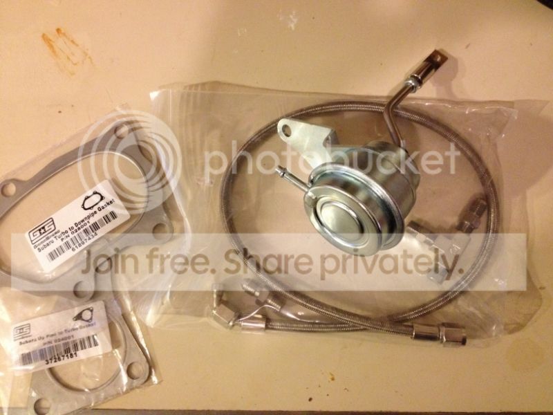

    I got some goodies in the mail today
    I got the wastegate the oil line on the turbo but the T fitting had the wrong threads for the EJ22T head.
    I will order a -4 AN to 12X1.25 adapter and hopefully have oil to the turbo sorted. Then install the up-pipe to turbo gasket and finally work out some filament issues.

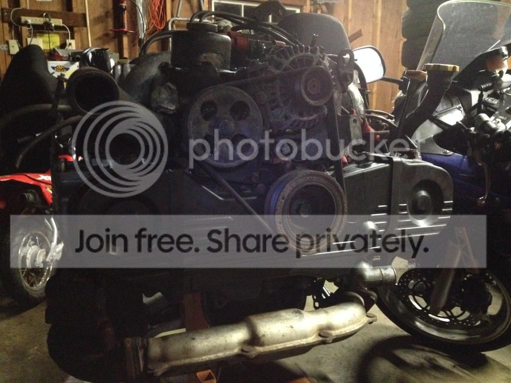

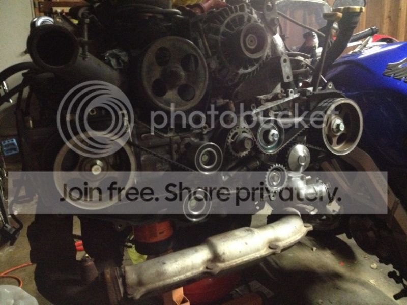

    Got the timing belt on. Im preeeeety sure it right. But not positive... It might be a tooth off but Its cold and the garage is dark so i'm going to look it over in the morning. There were 44 teeth on the left hand side and 40.5 on the right. I believe thats correct.
    I will post a better picture tomorrow.

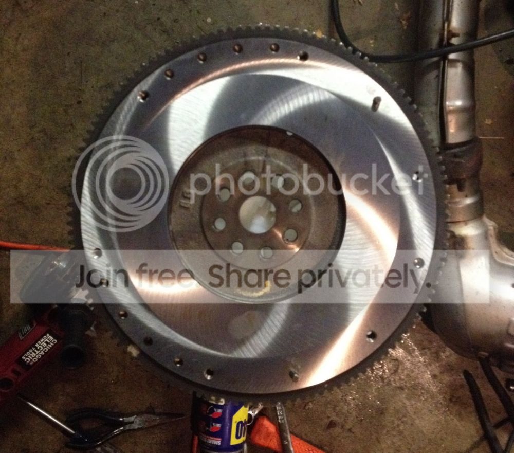

    Oil separator plate came on friday and my phenolic spacers just got here.
    Got the separator RTV'd and installed
    Flywheel resurfaced by Metro Engine Service. Installed and torqued down.
    Ntxhuav_Khang and Nhibbs like this.

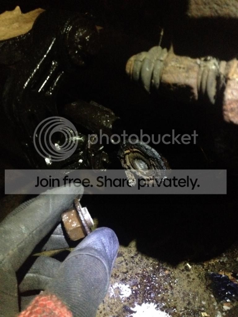

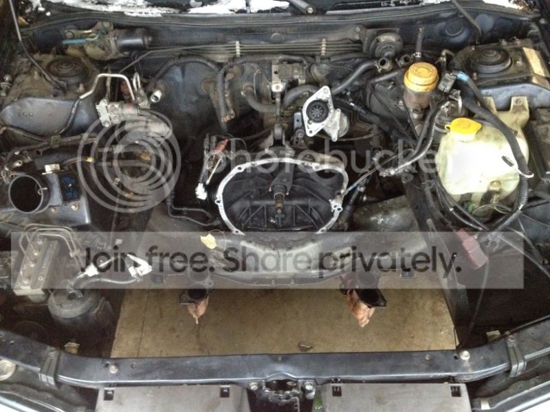

    Before I scrapped the shell I wanted to get a few odds and ends off, one of which was the passenger side rear wheel bearing.
    Got all the bolts off but 2. Then a nice grade 10 19mm bolt decided to rip in half. I was pretty pissed..
    After abandoning that endeavor, the tow truck showed up and we slid her up onto the bed and off she went!
    I'm going to clean up the garage a bit and pull the Legacy in and get to work!

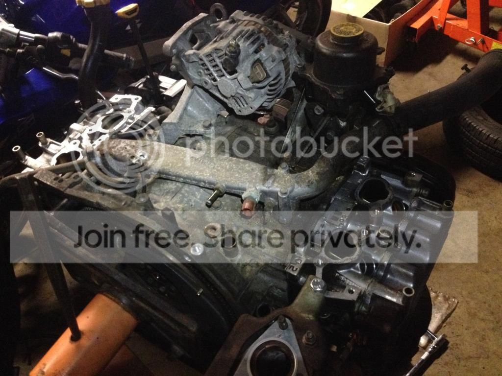

  29. Mattnes17
    Mattnes17 Well-Known Member
    98

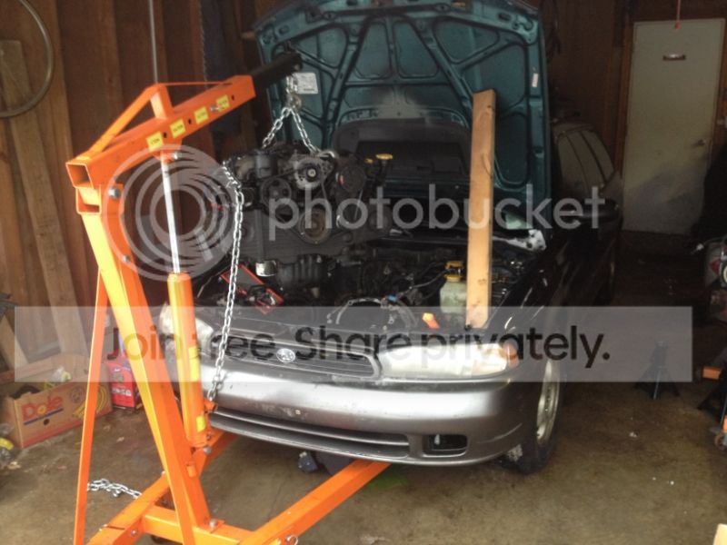

    It took me only 2 hours to pull the engine this time! I felt like a bad ass.
    The bay is nice and dirty. I will grab some degreaser and maybe even the powersprayer if its warm enough and clean things up a bit.
    I'm going to swap intake manifolds because there are some subtle but definite differences between the Impreza one and the Legacy one. I'll also be throwing the phenolic spacers on too :D
    EricS and phi11 like this.

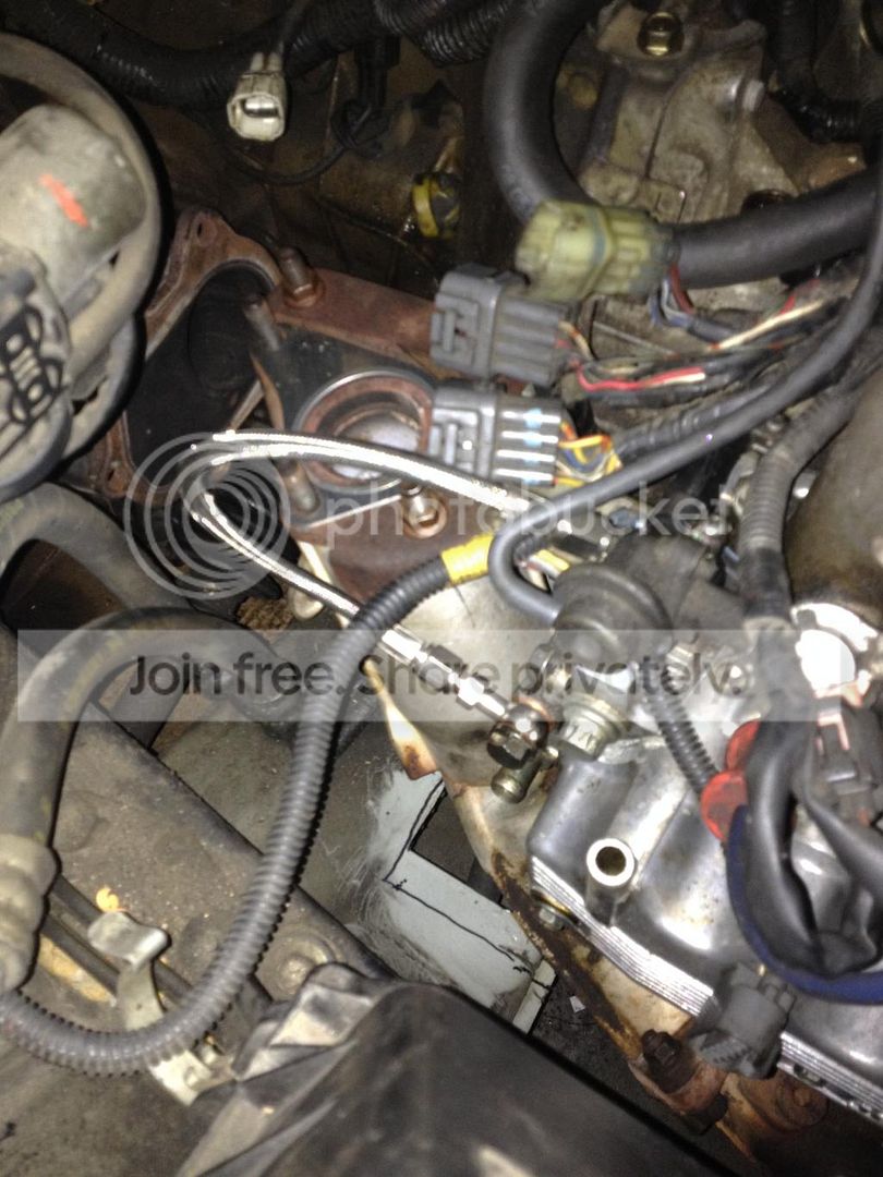

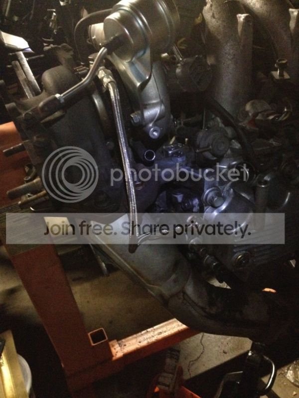

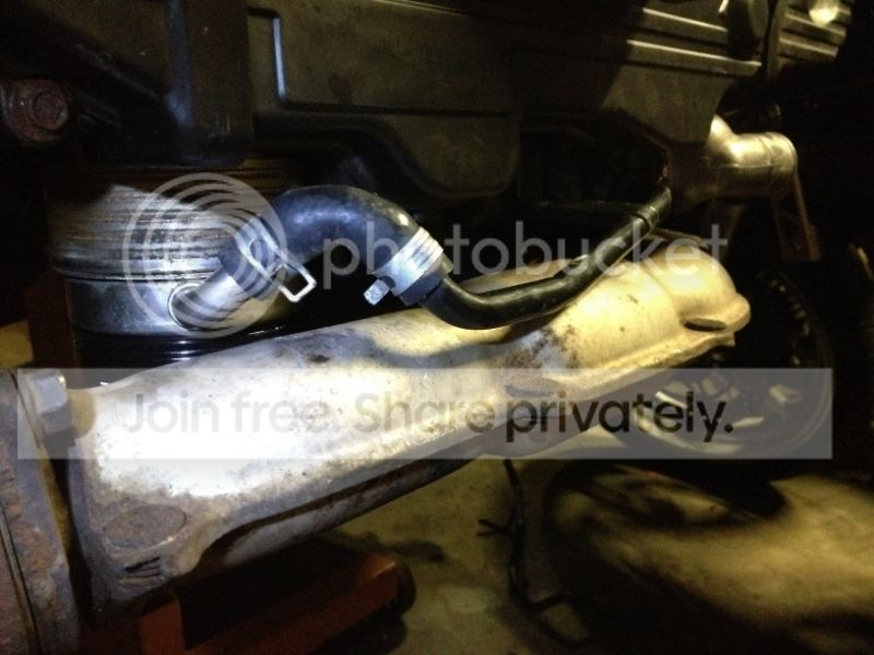

    Got a new oil line installed with the proper banjo bolts
    My new center timing cover also came in the mail. While installing it cracked slightly :censored: I just put a little dab of RTV on it to keep it sealed. Also got the crank pulley and the belt back on.
    I will be swapping the intake manifolds tomorrow afternoon. little by little, getting closer!

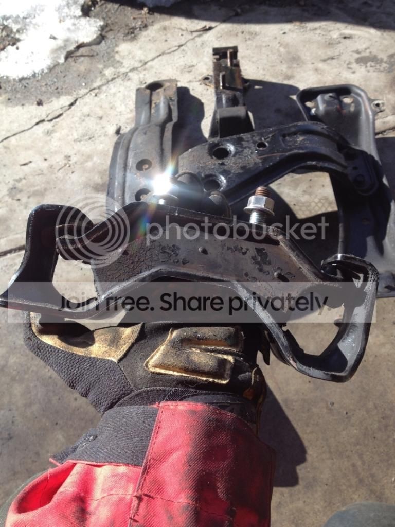

    Took a half day at work and got the new intake manifold gaskets, grimmspeed phenolic spacers, 95' intake manifold, and EJ22T pink top injectors installed.

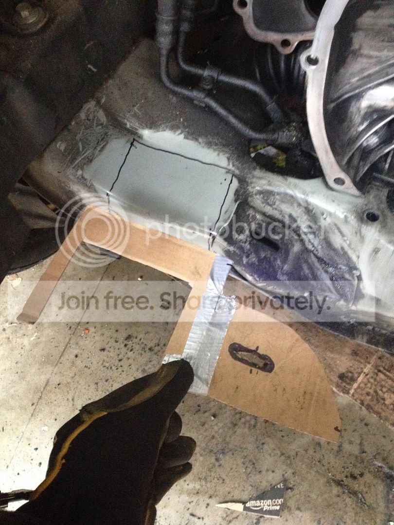

    I'm going to mark the subframe for cutting and possibly cut it tonight if everything looks good. Once I get that done and get coolant to and from the turbo the engine will be going in. Probably going to take another half day at work tomorrow because its supposed to be really nice out again.

    Testfit the downpipe, marked the engine cradle for cutting, and tried to figure out how the heck I'm going to route the PCV, crank vents, etc.

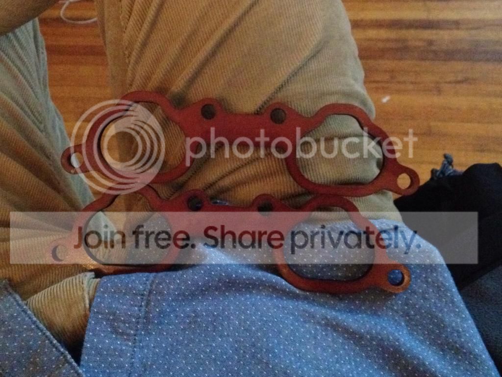

    Pics of Pink tops and Phenolic spacers

    I cut the subframe and figured I might as well see if the uppipe fit. It does! Perfectly! Then I figured I might as well bolt the engine to the trans. and plug in all sensors. I got a bit carried away and didn't even realize it was midnight!

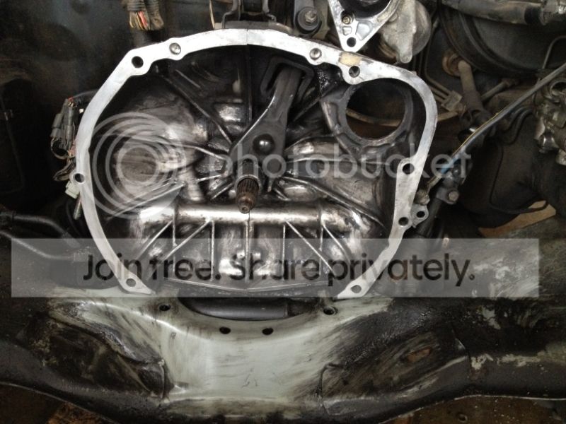

  40. Mattnes17
    98

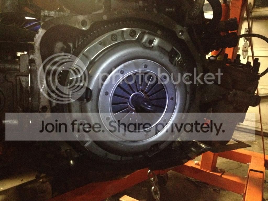

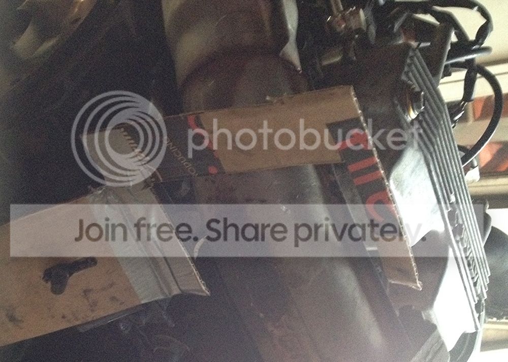

    Pics, because it did indeed happen!
    New Exedy clutch on
    Subframe cardboard mock-up
    That turbo sh!t :blink:
    You can see the line next to the actual hole. It was a misscut :p a little to close to the sway bar mount for my liking so I stopped cutting half way up and cut a bit further right. Im going to have my pal Jesse weld a little steel brace I made at work in there. Its crude but strong. I'll do that as soon as I get her running.
