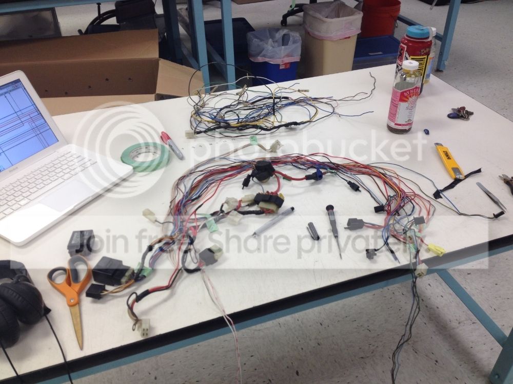

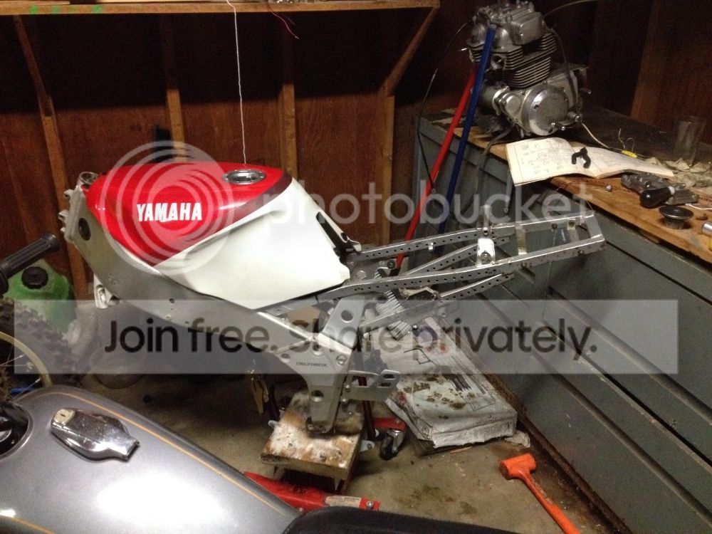

    In the mean time i've been working on another motorcycle project to keep my hands/mind busy after work. Its an FZR400. Picked it up for 50 bucks locally! I already had an FZR600 parts bike with a low miles engine that I picked up last year so i'm swapping the 600 engine into the aluminum 400 frame to build up a race bike!
    I pulled the wiring harness off the 600 and started slimming it down. Removed all the lighting, relays, horn, etc. I'm basically just going to run the charging system and the bare bones components (neutral light, oil light, fuel pump, tacho) I spent all last night at work listening to music, cutting up the harness.

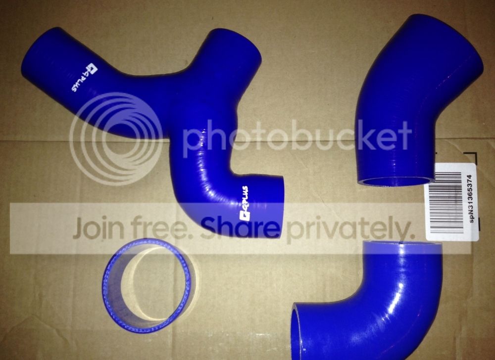

    FINALLY my parts came yesterday. Silicone Y pipe, TDO4 inlet elbow, and the top mount to throttle body coupler.
    I'm leaving work at 3 and going to do as much work in the garage as I can without freezing to death.

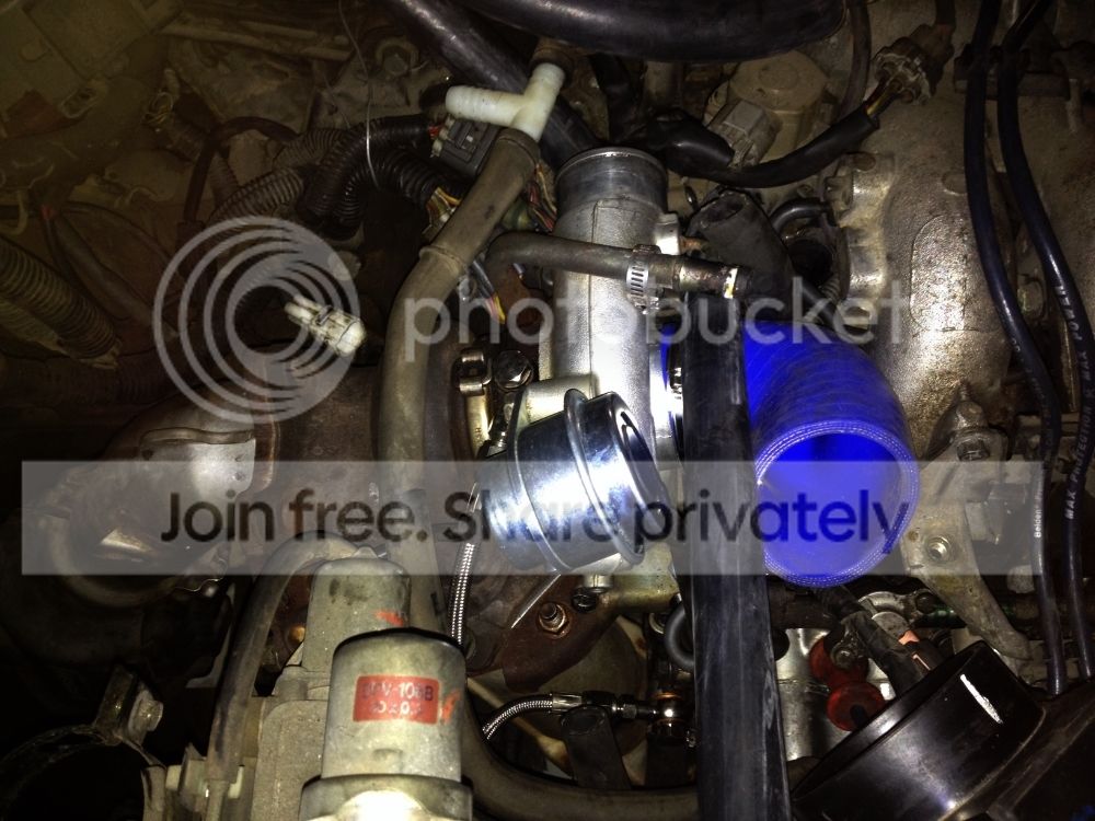

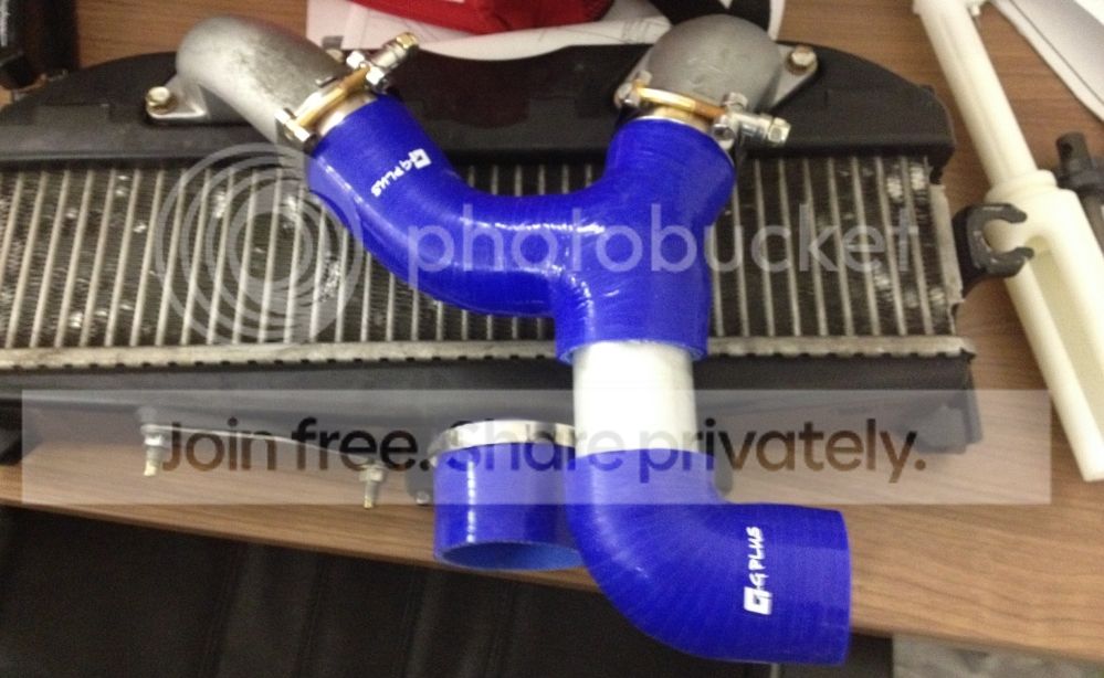

    It's been a while since my last update but a lot has happened!
    Iv'e got all the silicone parts installed, Y-pipe modified, intercooler on, turbo bolted down, downpipe on, and O2 sensors in.
    Turbo and 2.25 elbow installed with downpipe mocked up
    Extended Y-pipe leg
    I ran into a few issues with the intake, post MAF. I was planning on putting a 3/4 in hose adapter in the silicone 45 reducer (which I got to fit over the intake by heating it in the oven :p) but the way I was going to seal it in there just didn't seem secure enough to me. So my temporary solution is to put the 3/4" hose adapter in a 2" piece of PVC, cut down the 45 degree coupler a bit, install the PVC section, just run the IACV to the adapter, and try starting her up.
    I ordered a completely redesigned intake I mocked up that wont use the stock airbox or the PVC adapter. The parts should be here Monday. But I would really like to get it running tonight! I will post a video if I get it started!!! :thumbup:
