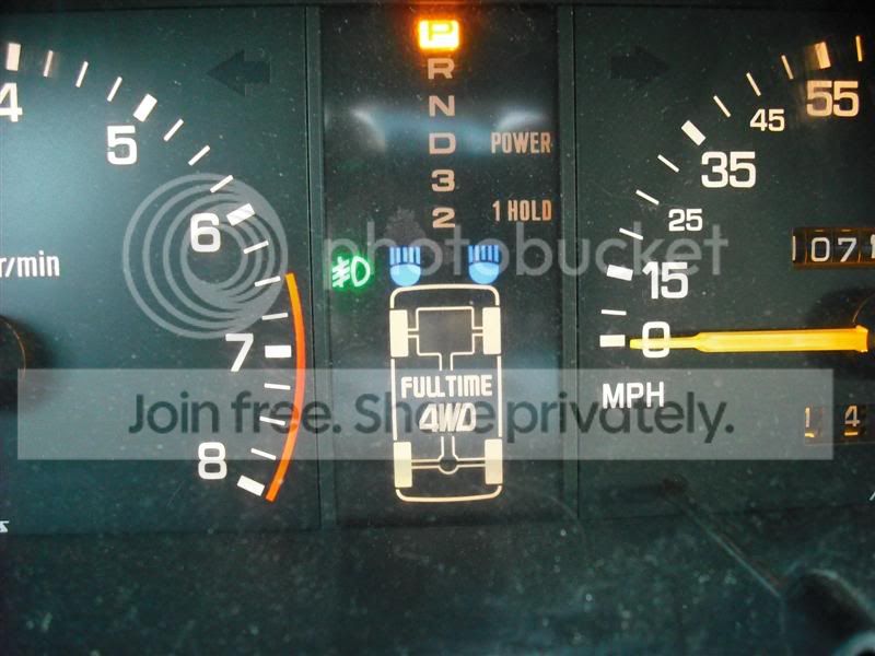

hard to tell from those write-ups, as they don't refer to wiring diagrams (wow...I've been staring at diagrams for so long, write-ups with pictures don't even make sense any more :eek3 anyway. looking at the 04 impreza FSM that I have, looks like all you'd have to do is ground this wire at the switch (notice the little red line I added to bypass the diode and headlight switch straight to ground. you don't have to ground it there, anywhere will do. when I did it on my XT6, I grounded it with the radio, which I was installing at the same time). it looks like you might have to cut that RG wire between the high-beam relay and fog switch, and hook the switch up to an ign switched power source, as the other diagram doesn't really make sense. but, in theory, that wire should get power all the time, as it's the R wire from that relay that goes to the high-beams. so it's still on the un-switched side of the circuit. couple pics of my XT6 with this mod:
