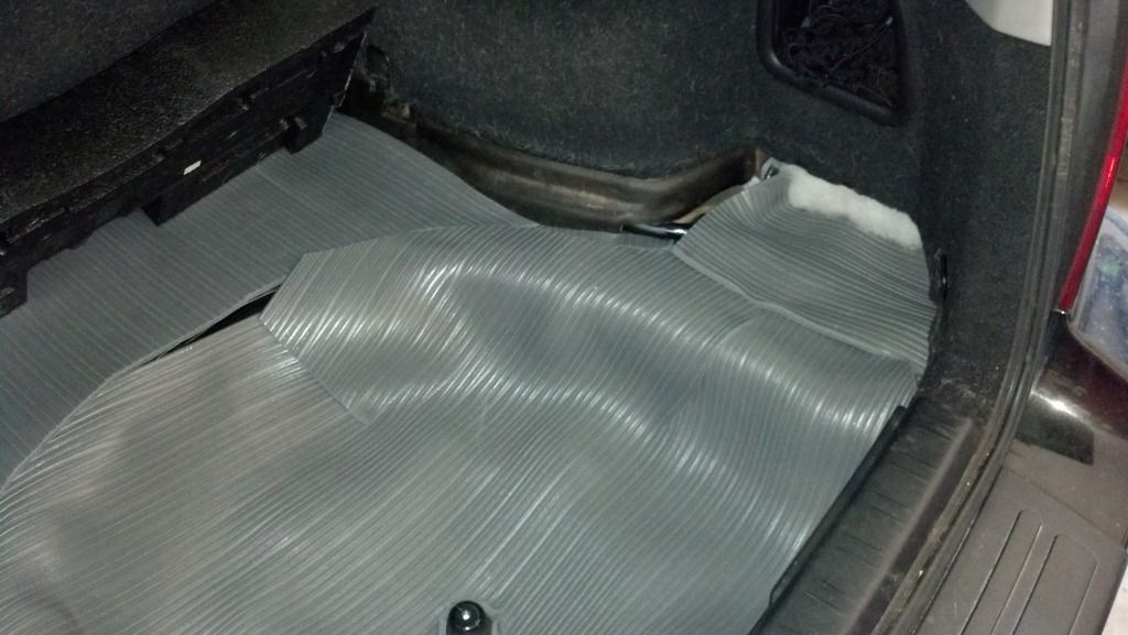

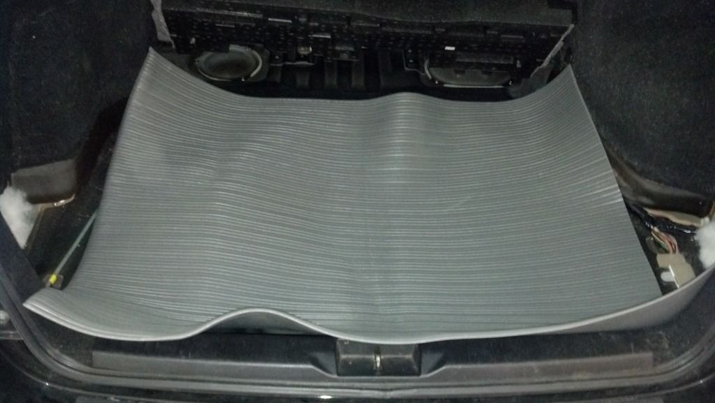

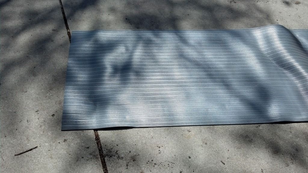

    Enter LOWES! After searching around at Home Depot, Menards and Ace hardware I found some material at Lowes in their Carpet section that i figured would work a lot better then poly-fill like some members have utilized. It is 3' wide and is sold by the linear foot (length) at around $3. I ended up buying 6 linear feet totaling about $20. After installing the initial drive was noticeable quieter. The drone was much less noticeable and overall I am quite pleased with my maybe $25 investment. I'll give an update on my first road trip back to my parents as that will be, for me, the real test.

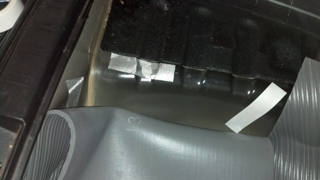

    I used carpet tape to hold it in place.

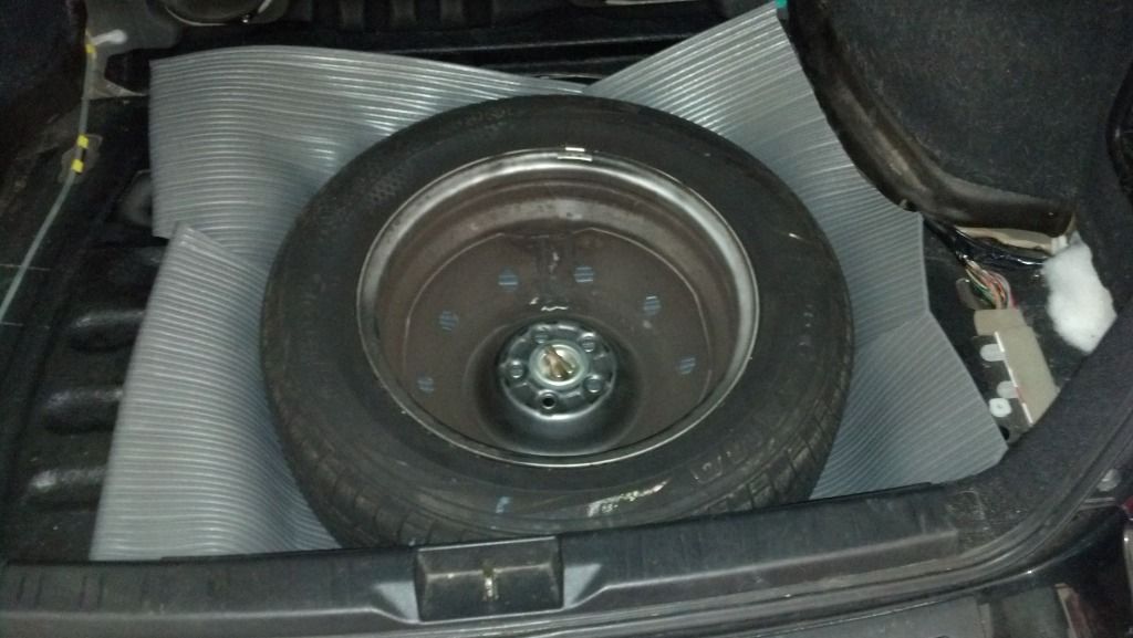

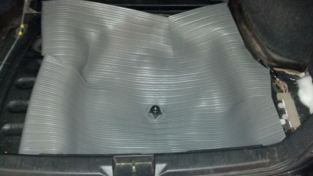

    From there I started with the spare tire area and just cut and fitted as needed. There was no exact measuring done, just lay it down mark here and there and make a few cuts to accommodate for the curvature of the wheel well. The Rest of the pics are the 40 min or so process.
    Rear cargo area
    40" or so section test fit
    Cut and test
    spare tire test fit
    Taping down wheel well section
    Trim and test fit left side
    Right side

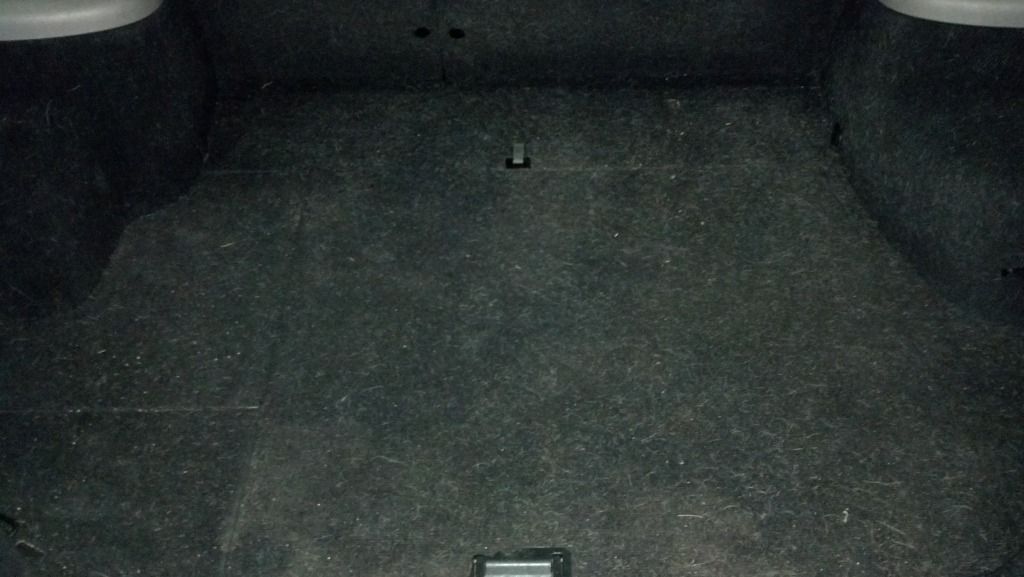

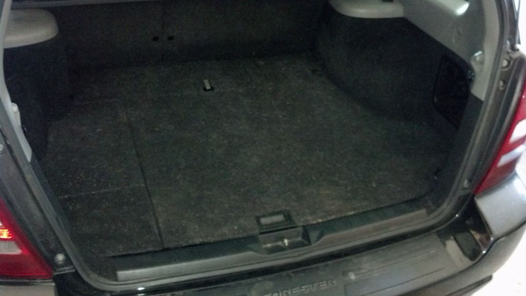

    Reinstall

    I can still hear my exhaust through the cabin. It just doesn't resonate nearly as bad. There was a "perfect" rpm range that just resonated like crazy through the cabin when I was on the highway due to the open cabin and lack of sound deadening material prior to this. After the mod I have yet to hear that and have just enjoyed hearing the Turbo spool more and the low mellow tone of the exhaust. I'm sure if there was an actual comparison with a decibel meter, the difference across the entire spectrum would not change much as I can still clearly hear my exhaust and road noise. The amplification that came with the exhaust note to the steel directly above is definitely reduced.
