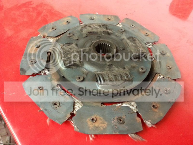

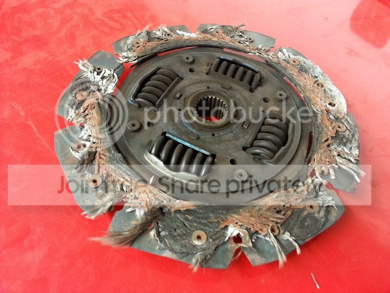

  20. Nuke
    Well, this is what we found
    Enjoy
    Tim, ofspunk7 and Deride like this.

    Looks a lot like your friend's life expectancy just dropped significantly... ;)

    Enjoyed so much did a rat get in there?

  24. Talonted
    Talonted Well-Known Member
    78
    holy ****! is that even possible? apparently.. impressive.
  25. KA-T_240
    KA-T_240 Well-Known Member
    Is that even possible in a short time driving the car?
    Pics of the flywheel?

  27. Nuke
    surprisingly the flywheel looked fine...

    Holy crap and crap!!
  31. derp
    That'll buff out.

  32. Back Road Runner
    47
    Well, that looks...weird.
    As a guy who's beaten the piss out of a NA Forester for 7 years with something sizably north of 200 redline launches and about 120k miles on a bone stock from the factory clutch that still works like 100k miles ago when I first bought the thing, I really have no idea how you can wreck these clutches so easily.
    Abuse should just glaze the clutch, just like you'd do to cheap, organic brake pads. Falling apart, I would think that's a completely different issue, a material failure...for whatever reason. That's not worn down or burned. That's just chewed up, torn apart. Cheapy aftermarket replacement? Adhesive failure? Animal playground? I don't know. I wouldn't call it user error though. I'd be more inclined to call it crappy engineering or external influences at play.
    Then again, I don't know much about clutches. They're just inverse brakes to me, lol.

  34. TMF
    You sure you didn't pull that our of this:
  35. Chux
    1,507
    +1. I don't believe this could be from such a short drive, especially on a non-turbo car. I've seen that happen before, but with poor quality parts.
    How many miles were on this clutch? Brand? Maybe your friend gave it the final straw.....but I think it was merely coincidence that it failed then.

    StanmoXT Well-Known Member
    A friend of mine had this happen to her 1999.5 Jetta. Co-worker borrowed it to run an errand. Called a few min later saying it was broken. Shop found a clutch that looked like the first pic, but on both sides. Pads completely gone and no scratches on the rivets even.
