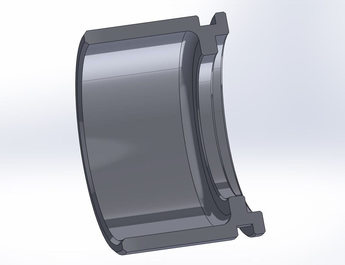

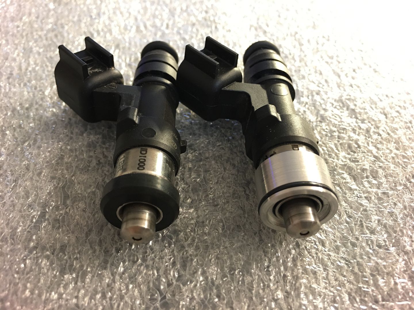

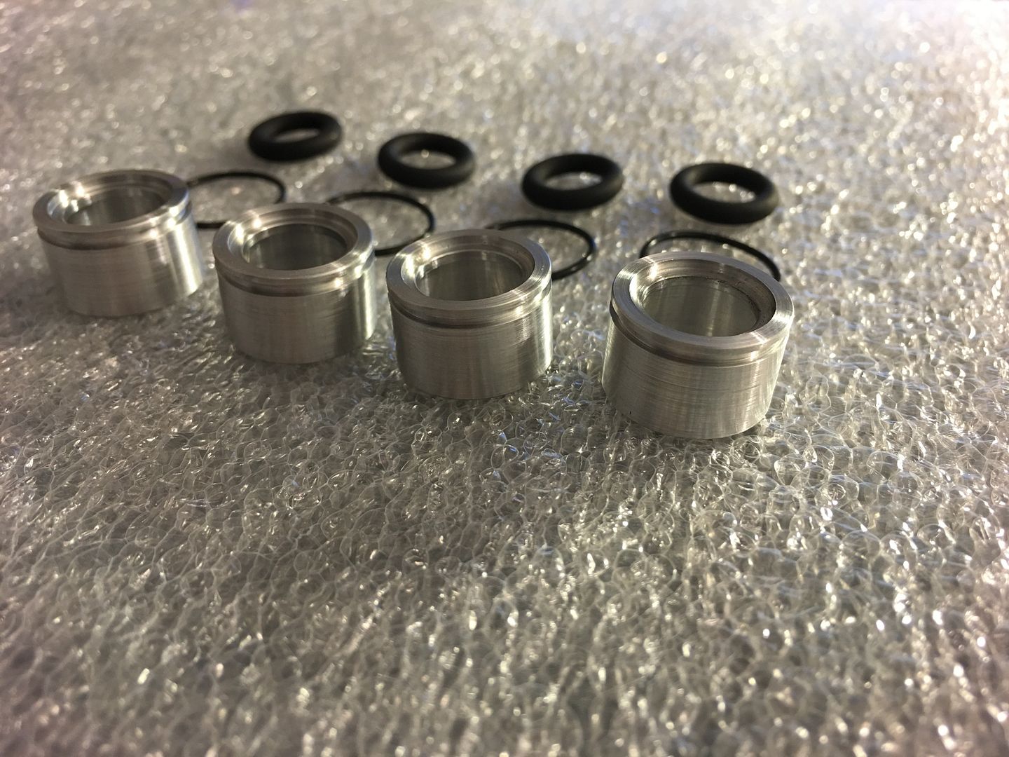

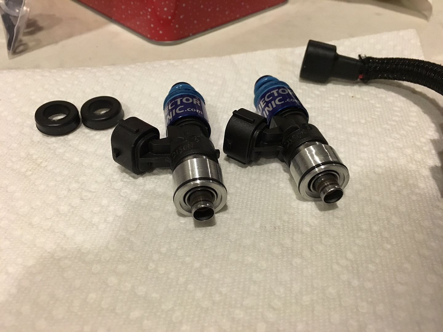

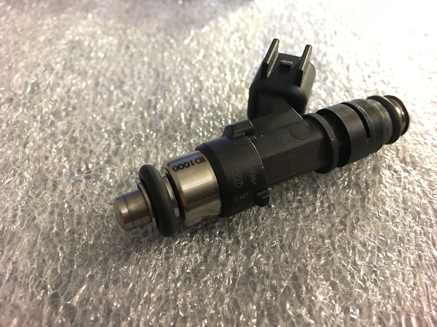

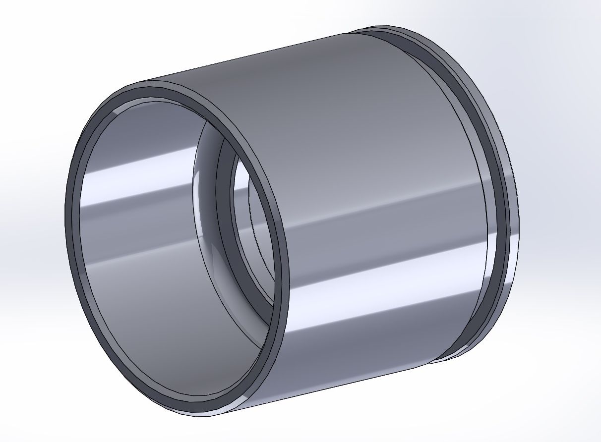

    The square cushion used to seal Subaru style top feed injectors are junk, these require downward pressure and do not work well or at all if the injector floats. ID has introduced an adapter that now comes with new injector purchases (resellers) but these adapters will not work with older style ID injectors because it causes the injector seating length to increase (the new style injector bodies compensate to get back to OEM length).
    So i thought why not make an adapter that will work with these older style injector bodies that came with square cushions :)
    They seal into two places, one o-ring is used on the injector to seal the inside of the adapter and the second seals around the outside of the adapter when pressed (has to be a tight fit) into the tumbler/TGV injector port. The adapters work with or without downward pressure and can float a small amount (1/32" or so).
    These adapters will be machined from billet 6061 aluminum, anodized and be supplied with Viton o-rings.

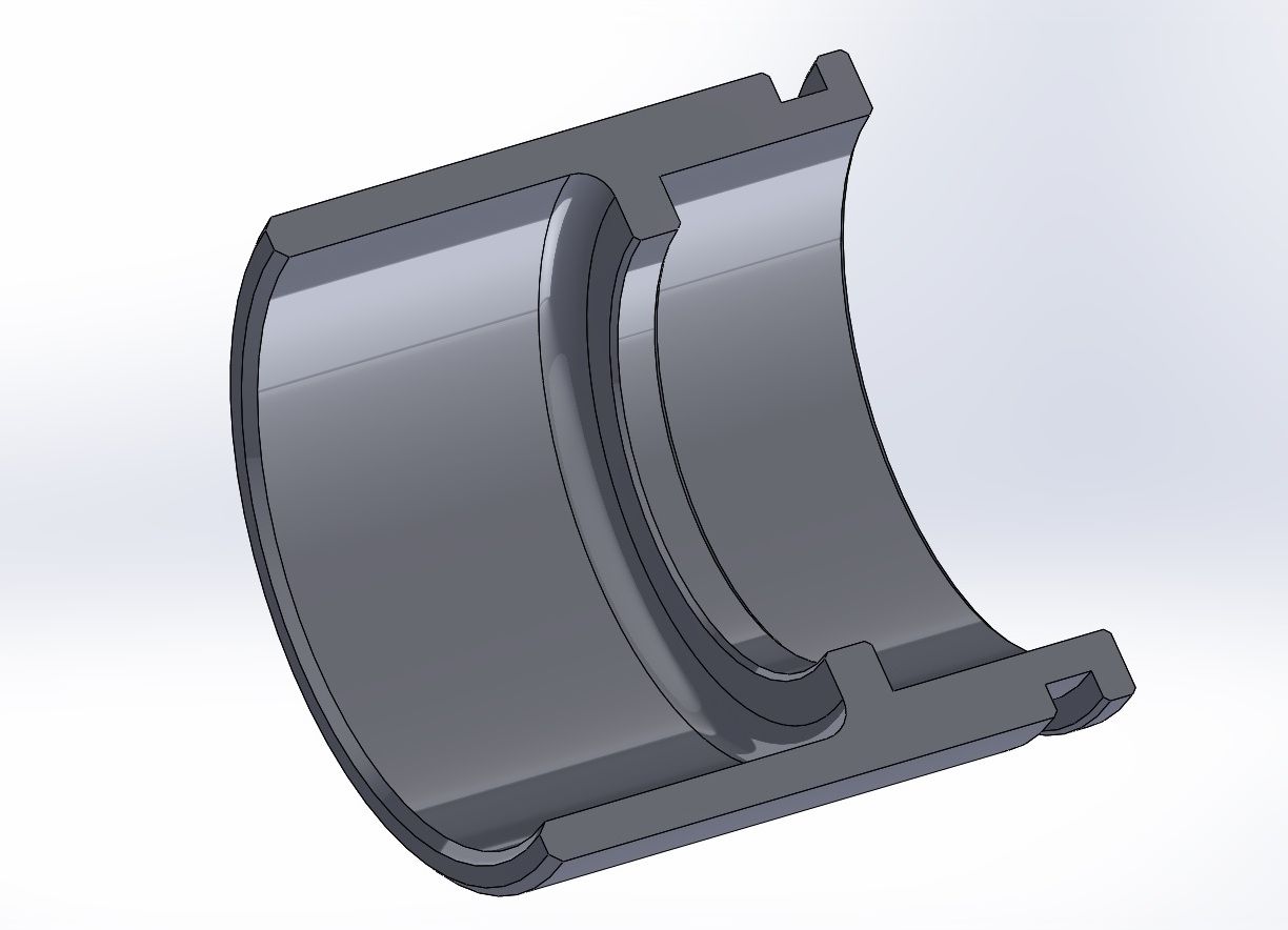

    If the adapters need to be removed it can be very difficult, so i have added some relief pockets at the end of the adapters so a dental pick can be used for removal.
    Some injectors came with one cushion and some came with two cushions, i have designed two styles to accommodate more injectors. These have not been tested with injectors that came with anything other than square cushions, so i can't confirm fitment.
    These are not branded or affiliated with Injector Dynamics and any questions, concerns, comments or anything related to these products must come through Aluminati.
    Pictures :)

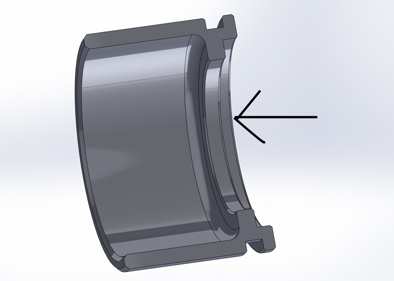

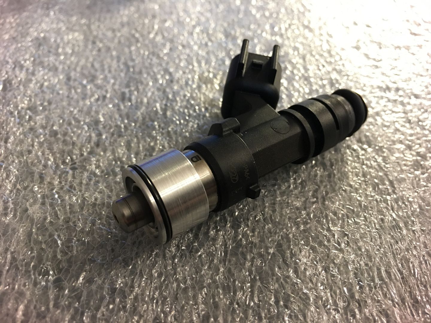

  2. xluben
    I can't wait to use these. The old ones always leaked at high boost.
    Where is the removal feature?
  3. Aluminati
    Aluminati Vendor
    636
    178
    Its at the bottom, its a pocket turned into the adapter to get a pick on it :) (the long version has a deeper pocket since the adapter had to be longer)

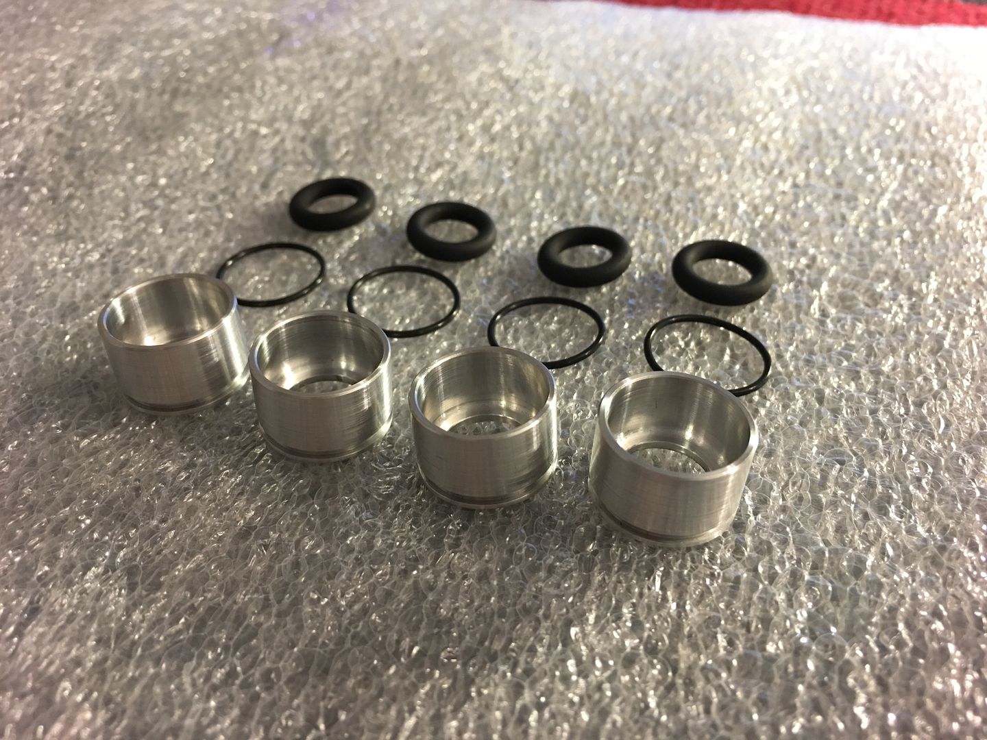

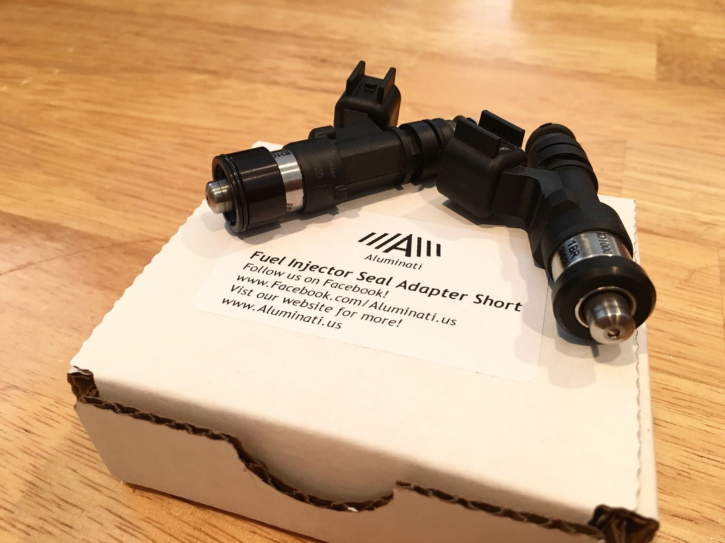

  4. Aluminati
    Aluminati Vendor
    636
    178

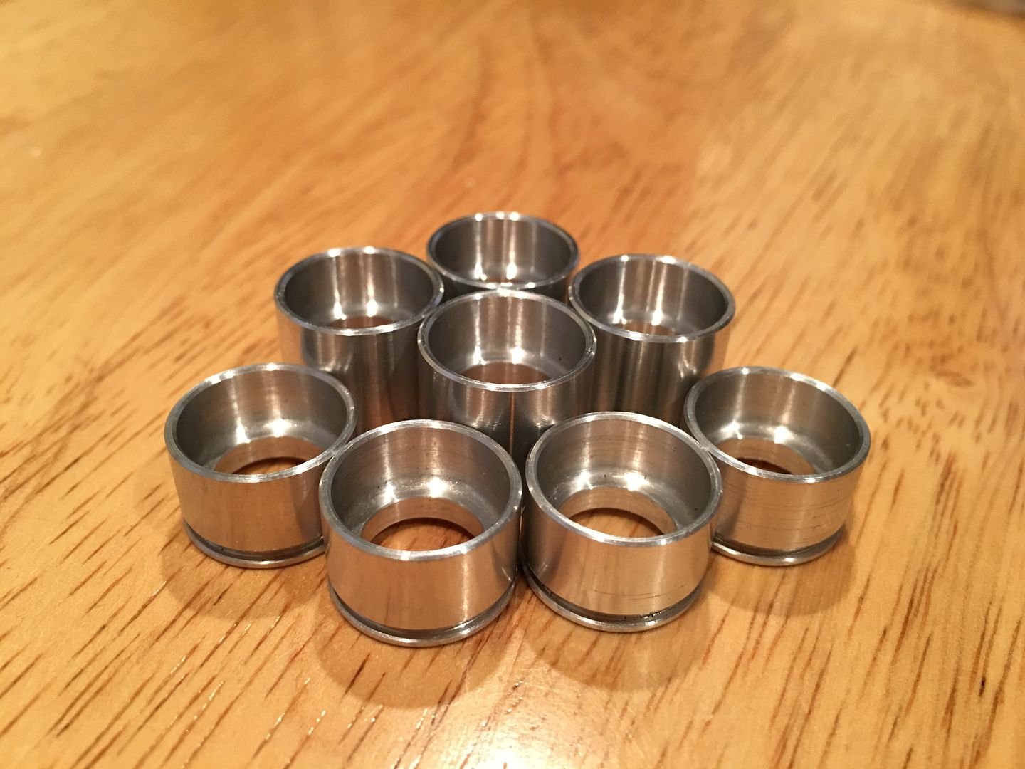

    Made 4 short adapters for final testing and everything works great! As you can see there is a inner o-ring and outer o-ring for sealing.

  5. EricS

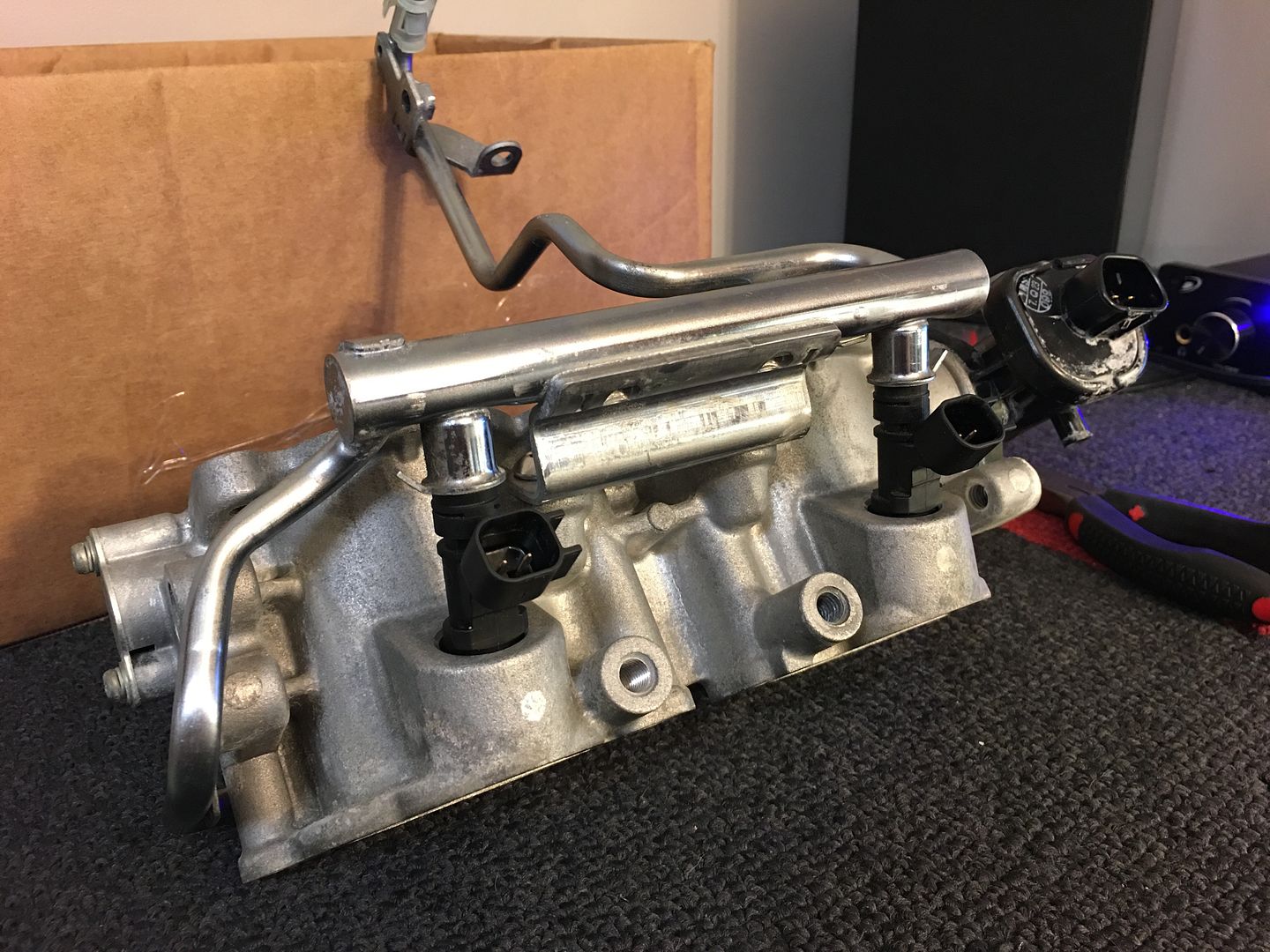

  11. Aluminati
    Aluminati Vendor
    636
    178

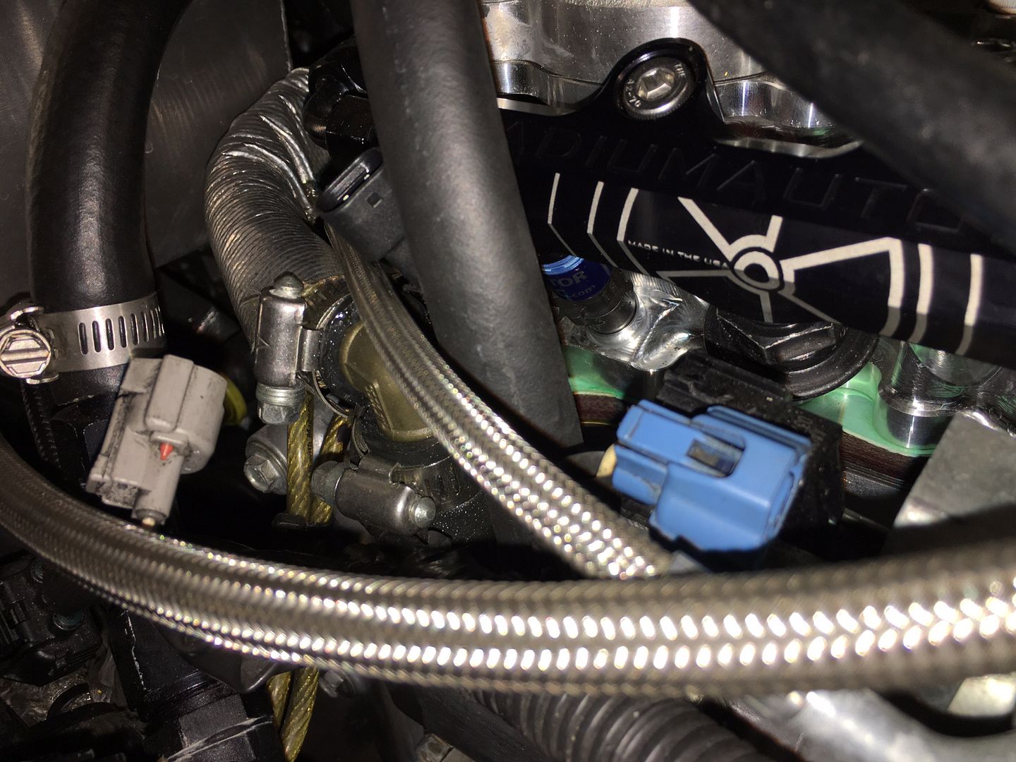

    Shout out to Jeff Chang for test fitting my fuel injector seal adapters on his car! Everything works great as expected.

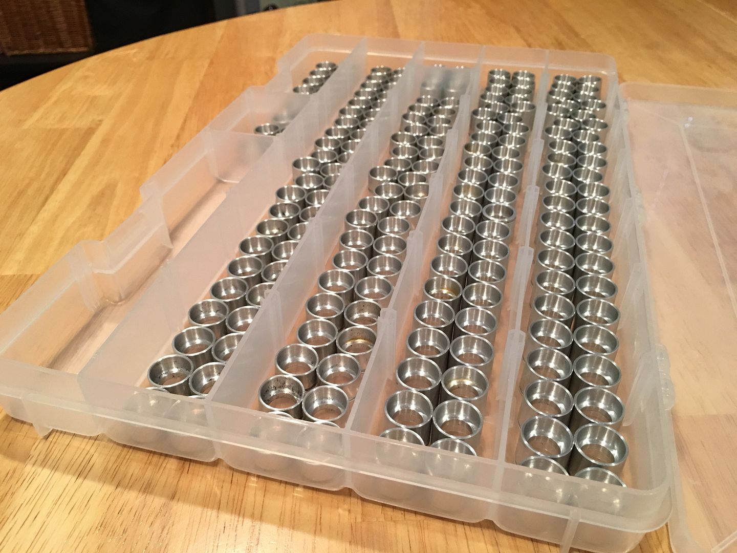

    Fuel Injector Seal Adapters are back from anodizing and ready to ship. These will be on the site in a week or so but for now send me a message or use the "Contact Us" form through my website.
    $59.99 for short and long versions.
