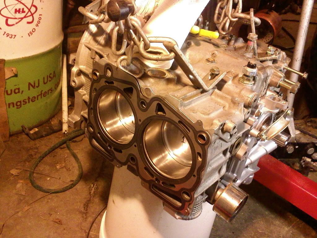

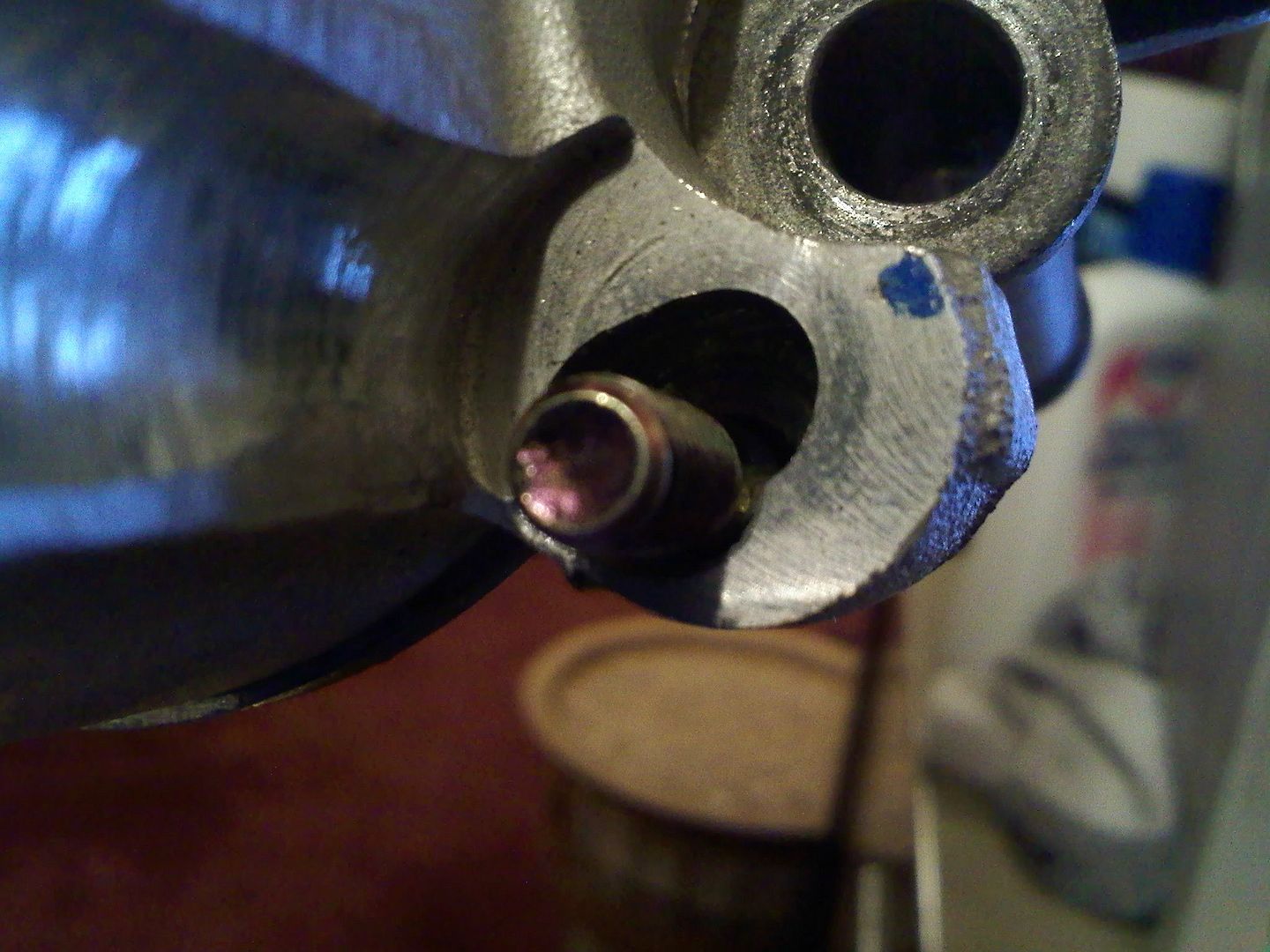

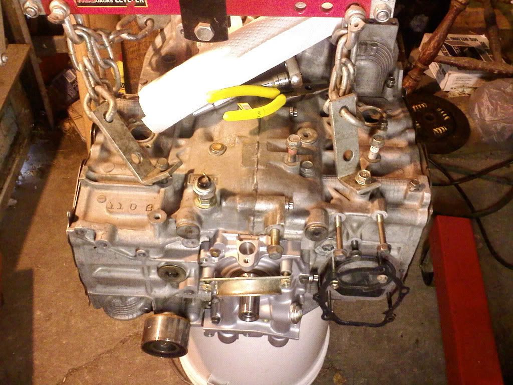

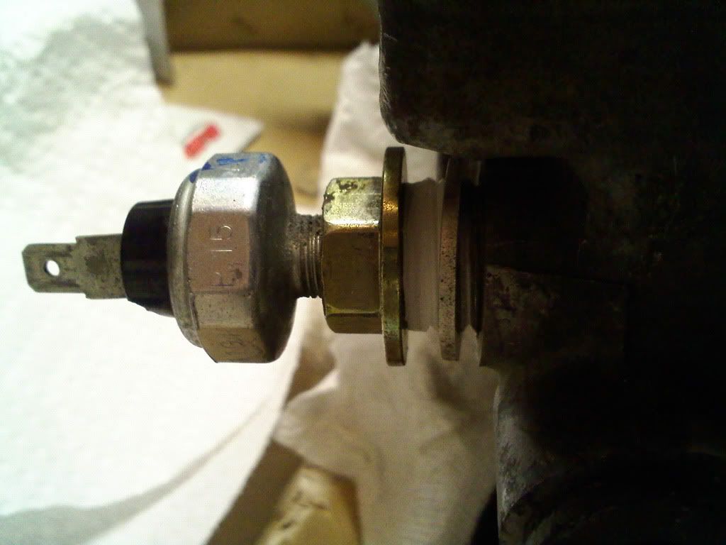

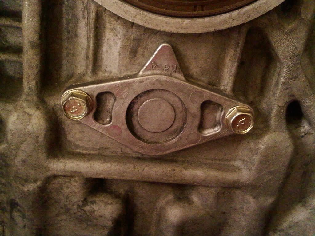

    a few more pics tonight. i love my match piston to combustion chamber. put back on the oil pressure switch and the wrist pin service plugs.
    [​IMG][​IMG]
    [​IMG][​IMG]

    Northern Tool has a 14mm hex key for like 9 or 10 bux. Or at least the used to. The socket would be better though. I needs one. And not one from the Snap-On guy.
  4. FuJi K
    ya, i stopped by autozone and picked up a set...12mm/14mm/17mm socket version.
  5. FuJi K

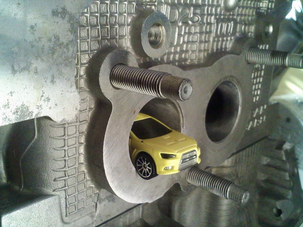

    So powerful it'll eat your EVO up!!!!!
    [​IMG][​IMG]

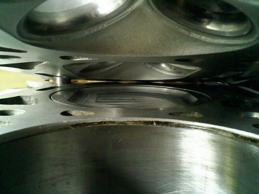

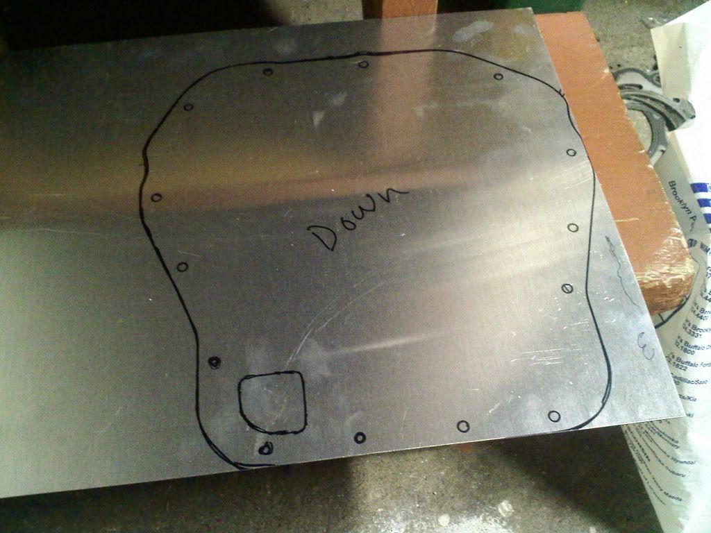

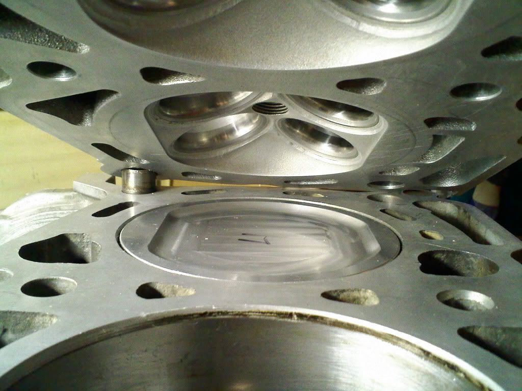

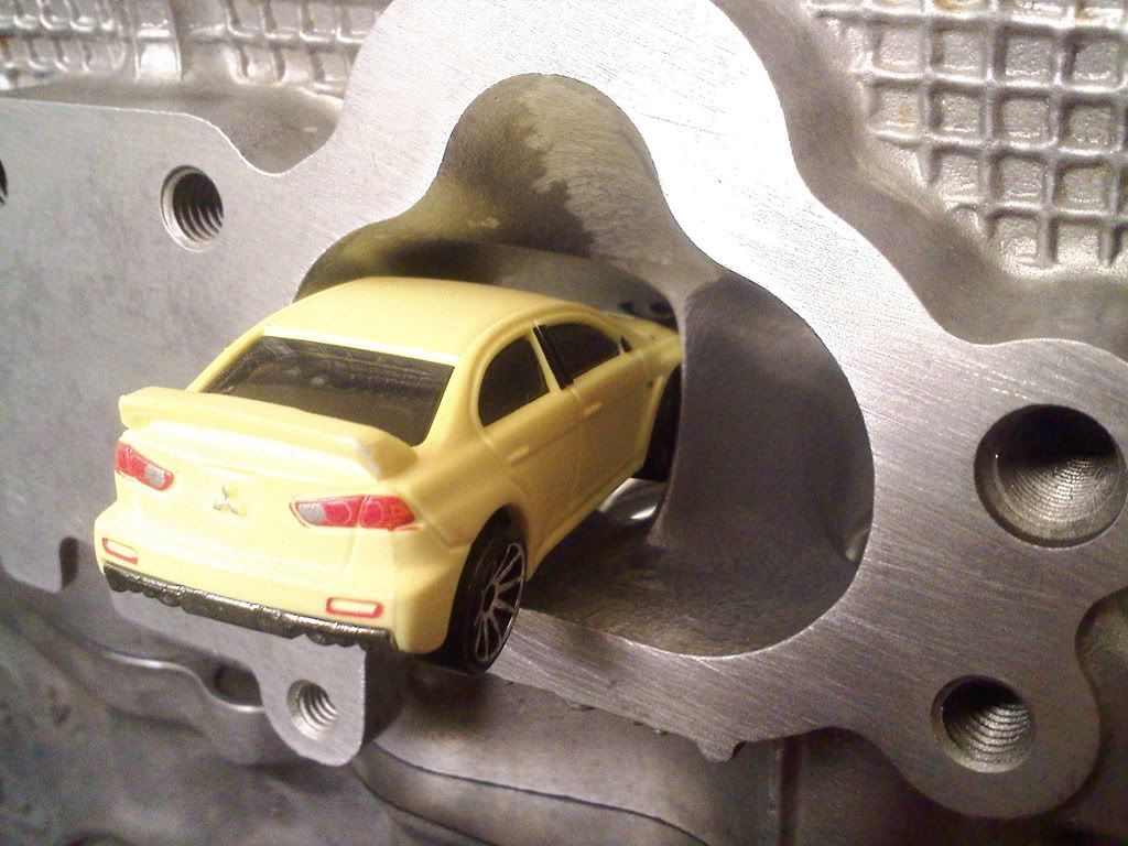

    here's to keep my oil in my oil pan. I fill up the NEW '06 WRX oil pan with a gallon of water, it's like 1/2-3/4" from the top! Oh yes, and my snack!!! Pork stuff buns? Forgot what they're called.
    [​IMG][​IMG]

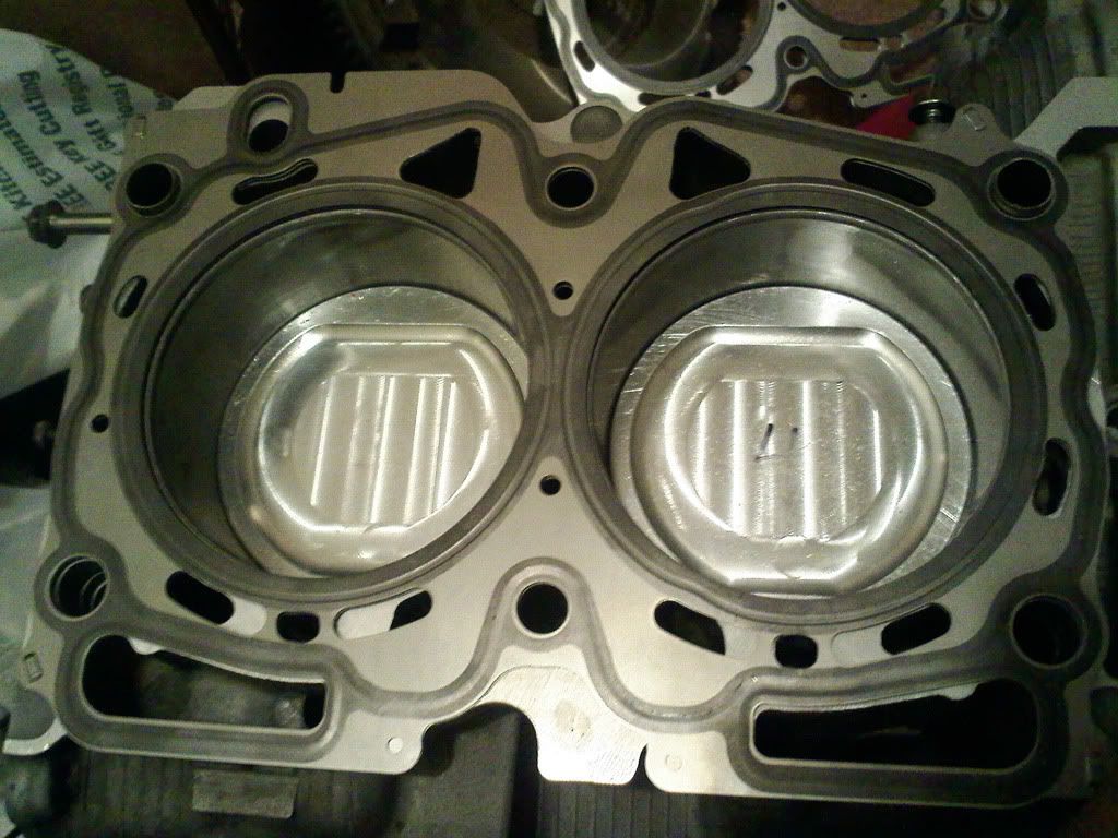

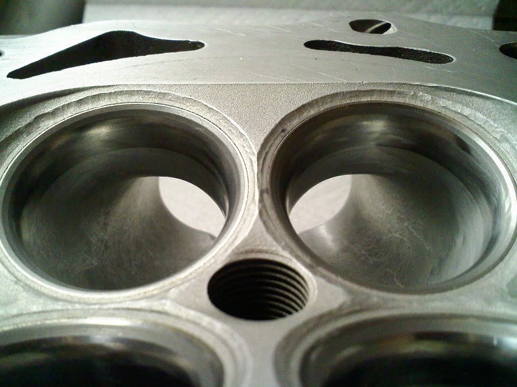

    My quench!!!! You can see!! QUENCH!!! I like my piston's dish.
    [​IMG][​IMG]
    [​IMG][​IMG]

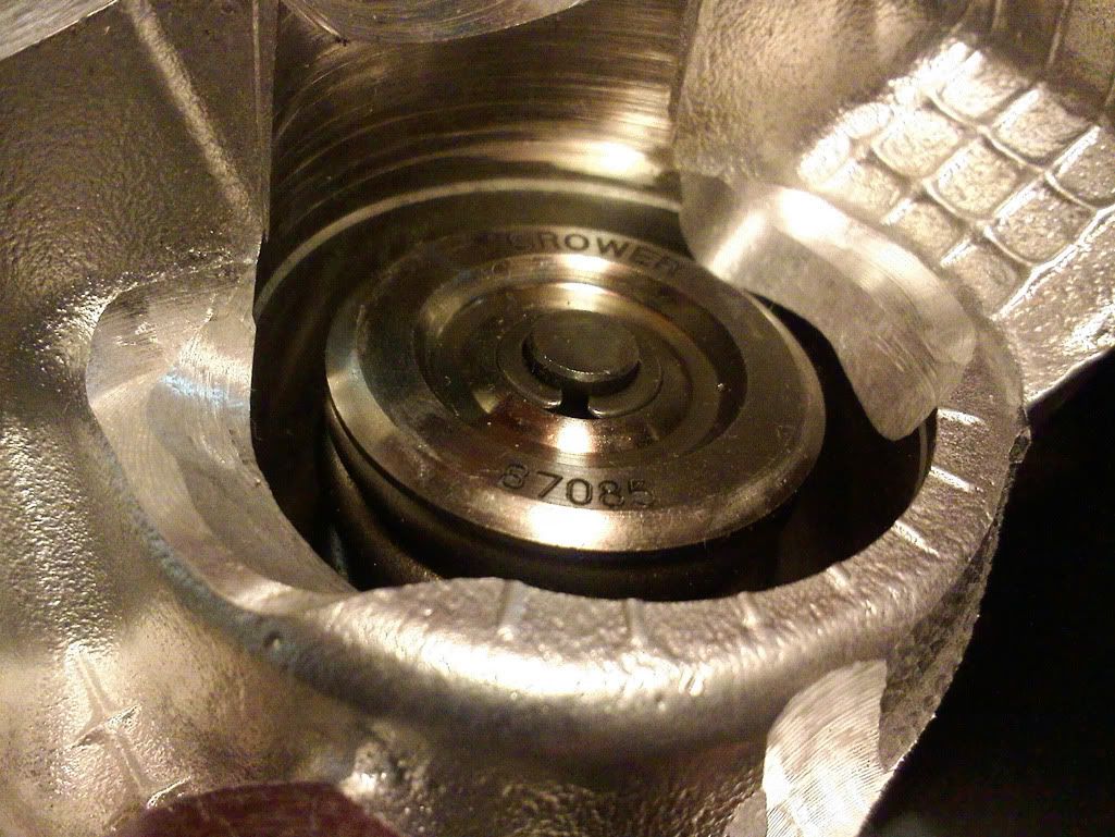

  6. FuJi K
    Valve spring installation onto the EJ255 head. Crower Valve springs and retainers.

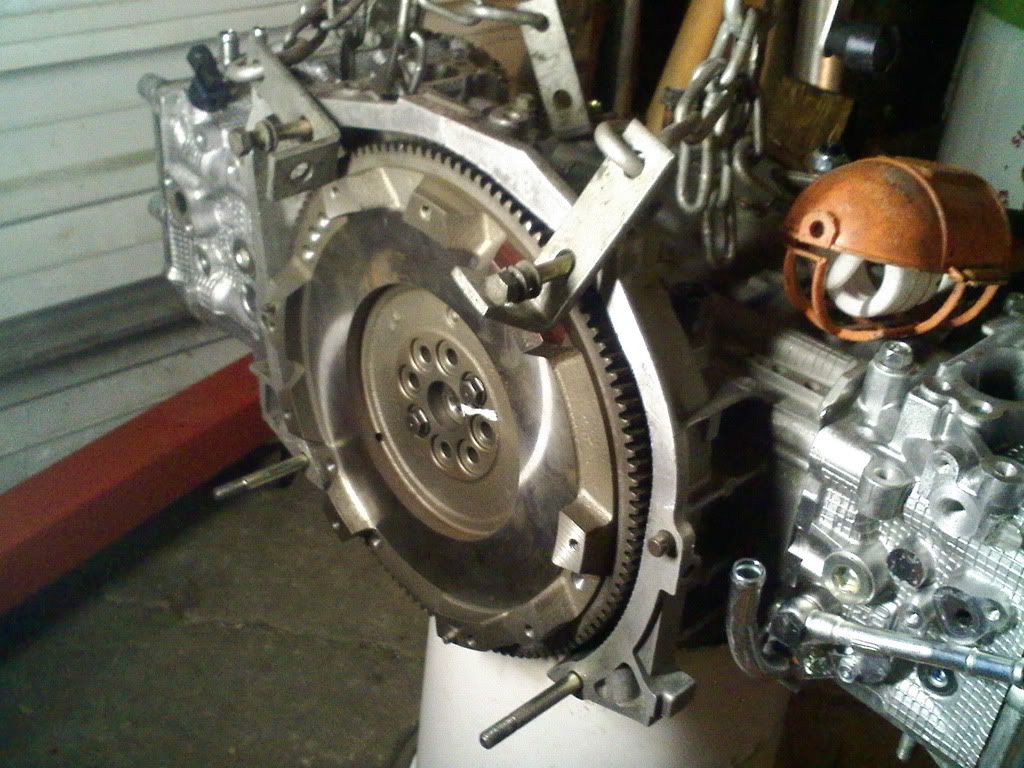

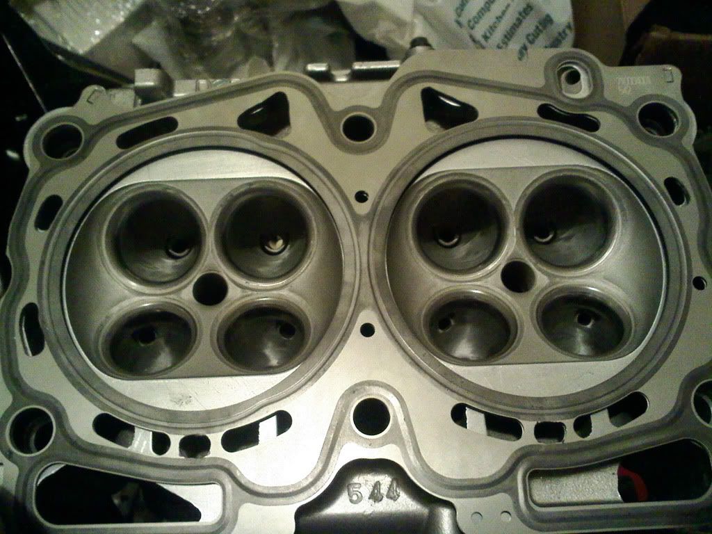

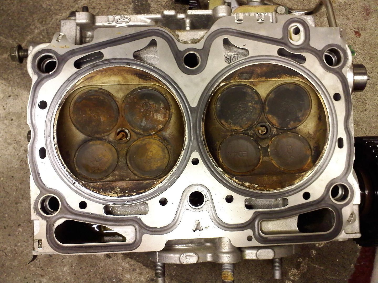

  8. FuJi K
    ^^^^^Thanks Mike!

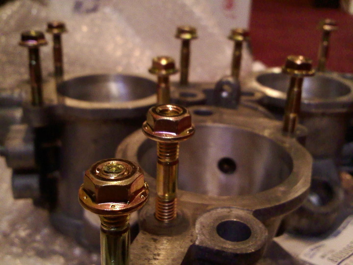

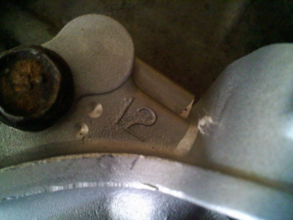

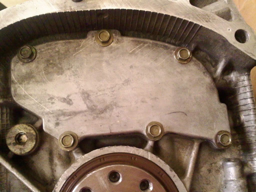

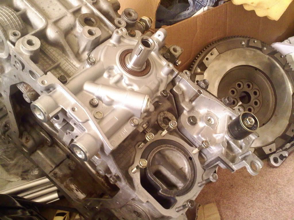

    12mm oil pump, not shimmed. Also timing belt cover to head/block bolts instead of philips screws.
    [​IMG][​IMG][​IMG][​IMG]

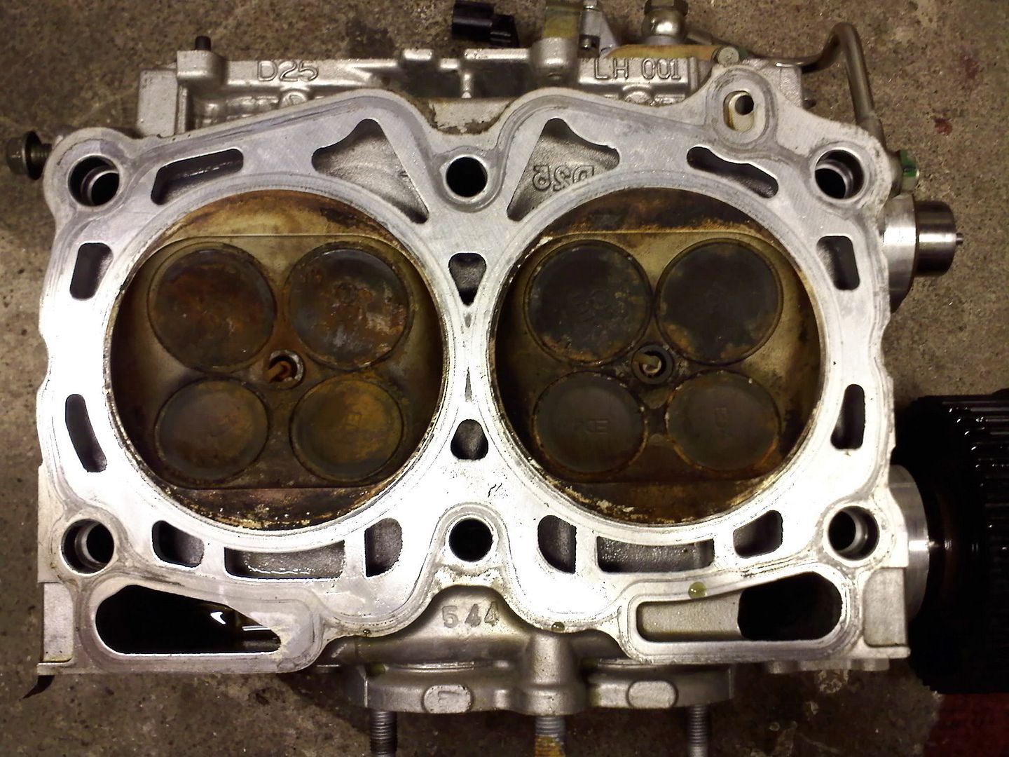

    What do you see different here......
    [​IMG][​IMG]
  9. Impreza 2.2 T AWD
    Impreza 2.2 T AWD New Member

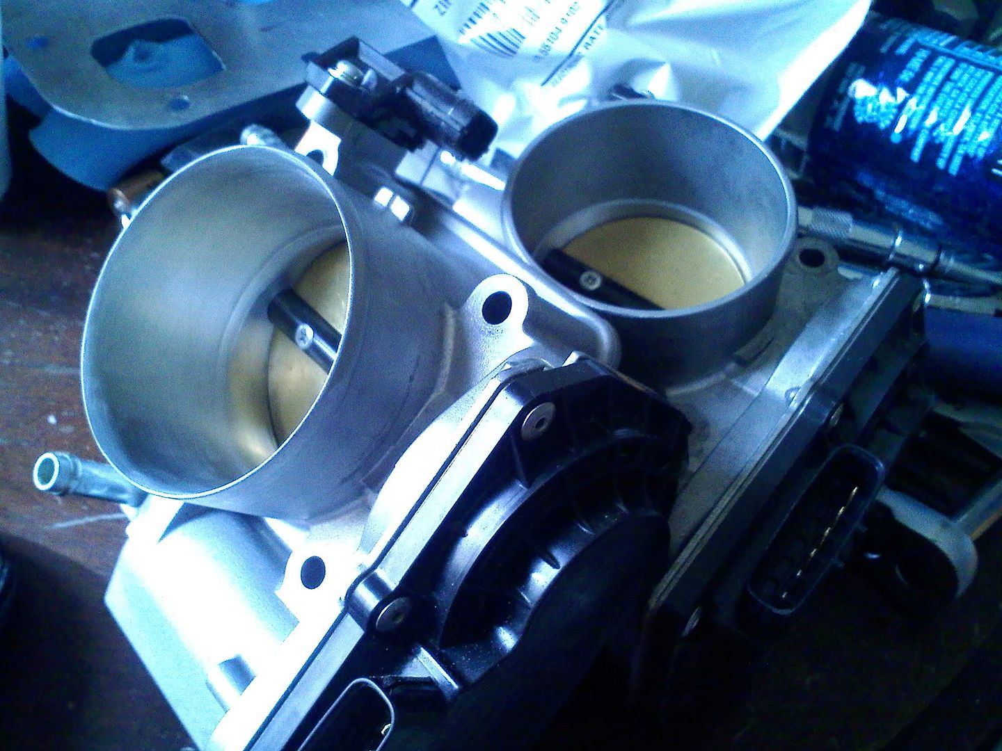

    Manapooha

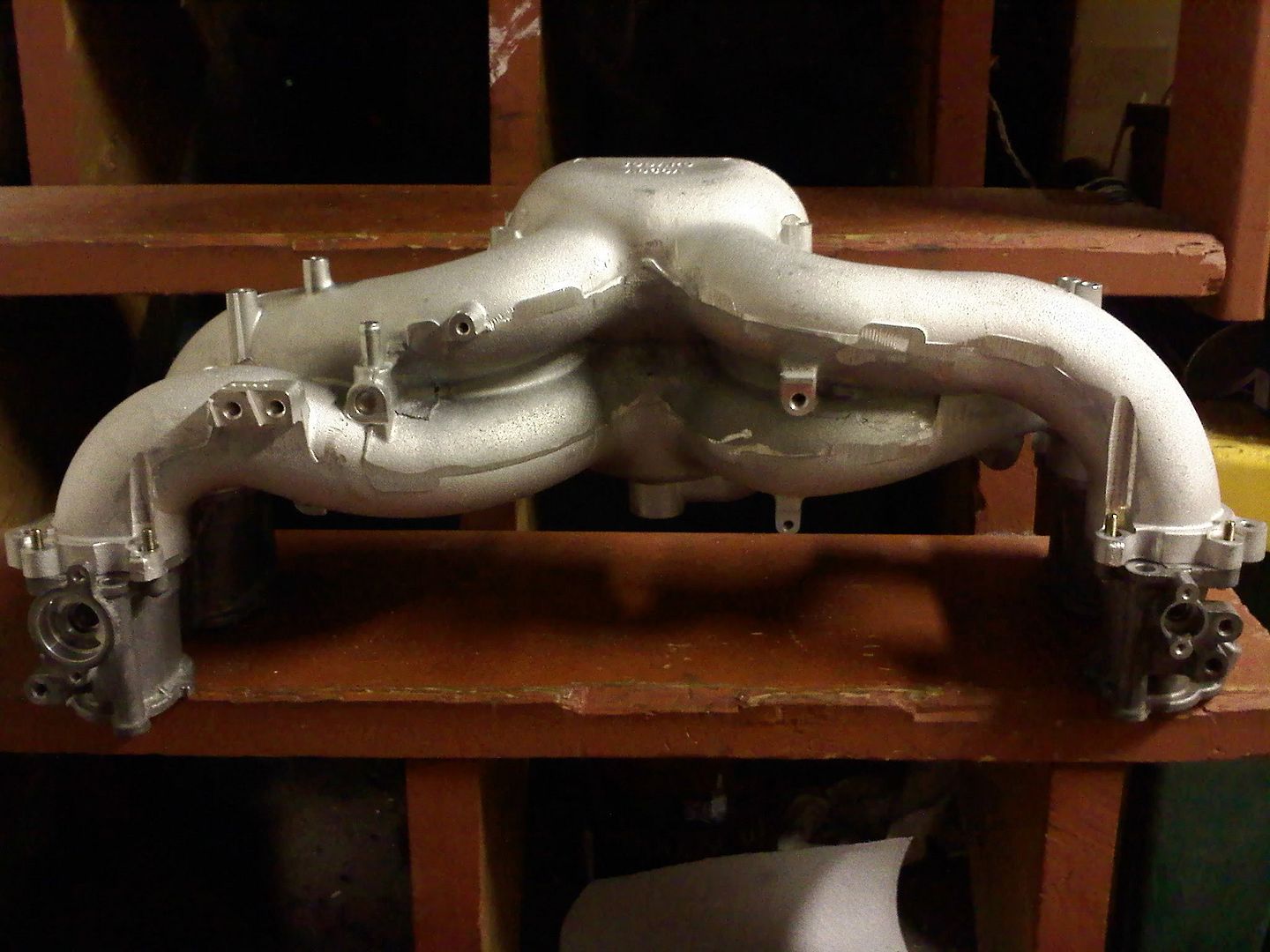

  10. piddster
    The head gasket doesn't line up perfectly. What head gasket is that? My .051" Cometics were fine. Like money in the bank, show me whatchu drank...

  12. Shibbs
    So these are EJ255 heads... Hmm... Fuji you wanna do another set?
  13. bikerboy
    94
    They are the new OEM gaskets with the cooling passage opened up at the top (center) of the head.
  14. Nuke
    Ding Ding Ding, we have a winner...winnerd
  15. FuJi K
    yes!!! modded EJ22E head gaskets.
    this is the original
    modded
  16. bikerboy
    94
    Winner winner chicken dinner!

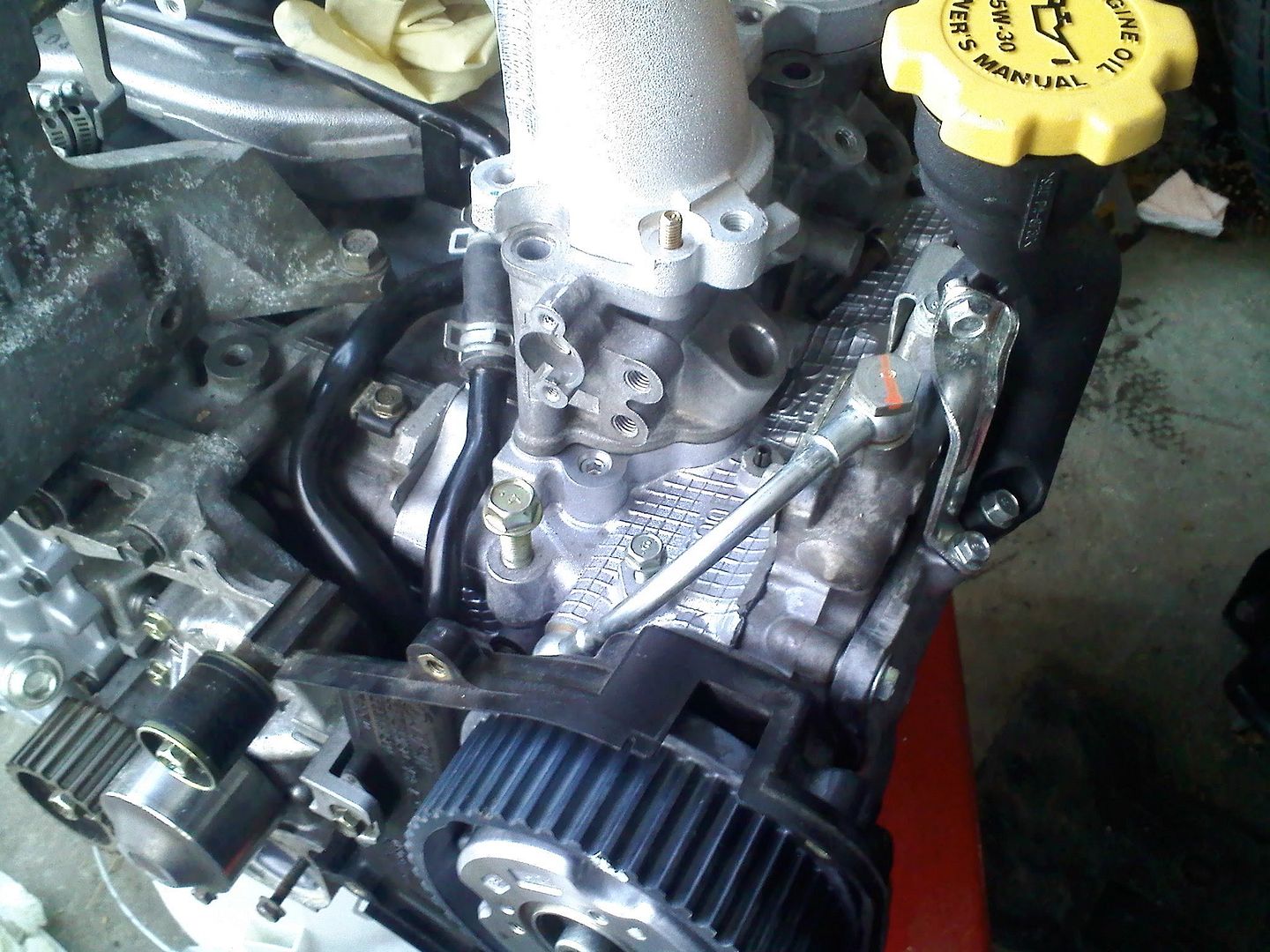

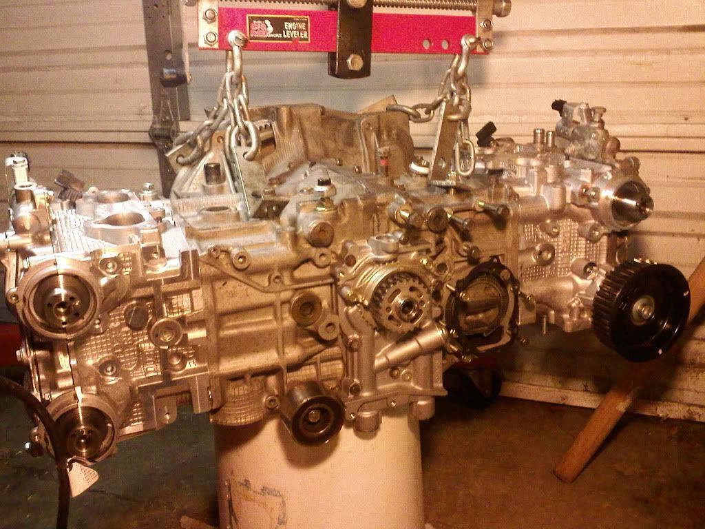

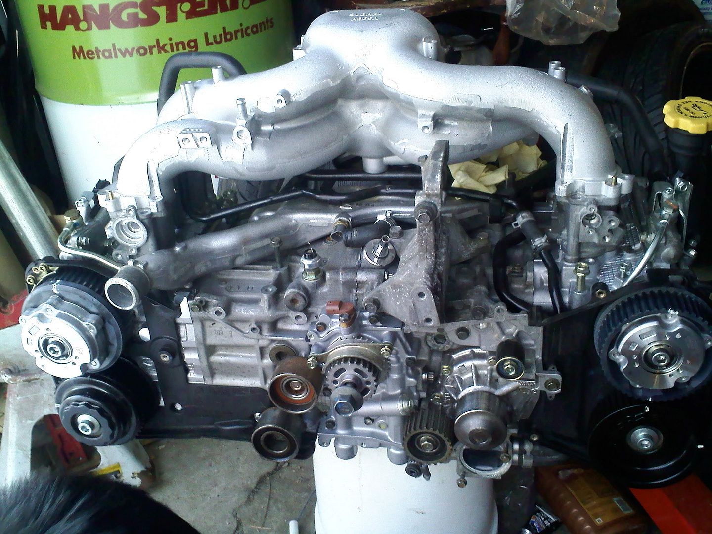

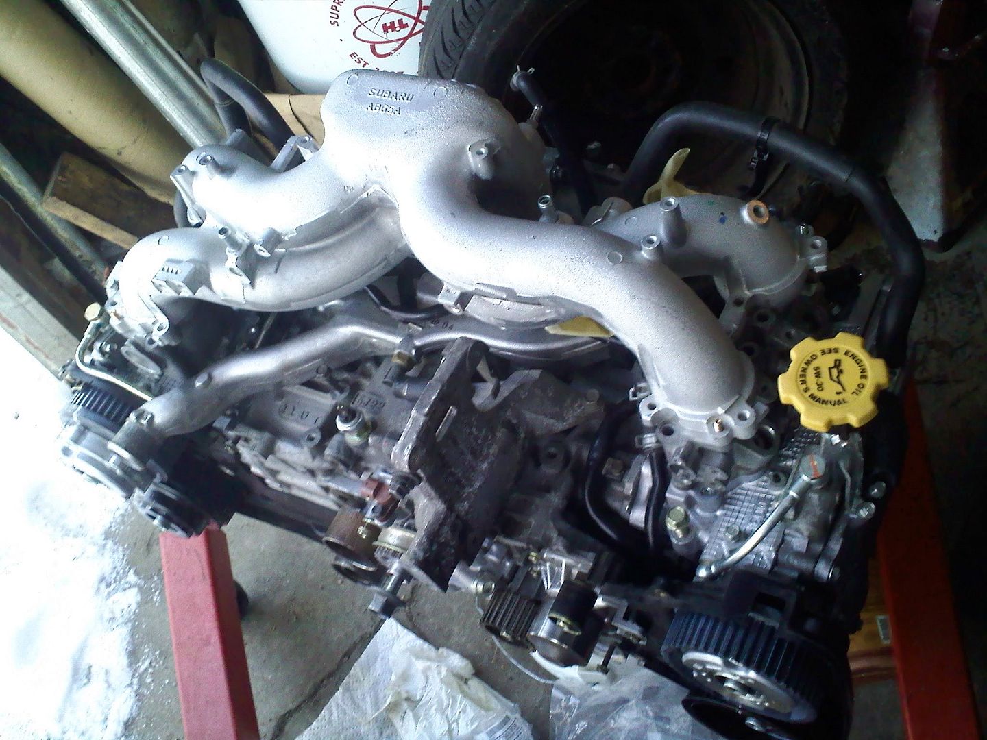

    Tonight's progress. Its built "Ground UP!"
    [​IMG][​IMG]
    [​IMG][​IMG]
  18. piddster
    Love the white 5 gallon bucket.

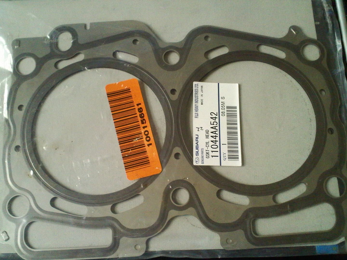

  21. FuJi K

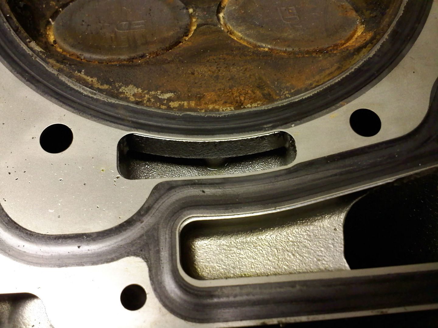

    Here's the newer EJ255/EJ257 head gaskets.
    [​IMG][​IMG][​IMG]
  22. FuJi K
    Well.... one must think very hard. Water flow to least resistant, right? If you look at where I made extra holes, you'll know what I mean. Cylinders #3/4 are hottest. More flow over there means cooler coolant can get there to help cool those two cylinders down. At least in theory that is. Very simple to do with a small carbide bur on a Dremel.

    here it is. Mocking up the manifold.... This is like new-age 22B STi motor... lolz

    Very good points about the heat in those cylinders, especially #4 which seems to get killed all the time. I saw the extra holes and I love that fab job. I'm still curious if you made this one up or if you learned it from someone/somewhere. With 24psi and 9:0:1 pistons, I should think you could be near 450WHP on E85. I suppose we'll have to wait and see, but you have the goods to make some serious power on this engine. I suppose the only restriction may be the GT30R, though it's all about what you are aiming for. Not to repeat, but keep getting clips and pics of all your work.

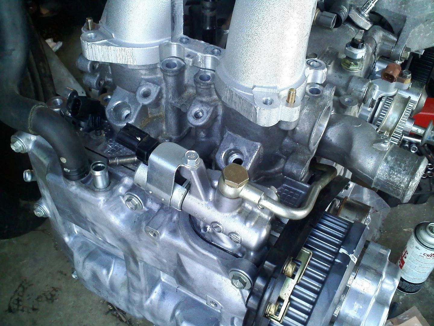

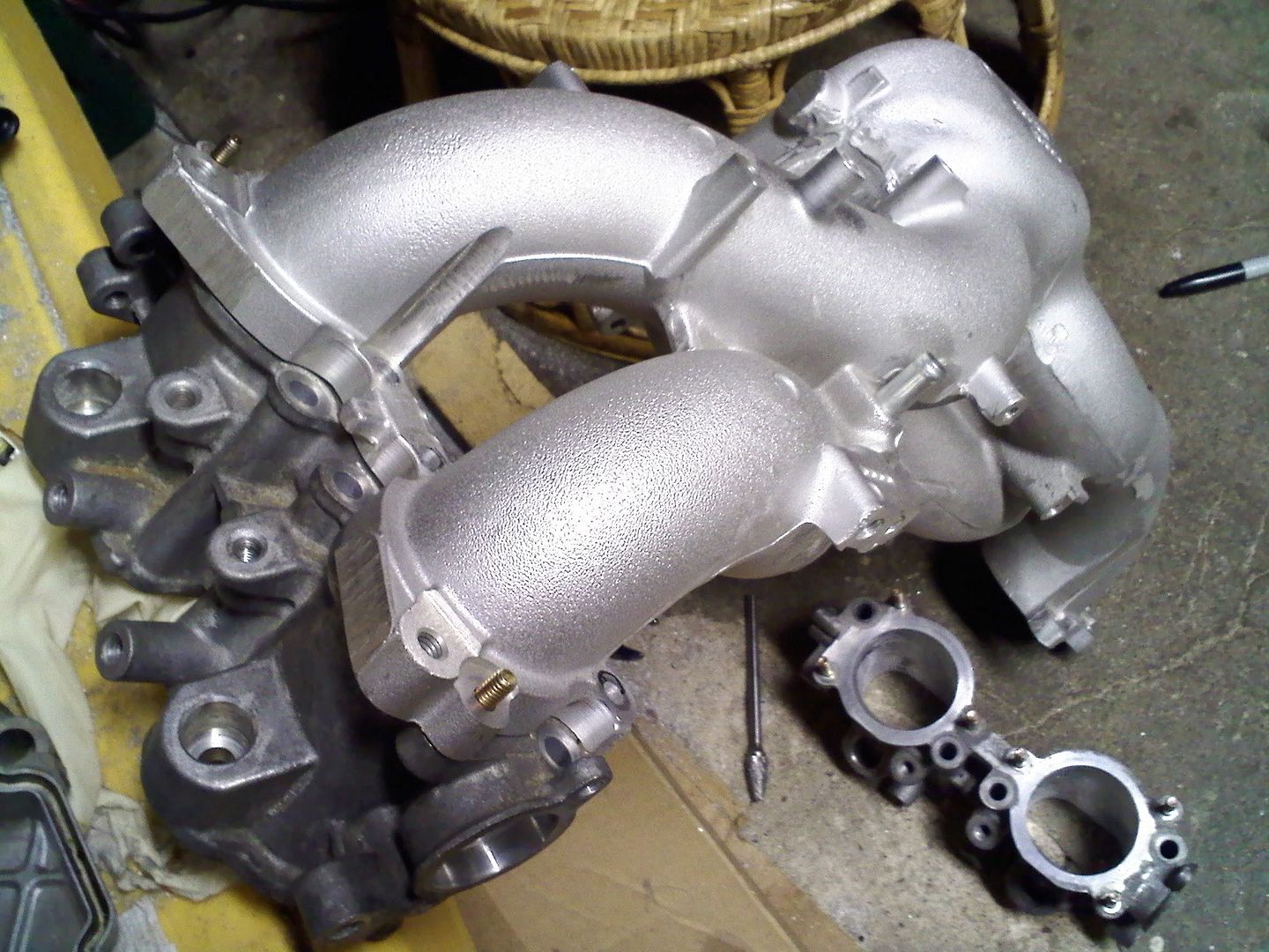

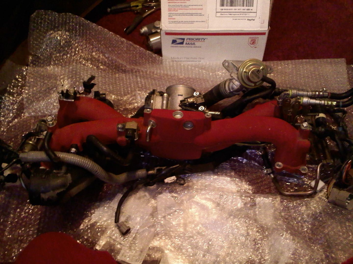

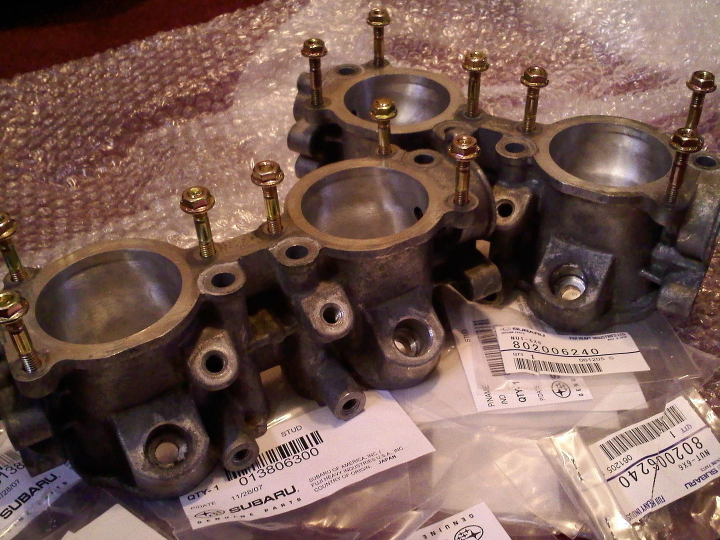

    A couple of parts laying around. putting together the intake manifold. plugged the TGVs... small stuff so far. SO MUCH STUFF on the manifold! ugh!
    [​IMG][​IMG]
    [​IMG][​IMG]

    humm...... testing TGVs on the manifold.
    [​IMG][​IMG]
  37. FuJi K

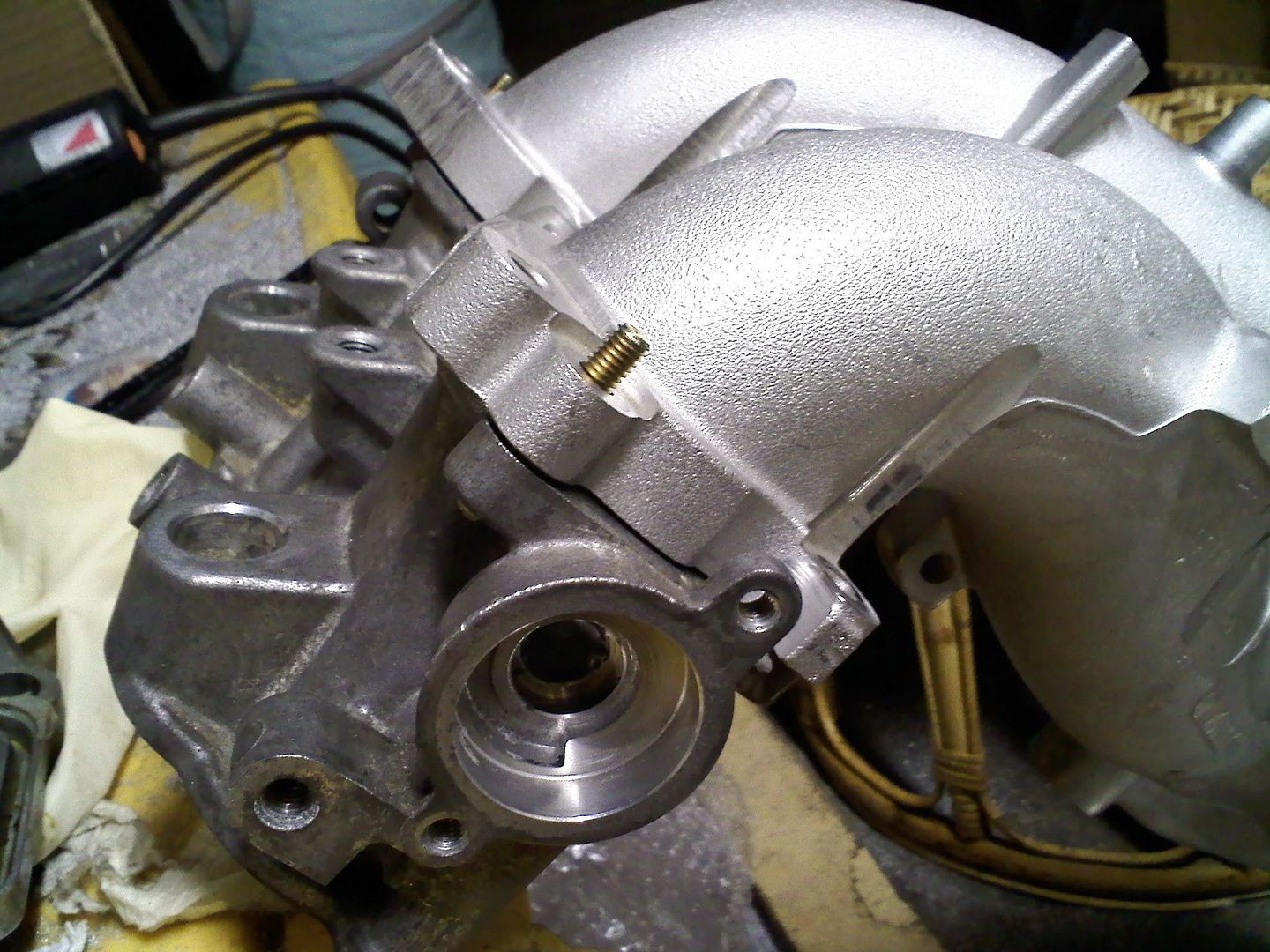

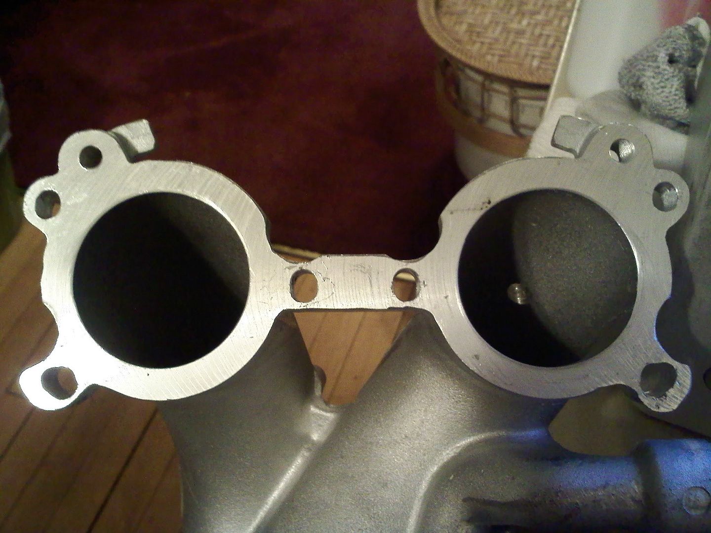

    Mocking up the intake manifold onto the TGV's and head. These TGV's are NOT a direct bolt-on to the manifold. Four of the holes don't line up since this manifold has larger runners and shaped differently. I'll show a pic when I'm done modifying the manifold.
    [​IMG][​IMG]
    [​IMG][​IMG]

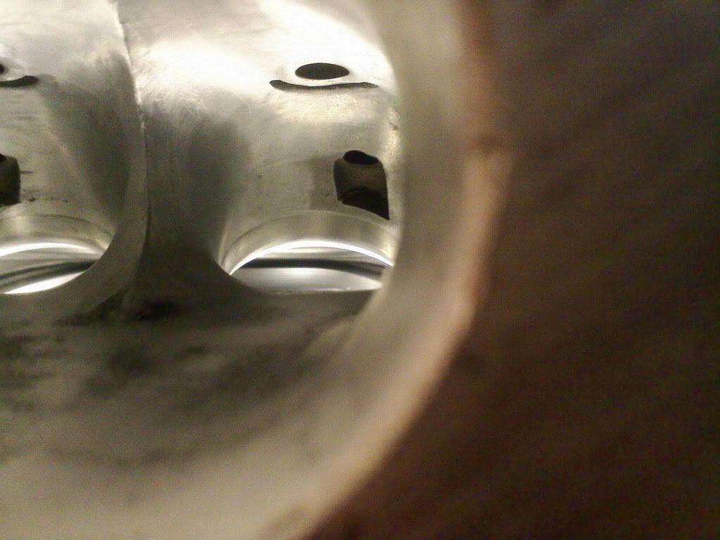

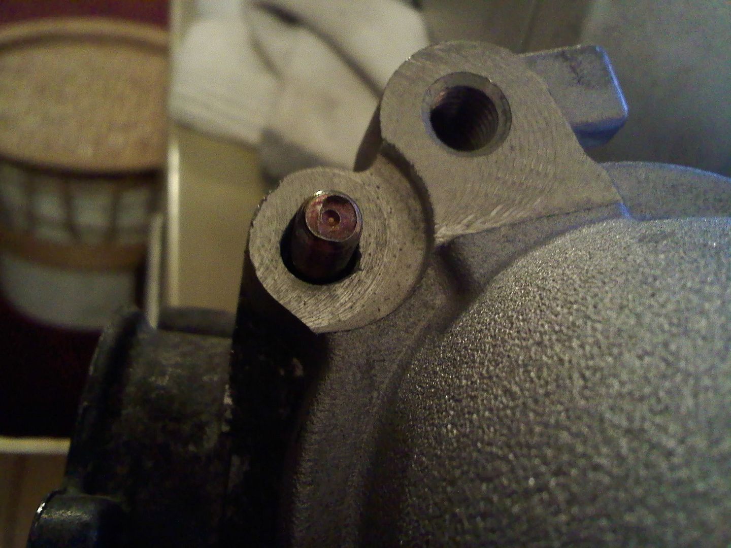

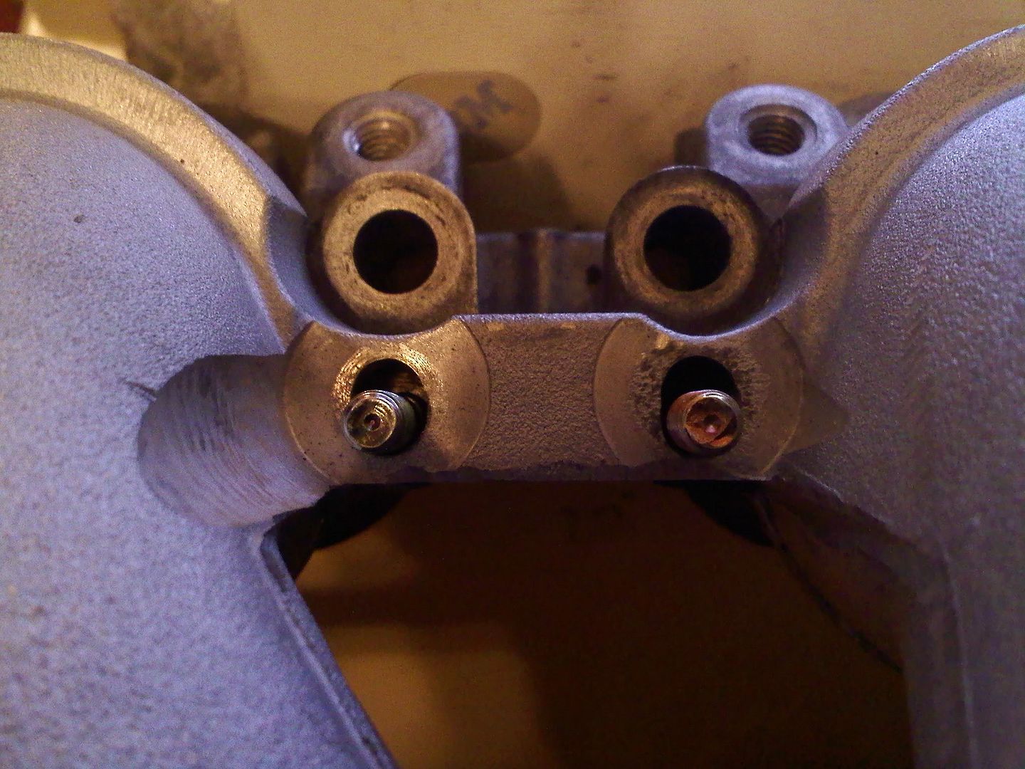

  38. FuJi K

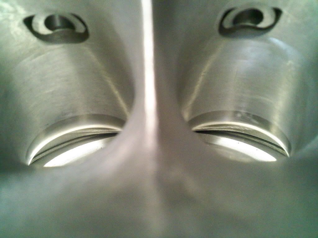

    Here is the modification needed. Slight oval of the holes. I bolted the TGV's onto the heads and trimmed away at the holes on the intake manifold. Installation would be TGV's first, then upper manifold 2nd. This ensures that there is NO step or drop from TGV to head and allows for smooth flow from TGV to intake ports.
    [​IMG][​IMG][​IMG]
    [​IMG][​IMG][​IMG]
  39. Shibbs

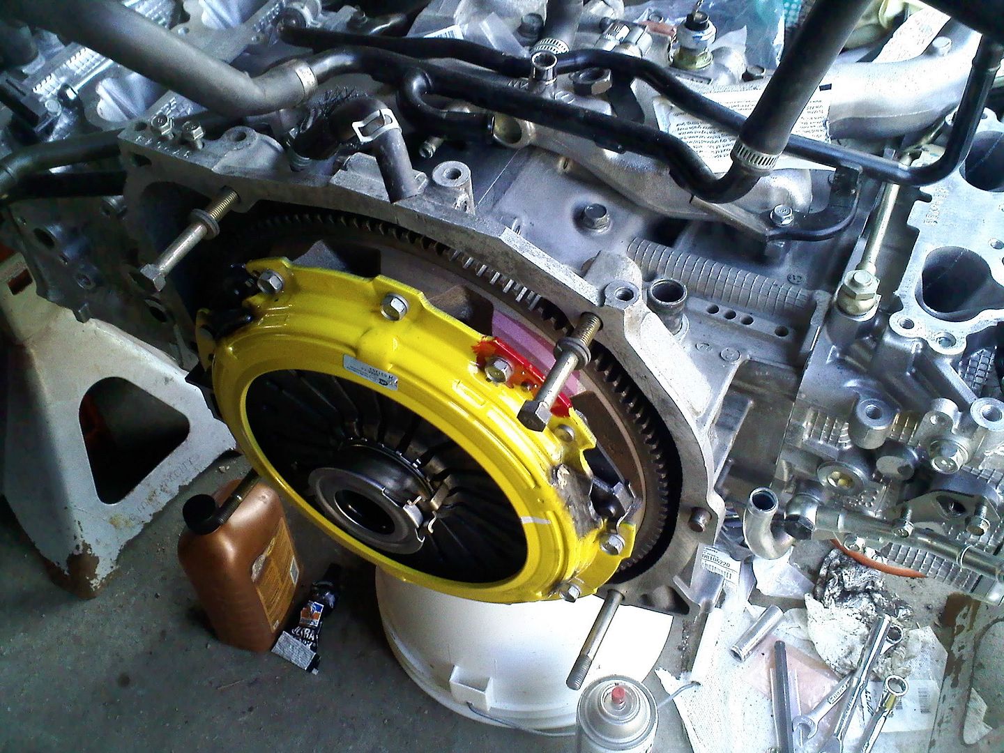

  44. FuJi K

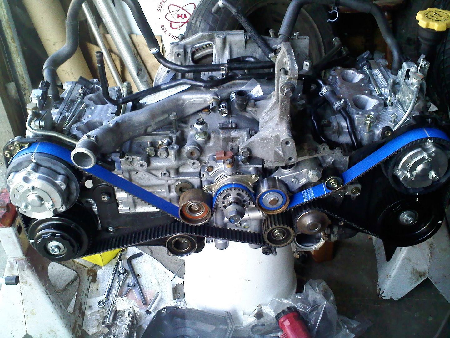

    I installed the belt and put together the clutch. Such pretty colors but....will be inside where it can't be seen.
    [​IMG][​IMG]
