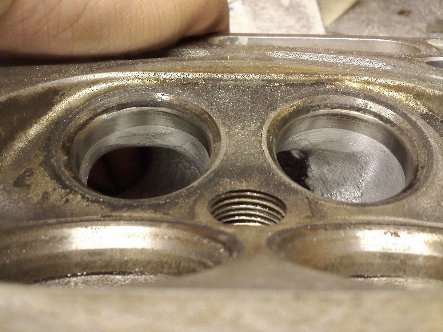

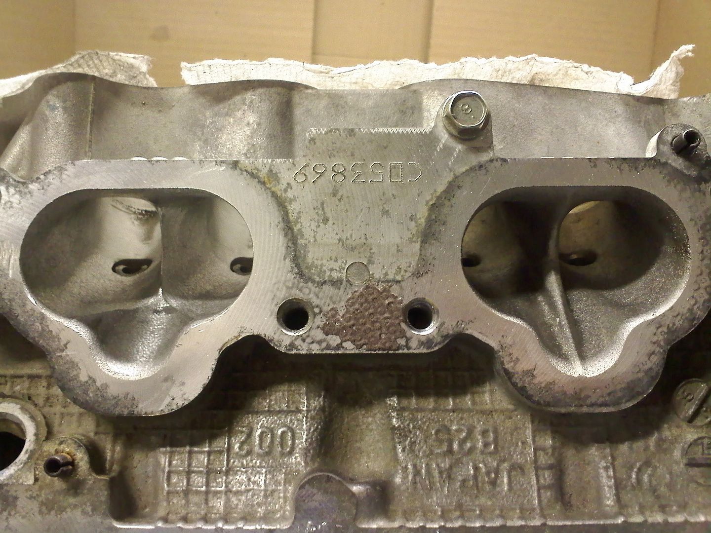

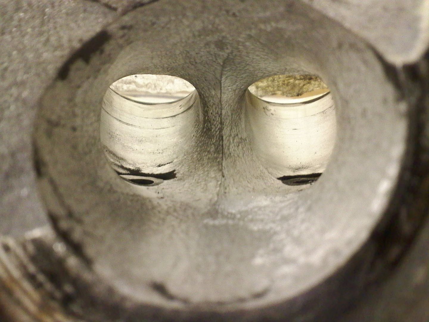

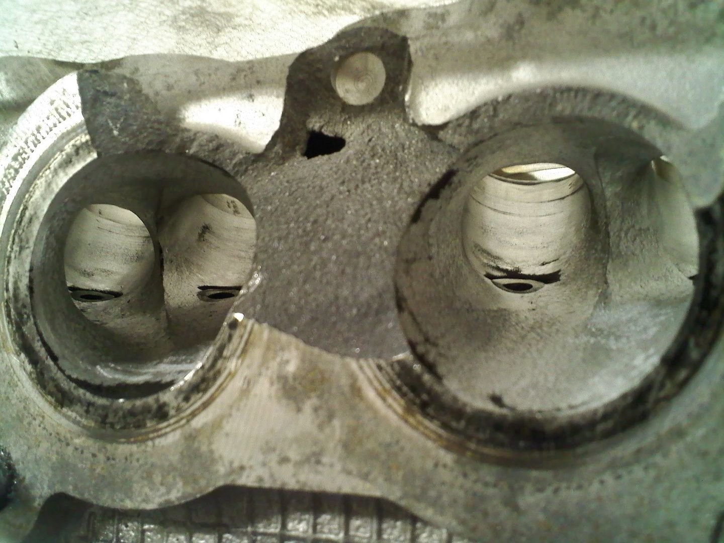

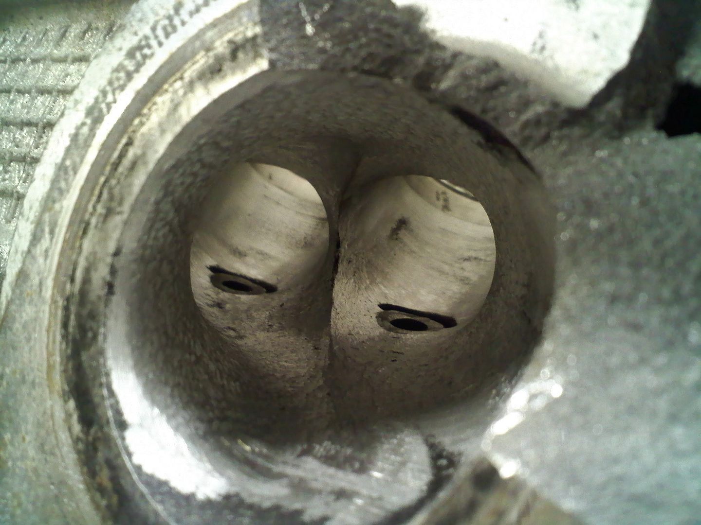

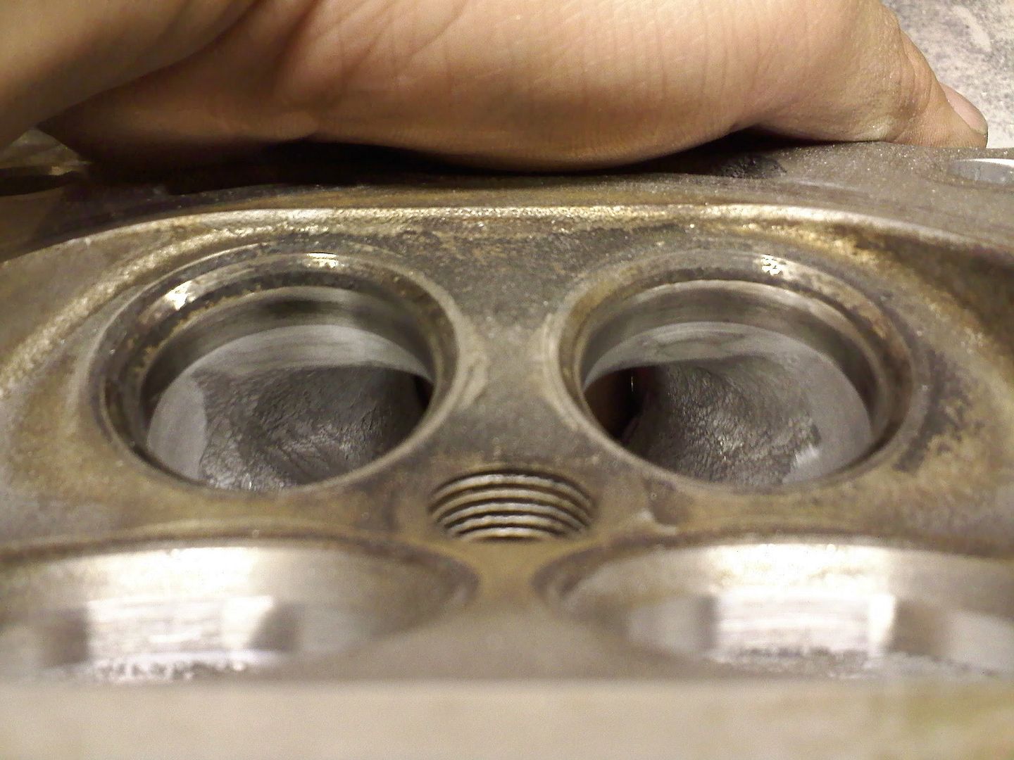

    Some B25 heads I was testing with the DD porting style. It's still got meat so the intakes can get the D-ports.
    [​IMG][​IMG][​IMG]
    [​IMG][​IMG][​IMG]

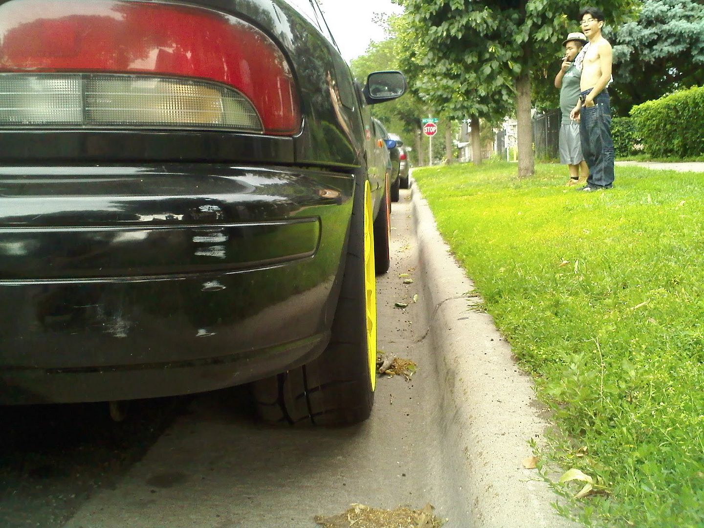

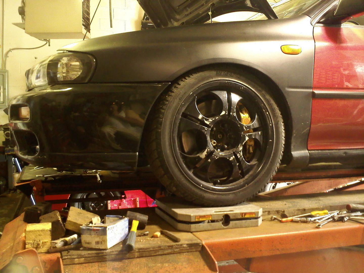

  21. FuJi K

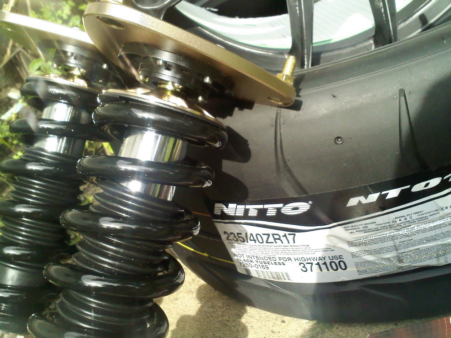

    BC Racing inverted coilovers; 12K f/r w/ rear camber plates
    Nitto NT01 235/40/17
    Project Mu Racing 999 race pads
    Drag DR31 17x9 +38
    [​IMG][​IMG]

  22. Lowrider
    Lowrider Well-Known Member
    152
    How many pounds do those wheels weigh?
    Could have bought my PAGID race pads...:)
  23. FuJi K
    I think they are like 22lbs or something....

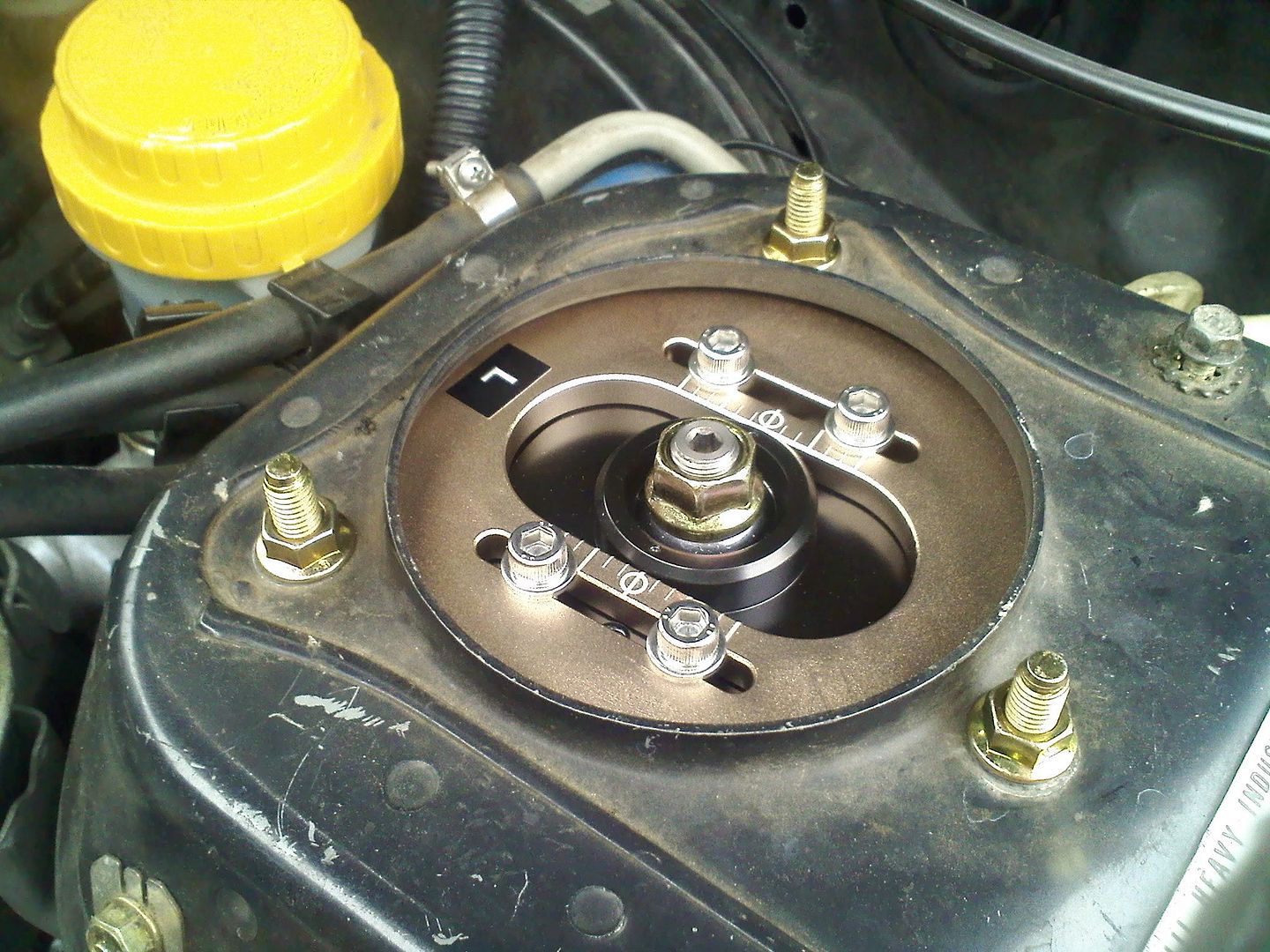

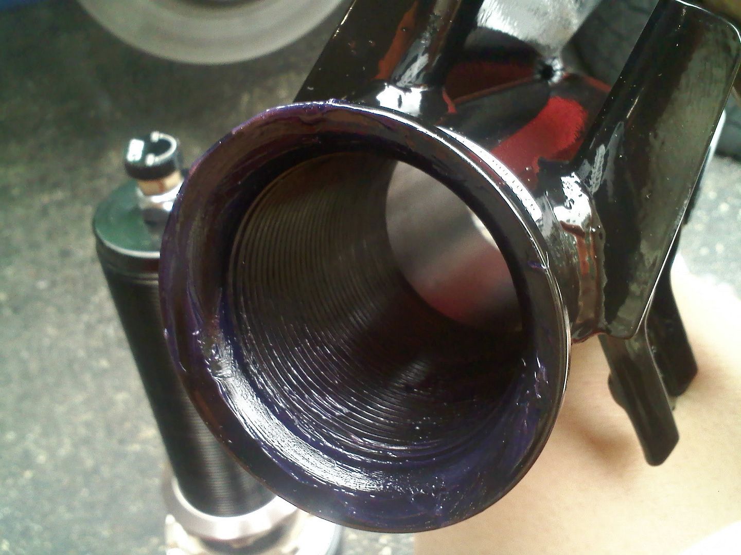

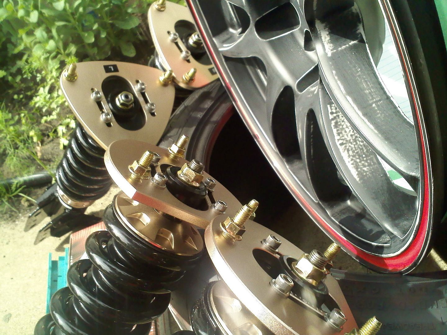

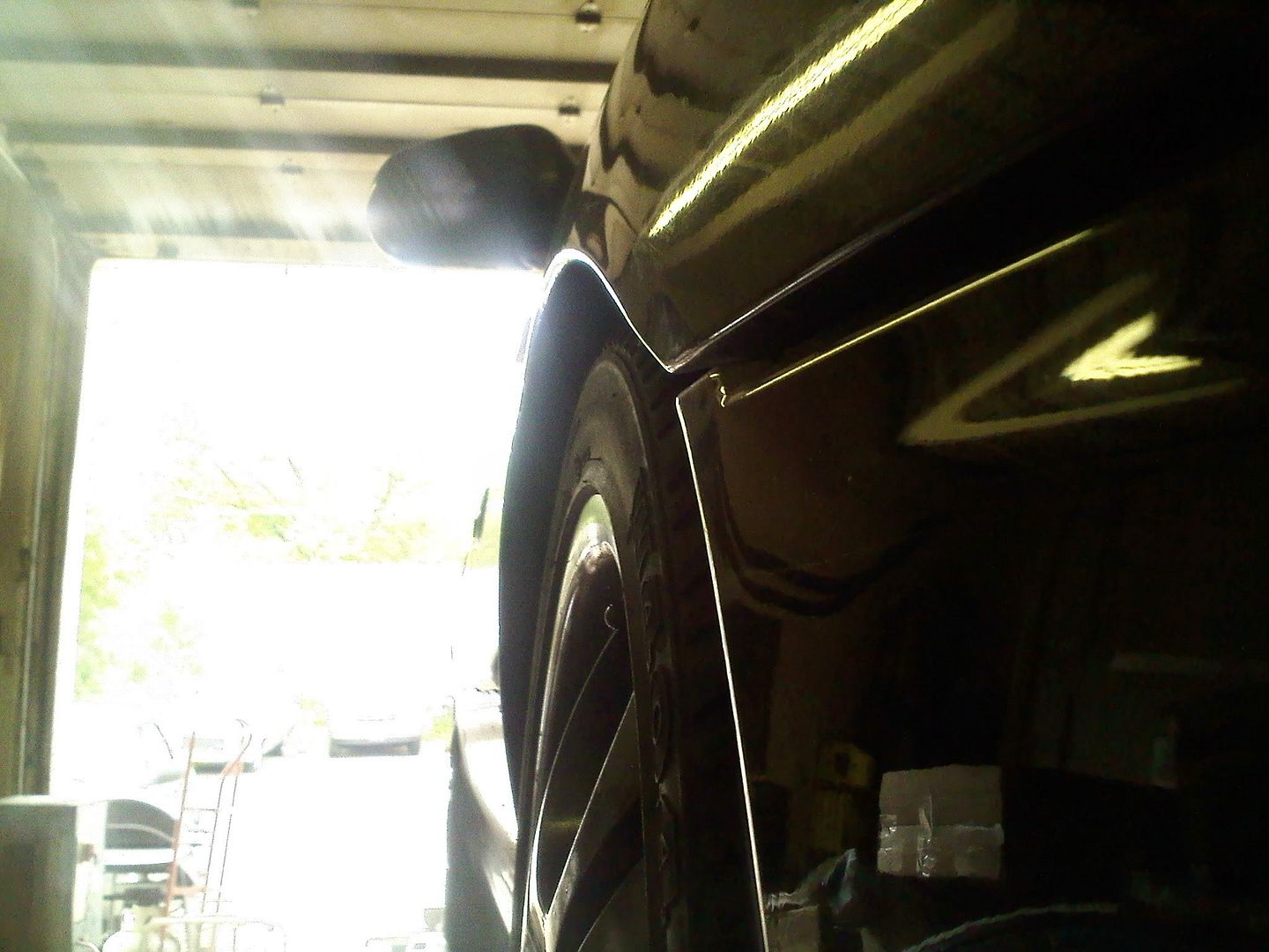

  27. FuJi K

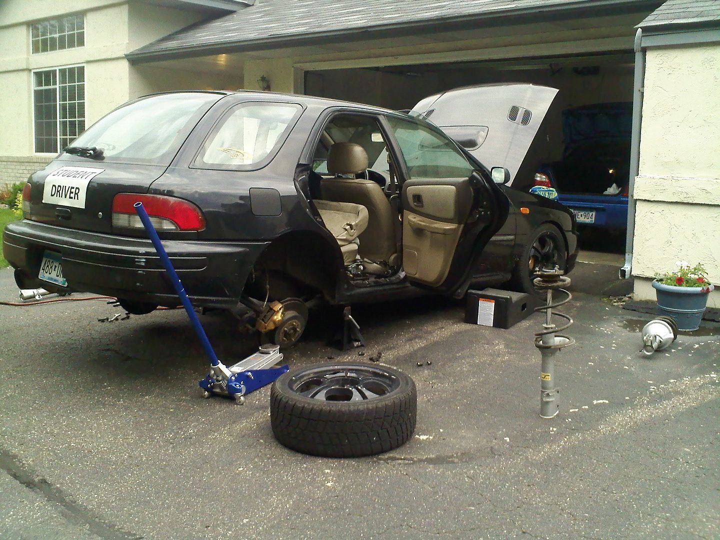

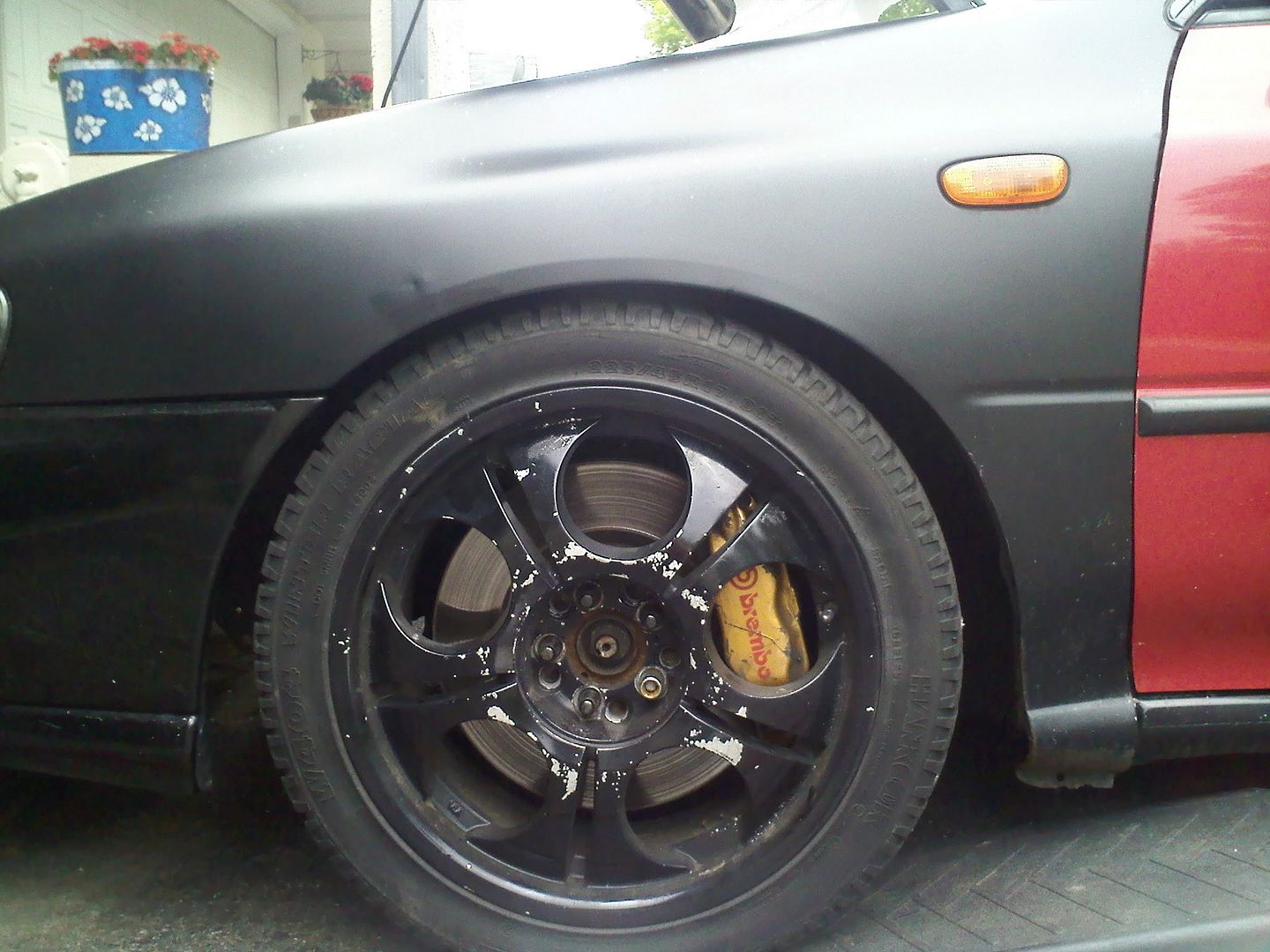

    I installed the coilovers after adding some grease in areas that corrode. This is MAX lowerd. Any more and the knob for damper adjustment digs into the front axle boot.
    [​IMG][​IMG]
    [​IMG][​IMG]

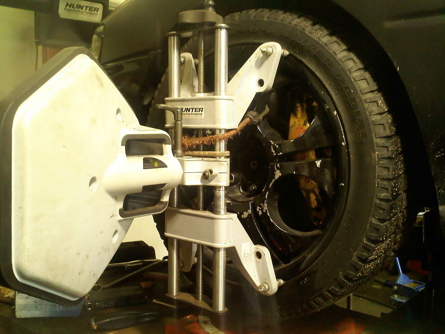

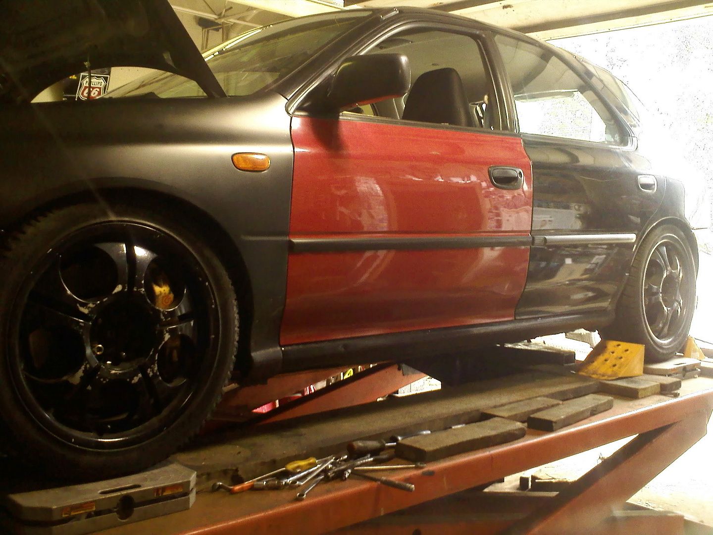

  28. FuJi K

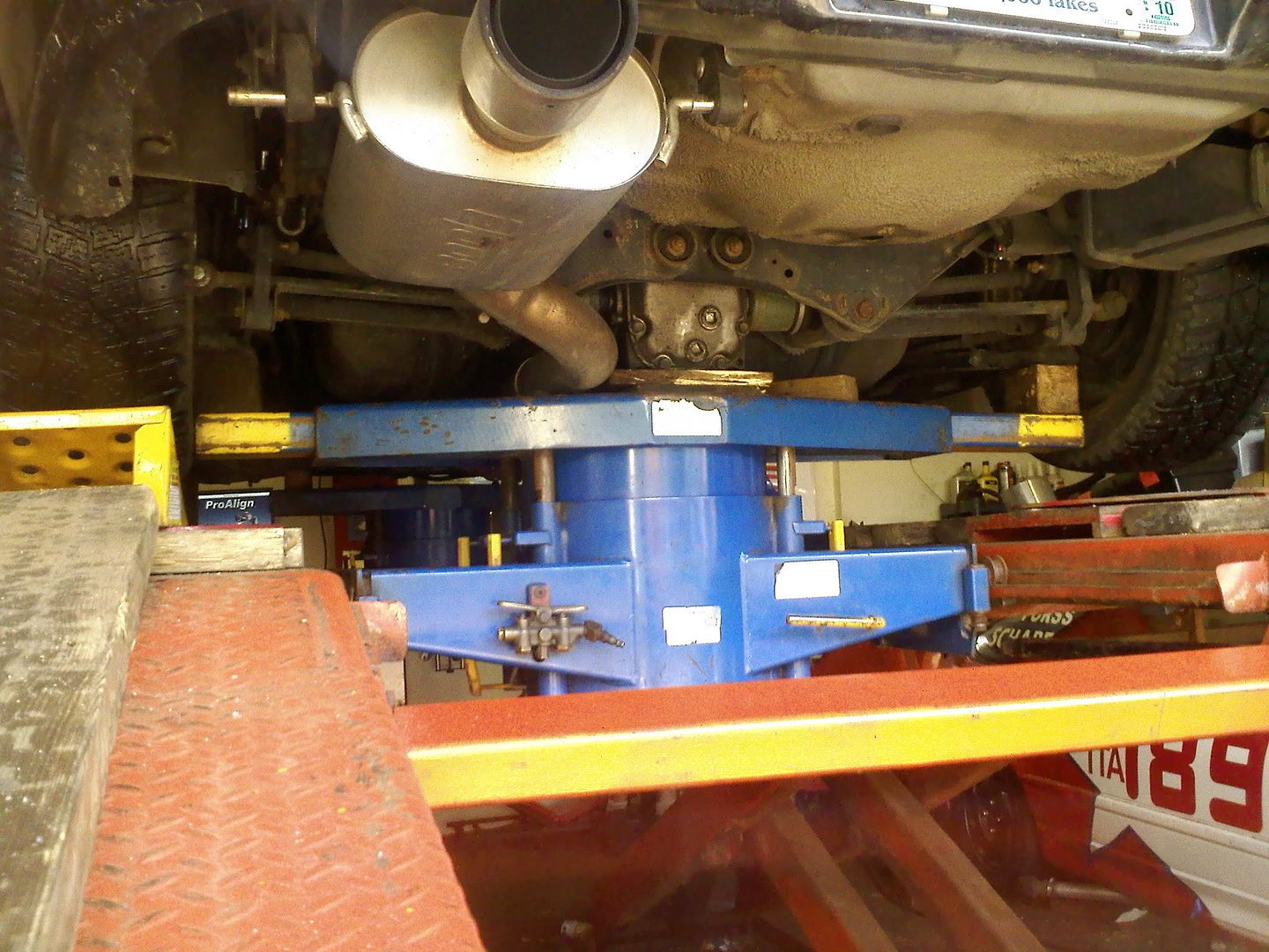

    Alignment set and corner balanced!!! The screen shot show's what it came in as.
    went out with
    -2.5* front camber
    -2.0* rear camber
    -.35* toe OUT front
    0.00* toe rear
    [​IMG][​IMG][​IMG]
    [​IMG][​IMG][​IMG]

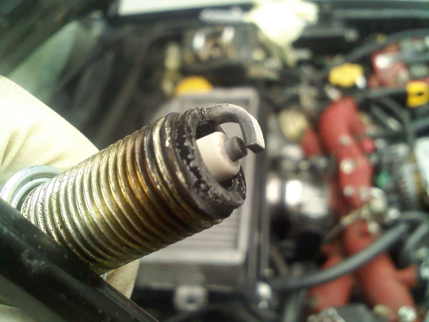

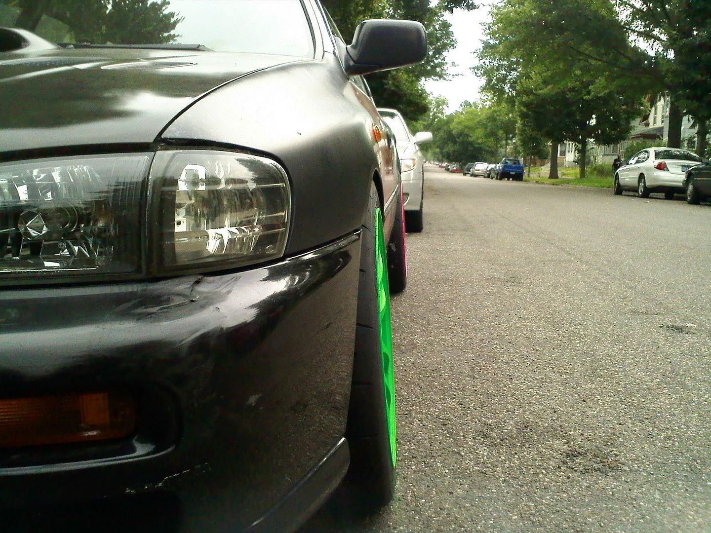

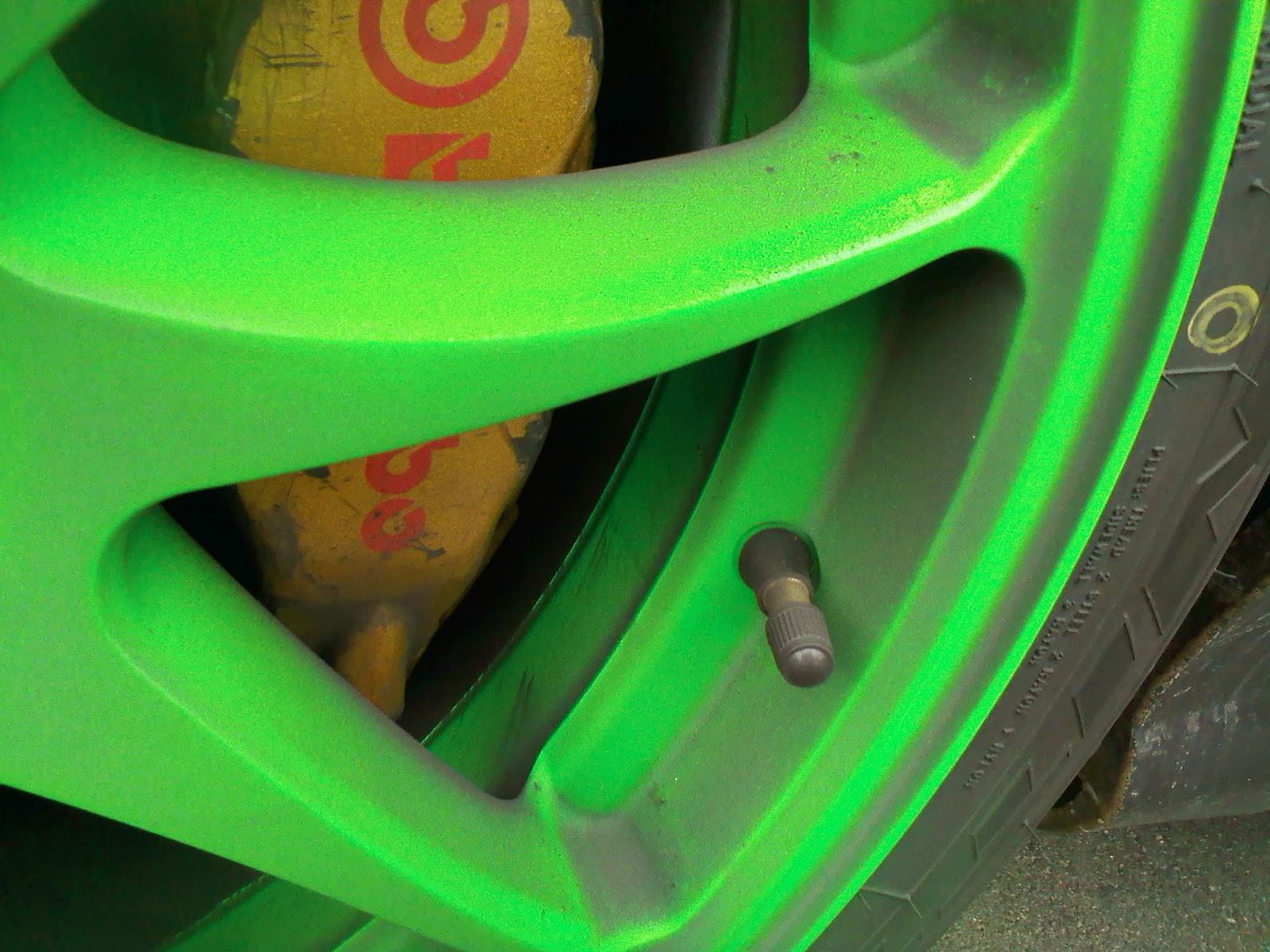

  29. FuJi K

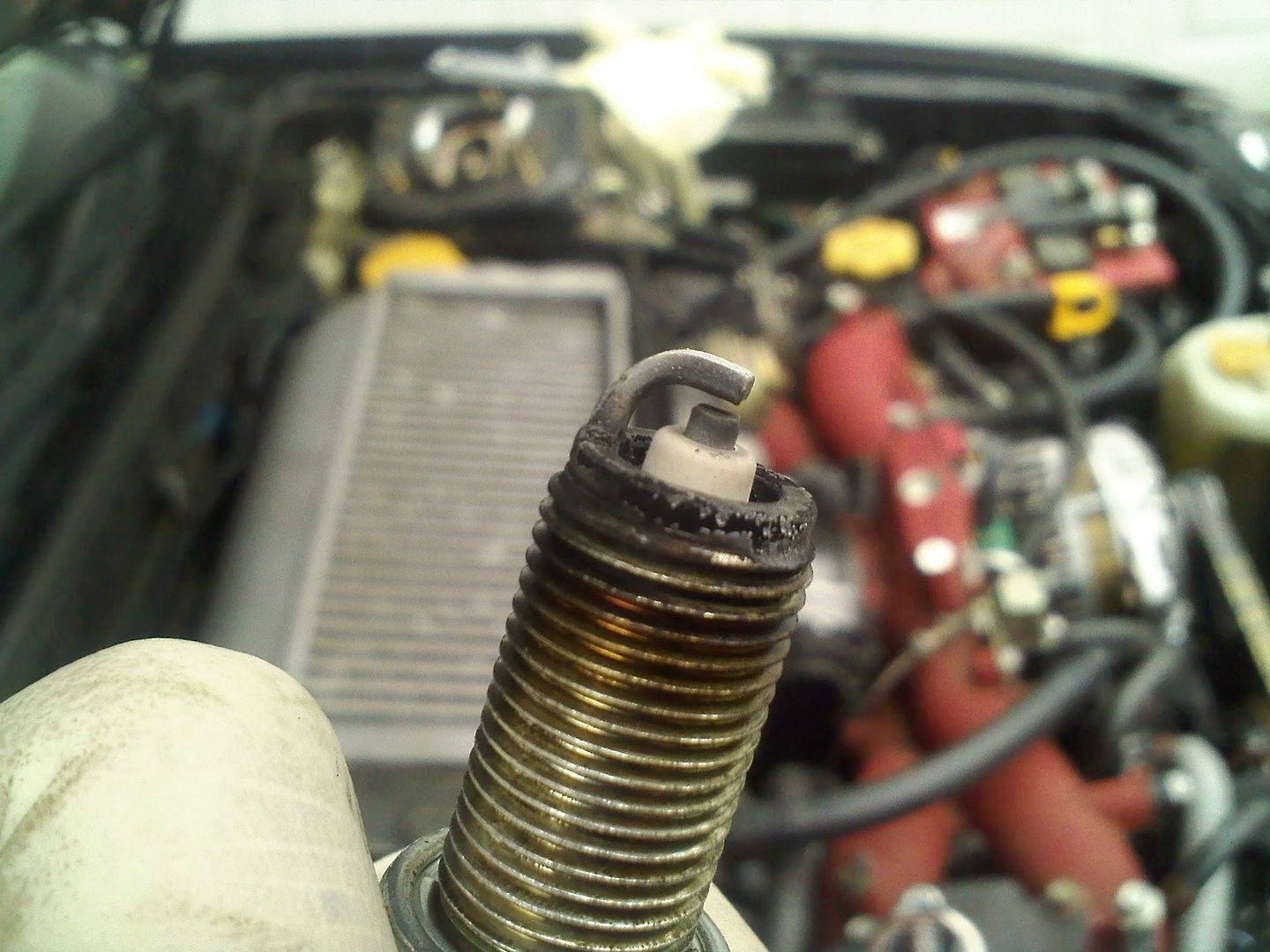

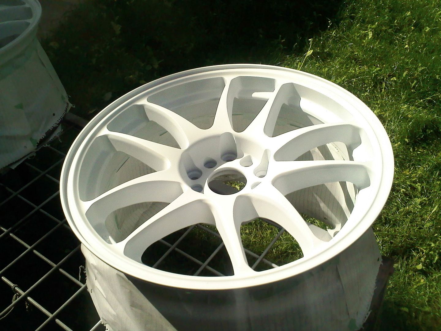

    Testing HELLA FLUSH. painted!!! Spark plugs at 1500mlies. Compression shows 135-140
    [​IMG][​IMG]
    [​IMG][​IMG]
  30. Lowrider
    152
    What is the difference between the 1 step colder plugs and the stock ones?...apart from price

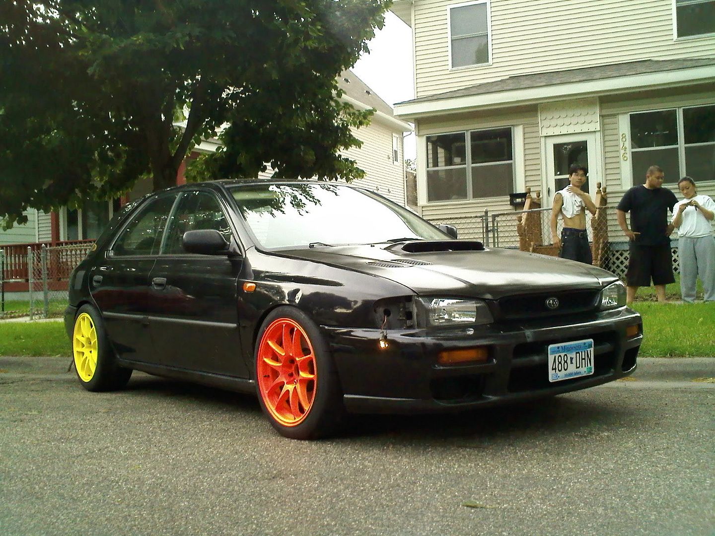

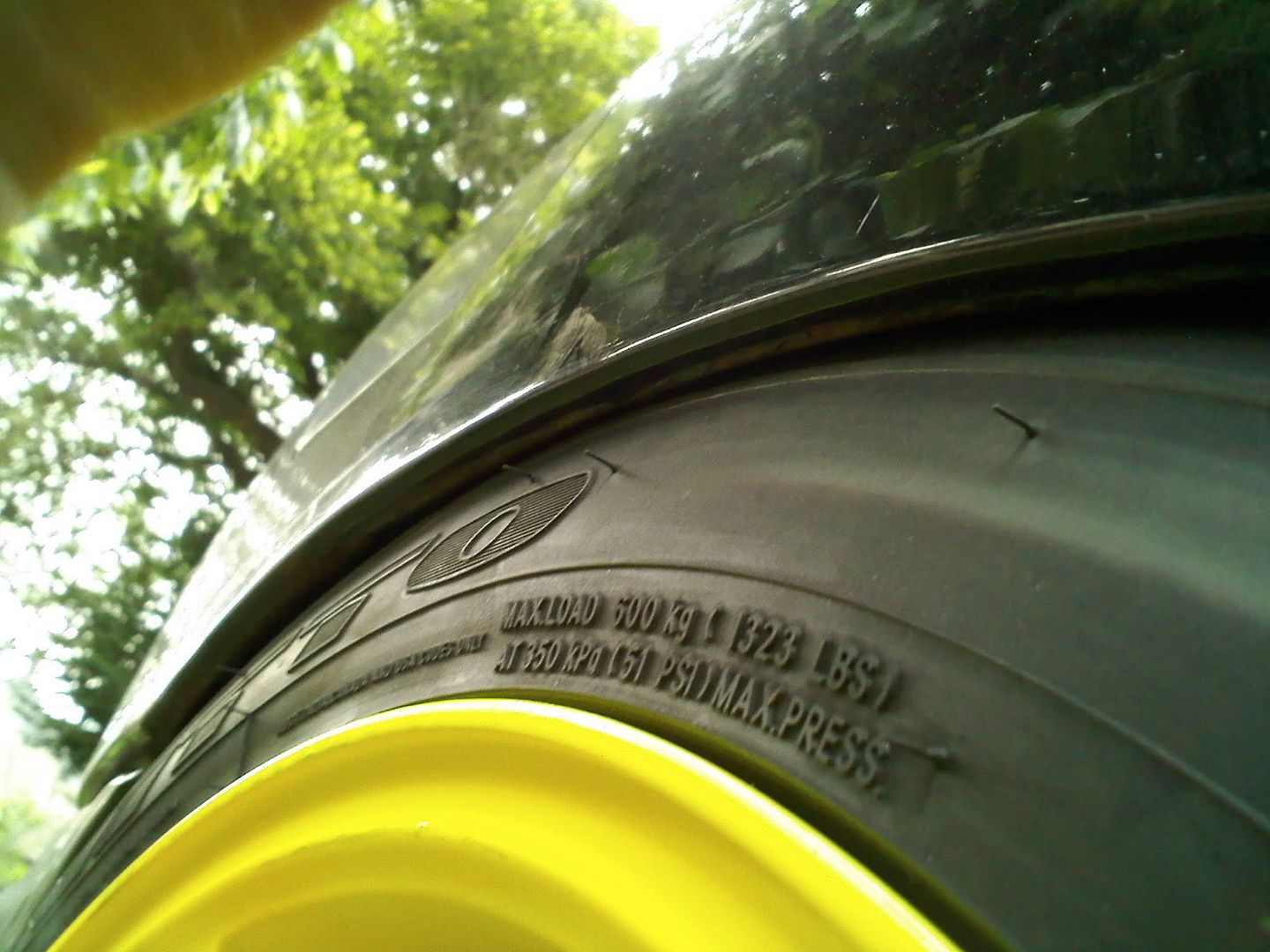

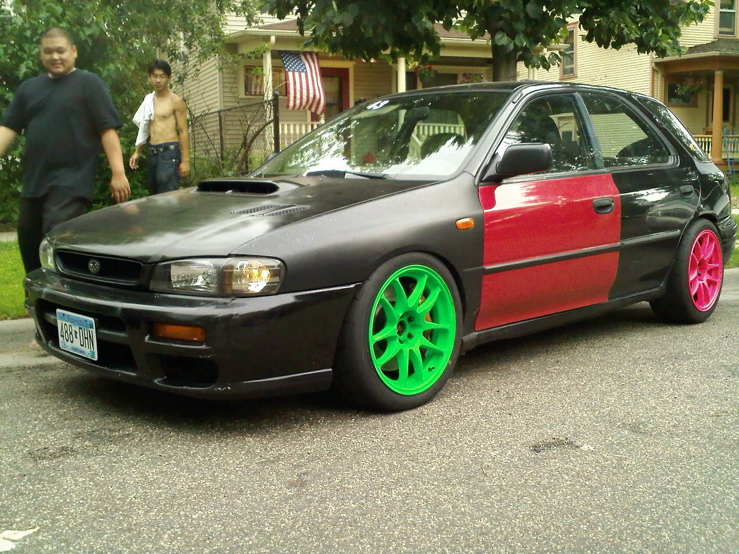

  31. FuJi K

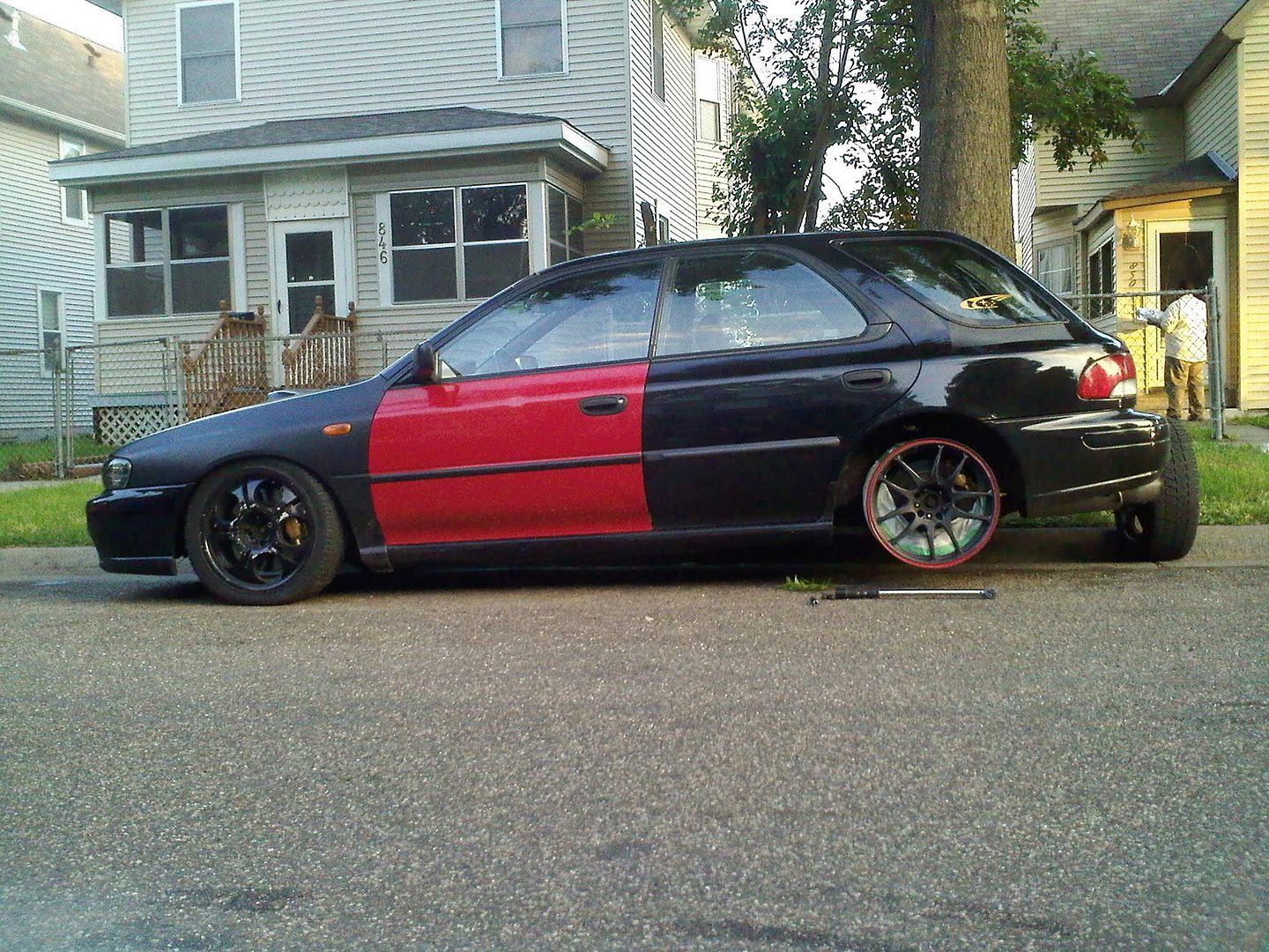

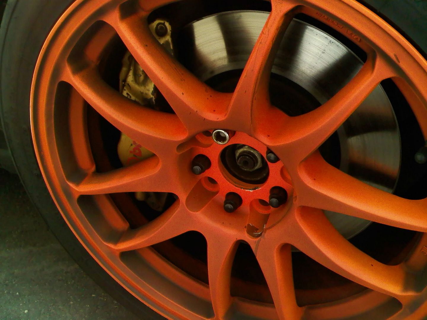

  32. FuJi K
    Taste the rainbow!!!!
    [​IMG][​IMG][​IMG]
    [​IMG][​IMG][​IMG]
  33. prezawagon
    prezawagon Well-Known Member
    49
    haha, nice! The yellow/orange side looks great.

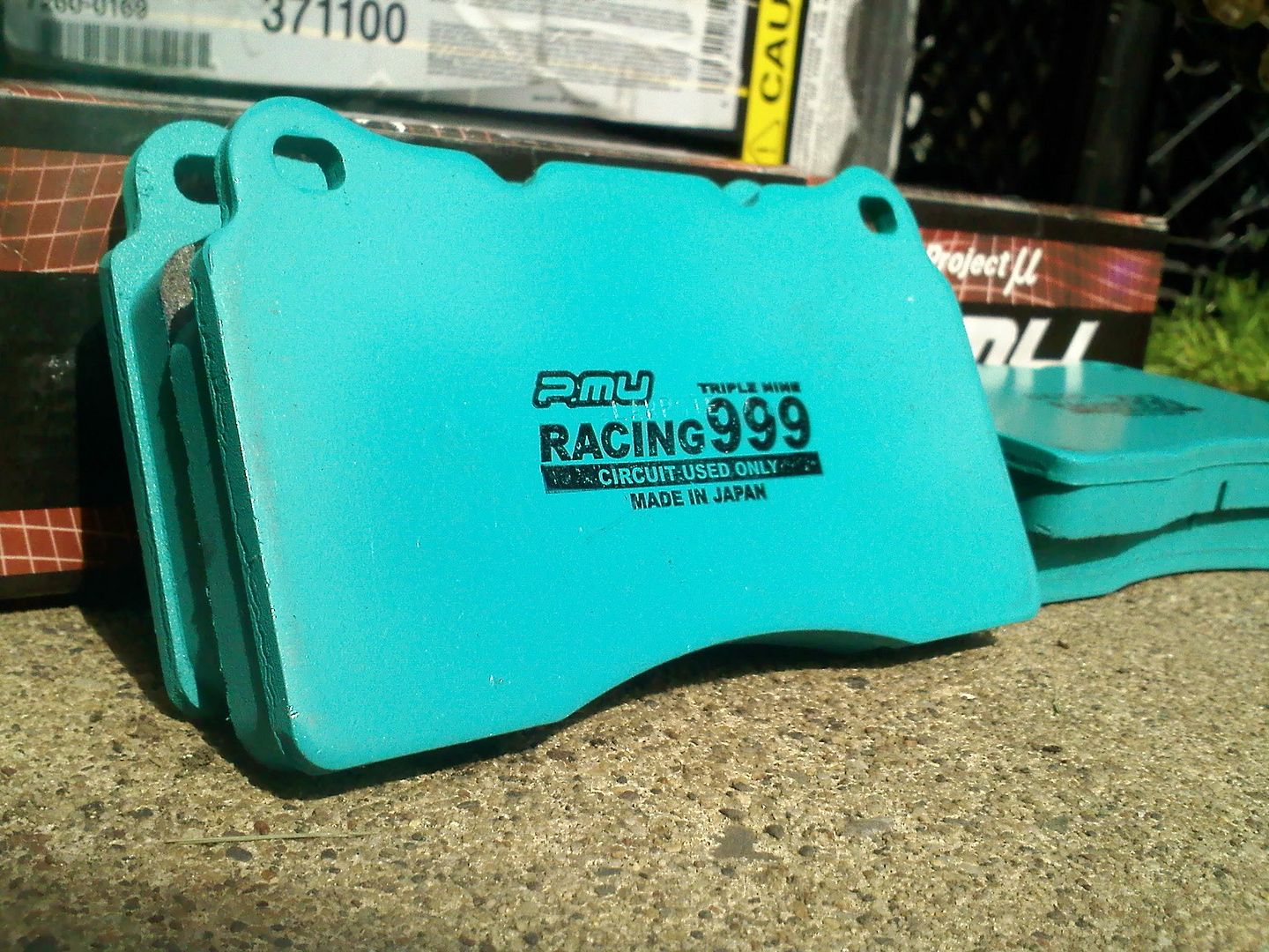

    This is what Racing Pads do.... they are quite dusty.
    Project Mu Racing999 pads for STi brembos.
    [​IMG][​IMG]
