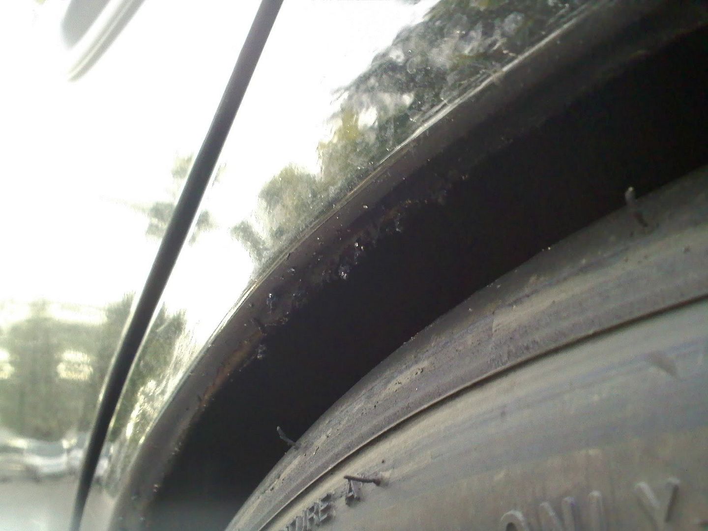

    Here's the rubbing I get from the wide wheel/tire setup. This is taking the clover ramp with the Nitto NT01's.
    size again FYI:
    17x9 +38
    235/40/17 Nitto NT01

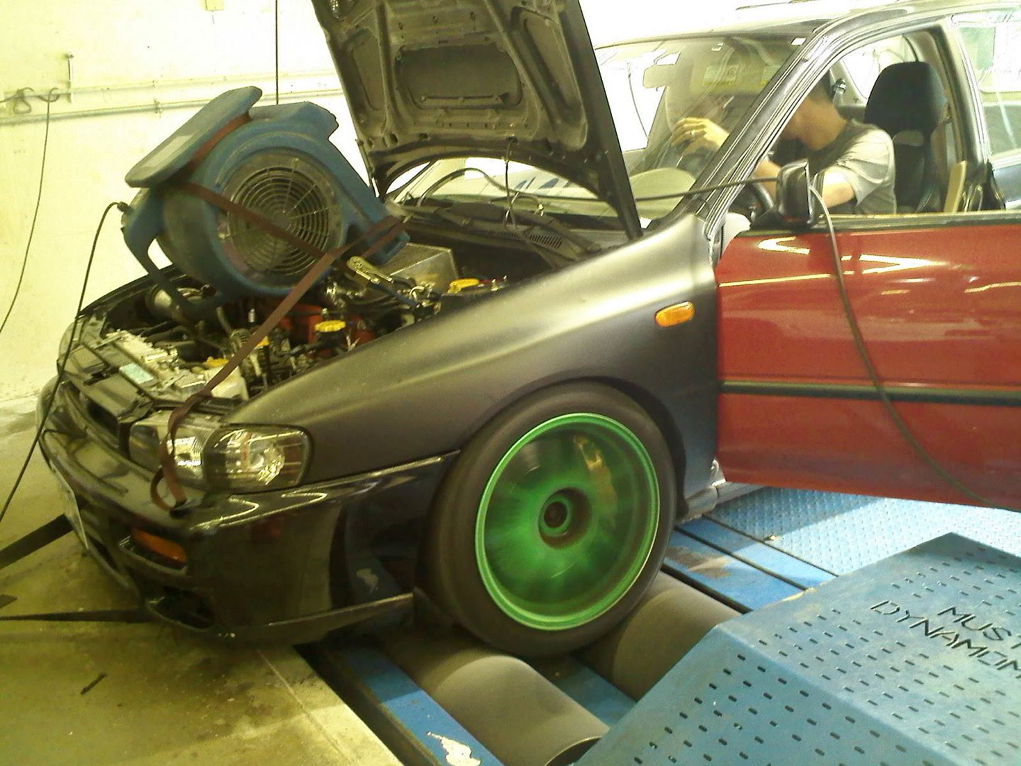

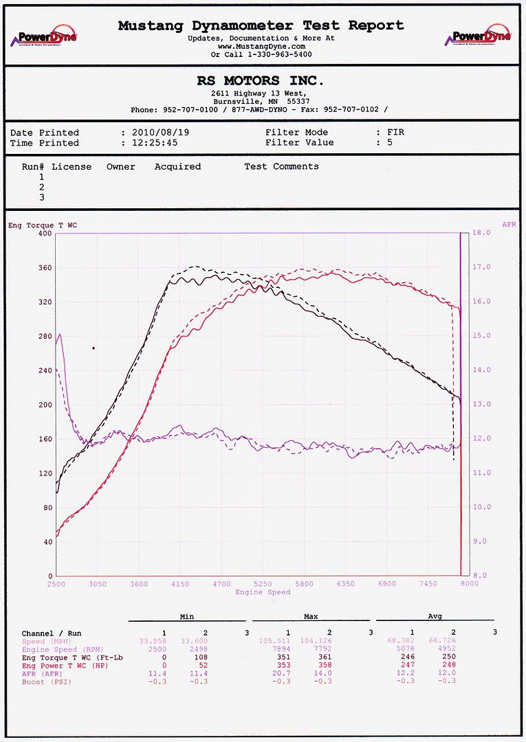

    The compression test before the dyno when we swapped out to new plugs was
    Cly #1 140psi
    Cly #2 140psi
    Cly #3 140psi
    Cly #4 145psi
    This is roughly 6800ish miles. It only would burn oil via blow by through the vacuum hoses. This happens when running higher RPMs. An oil catch can was installed and it showed oil coming through. I'll get a puff of smoke at startup especially when I ran it at high RPM's before I shut off the car. Will have to see if it still burns oil out during normal driving. I strongly suggest an oil catch can when you are going to be running the car hard.

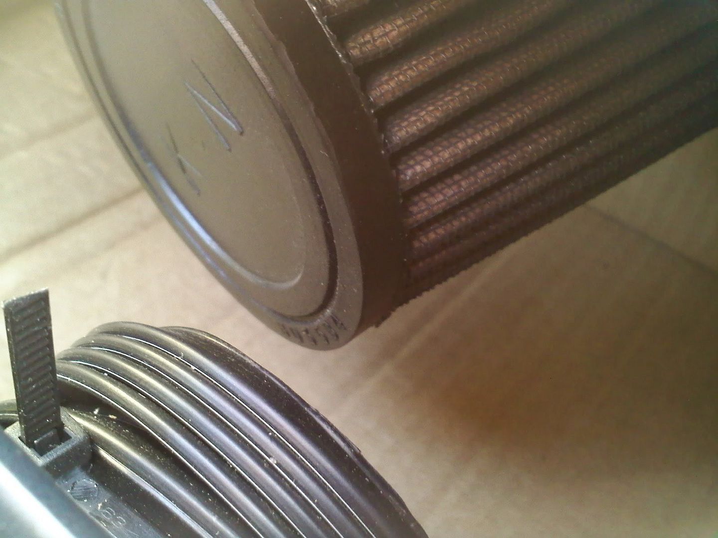

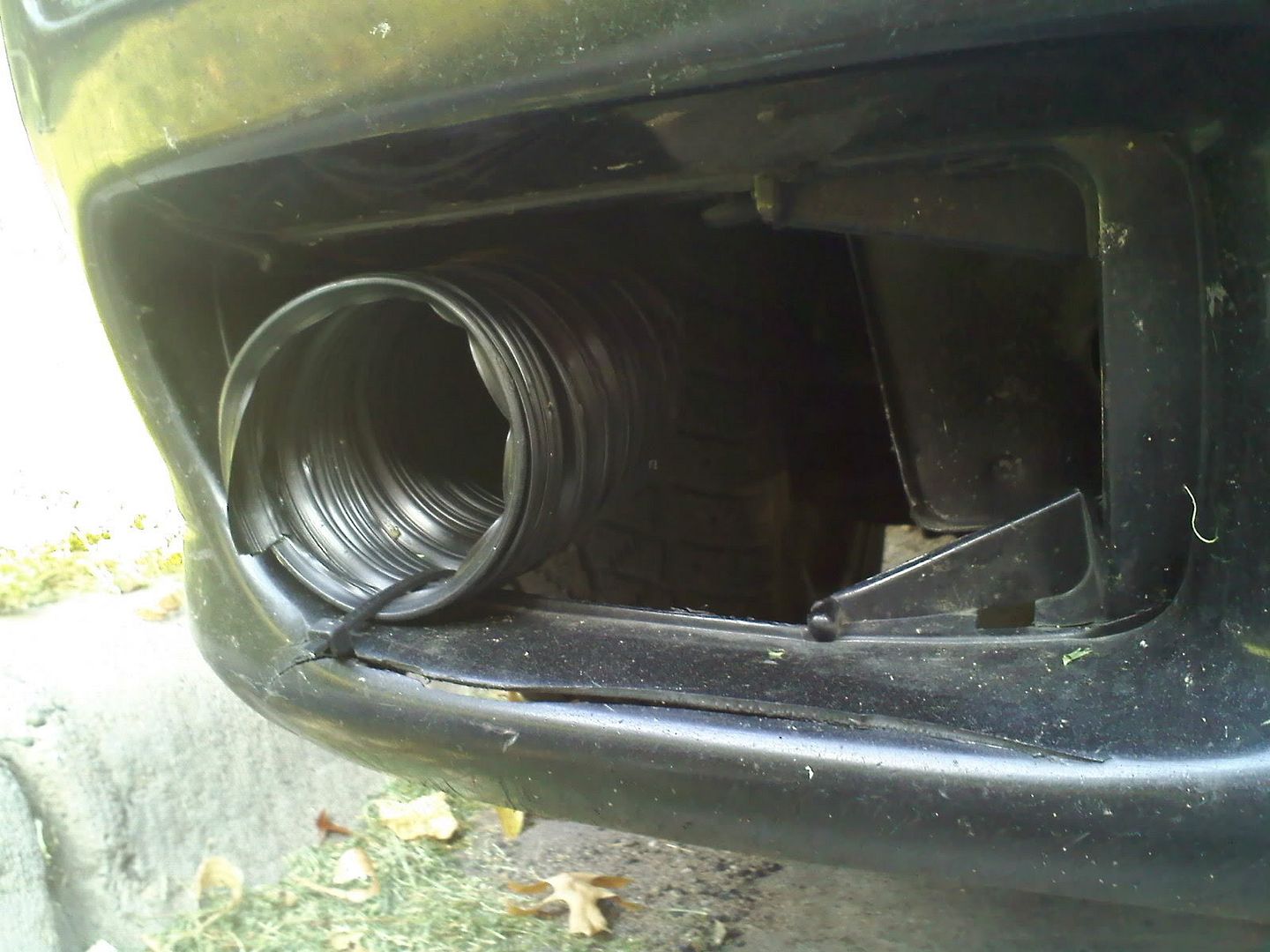

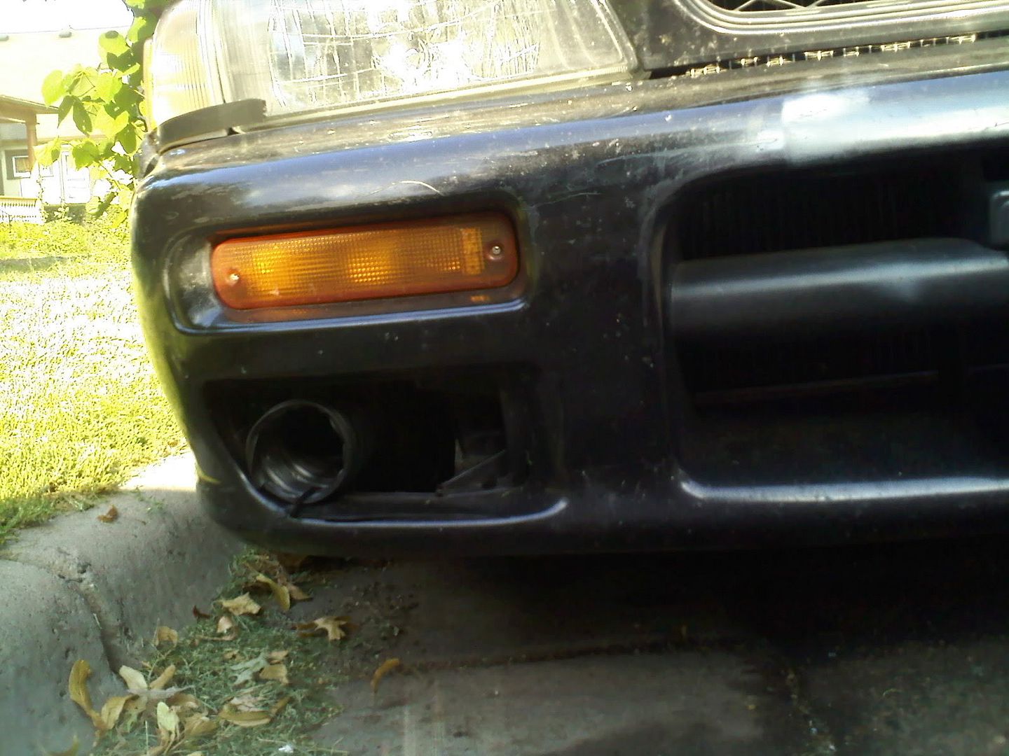

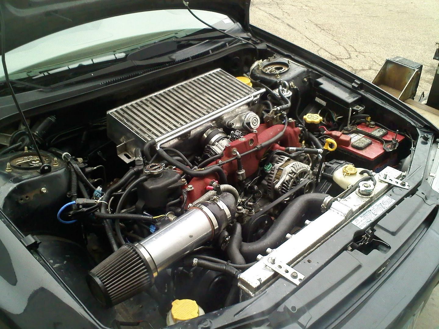

    Here's my fast secret. IAT's would normally be like 120-150*. Now it's as cool as the air outside if not a few degrees warmer. One night we were cruising the Hiway, a cool night... 60-70* or something to that and IAT's where 72*. The car is MUCH more preppy normal driving light throttle stuff. Good pickup because the initial air being drawn in is much cooler than engine bay air.
    [​IMG][​IMG][​IMG][​IMG]
  28. olegrad
    olegrad Well-Known Member
    ^lol. you got this idea from me ;)
  29. Grayguy
    Grayguy Well-Known Member
    I am planning a sheetmetal version of something like this on my next 97' LGT project
  30. Lowrider
    Lowrider Well-Known Member
    152
    Ummm... i think that box will catch fire at some point from the heat off the turbo and the whole engine bay especially if you do some hard driving on the track.
  31. Nuke
    LOL you literally have to put the box right on the turbo to get it started.
    The box will be fine, lol
  32. carl
    +1 lol. the ambient temps within the engine bay are no where near high enough to ignite corrugated board. If they did get that hot, a lot of other OEM parts would be destroyed too (ignition point for cardboard is higher than most melting points for plastics)

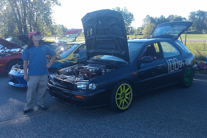

    I dunno if most of you all know.... but this is my 3rd engine setup.
    '91 EJ22T complete swap
    '02 EJ205 head/EJ22T shortblock swap
    '06 EJ255 head/EJ22T shortblock swap (built shortblock)
    just an update. The glass window will be replaced prob next week. The car is getting setup for an autocross this Sunday with the Corvette club. We hope to get some video footage. A rear sway bar will be put back in; 20mm WRX to bring out the tail end again. The brakes will be bled out with new blue fluid. The oil will be changed and brake pedal will be adjusted.
    BRAKE PEDAL!!!!
    I have long battled this issue. Normal driving the pedal feel would be fine. It'll bite well and up top. However when you put the car through any turns or say mad drifts, the initial bite is DEEP. I've swapped out the MS to a SVX 1 1/16 unit, still no cure. I've bled the brakes MANY times, still no cure. I've tested HIGH vacuum to the brake booster costing me my rod bearings, and still no cure. I've put in NEW pads, still no cure. When I did the 6spd swap, I had to go hydraulic pedal box. I did NOT adjust the pin down there and just dropped it in. SO that'll be the NEXT thing to adjust and see if it will take up some slack down there. SO we'll see if this will fix it.
    Mileage is currently 7450miles.

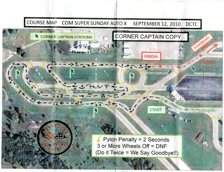

    BM at COM Autox Sept 12 at DCTC

    So I never thought I'd go back to auto crossing it's been many years and I had lost interest. Than my friend from work informs me the old crew was getting together at an event hosted by the Corvette Club. And that's where our story begins. My car was done for the season so I text Fuji to see if he'd be interested in taking out the BM for another tune up. He happily obliged and worked horrendously to get the car ready for me to take it to the track.
    I had only driven the newly revised version once prior to this engagement and I was informed the car was still being broken in at the time. But this time the car was ready to take on anything I could throw her way, including using all the rev's up to 8500 as the owner had kindly advised me to take full advantage of.
    I ended up meeting Fuji at DCTC in the morning where we exchanged vehicles. He had to leave for work and I had some work to do myself. The turn out was very good 88 drivers registered, they split the group in half and than into thirds. I jumped onto group 1A. First on the track so we can clean the track as some would say, but this would pay off on the second half cause I won't be so tired, it sucks being the last ones on the track cause by then all you want to do is be done and go home.
    We were pretty much guaranteed to get seven runs. After walking the course I knew this was going to be a very fast course. So my strategy was to push very hard on my first two runs and than dial it back from there. I won't suggest this unless you are familiar with the track, can engage the car quickly and can make adjustments quickly.
    The brake issue we were having before wasn't so much of any issue anymore, after the first initial hard braking which had a very high engagement point the pedal quickly settled down to about half way and stayed consistent for the rest of the day. But I did run into a new brake issue one I had anticipated but there wasn't a whole lot I could do. Turns out the NT01 235/40-17 tires was a mismatch with the Project MU Full race pads. They were way too aggressive for this type of course with the current setup. The window between threshold braking to trail braking to lockup was super small. My first few session I was fighting with huge amounts of understeer, it wasn't so much an issue of me trying to carry all this speed but trying to balance the brakes to find the happy median so I could. I ended up just doing everything a lot sooner and slower, turn-in points were the same just ended up coming in much slower than I wanted to.
    I also found some challenges trying to setup the car so I could pitch it into the hairpins, the car was bucking and fighting me the whole way. Coming off the start all four tires would spin, than the brakes would lock up the tires coming into the first hairpin, than after the hairpin WOT all the way down into the fast right hand sweeper, the car felt like it was going to come off the track often times wheels still spinning while we're already in motion. I got into the right hand sweeper and I trail brake, than as I get closer to the second hairpin I pinch the brakes to load the front and get the rear to come around and I'm back on the gas hard. This was also very challenging since the car had a very heavy steering feedback looking for every ounce was very difficult.
    After clearing that section it was a quick left down a few gates left right left and another hairpin to the left. I locked it up here a few times so instead of braking after the last gate I moved it before it. I come around the hairpin and its back to WOT for a brief moment down two slalom cones than back to WOT, lifting just a little bit to get the car to turn right up the hill and than hard braking. Quick right hand and back on the throttle hard all the way down to the finish line.
    All in all I was able to maintain enough speed thru the turns to utilize 2nd gear. I felt the body flex more than ever cause when ever I could I would open her up quickly and hard with both hands on the wheel making the slightest adjustments to keep all four on the track. I ended up making some tire pressure changes which helped calm the back end a lot. I did have one hairy moment and by that time the tires where starting to complain as did the car and I had started pushing my luck so on my last run I short shifted at 5k and used part throttle, I managed to get a 1:06 clean run no cones.
    Lots of things happened and I tried many different things but in short that's basically what happened. I had a great time, hope you enjoy the recap and videos.
