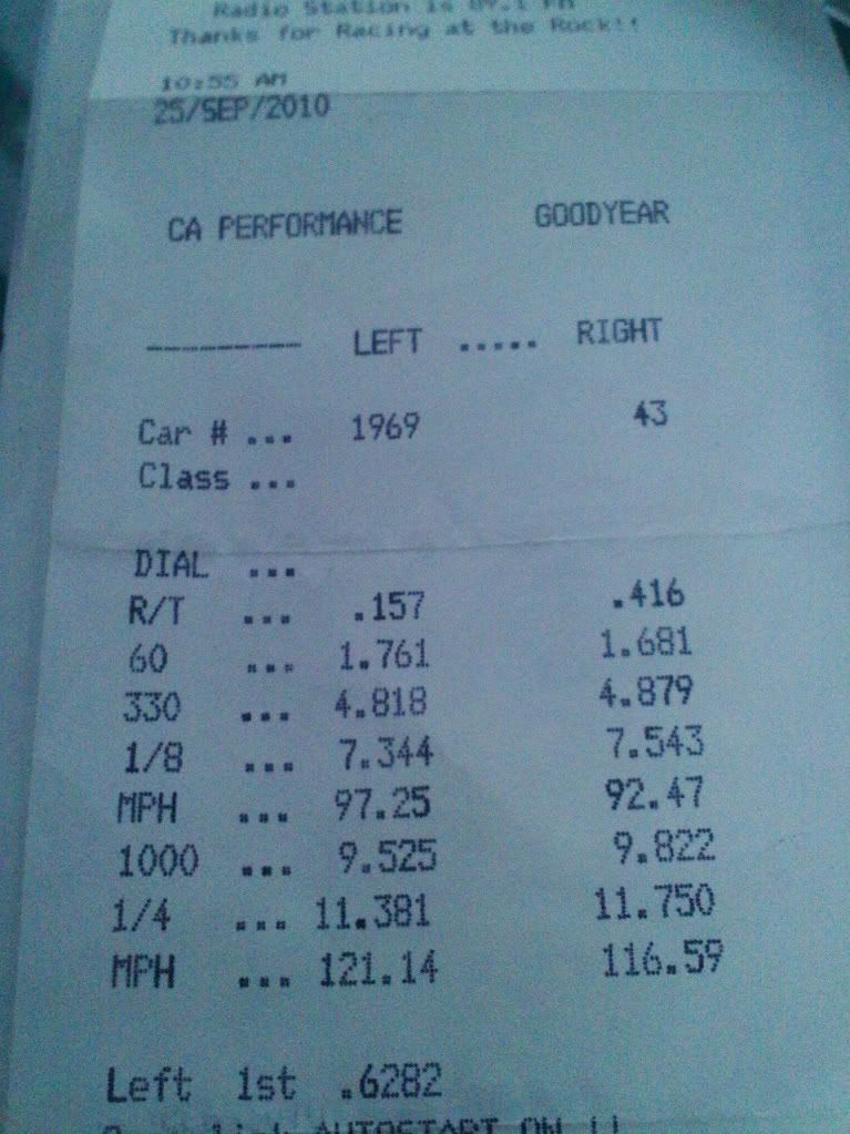

    HUGE Congrat's to everyone involved and especially to you both. Not sure how those times translate in my world but I'd say its getting into the scary fast street able world.
    If I could suggest so openly and boldly-I thought she could of done better. I really think she's capable of doing 11.5 if you'd just install a duel short shifter. And next season if Fuji gets the old bushing's replaced 11.3 is a possibility. There's a lot of lost energy wasted with all the travel. And get serious guys, get some real drag slicks for once, you boys are all using the same dimension tires and wheels that you could all just get a set and share. If you do Mini Mt. Fuji will be shopping for a fire suit and cage really quick.
    Granted I wasn't there and I don't do the 1320 thingy.
    I'd like a recap from Fuji what were his shift points and if they were consistent in every gear?
    I like!
  23. FuJi K
    3,850
    St. Paul, MN
    the first run, which was also the fastest run was driven shifting right about 7000rpms despite the higher 8000rpm redline.
    I know the shifter is really sloppy becuz of the worn bushings at the joint. If you can shift it fast without a shorter shifter, then you won't need one. Anything faster and you'll be grinding gears or wearing out the synchros fast. If anything I'll be getting a short throw linkage over a shifter.
    I'd like for you to take a look under the car and suggest which bushings need replacing. There are a few select ones I would like to replace but I'd like to see which ones you suggest.

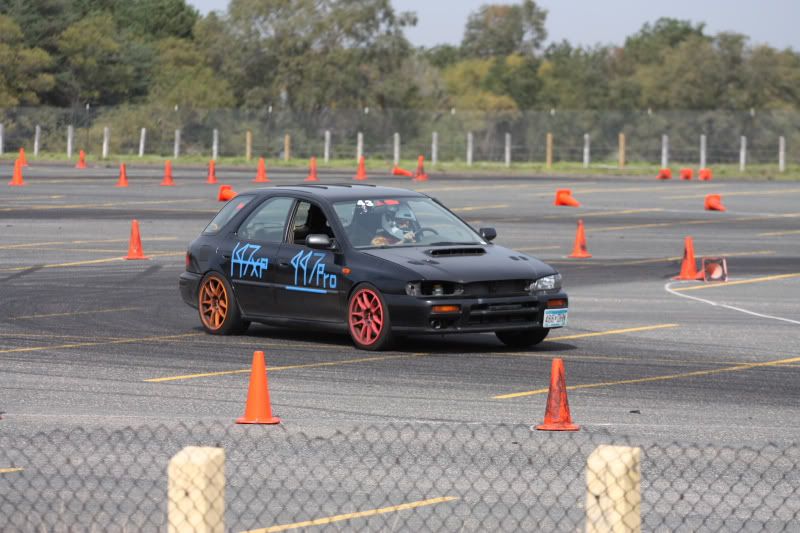

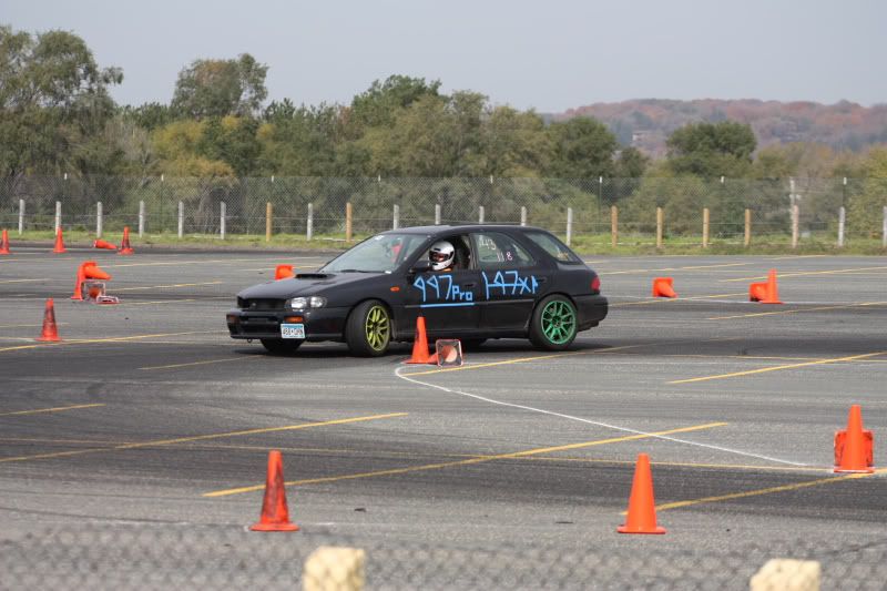

    here's from the autocross yesterday... I haven't autoX for a LONG time. I dunno where I am on the time list.. but eh... I had fun! Formnula karts doing 50-55secs. Fast EVO running 56sec. I running 58 sec. Other cars 60+ sec.
    Credits to photographer!!! Thanks for speedyham for lending us some tools! Thanks to Chong for coming out to have another drive with the wagon before winter. Thanks to Nuke for the bringing the uproar in power, Thanks!
    We broke the sound barrier with our "LOUD" external wastegate. People hated us. Well that's just too bad.... it's as if they've never heard anything that loud before... thanks for the hate! we made a record of 103.5db at something like 50ft away!!! WE ARE THE PROBLEM!!!! LOL hahahahaha
    The car handled sloppy. The road was like marbles. However the car still gripped if you allow it to. Then if you wanted it to slide, you can on demand. The LSD was overworn. Inlift sucks because you can't lay down the power. The car sure moves when BOTH rear tires are flat! Damn that EWG is ear piercing! I would have drifted the course if I wanted to. Revving out to 8000rpms is quite fun! I almost got into 3rd gear. We probably hit close to 60mph on that little straight. I saw course workers running out of the way when skittles approached. The car is STOCK.

    Well our day started very well. I signed up my little friend Fuji into the Pro Index, why? Well he's our secret weapon on the team you might say. But really he's just that good. No pressure considering pretty much everyone in that class was running slicks and has many years of Autox'ing experiencing. I put myself in XP, it was really nice to finally see Speedyham's GC monster, for some reason this car reminds me a lot of the Time Attack GST. It's nice to finally meet you Sean.
    So the day started out without a hitch, I had asked Fuji to run the first three sessions since we were sharing the car so we can get her dialed in quickly. In the morning the car oversteering a lot more than I'd like so we kept dropping the tire pressure especially the rear. We finally got the car to where it would only oversteer on demand. It was very nice to see a course map before going to the event. Studying it I observed lots of opportunity for left foot braking and two possible hand brakes. So that's what I ended up doing to keep my lines tight.
    I got a little creative since this was not as very a fast course as the last COM event, so I decided to get an Instructor to ride along. I wanted their input and some weight to balance the car out on the right side. This car really took them by surprised, one female instructor told me she had held her breath in some of the sections and this is from a Corvette driver.
    All morning we were pushing pretty hard trying to find the threshold of the car's traction limit running at I believe 25psi, no noise infractions what so ever. I was probably the colperate since I had the most DNF's from spinning and going WOT in area's where some wouldn't, but that's one of the advantage's of using LFB'n. We later took her down to WG boost 18psi and that's when Fuji bounced off the rev limiter twice giving us our first noise warning infraction at 101 db. LOL
    The BM is a handful but a lot of fun to drive, Fuji's has agreed to get wider tires for next season so hopefully we can reduce the amount of tires spinning and minimize braking and carry more speed into the corners. I really liked the modifications Fuji made to the shifter, this is a much needed improvement. I can finally drive without second guessing which gear I'm in. We'll have to put a real bucket seat and race harness in for next season.
    One of my least favorite things about Auto'x is standing around for hours. I was working as the Start Marshall and I've been hydrating all day to the point where I had to go super bad. I was trying to flag someone over from one of the near by stations and also tried to radio someone to come relieve me, so finally I got Speedyham to come help me out. I sprinted straight to the portapotti. Thanks Pal!
    Despite popular belief I believe we put on a heck of a show, displaying AWD car control. Everyone that asked can't believe the car is only putting out just over 300 whp. Well folks here's the secret, it's all in the delivery and the best guy to go talk to about this is Nuke, he'll set you straight. It's not about peak horse power, it's how practical and functional you can apply it to your style of driving and activities.
    My camera was only able to capture Fuji's two run's in the morning so enjoy.
