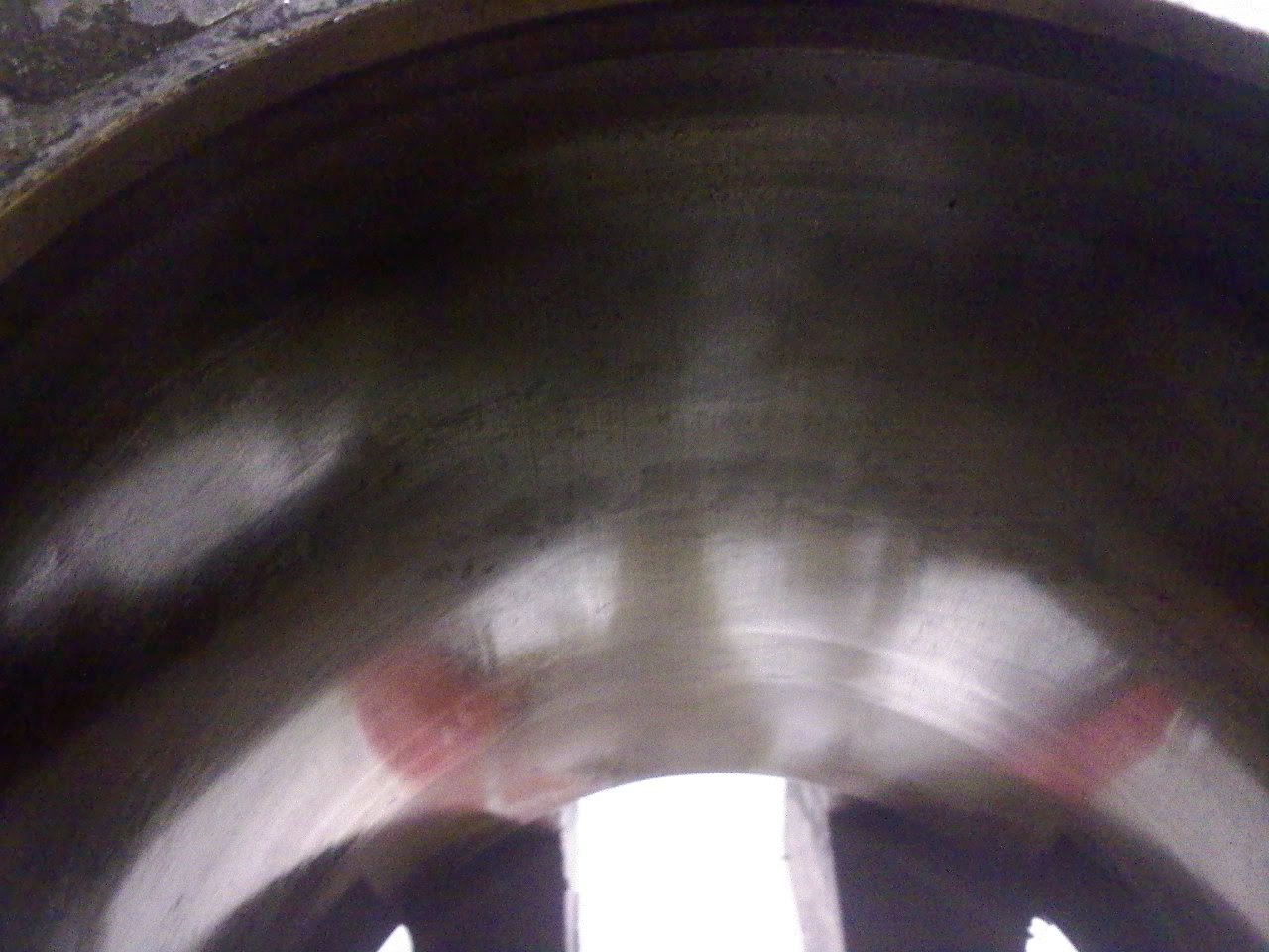

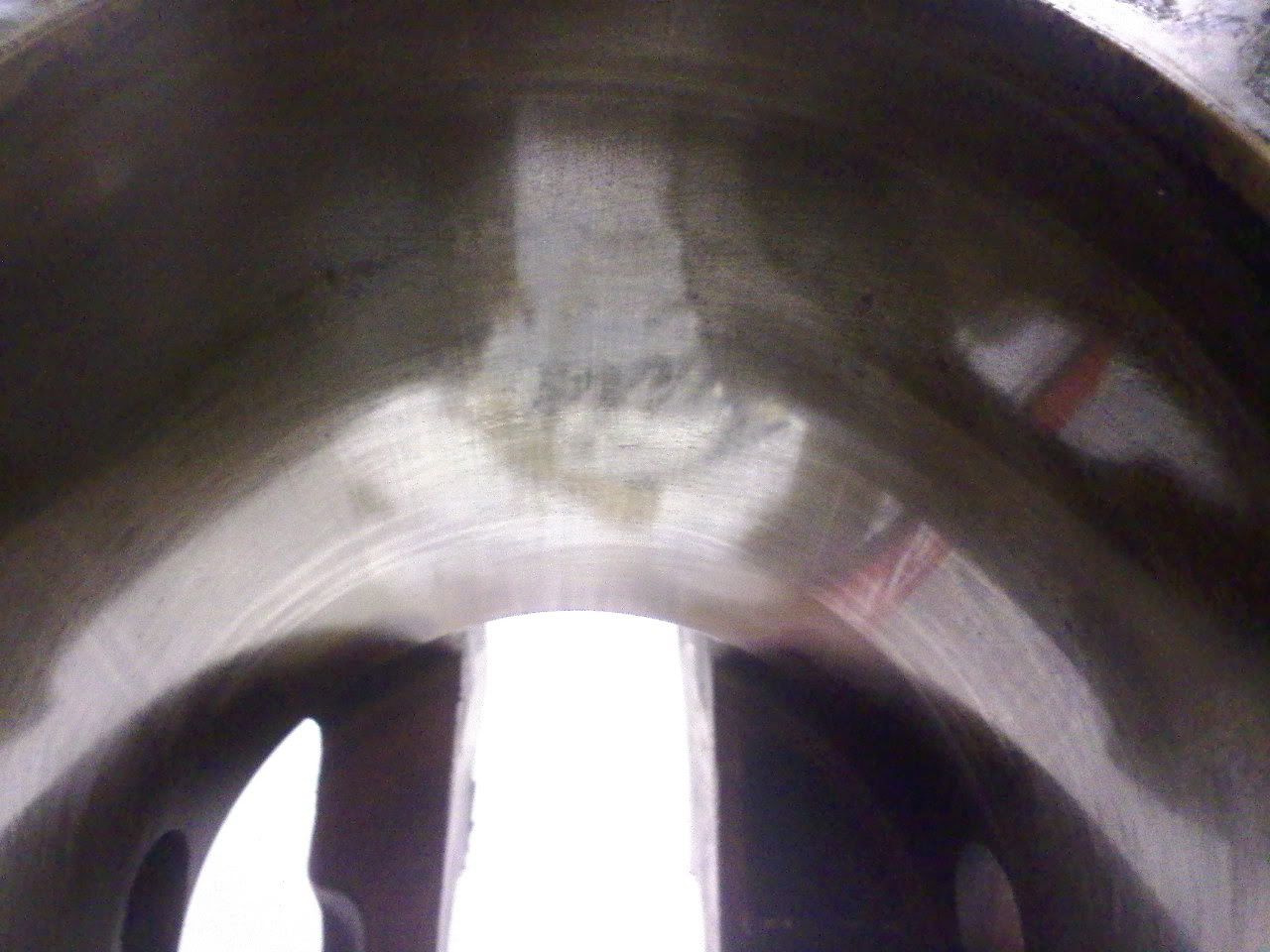

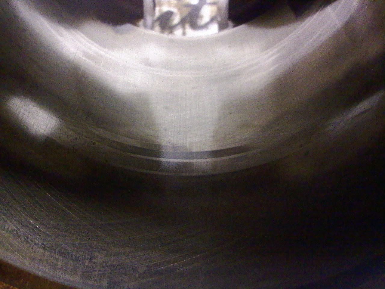

  3. FuJi K

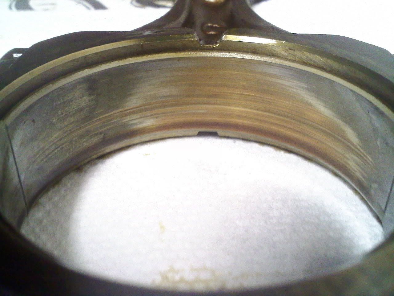

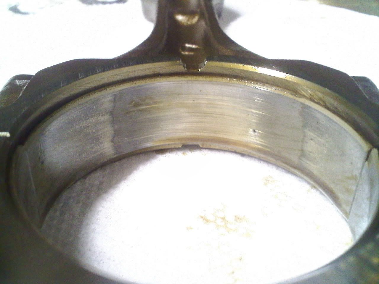

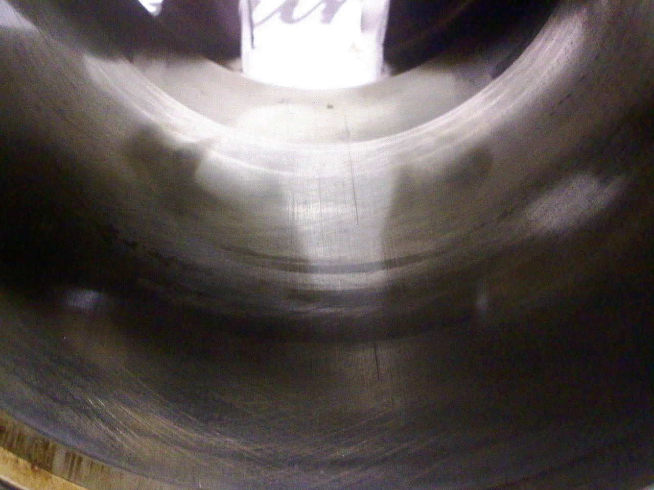

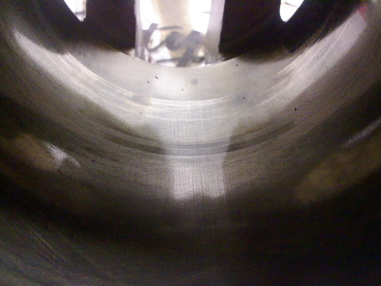

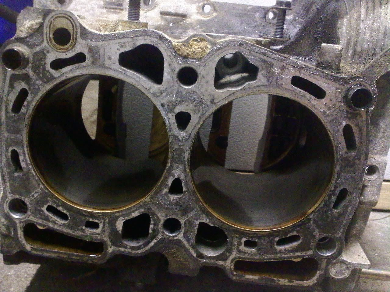

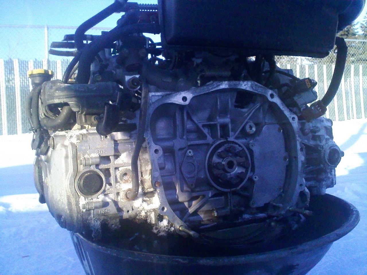

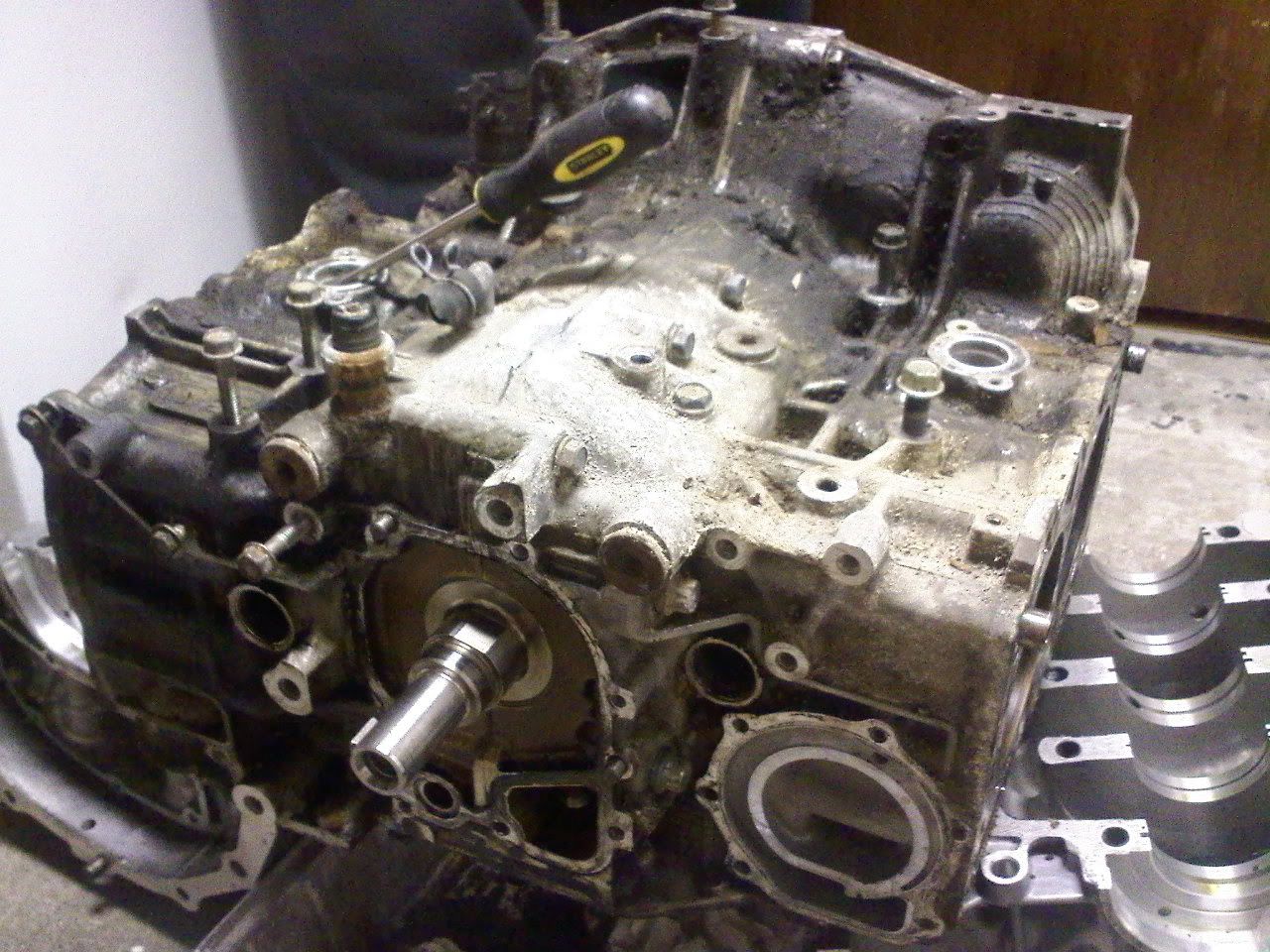

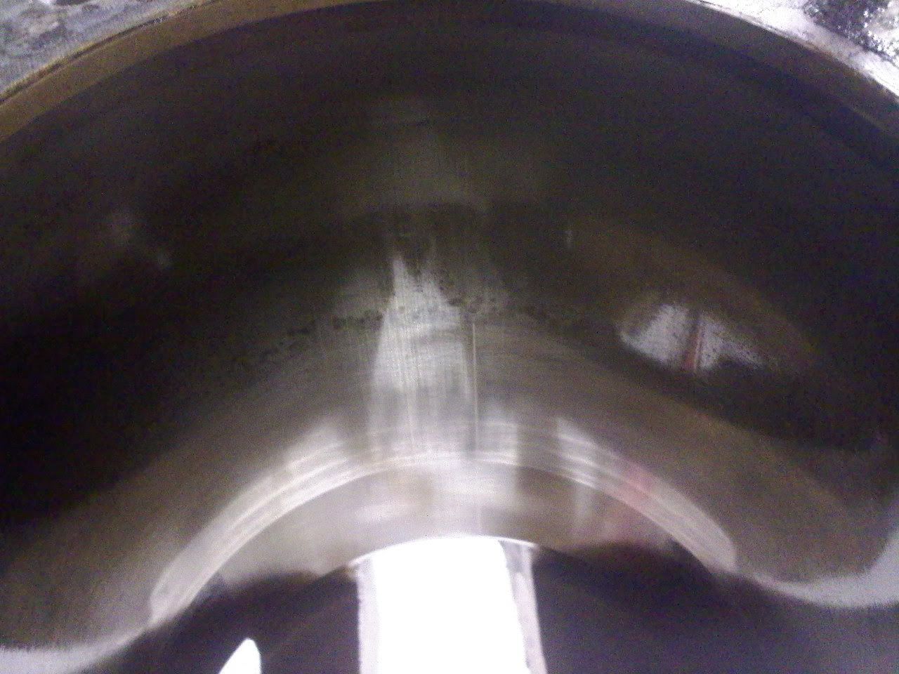

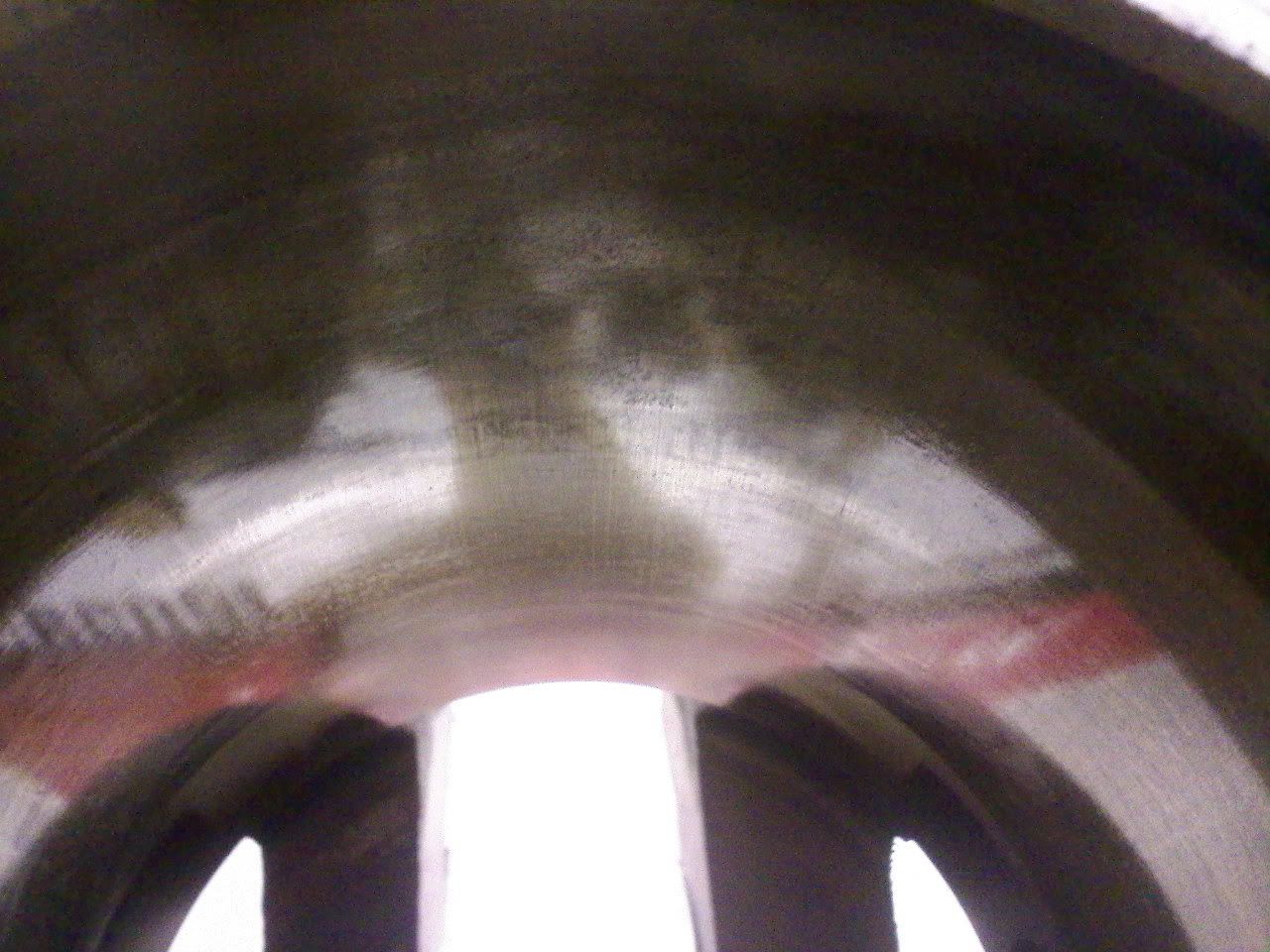

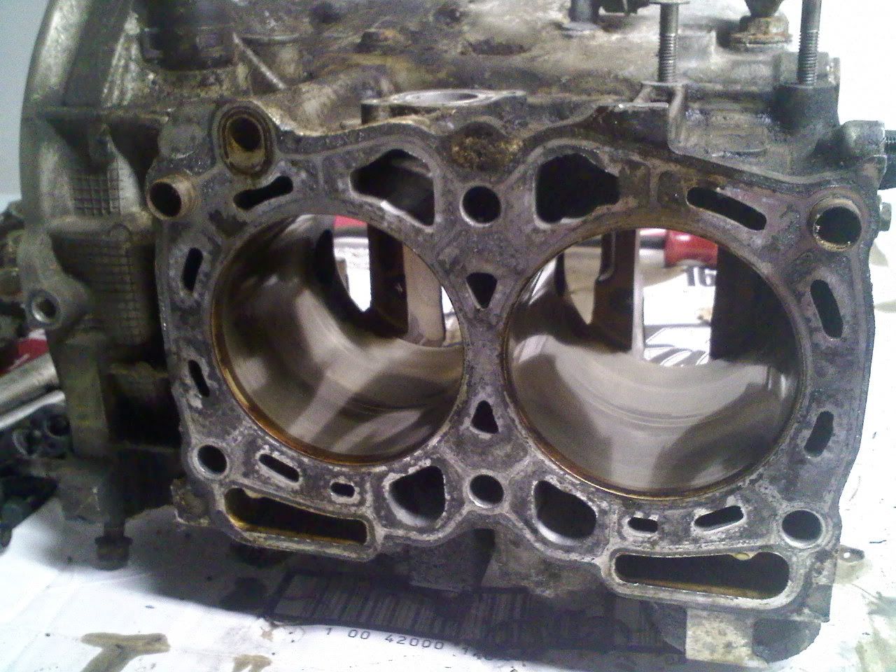

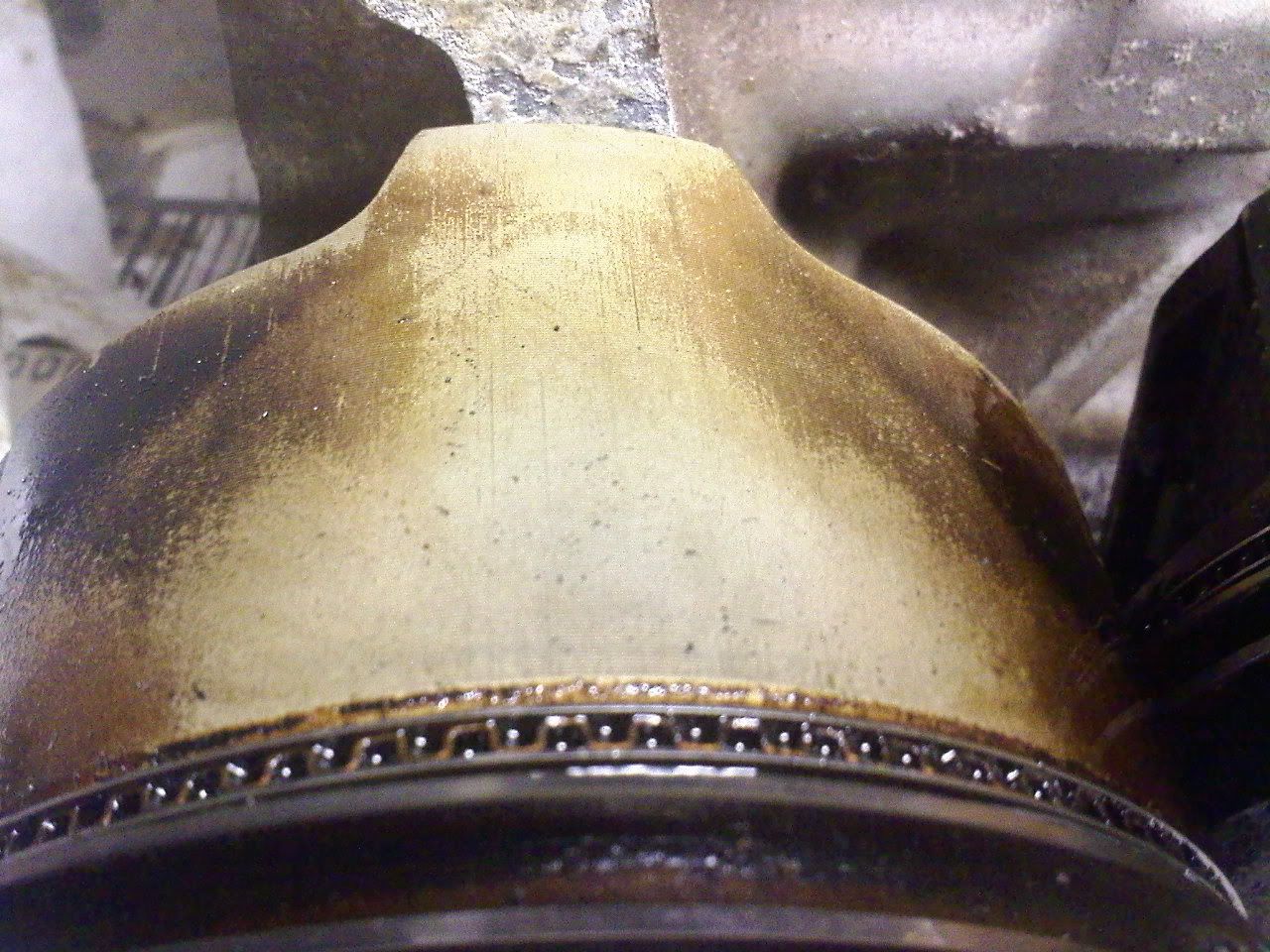

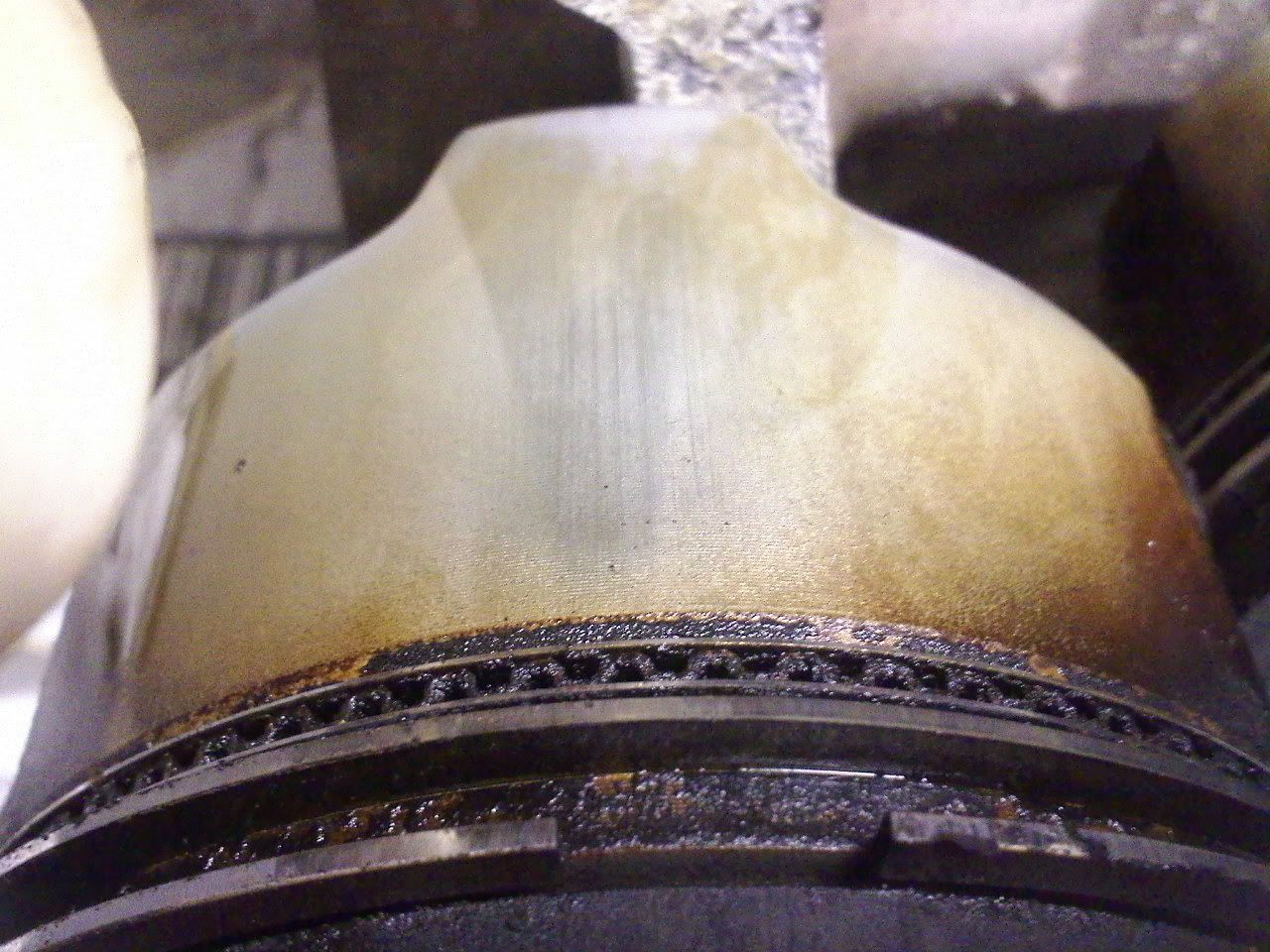

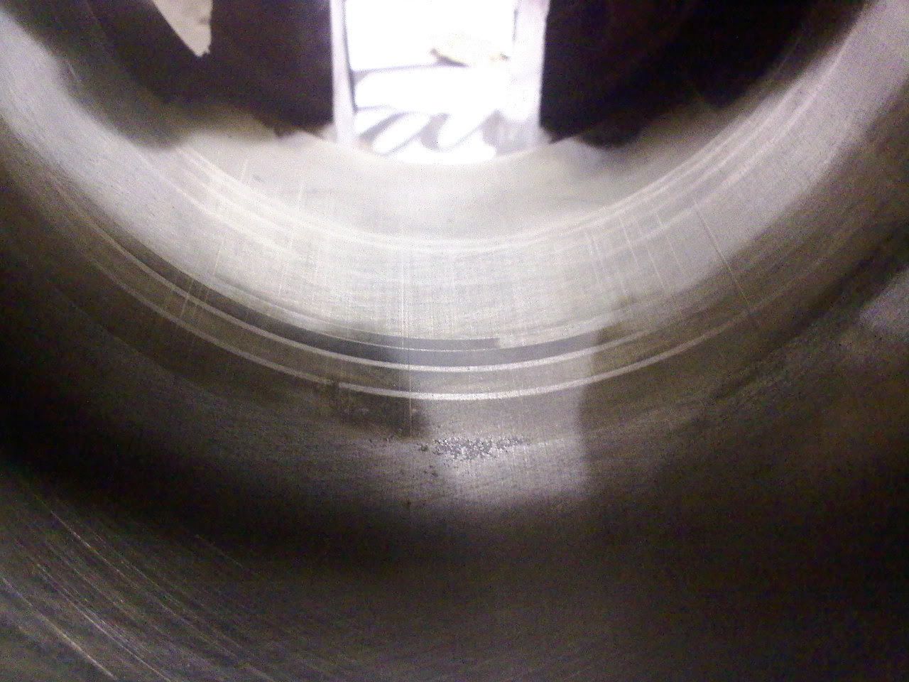

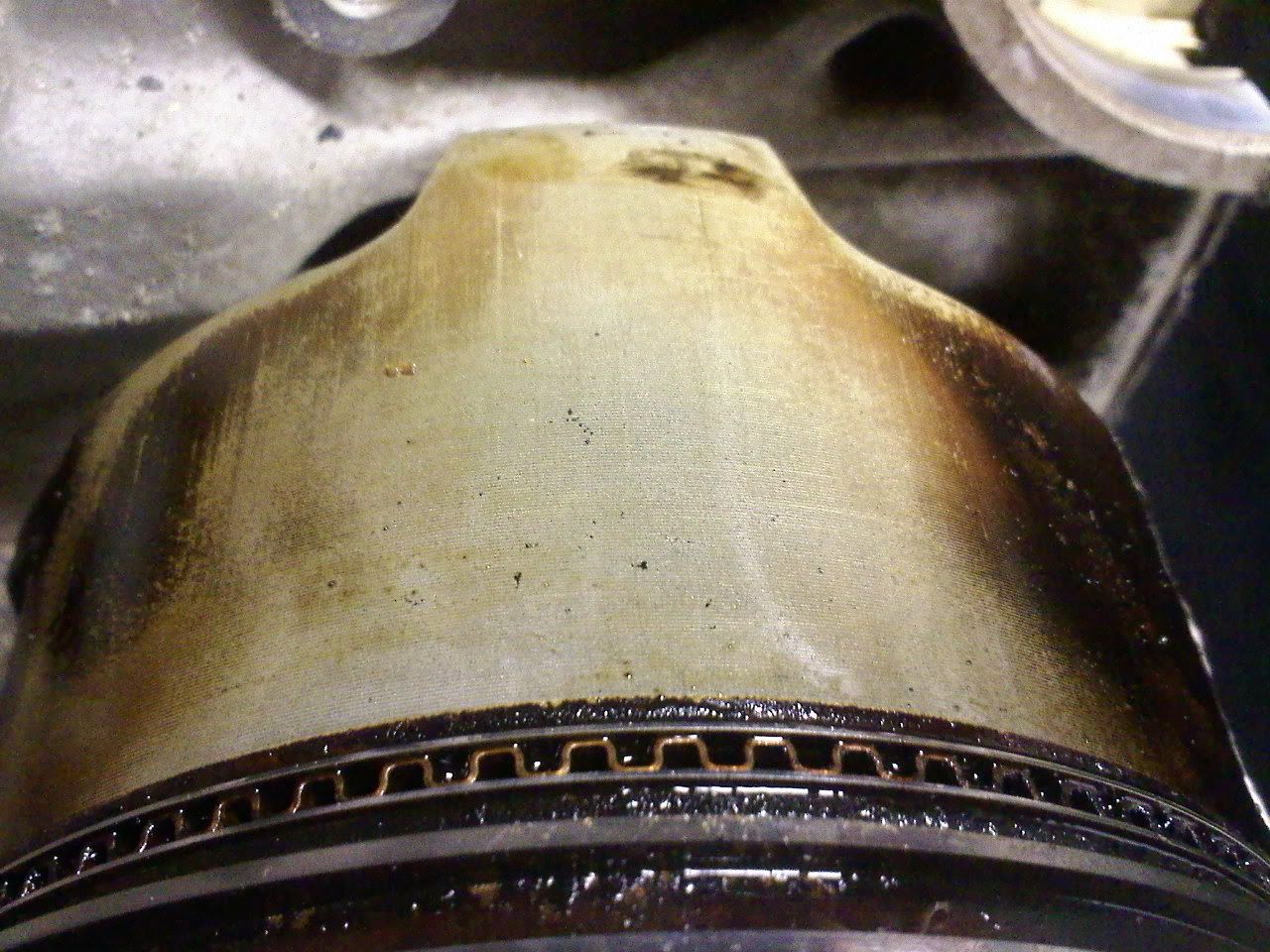

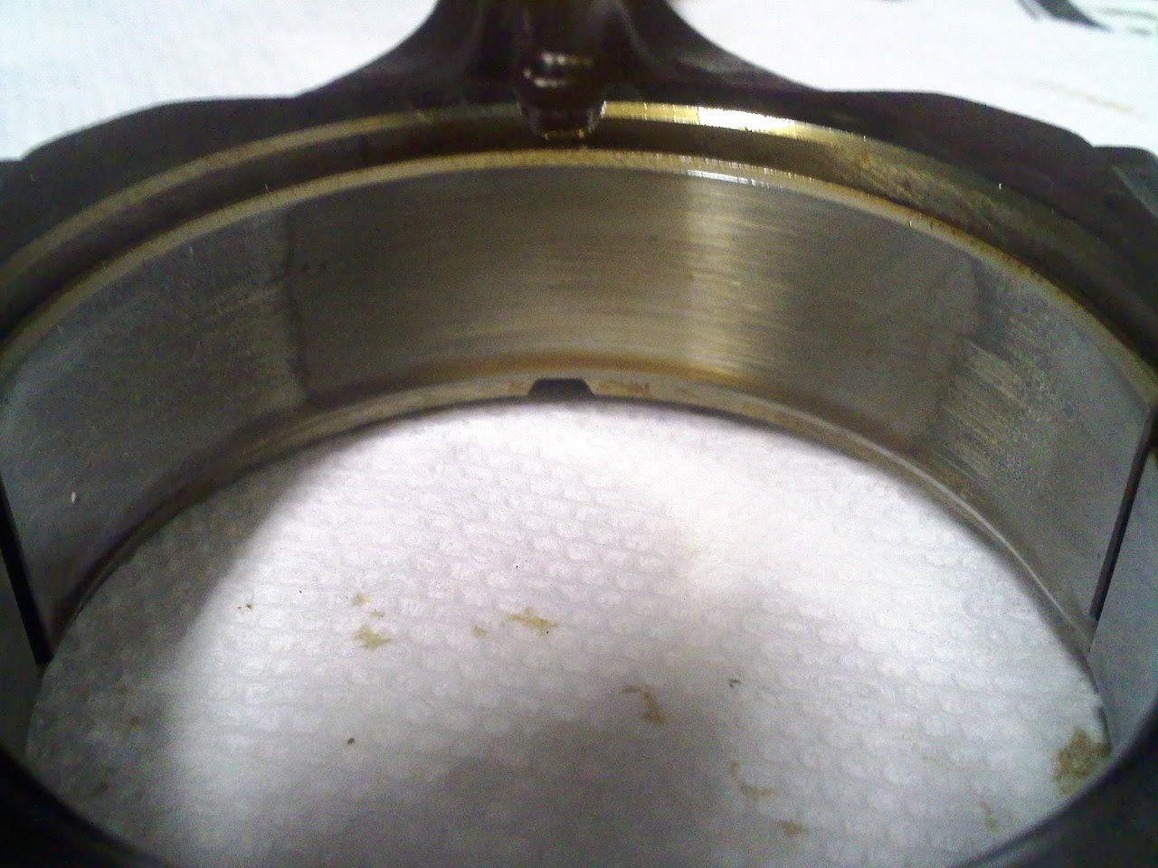

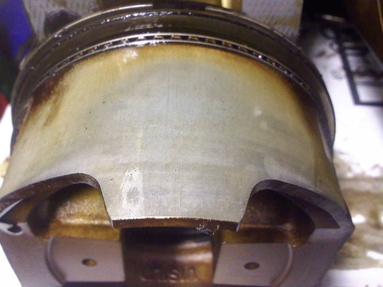

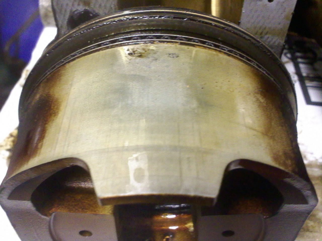

    here's the latest. This motor suffered from rod bearing failure. I dunno if it was from lack of oil or if it was fed with 87oct? Here are some pictures
    Halves
    [​IMG][​IMG][​IMG]
    Rod bearings 1-2-3-4
    [​IMG][​IMG][​IMG][​IMG]
    Cylinder walls 1-2-3-4

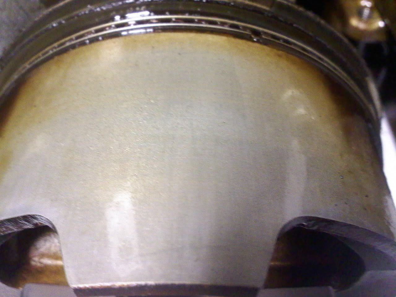

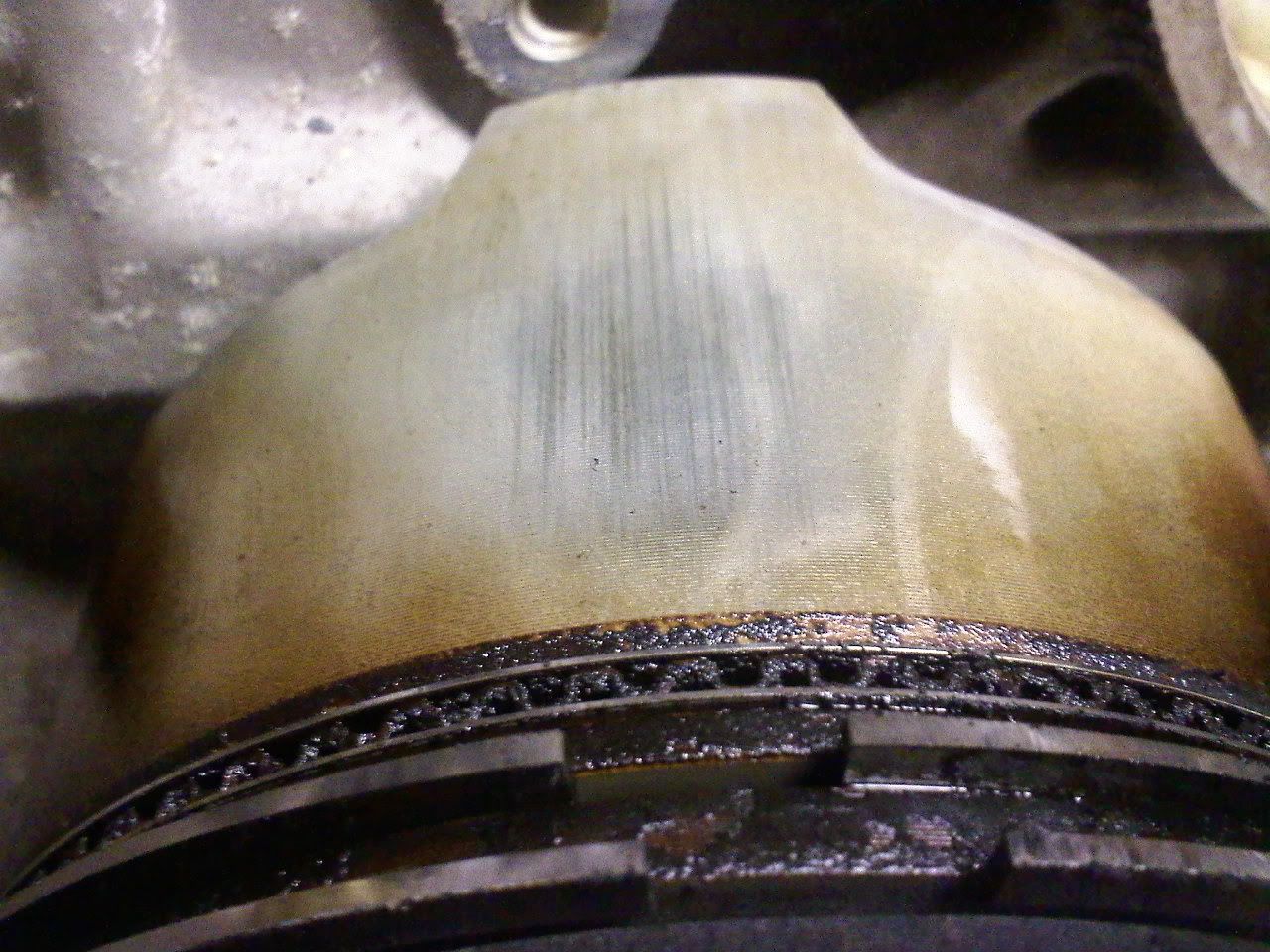

  4. FuJi K
    Pistons 1-2-3-4
    TOP[​IMG][​IMG][​IMG][​IMG]
    BTM

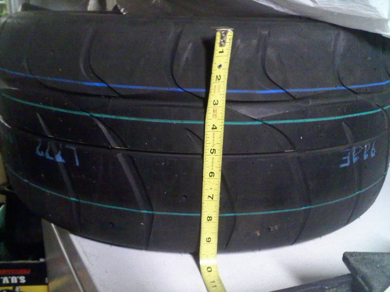

    ok..... an update..... these will be stickier.
    255/40/17

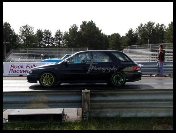

    The new tires have been mounted. Previous Nitto NT01's where 235/40/17. They are now 255/40/17. I figure these will be as big as I will ever go. Anymore and we may need to do some 22B wide body or something. hahaa My fenders are rolled and pulled. They LOOK stock but it's how you pull them so it'll look clean. I don't like the flared lip look.
    The wheels again are 17x9 +38 offset Drag DR31 wheels from Discount Tire. They are a replica of the WORKs CR-Kai. They weigh about the same. Spoke design about the same. The difference is the angles on the spokes towards the face. Other than that they are very good looking wheels. These 17x9 are deep dish faced. The reg 17x8 are not like this. You can look at them on dragwheels's website.
    Here's the stance and launching at the drag strip on the 235/40/17. I didn't even know who took these pics.... but tagged on facebook!
